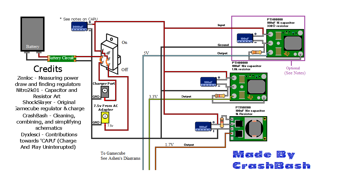

sorry again for another noob question, but does anyone know how to connect all the regulators together to the battery pack? Could someone please explain this to me? Thanks again
The positive output of the battery (which should come from your protection circuit as P+) should connect to your power switch, with the other end of the switch connected to the input of your regulators. The negative output of your battery, P-, should connect to the ground of your regulators.
Ignore the resistor values, this diagram was made for the Gamecube. The wiring, however, is the same. You can just daisy chain the wires across the regs.
