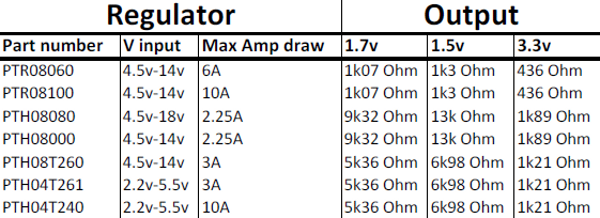

Bakuku . Joined Jul 23, 2016 Messages 214 Likes 124 Location Genk Portables 4 Aug 20, 2016 #1 With this Diagram you can determine what resistors you need to get the votage you want for which regulator you are using. Diagram was uploaded by LocTronics/Zenloc on MR. Was lost but I found a cache. Attachments diagramresistors.png 100.5 KB · Views: 646
