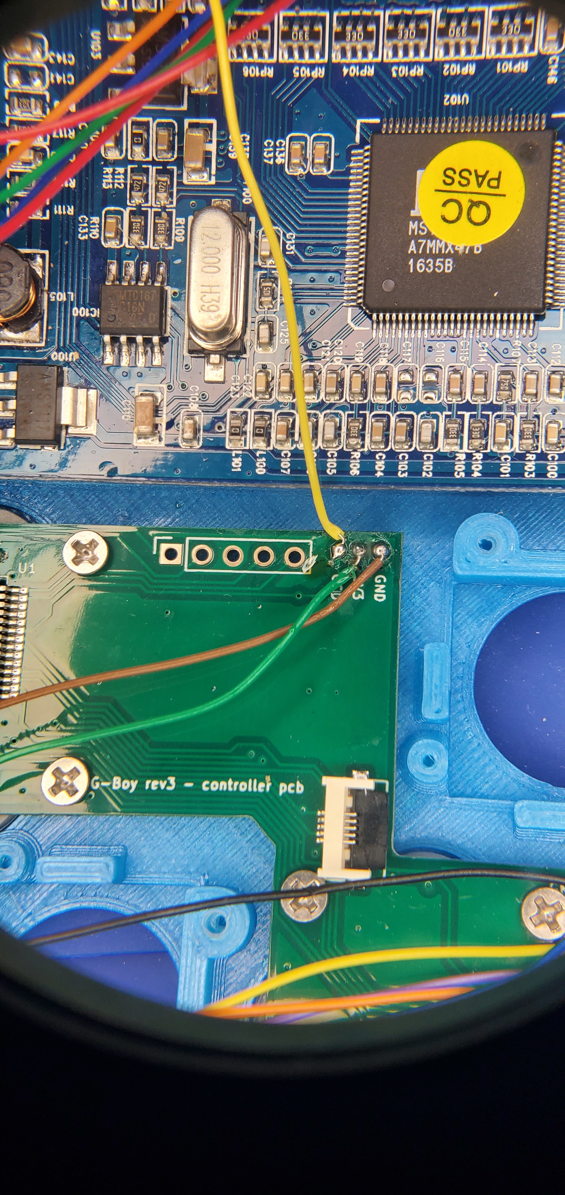

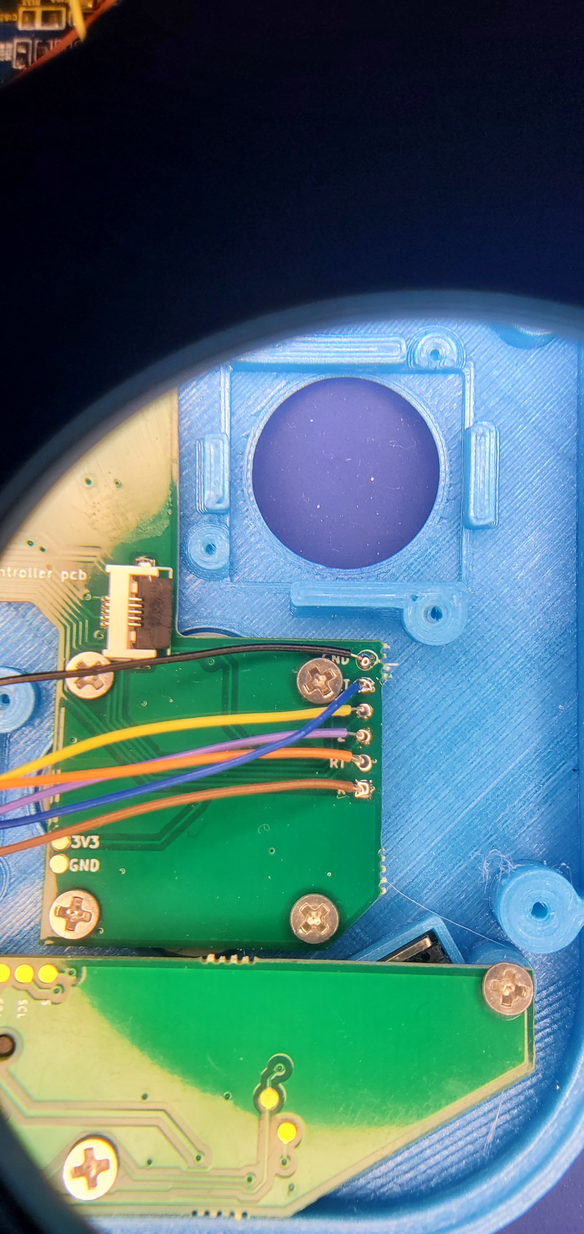

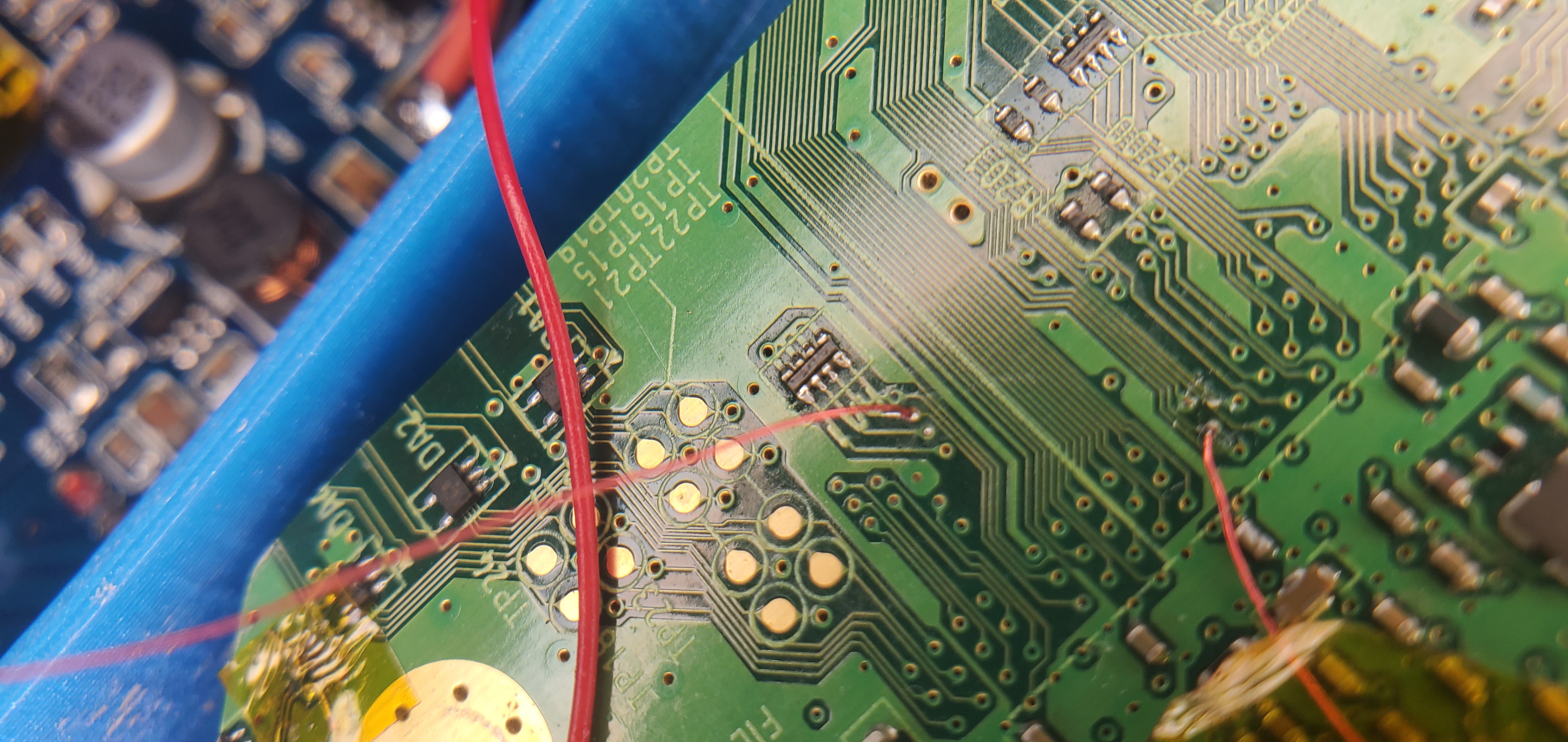

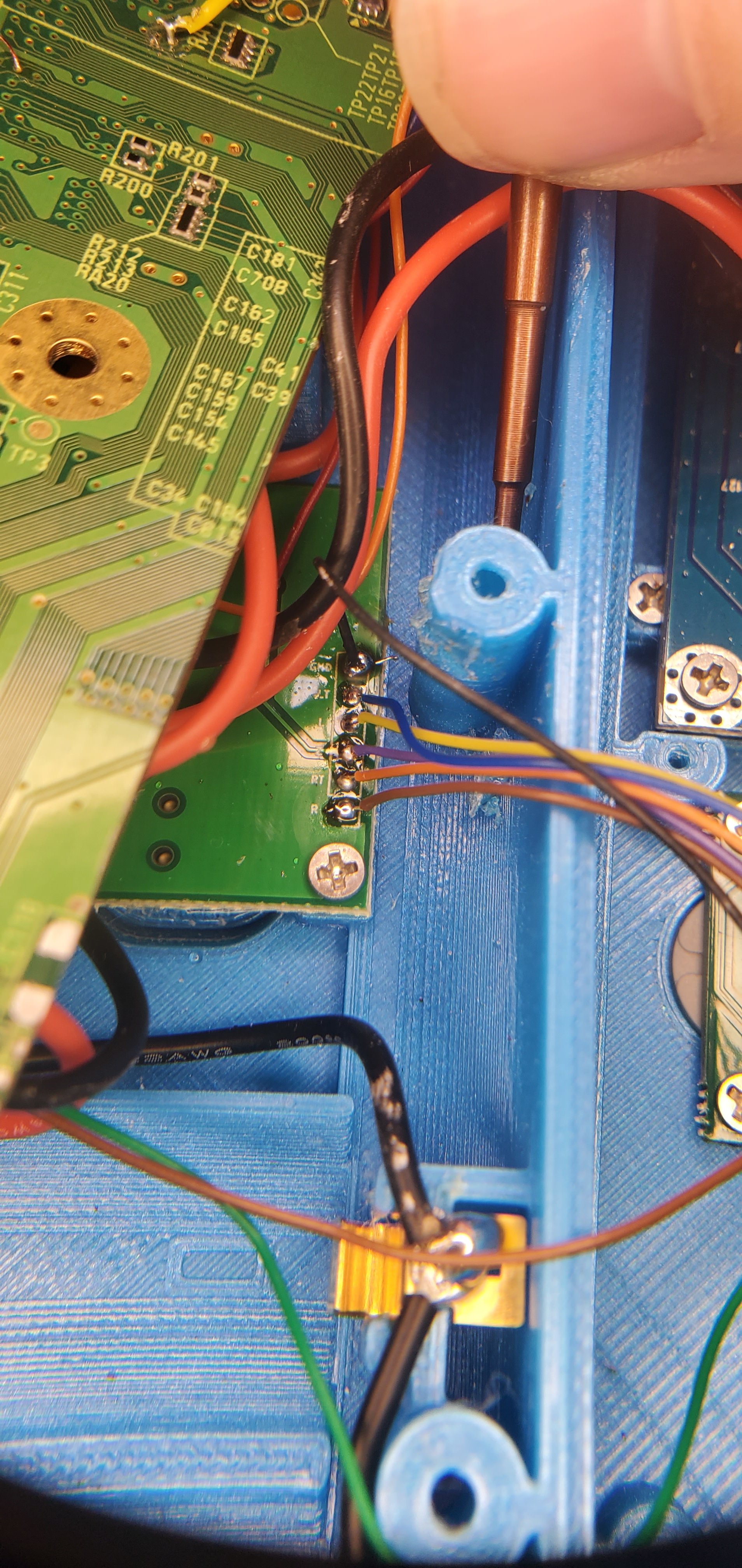

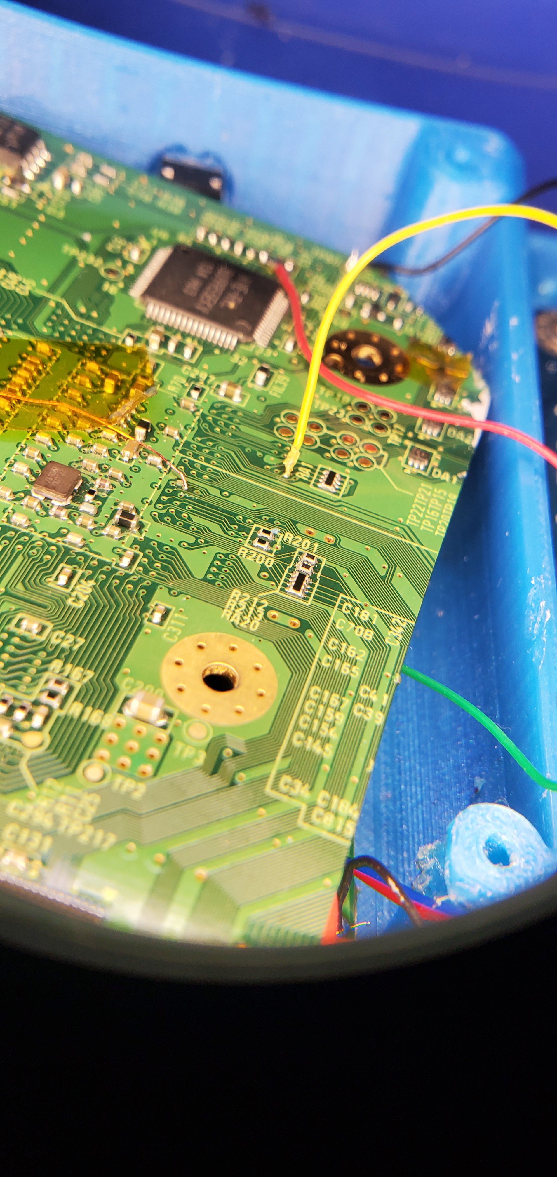

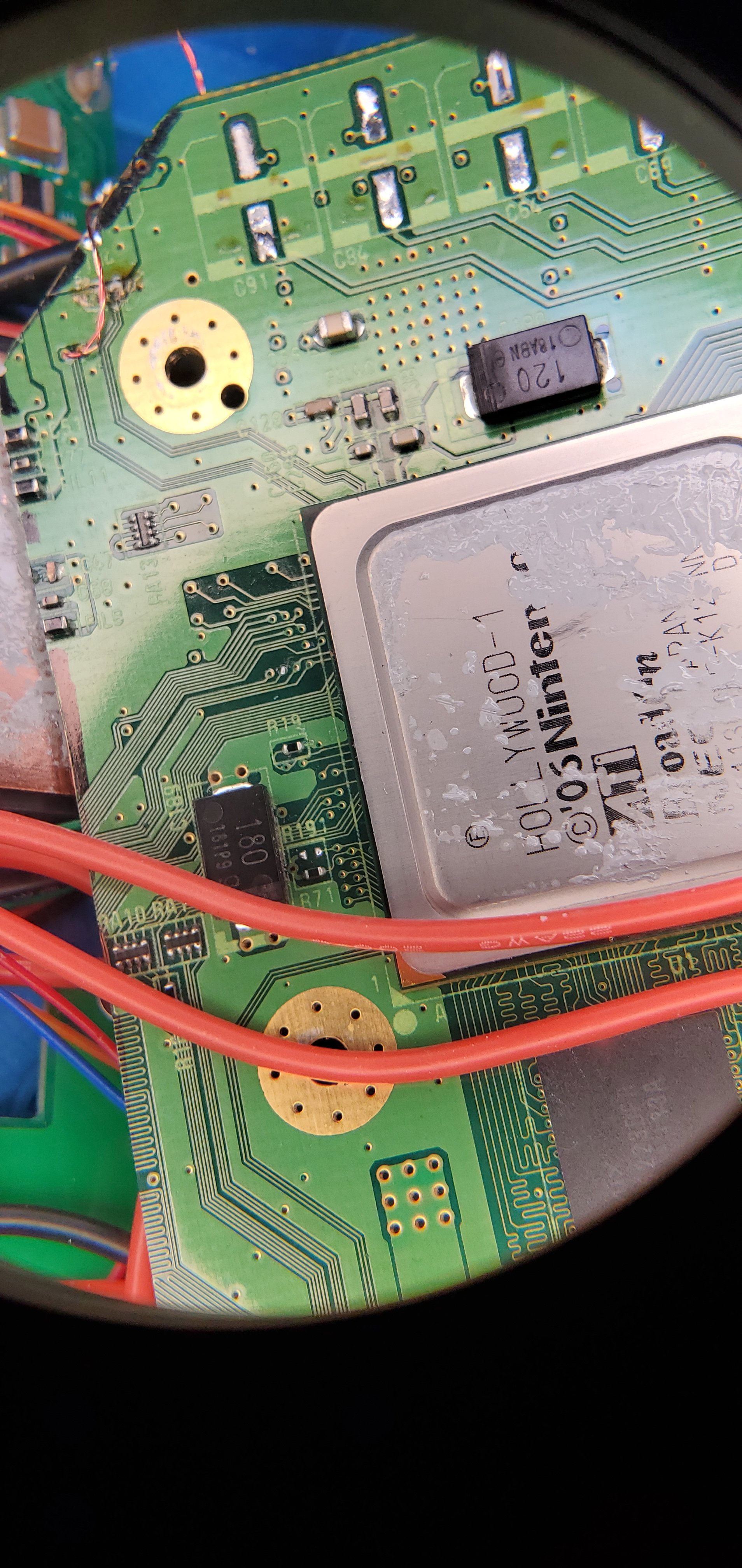

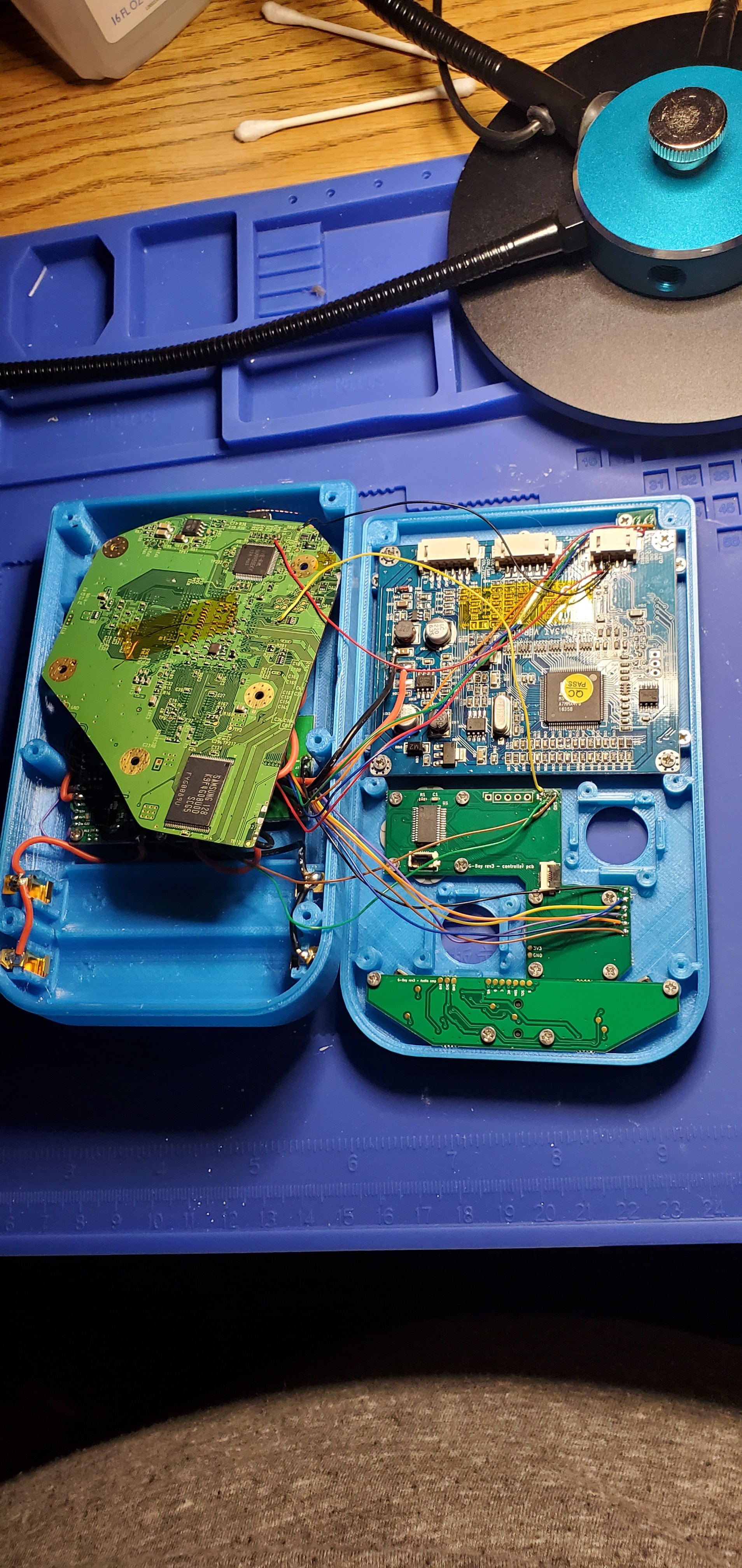

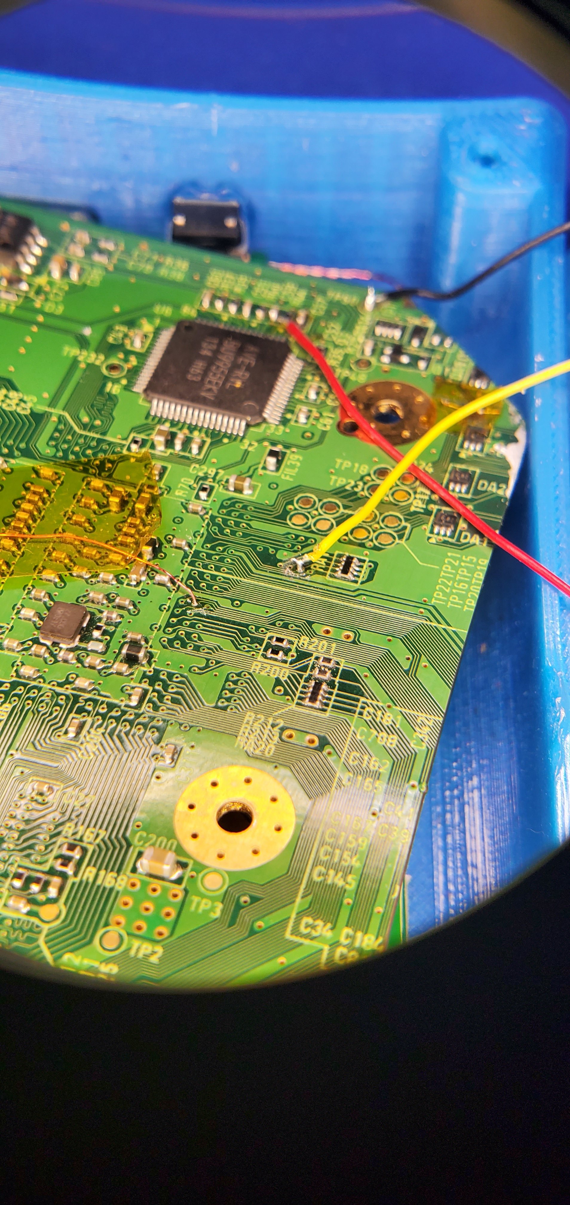

I have been working on a gboy for a while and I'm stuck I can't get the controller to work I have changed and resoldered the wires and nothing works I checked it with a multimeter and everything seems fine but I don't know whats wrong
You need to share pictures and as much detail otherwise we do not have much to go off of.

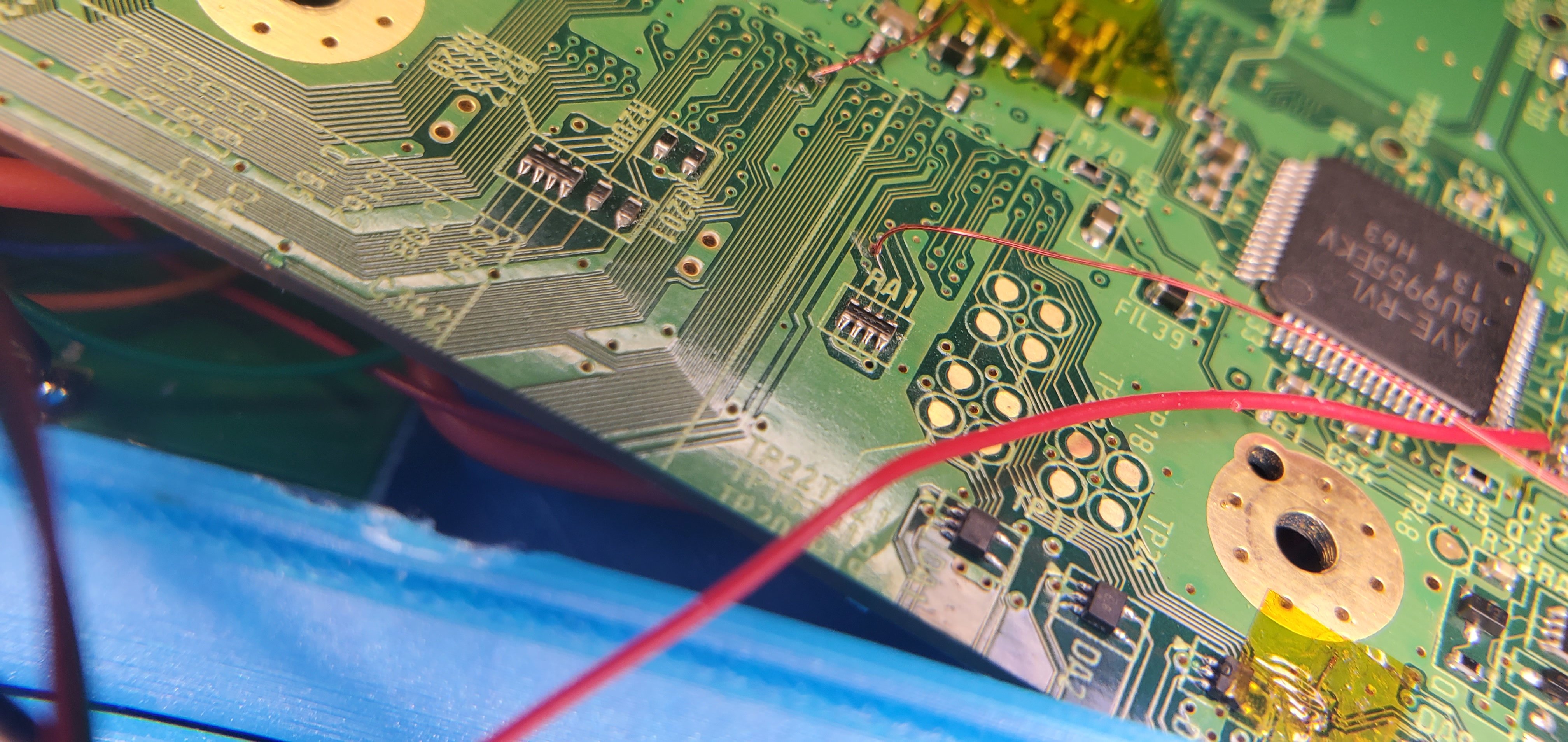

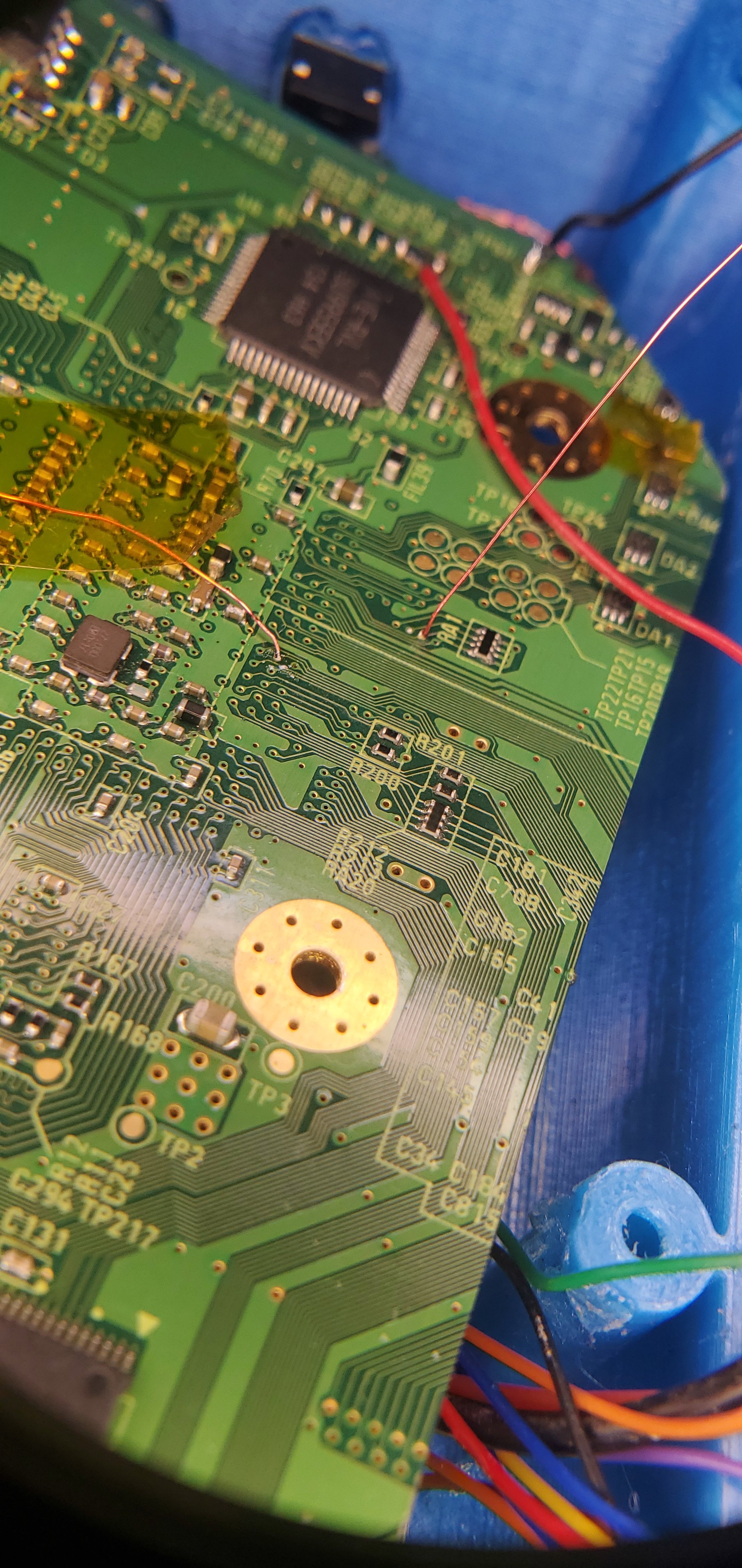

Here are some pictures of the soldering I've done with the controller board

The gc data on the wii via doesnt look great. Make sure you scraped off the solder mask to expose the copper otherwise it wont be a connection. youve also got solder splashes on the surrounding area which signals that there wasnt sufficient flux and the solder could be forming a short circuit

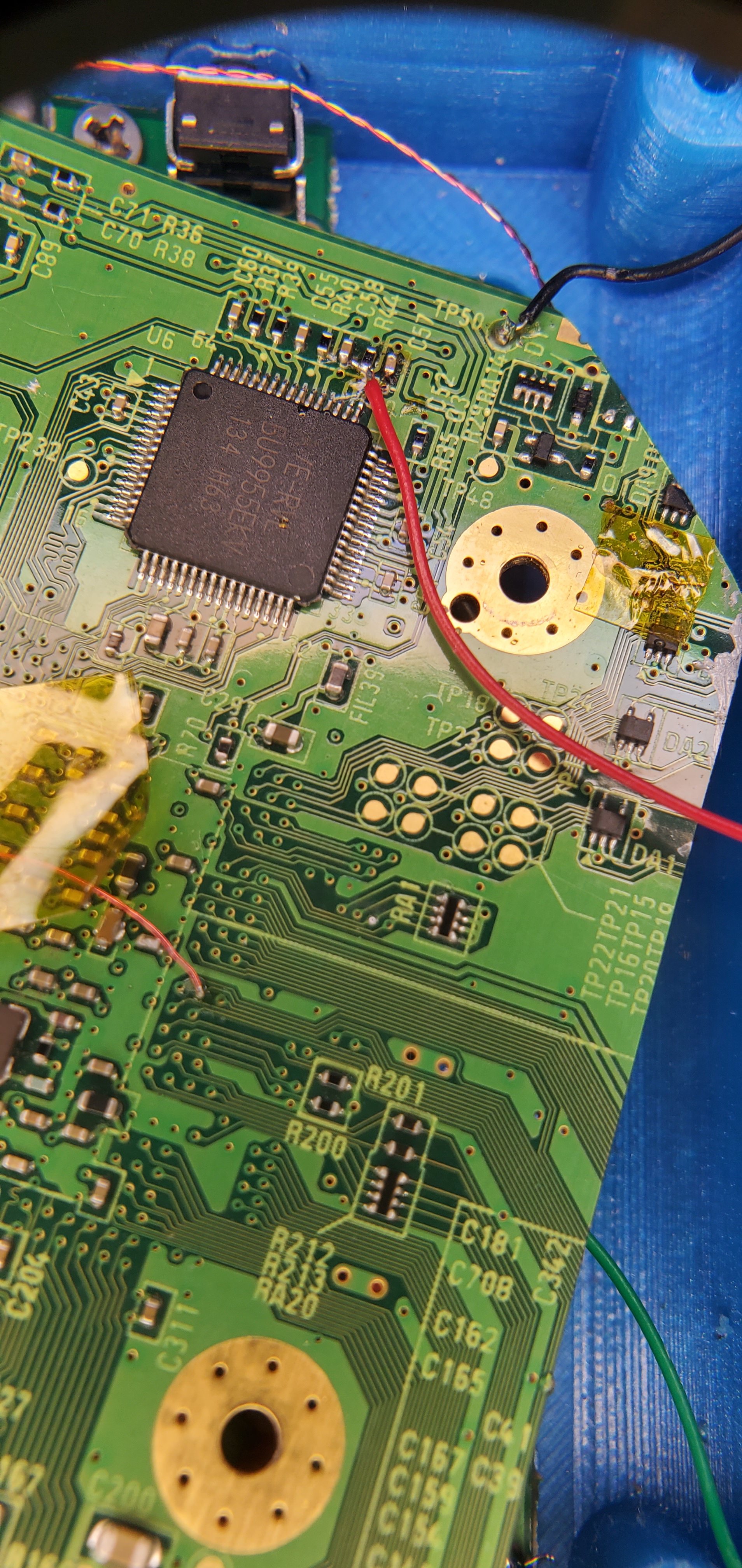

I cleaned up the solder took the wire out and I felt like I exposed the copper good enough rewired it and it didn't work so I changed to magnet wire and still nothing

Looks better. How are you testing it? I see you didnt have the joysticks plugged in.

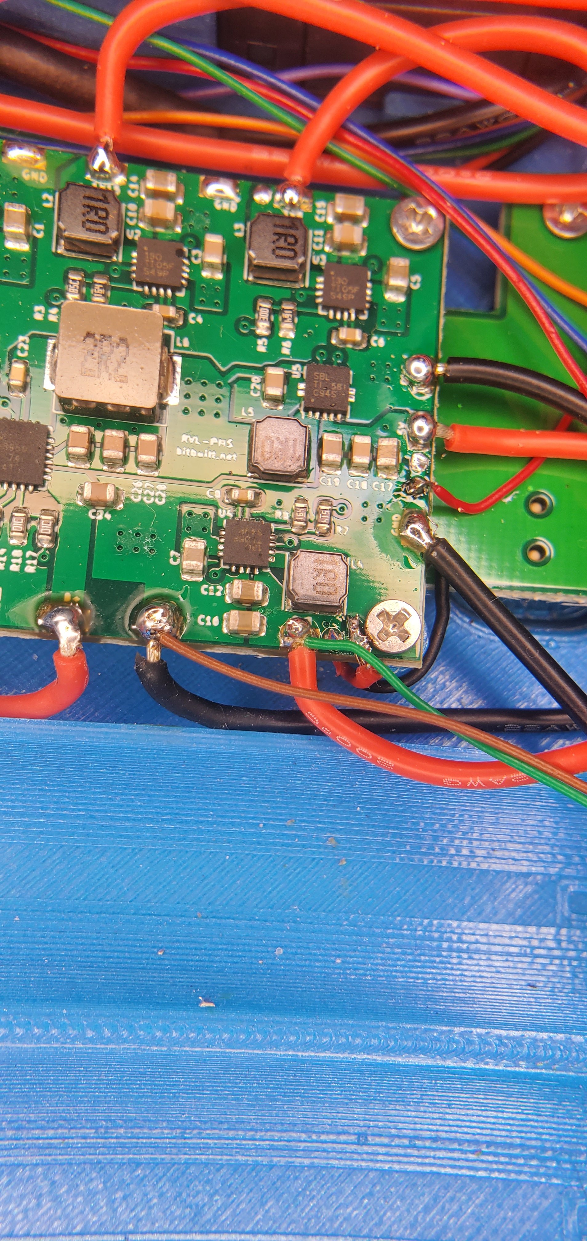

I took the joysticks off to see if there was anything wrong with the other side of the board it looked fine and I had the joysticks connected when i tried it to select a game I can't get any buttons to work I used a multimeter to check the power it checked 3.37

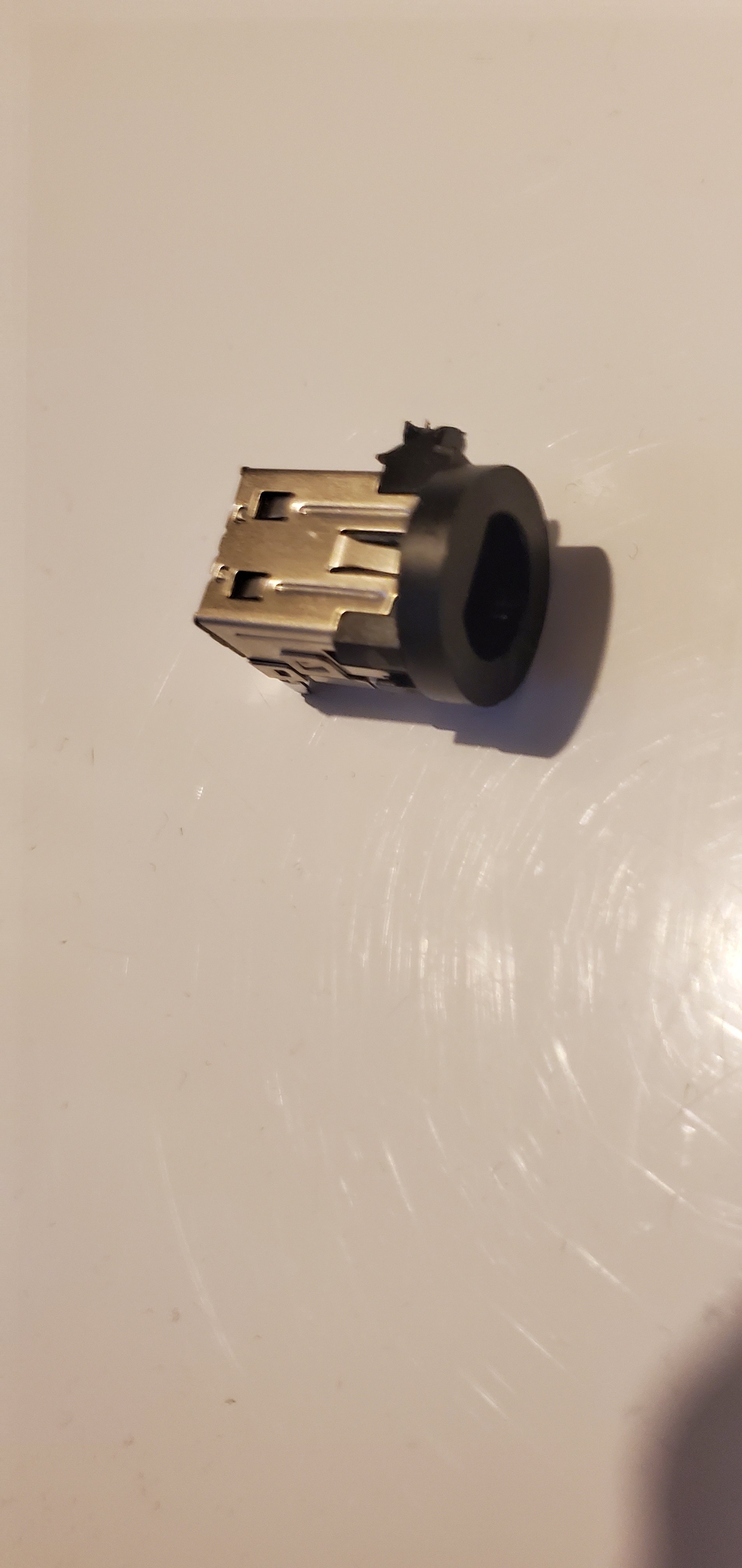

I have a controller port now. how do I wire it to the motherboard
