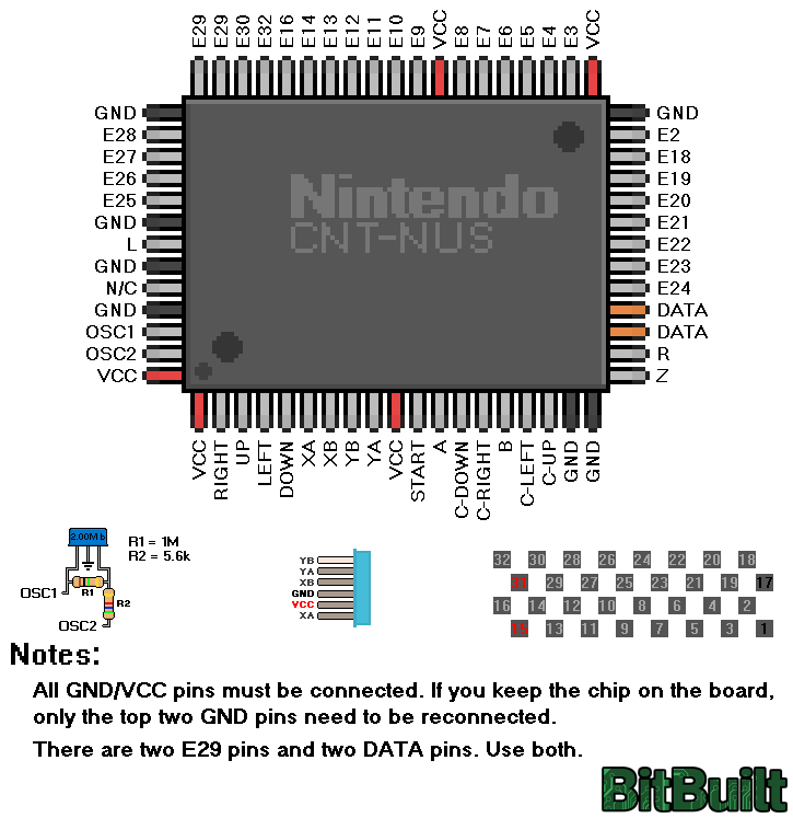

My purpose is to design new hardware for the controller, but I need to know the controller expansion protocol and right practices.
Some Chinese manufactures are making Nintendo 64 copycat controllers, so that means that the specifications of the CNT-NUS are already known outside Nintendo, also since their days are Controller + Rumble Pak's that with a simple switch change the device detected, so that mean that the specifications of the VDEC-CNT are also already known.
Someone can help me to find any info about this subjet? schematics about that mentioned Controller + Rumble Pak's? or the Transfer Pak?
