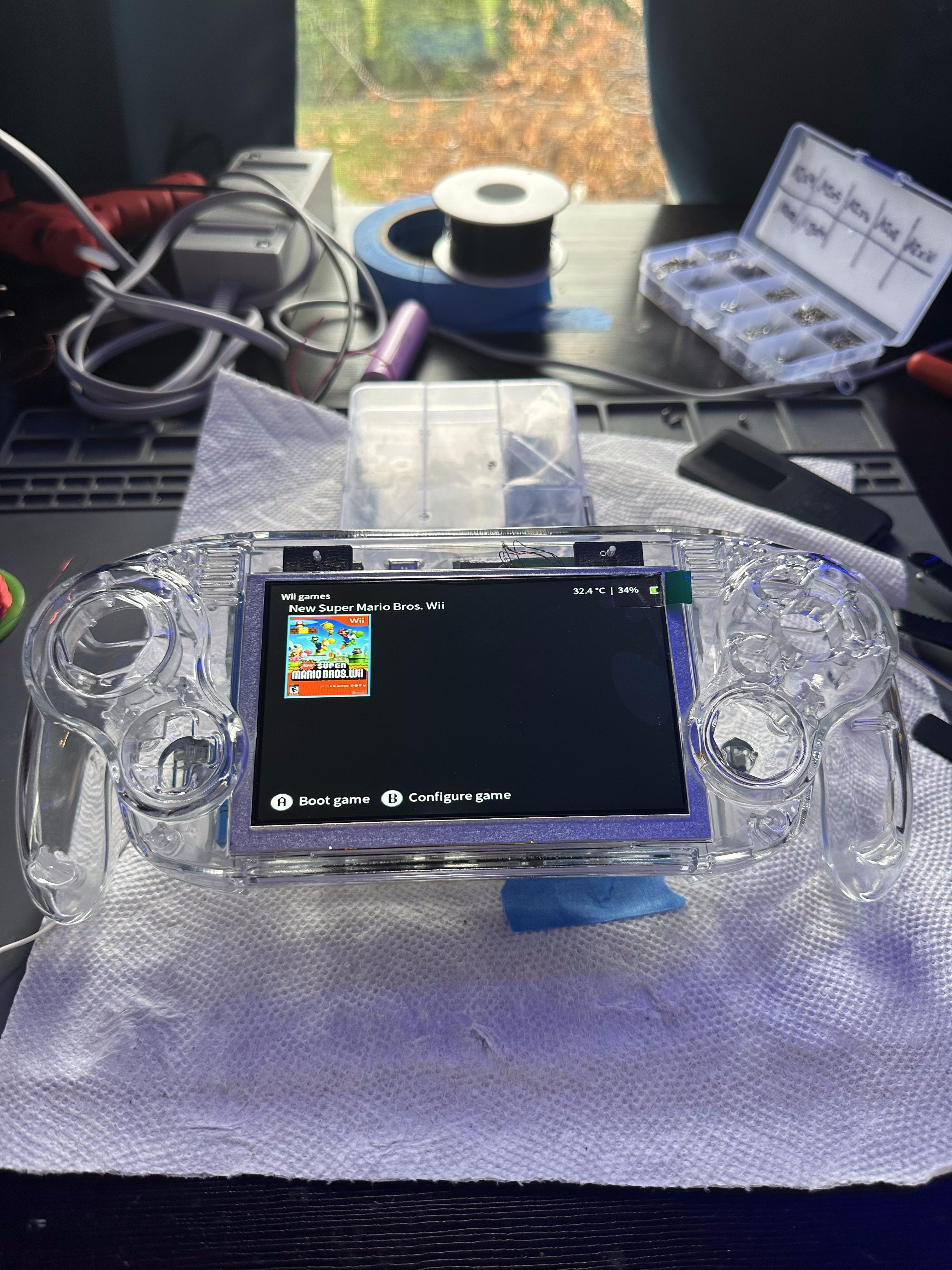

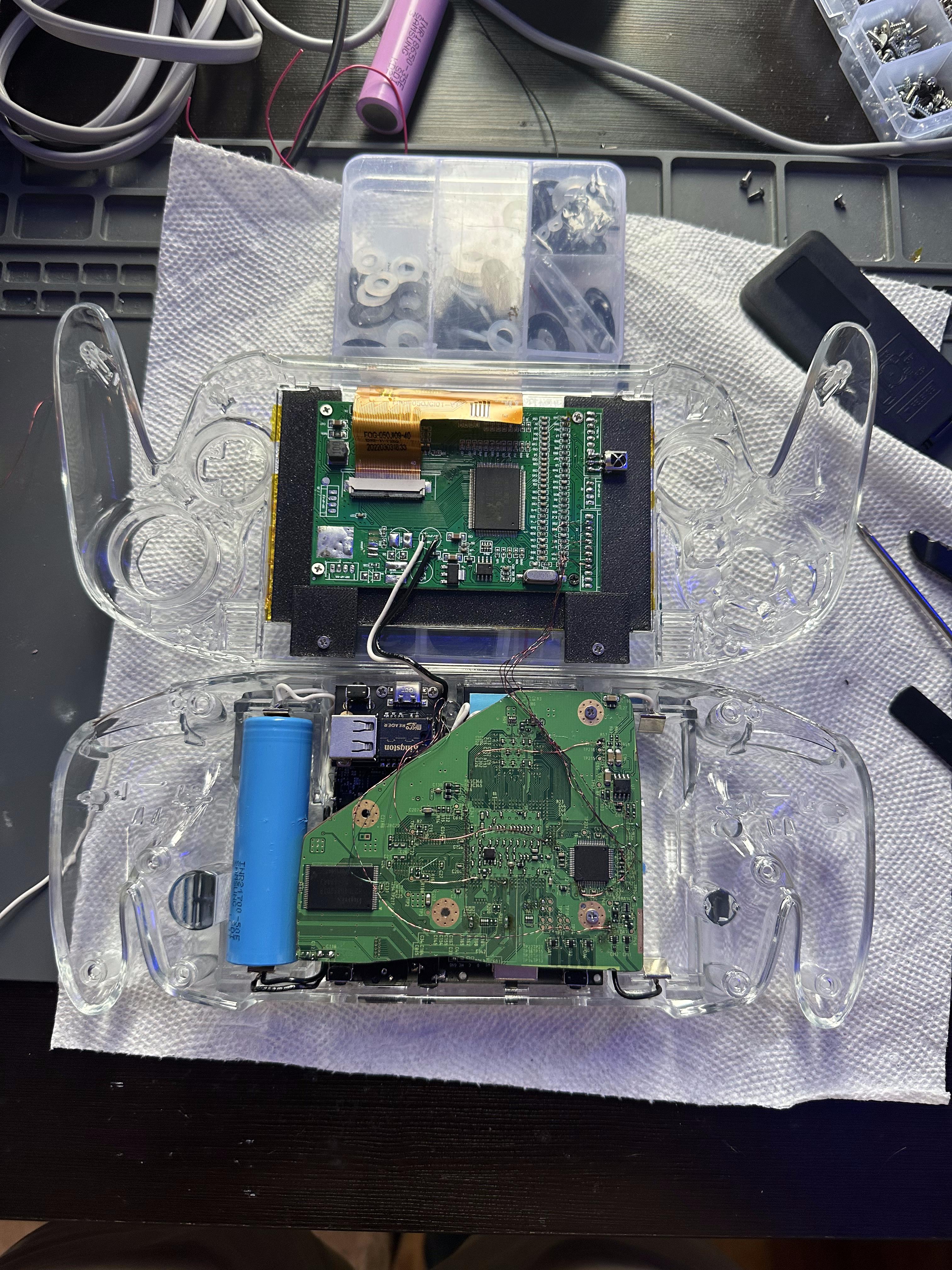

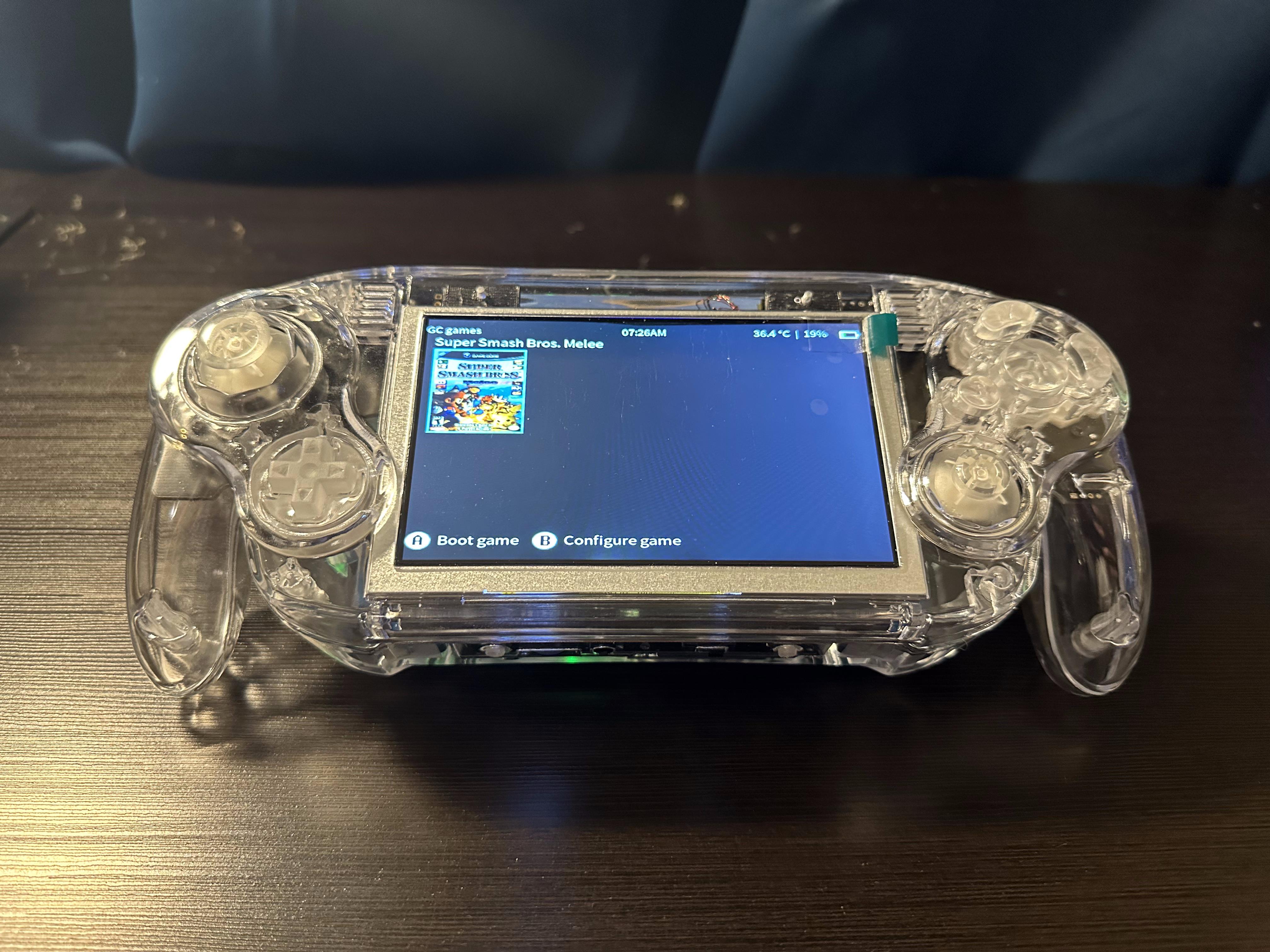

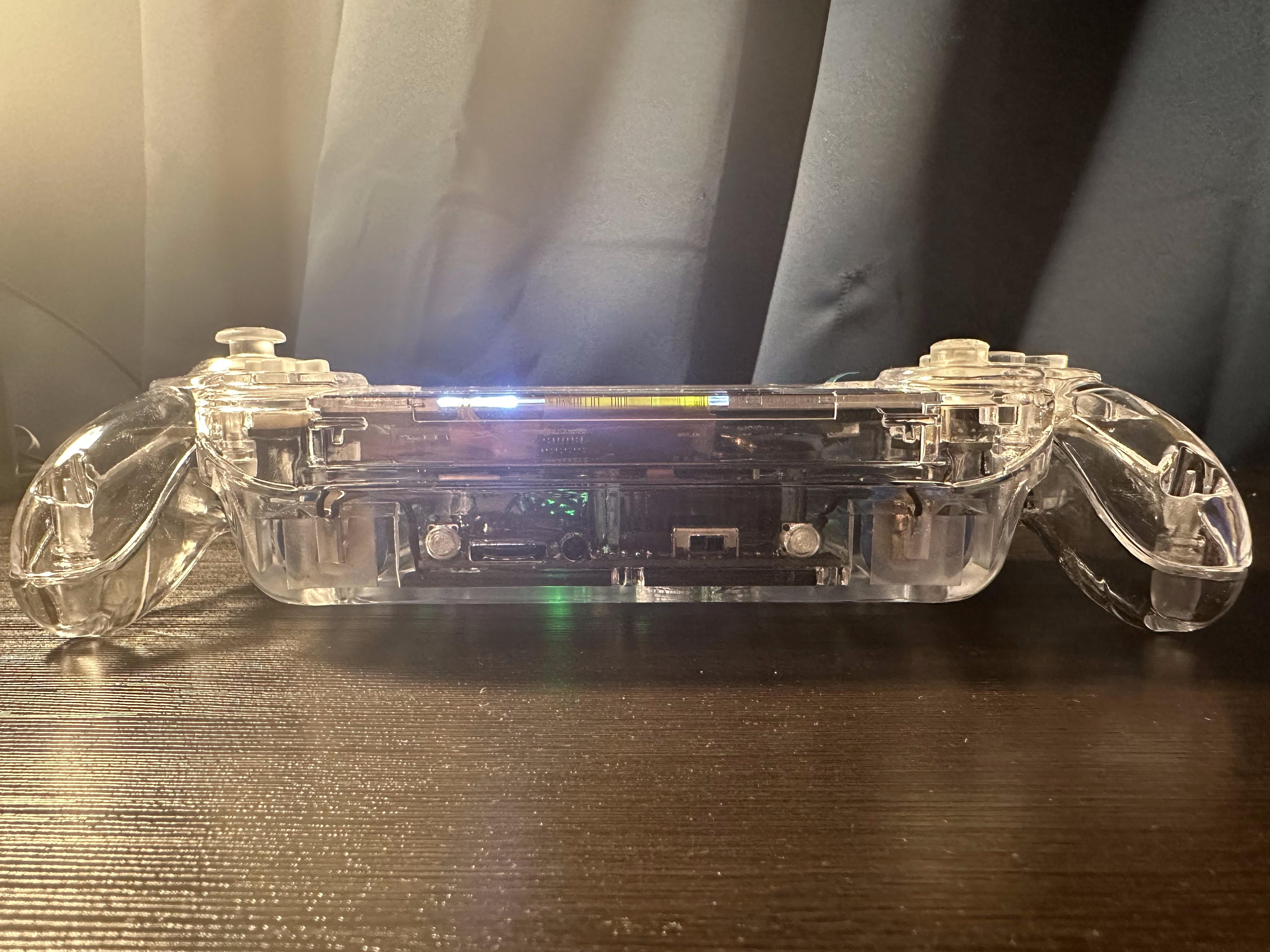

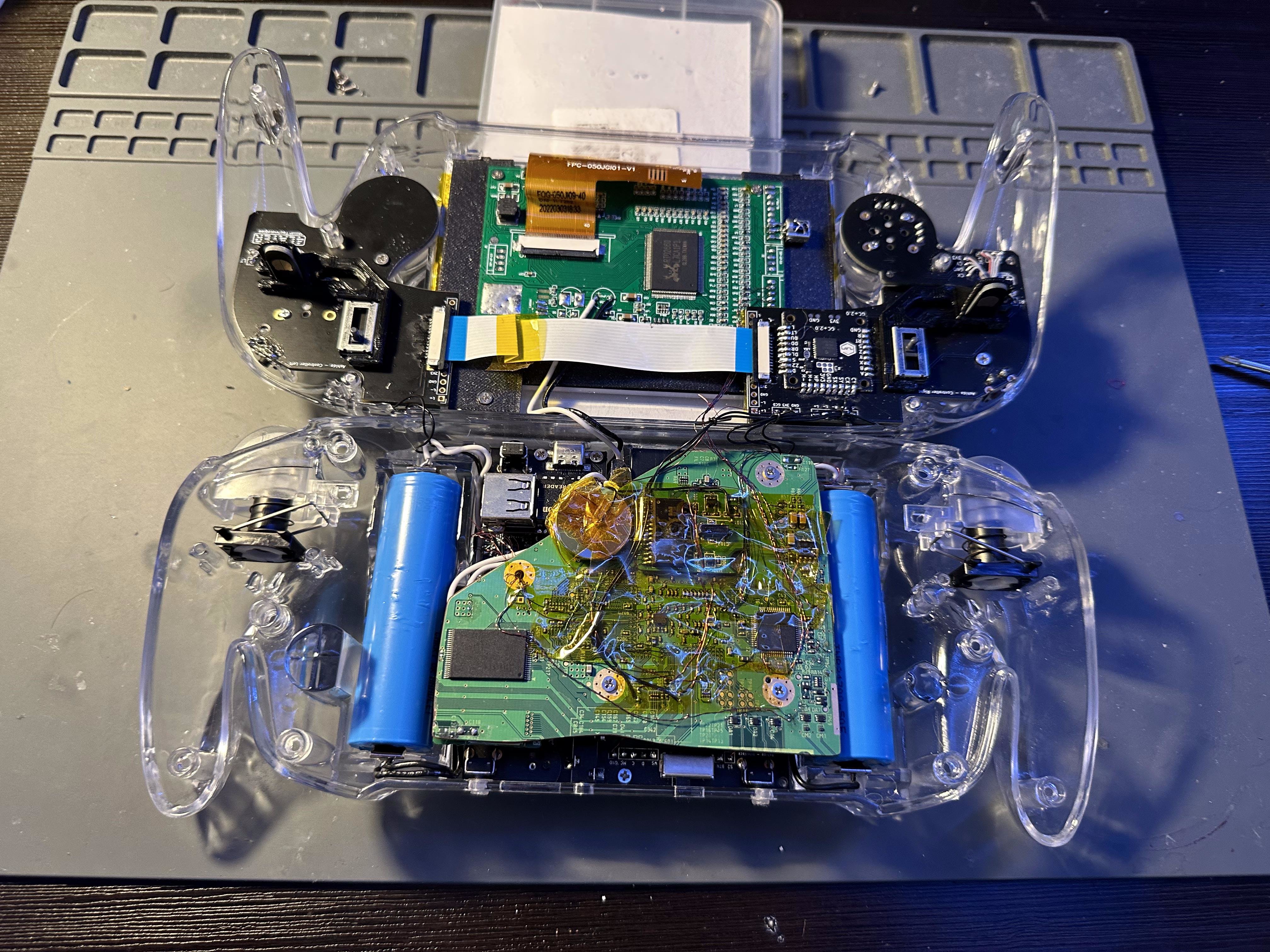

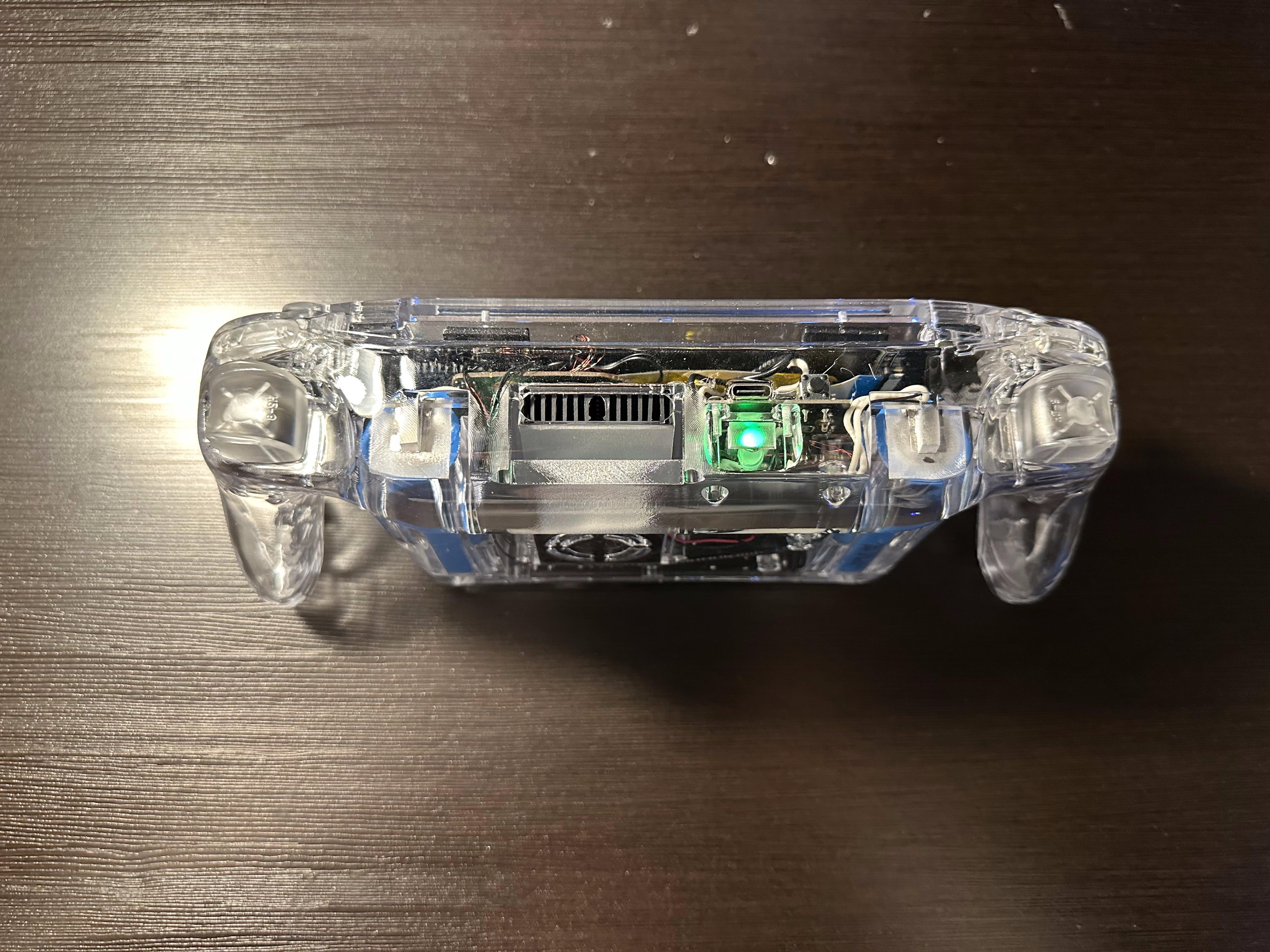

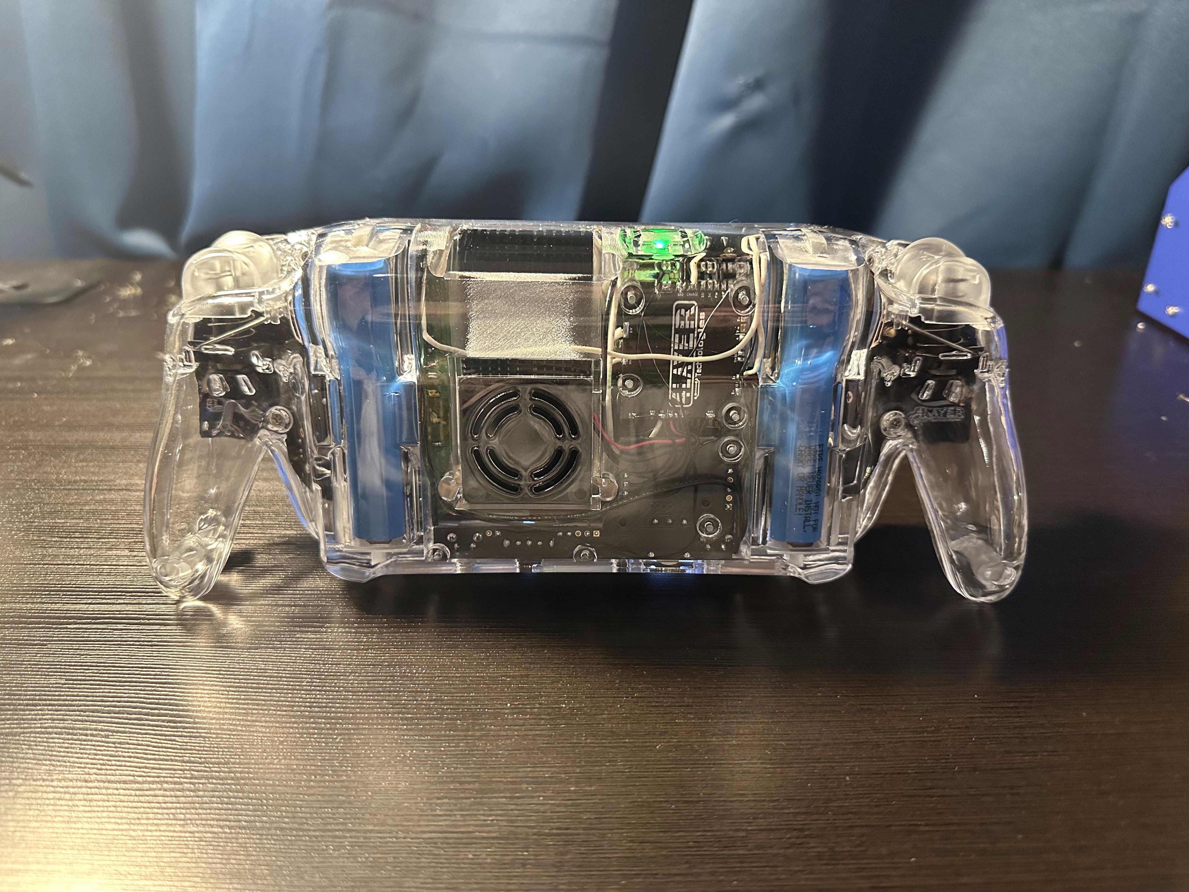

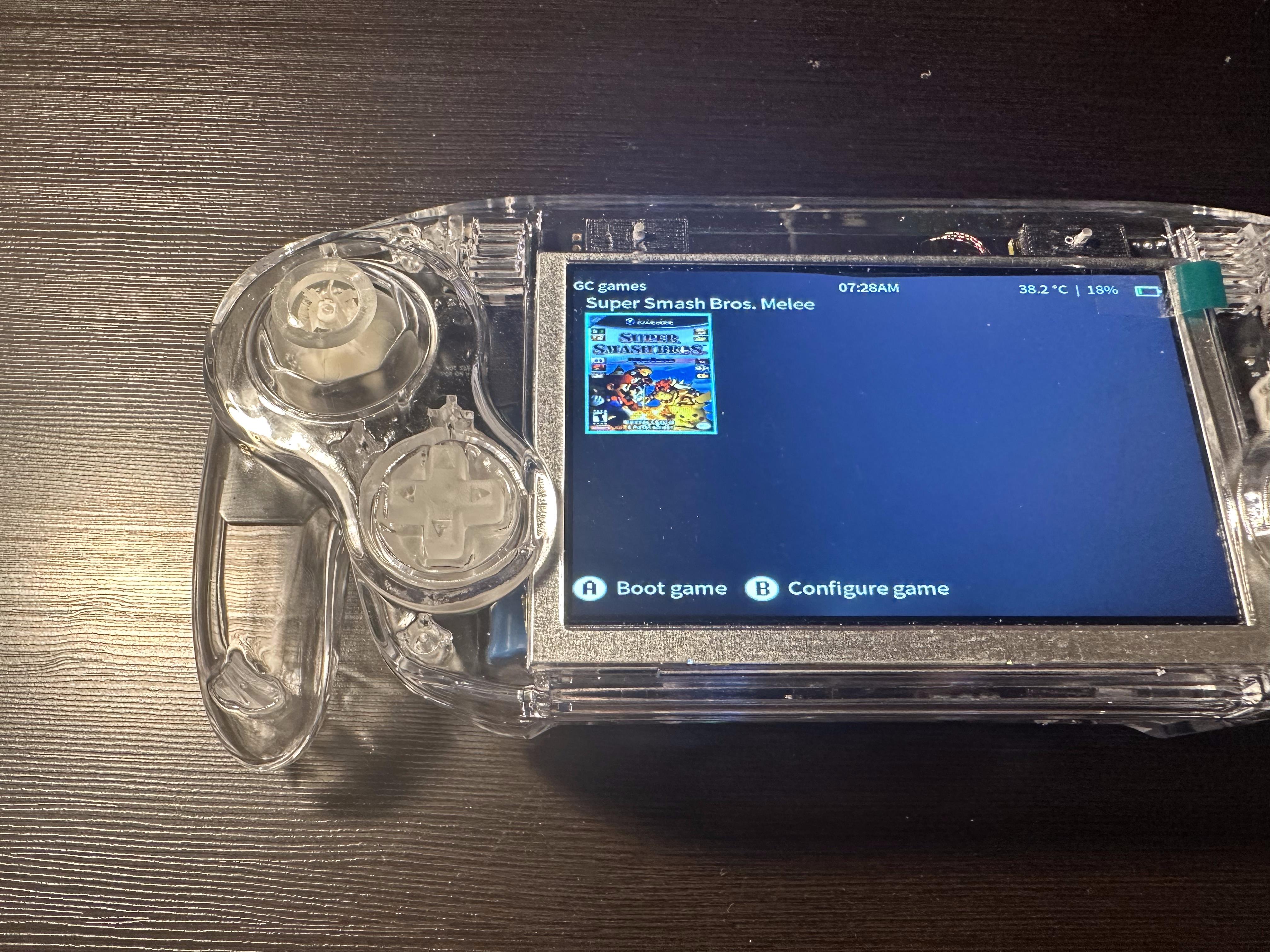

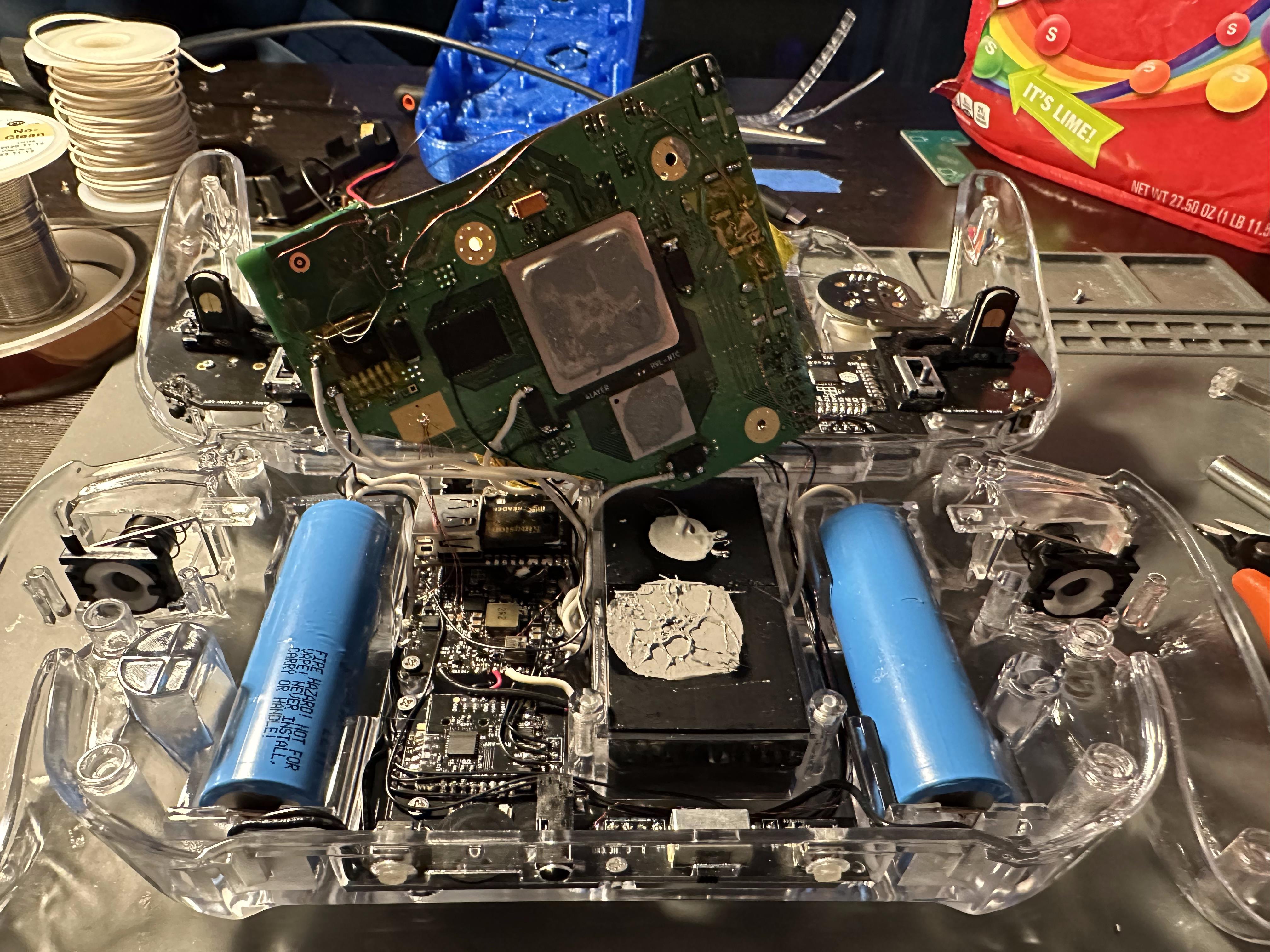

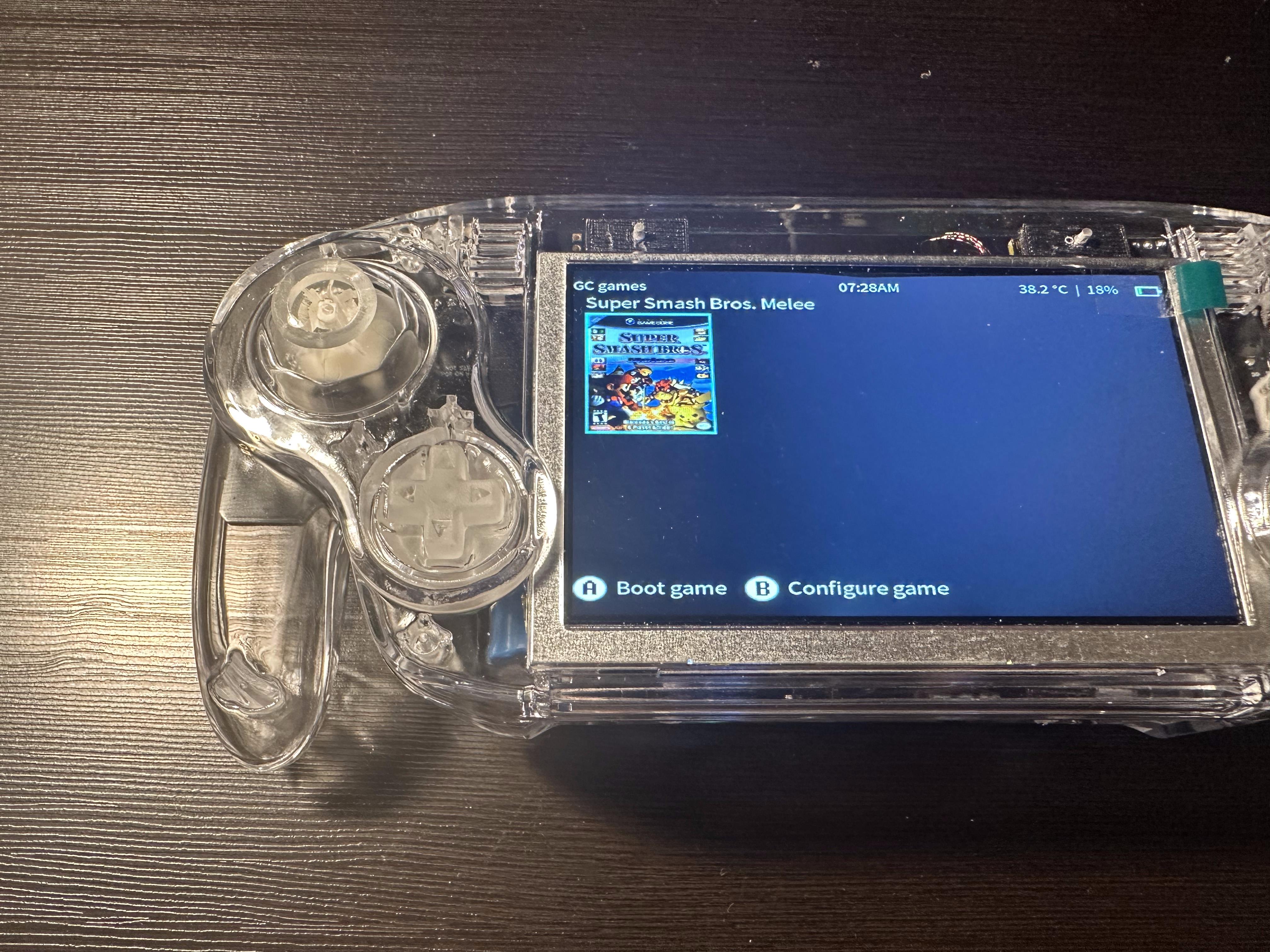

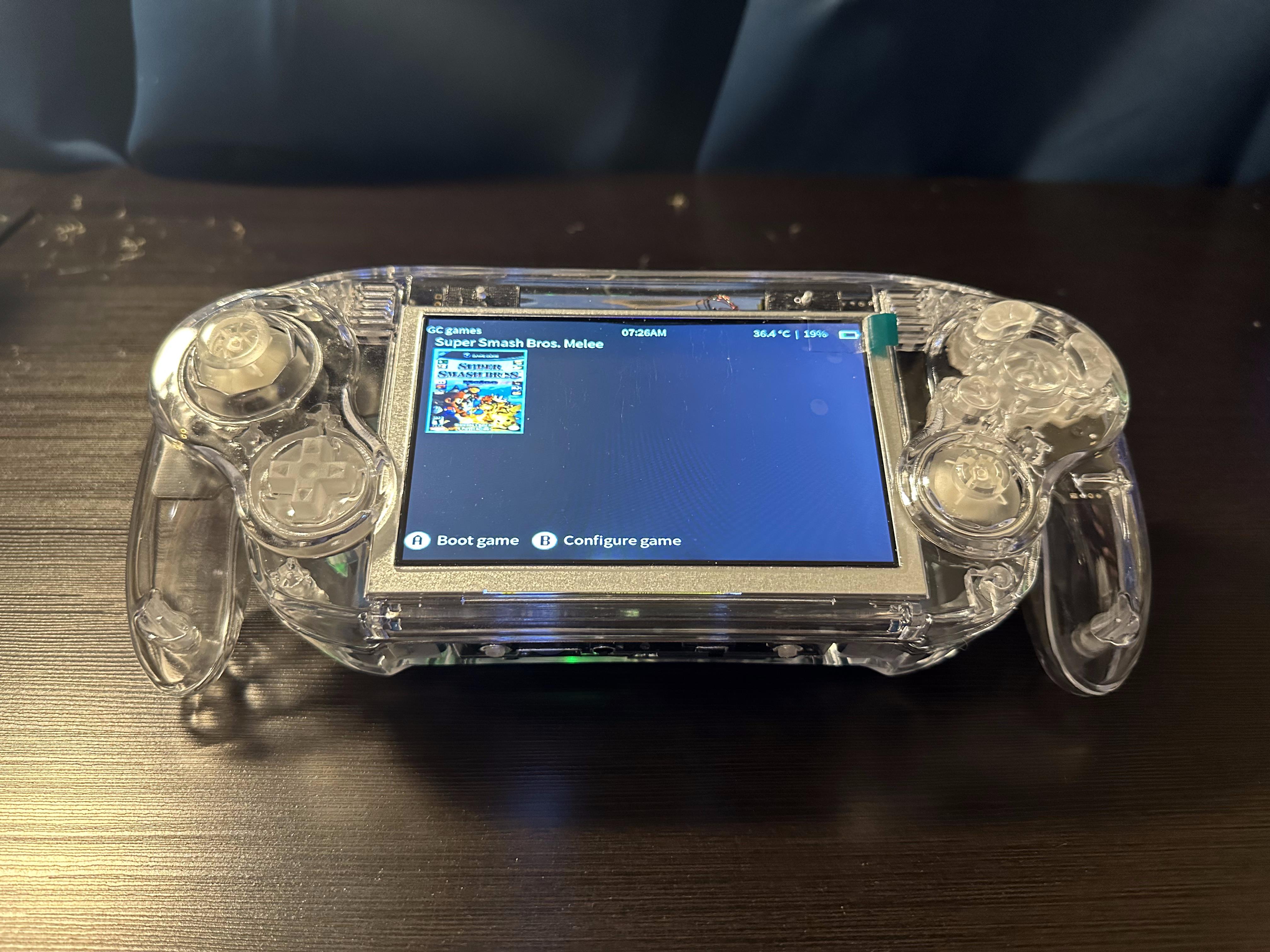

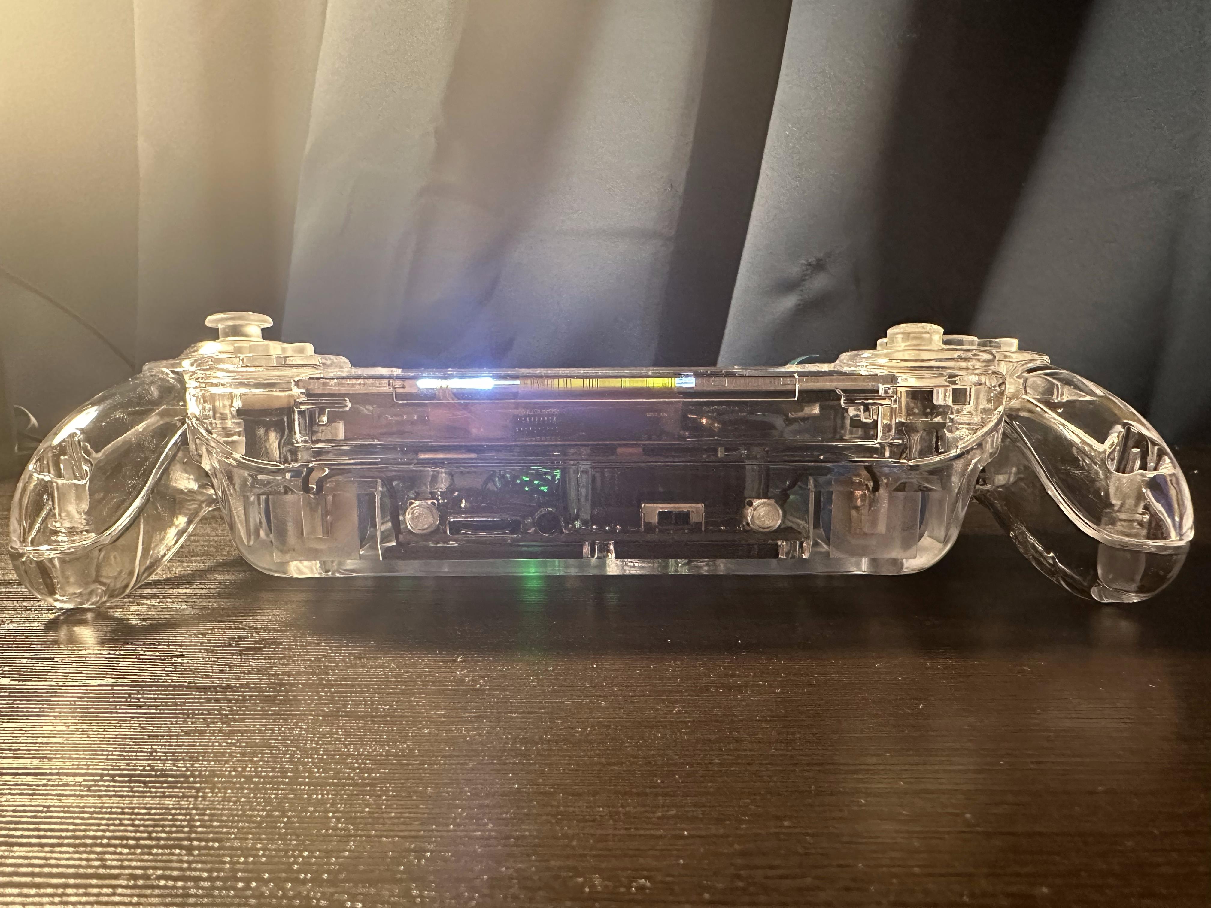

Hey guys I completed this fully clear Ashida build and I thought I'd share it since I really like the look of it. I used resin casted GameCube buttons and tried to keep the internals as clean as possible. The Ashida is such a fun build with all the streamline 4Layer Tech boards and the form factor makes it even more enjoyable to play!
Features:
Clear resin casted GameCube buttons
IPS Display
2x Samsung 21700 50E Batteries
4Layer Tech boards
T4 Stickboxes
256 GB Storage
MX Chip and Bluetooth relocated

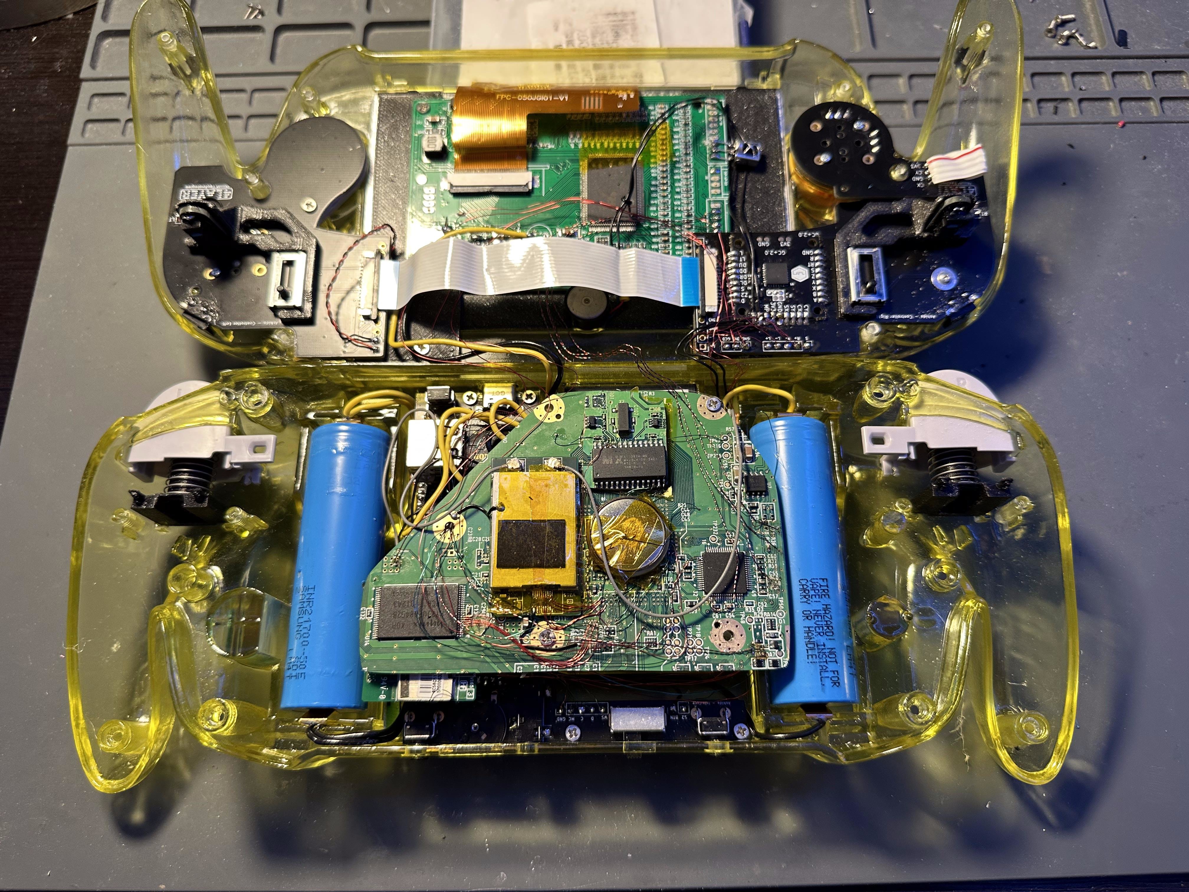

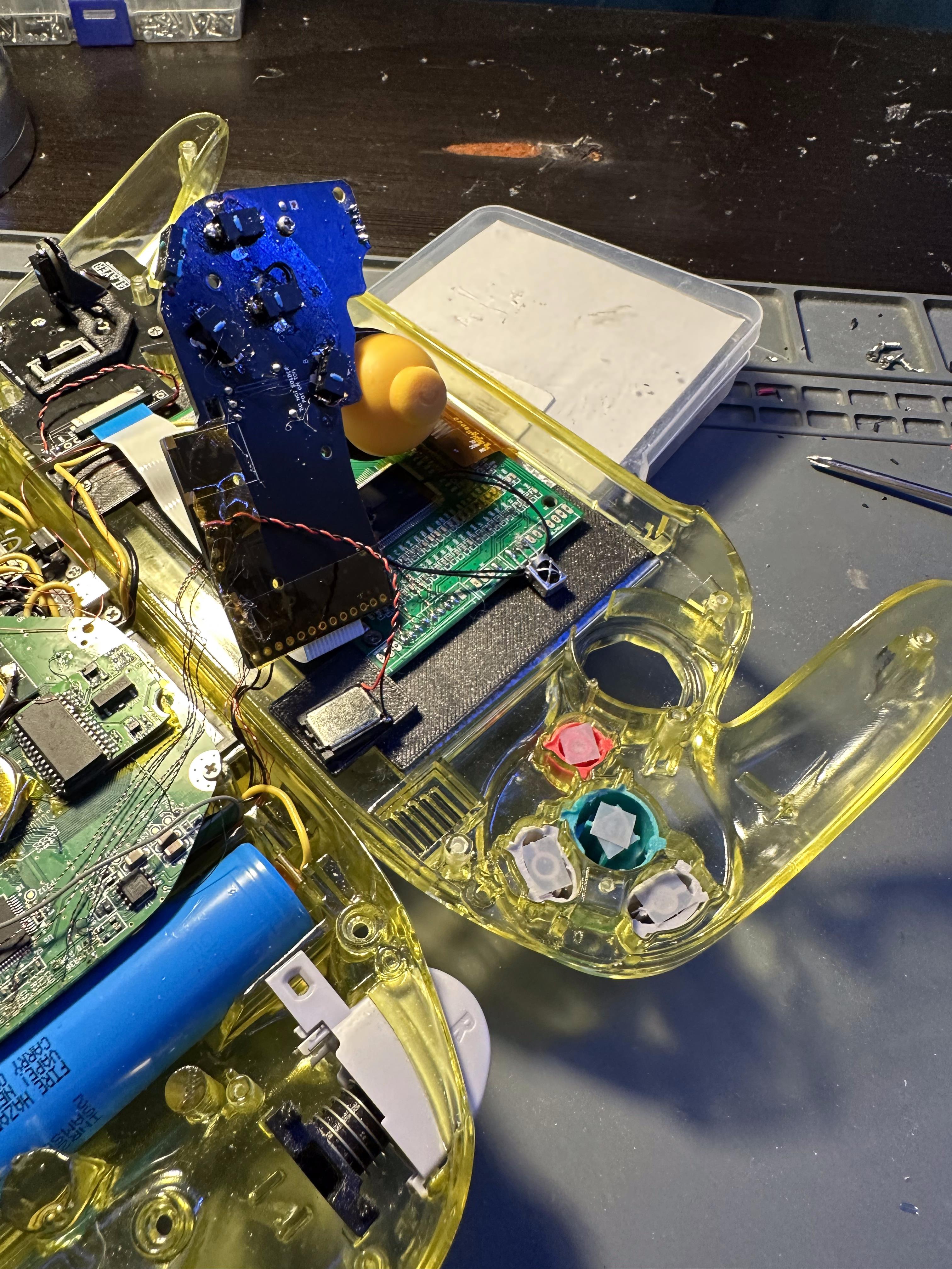

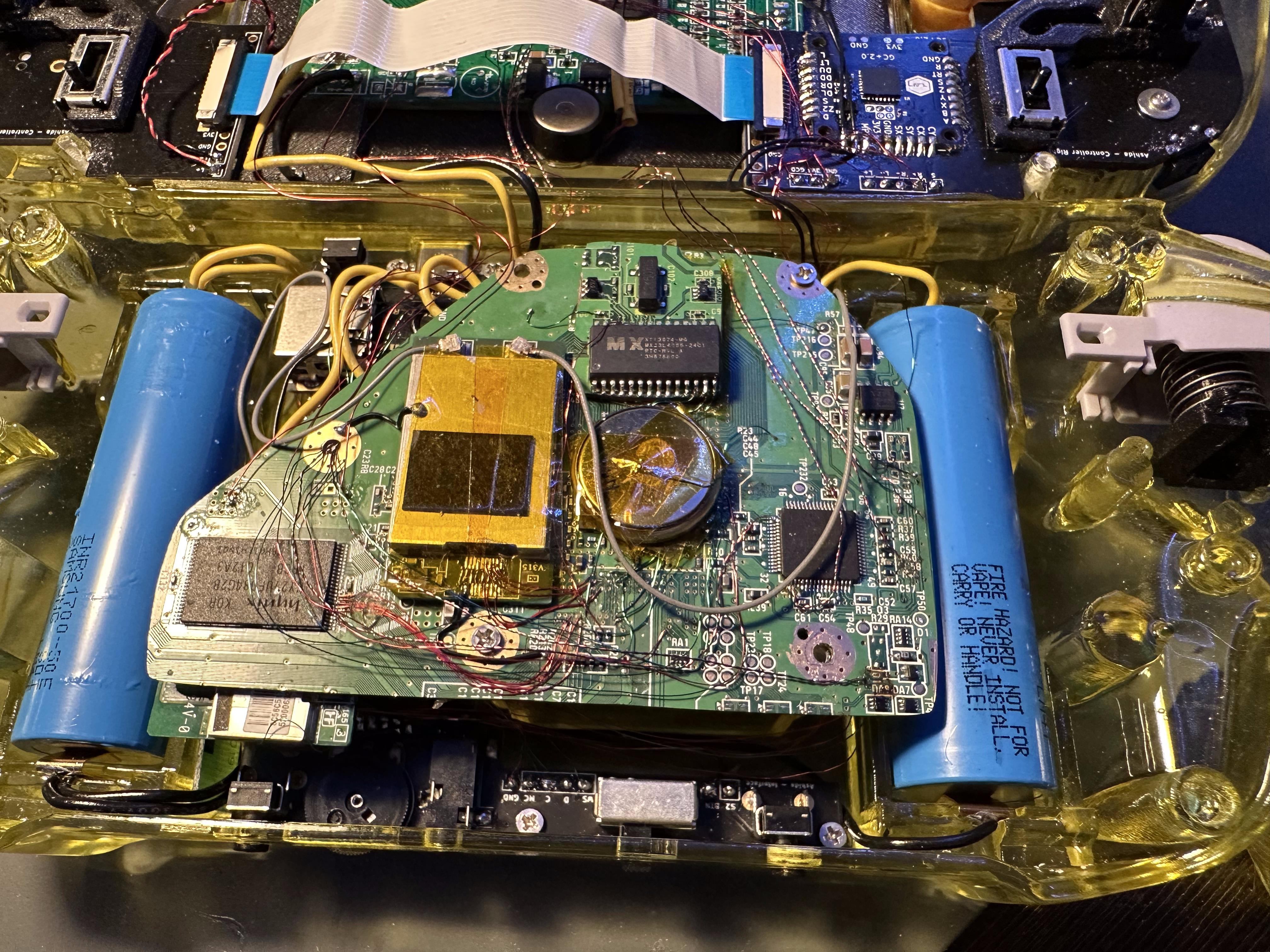

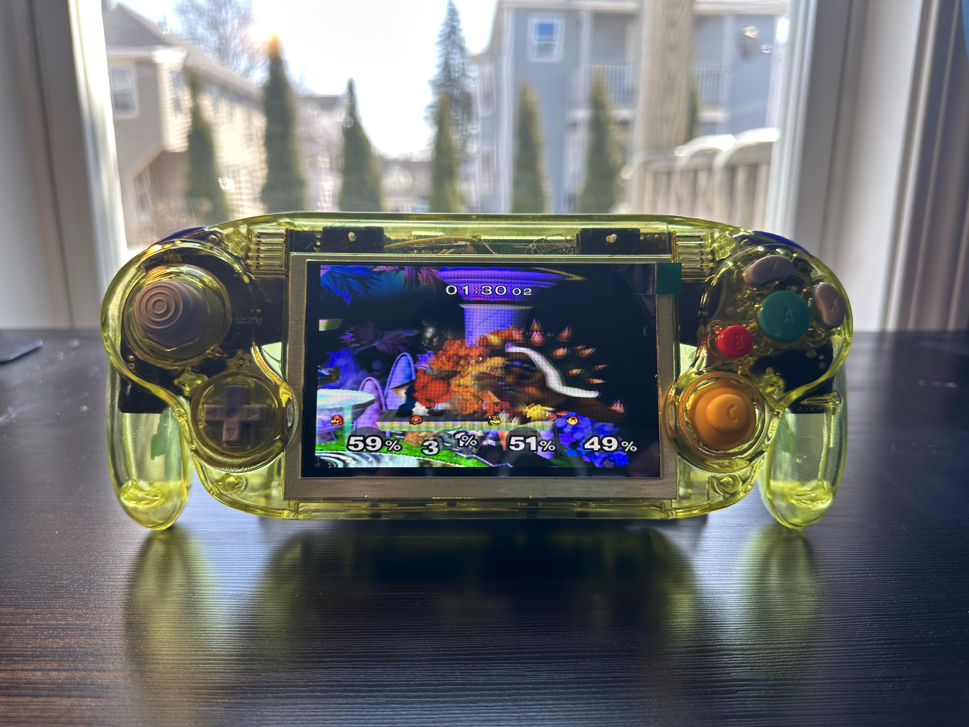

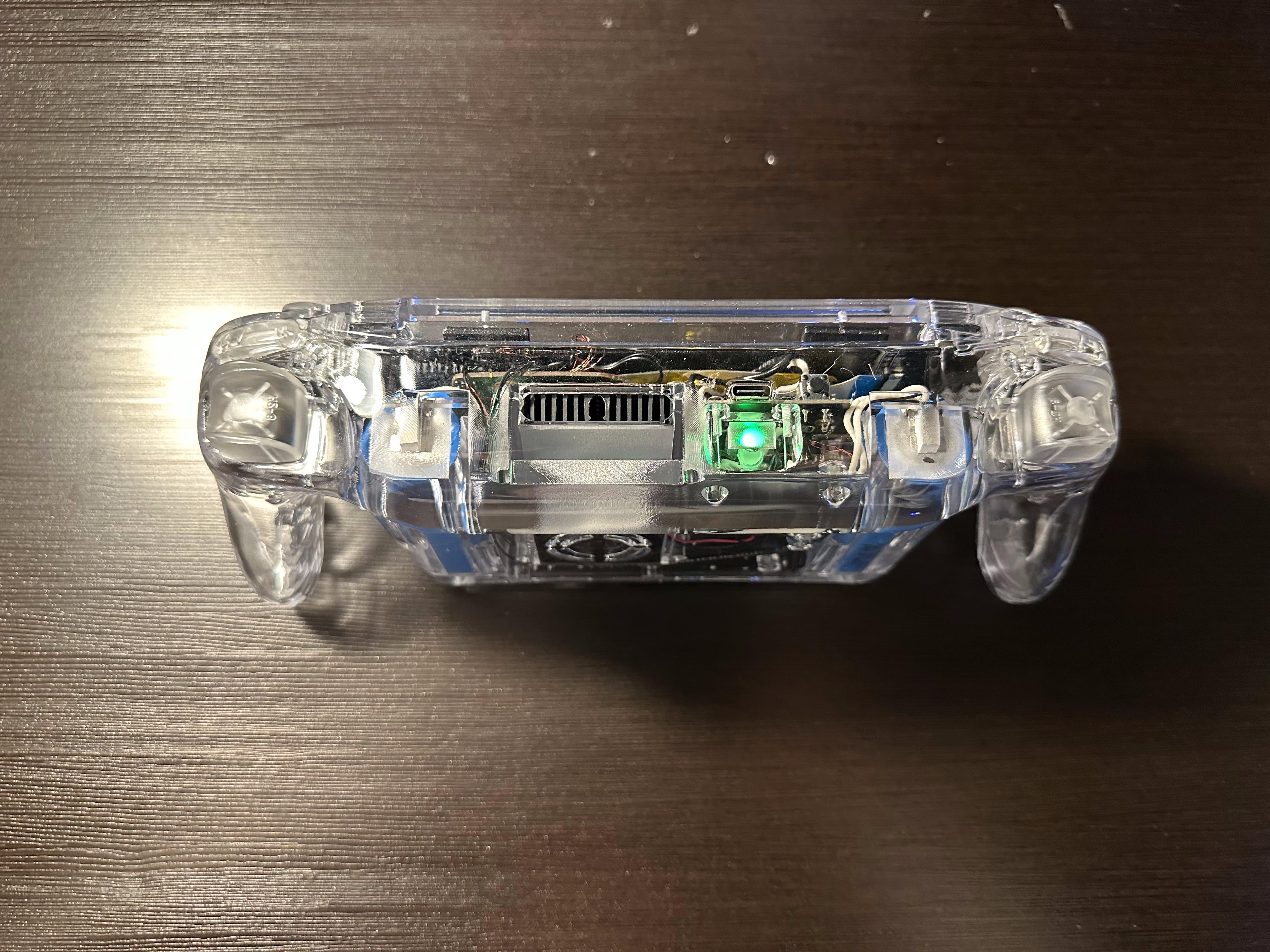

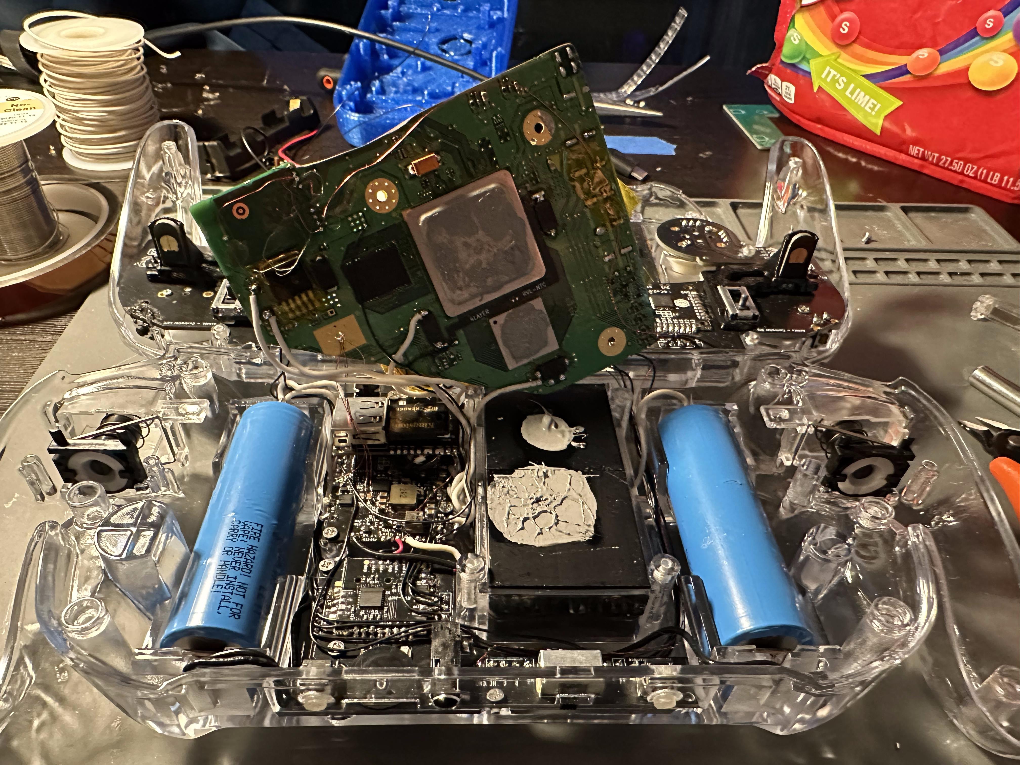

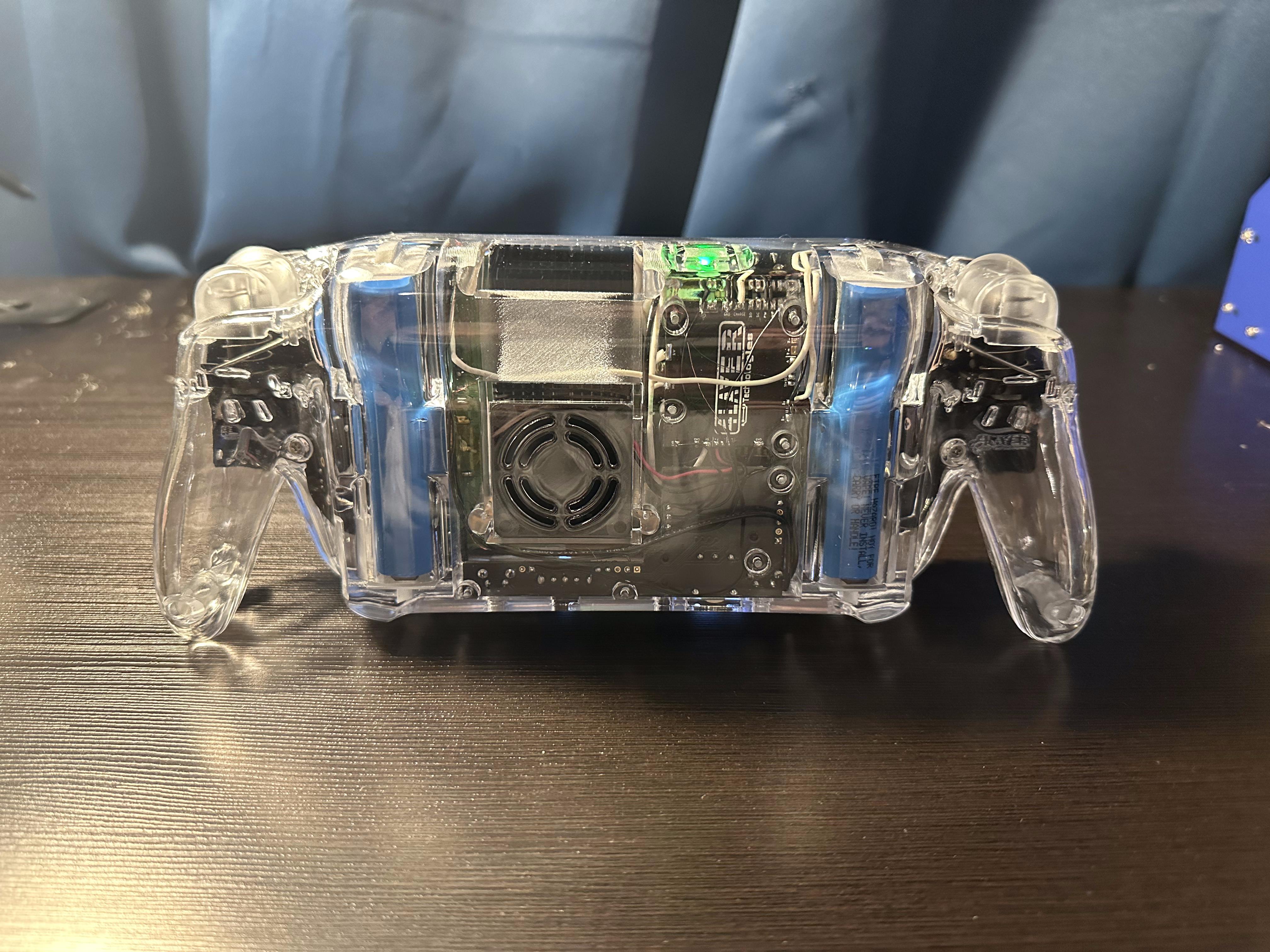

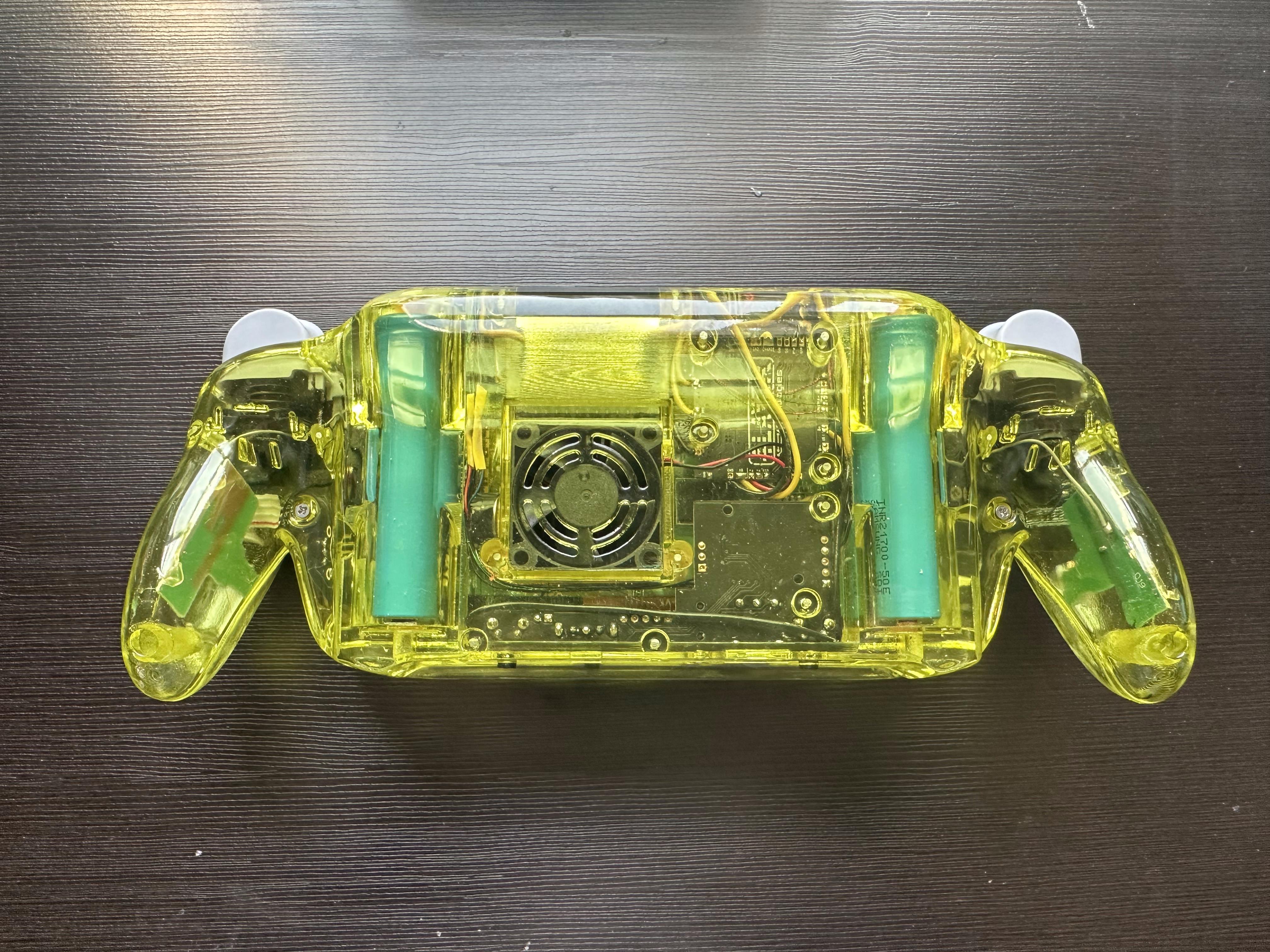

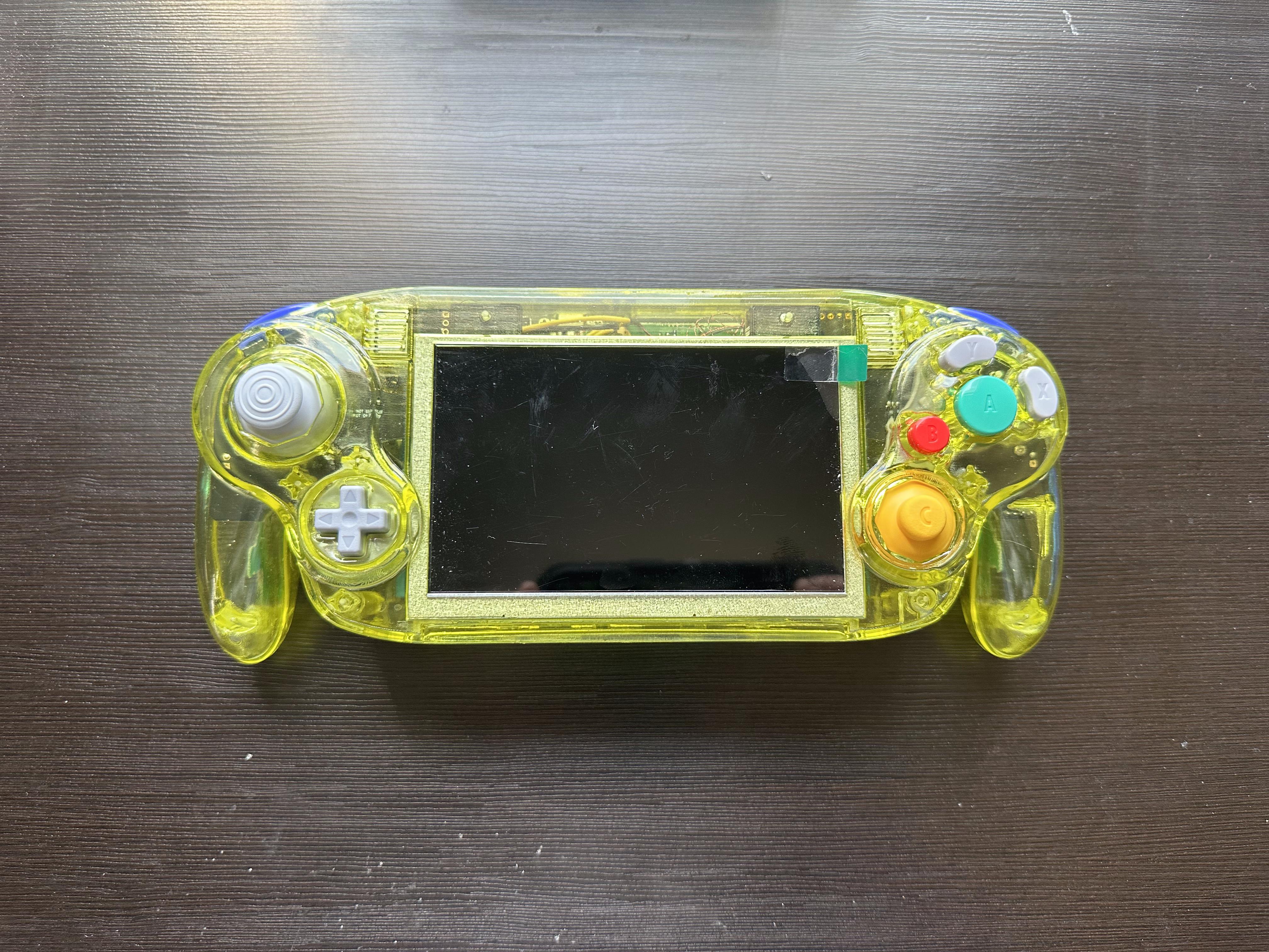

I completed another transparent Ashida this time in yellow. This one has a lot of cool features and it was a pretty difficult build and the first time I've ever included WiFi in a portable. The yellow looks really nice in person and I'm happy with how it turned out.
Features:
Original Gamecube buttons: A, B, X, Y, Z and the triggers have mouse click buttons.
IPS Display
4Layer Tech boards
T4 Stickboxes
1 TB Storage
MX Chip, WiFi and Bluetooth relocated
Rumble motors from Wii Remotes

Wow, That Clear Yellow Ashida is absolute perfection! I can feel your heart and soul in the work you put into the system.

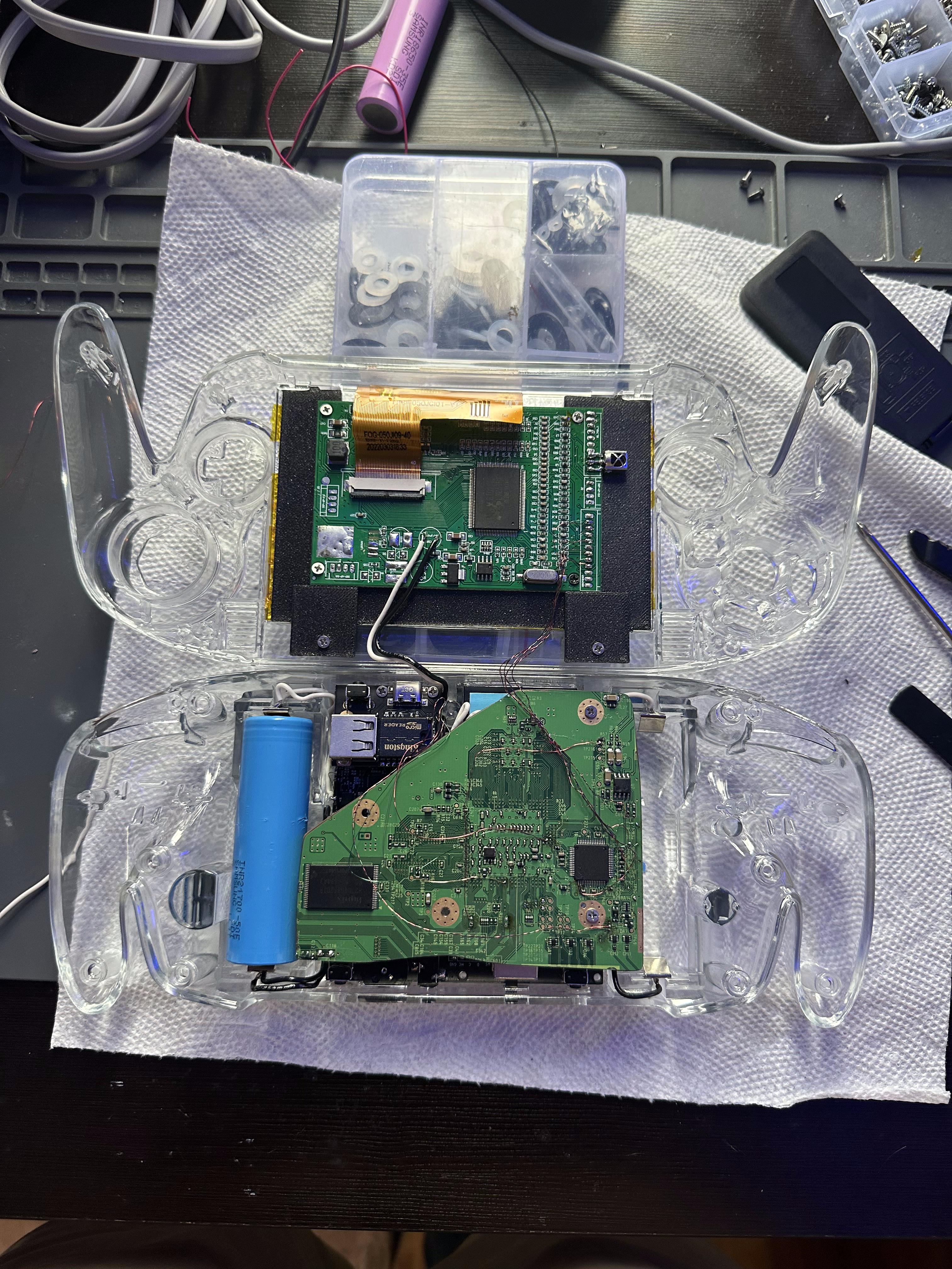

On your wii trim I noticed you're using TP47. What is that for? I'm slowly making progress on mine. I don't think I've seen a reference to that tp. Is it required?
TP stands for Test Point. Test Points are connected to voltage lines and various data lines around a system so that quality assurance and repair work can be done easily. Each TP belongs to something, in this case TP47 is connected to the Mode line which enables yPbPr/VGA video when connected to 3.3v. Using TP47 isn't required, any Mode location can be used, but it's a more convenient spot to solder a 3.3v wire to due to its size and lack of surrounding components.
Thanks, yes I understood that it stood for test point. I didn't come across any reference to what you mentioned mode location to enable yPbPr/VGA unless I overlooked it or just never noticed until now.
It's shown in the Wii Trimming Guide's Audio/Video pinouts and in the G-Boy manual. I don't blame you for not reading the G-Boy manual tho, and the Trimming Guide is a lot of colours and random info to take in the first few times you look at it. Everyone misses stuff at first

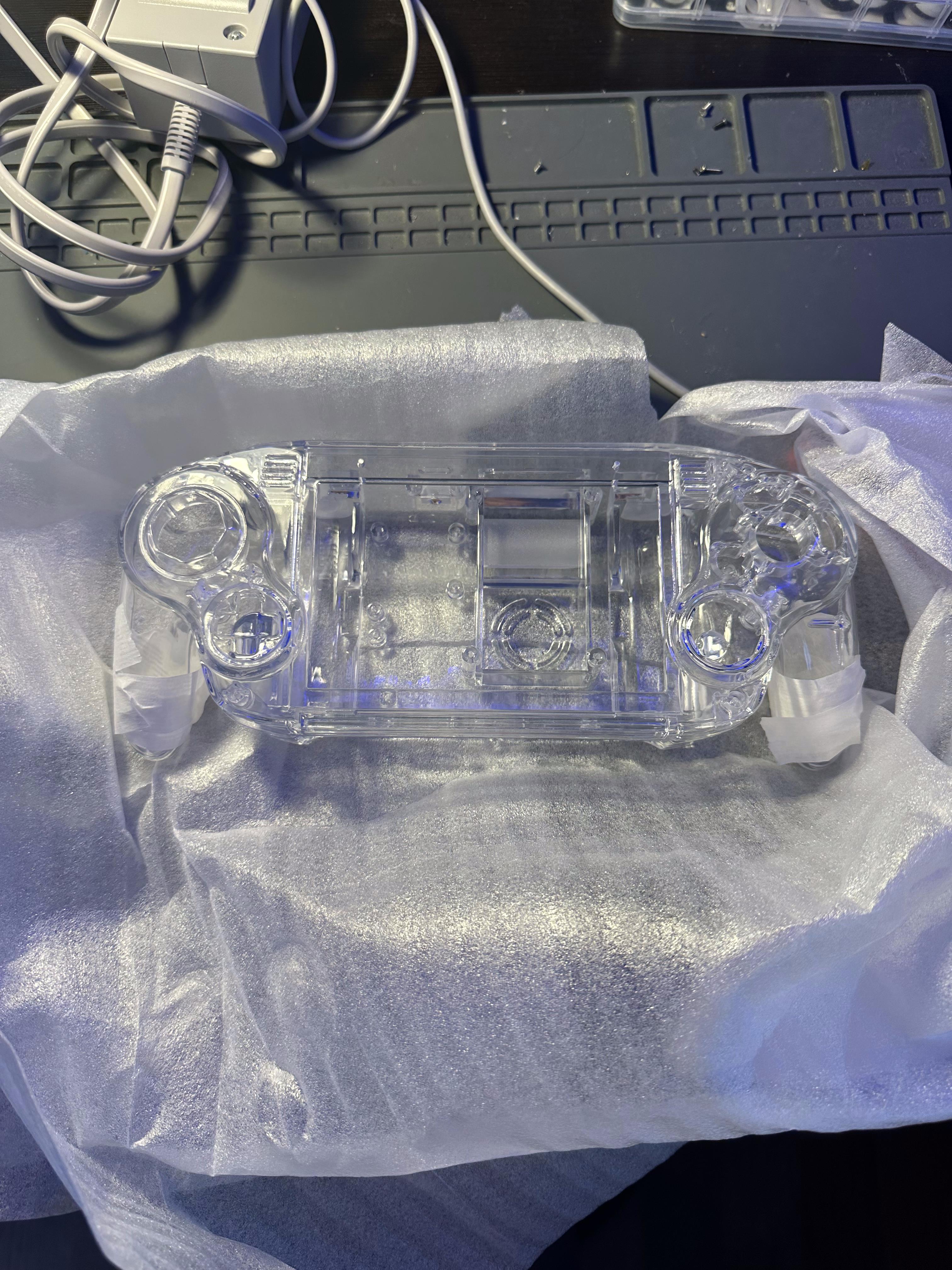

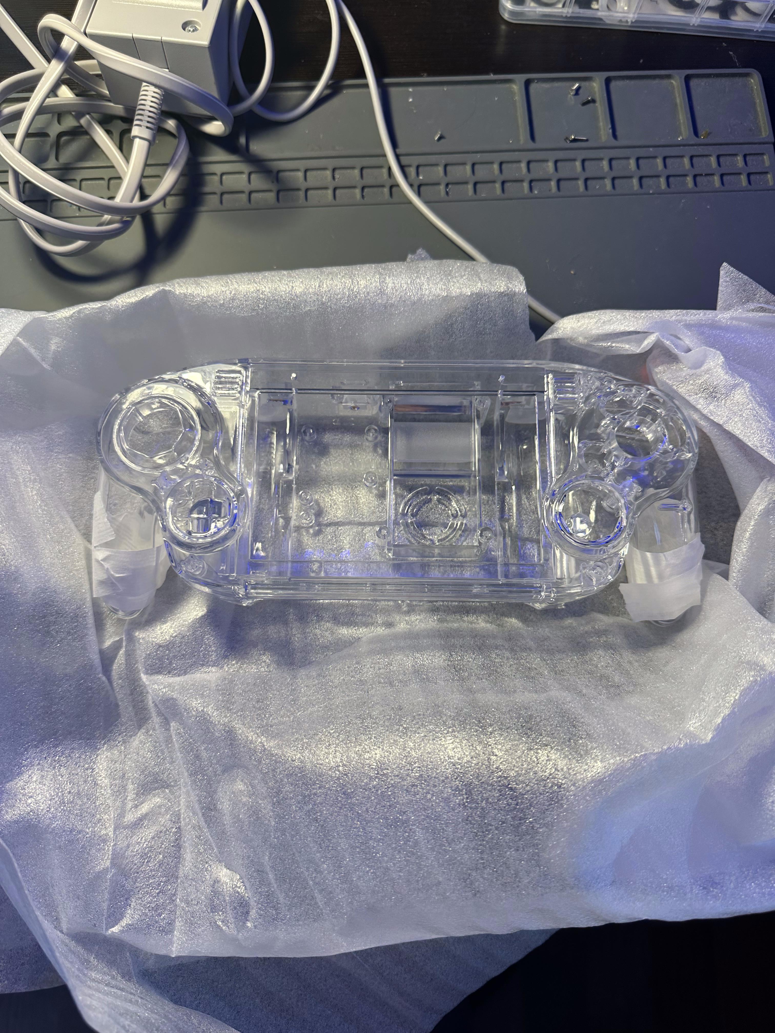

Where did you get the clear shell from????
