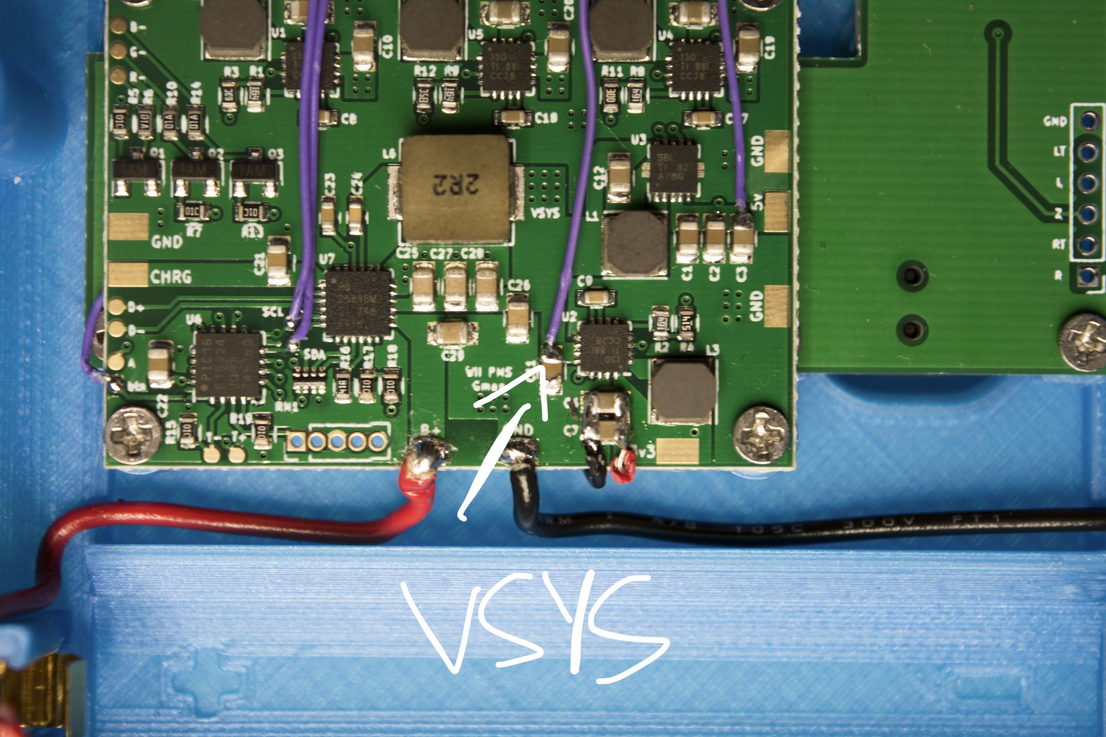

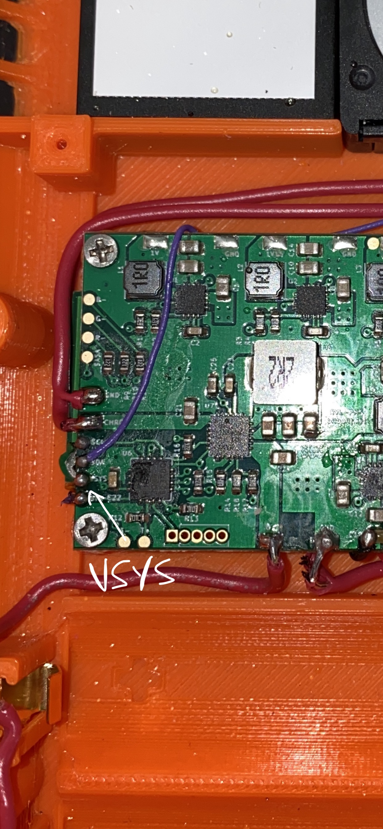

Hey all,
I've noticed a change on the RVL PMS I have vs what's used in the manual and need some guidance. In section 7, Wiring the USB, step 3 shows the location of the VSYS as being in center lower left of the board, whereas my board has a pad on the lower left corner. Images attached showing these locations. Later in section 12, step 3, the manual says to run a wire from "one of the capacitors on the VSYS plane" to the power pad on the RGB board. My question is with where my VSYS connection is, which capacitor should I connect the RGBs power to?
We've added additional pads to make it simpler to solder multiple voltage lines. There is another VSYS pad for the LED right next to the RGB pads.
