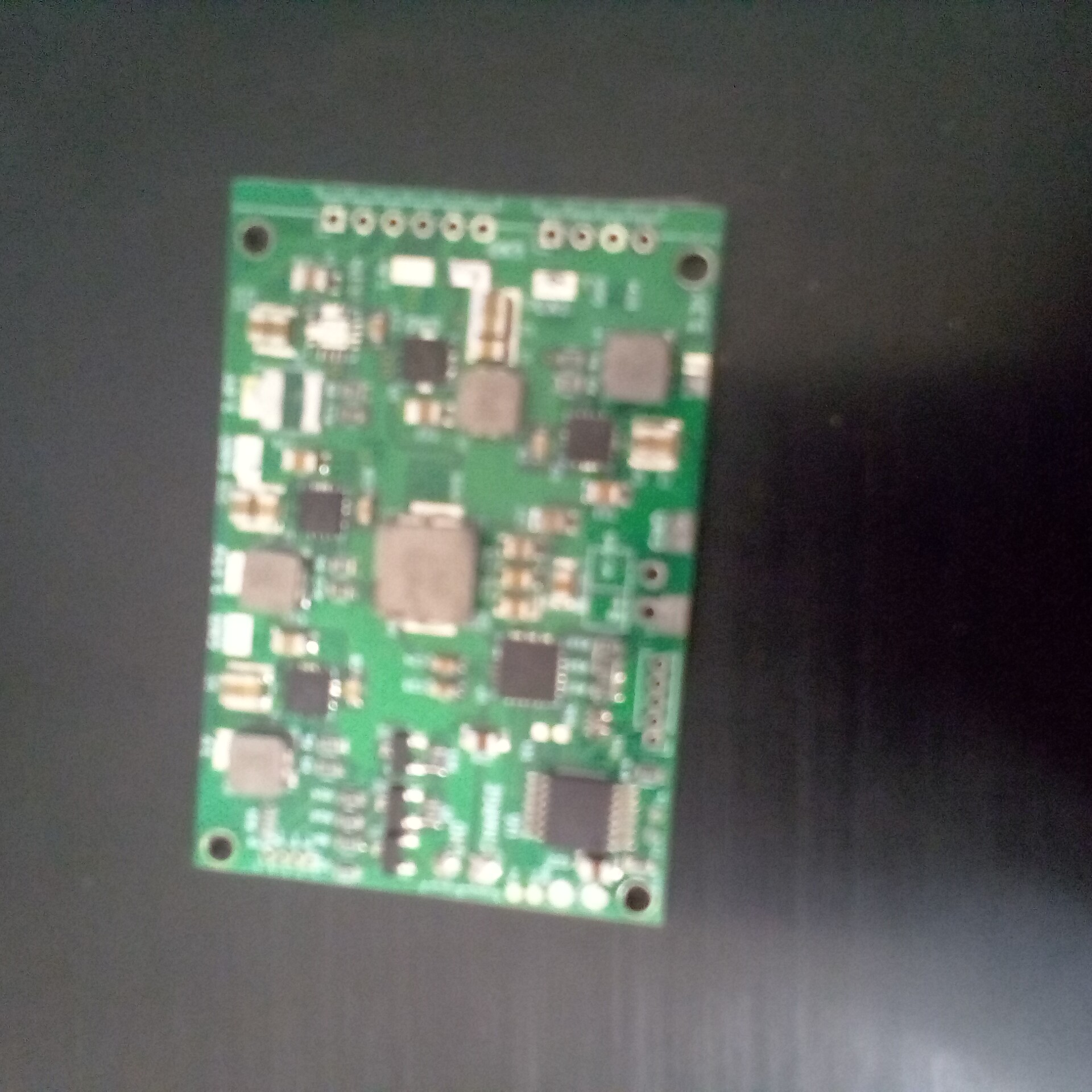

i have this pms board here idk wha type butjust wondering if i wasted my money on this
i was acctually wondering if it works with the modern $ layer boards
ok wasnt judging u just wondering

It does not. Ohkin's boards are reproductions of the old opensourced 1.0 version of the PMS. The current 4layertech 2.X designs use different parts and a different protocol. They are not inter-compatible in any arrangement AFAIK. Also worth noting, that 1.0 PMS does not have reverse polarity protection. If you wire your cells in backwards, it will kill the PMS.
Be sure to double check everything before connecting the cells.
What are so different about the protocols i have the Dustin pcbs for the gc+ and rvl amp
so theoretically it should work with the pms 1.0
Sorry, I should have been more specific. The GC+ and AMP boards will work fine, it's the current generation PMS and PD modules specifically that are not compatible with each other across generations. You can't use a PD2 or PD3 with the 1.0 PMS, and can't use the old 1.0 PD module with a current generation PMS or PMSLite.
