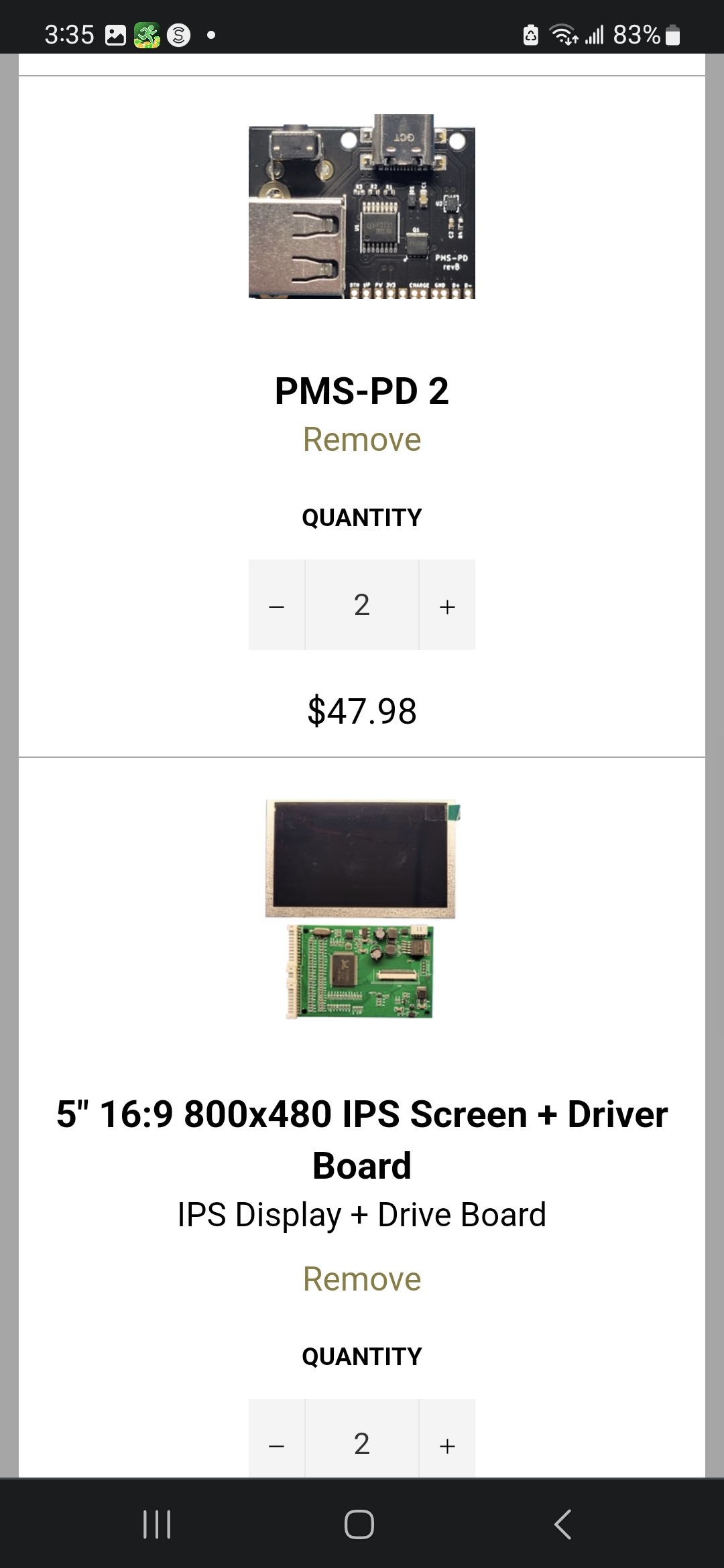

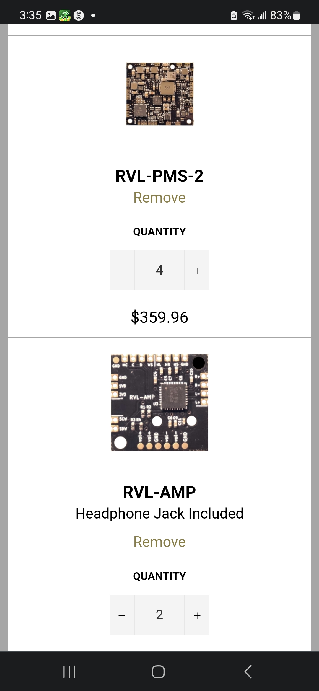

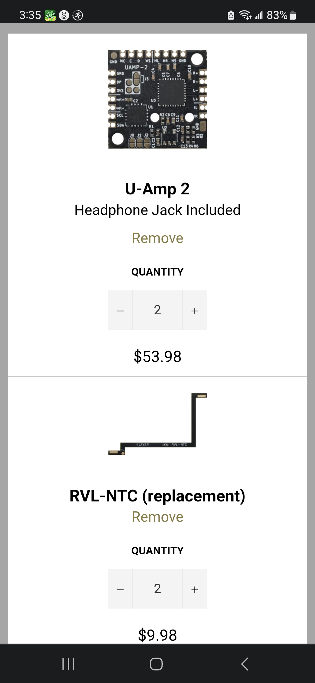

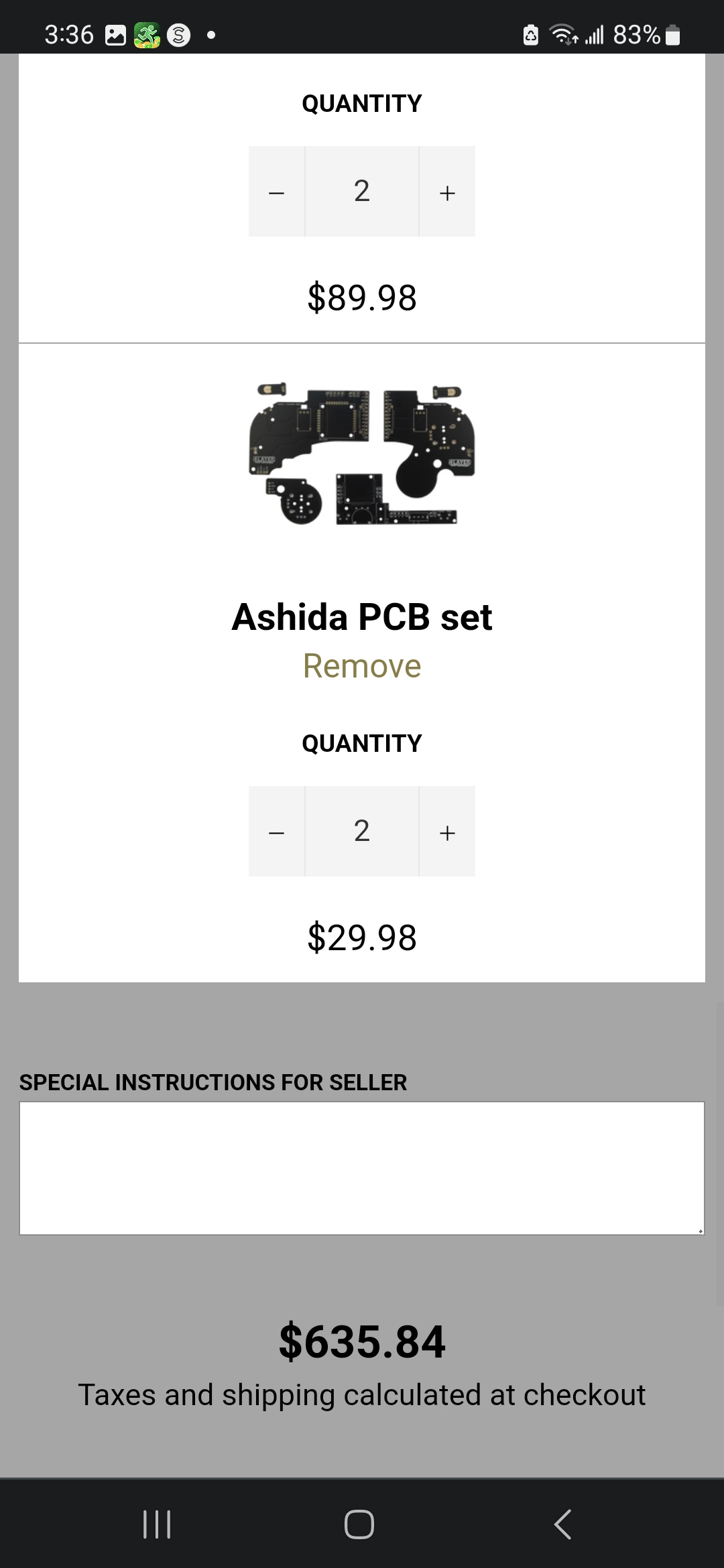

I have these added to the cart. I read the description under the pcb's to try and understand what each one does, but I feel like some of the pieces (ie the replacement heat monitor L chip) are redundant, and I don't really wanna waste money, so is this all I need to make the ashida work? (I have gamecube remotes to get buttons and button membranes already) I also know I need to look for lithium batteries still, and I already have 35mm magnet wire (or 34mm I don't remember) and 20 something wire (both reccomended in the ashida bom) and my soldering stuff is all here.
Here's the screenshots. I forgot to add them

Ah yeah, you don't need the replacement NTCs, the PMS2 / Lite comes with one. You'll need 34awg magnet wire and 22awg stranded wire at a minimum, it's also good to have some stuff in the middle for wiring things like power for the UAMP / GC+ (like 26/28awg stranded).
