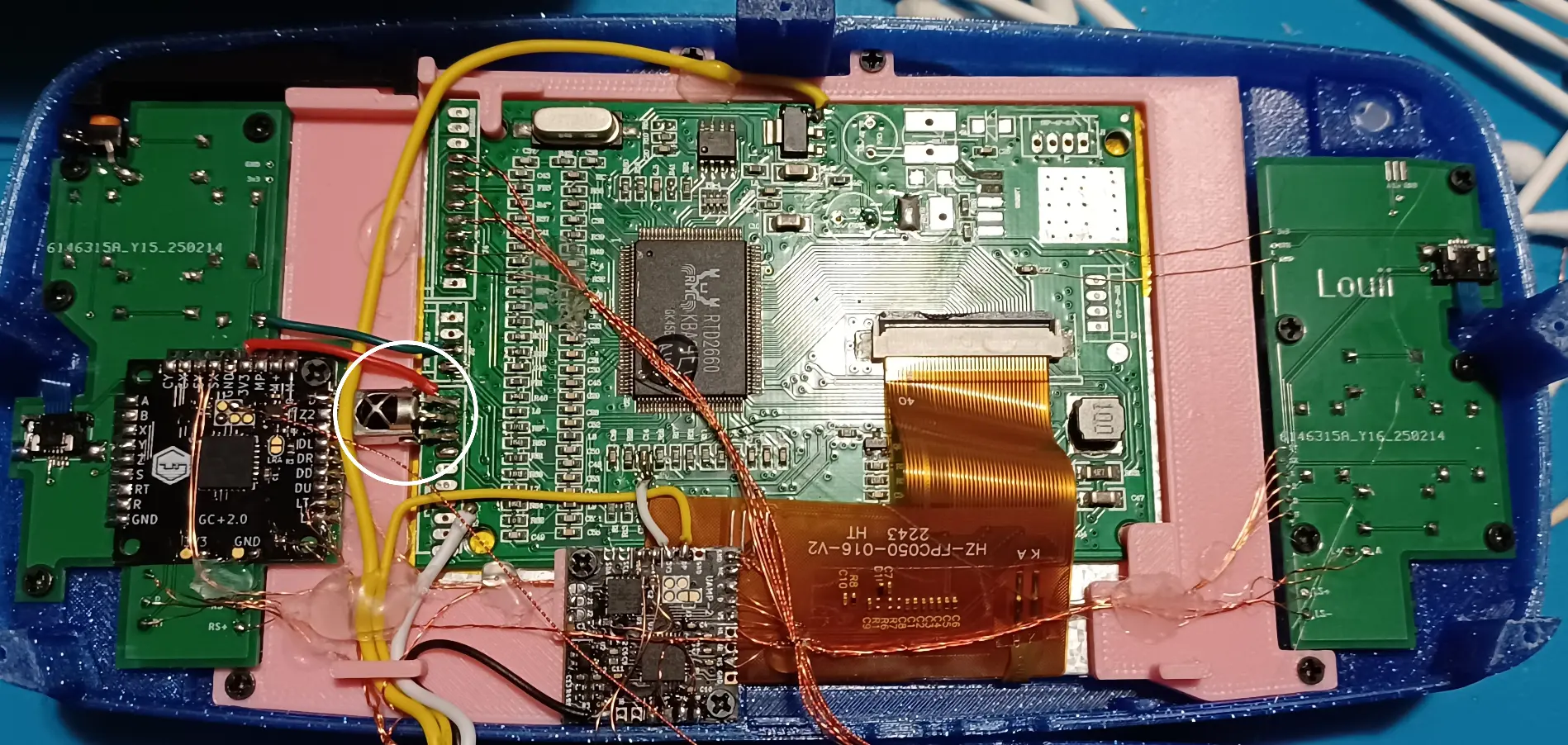

It can, but only if you get a screen with an IR reciever diode and you relocate that diode to be visible from outside the case
Only if your screen has an IR receiver and you move it outside the case so the remote can reach it
This actually isn't true. I've got Ashida and Louii builds with the IR receiver relocated inside the unit, and the remote works fine. I have to aim the remote at the bottom of the portable since the screen blocks the IR light, but it works really well even on my reflective blue Ashida!
You should be able to find the IR receiver on the screen control board. You can relocate it wirelessly according to my picture.

TLDR, yes you can! I just went over how you can do so! :)
