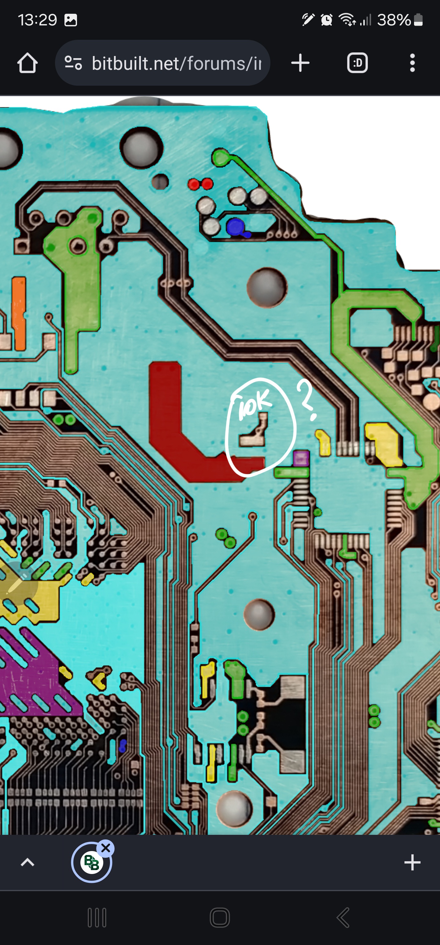

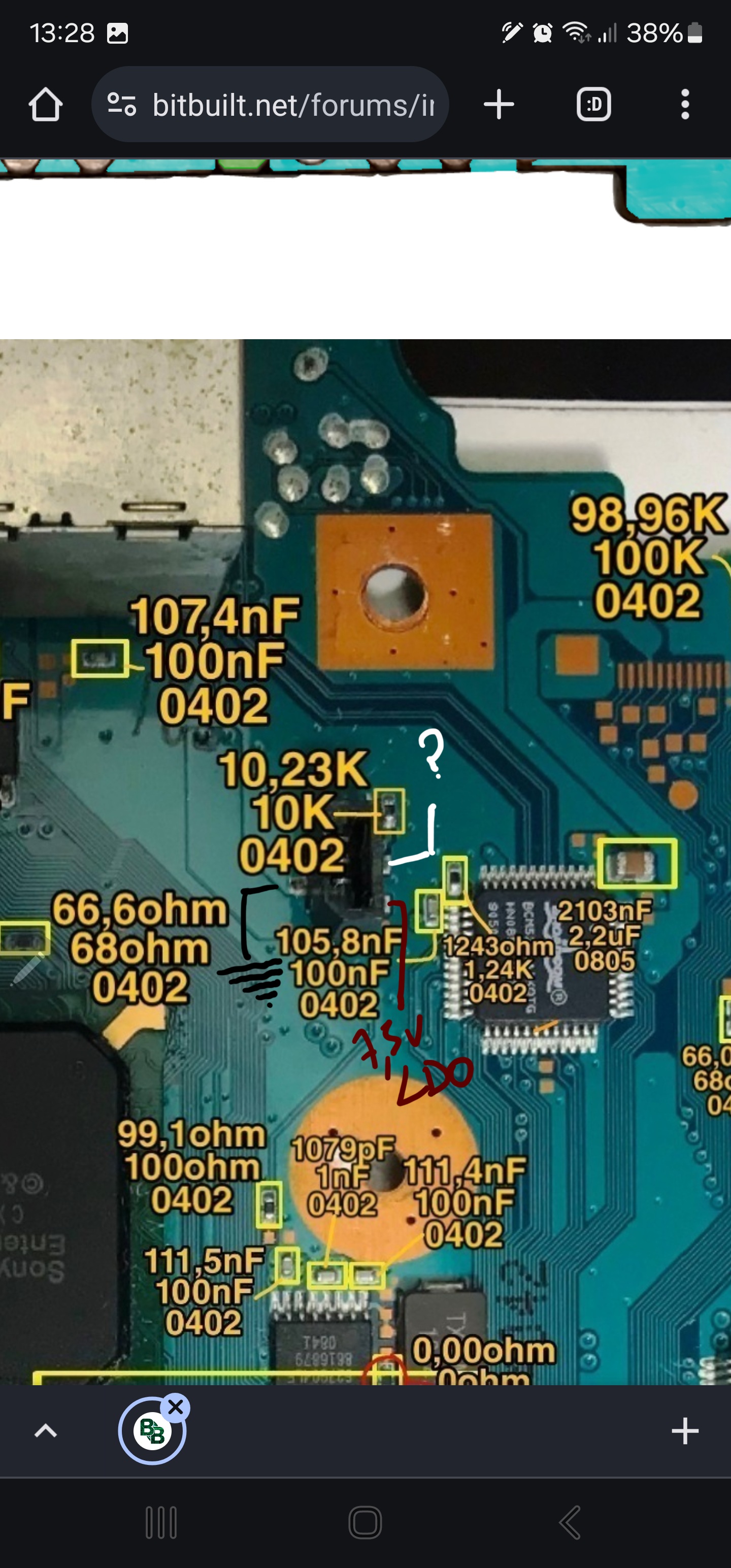

Hello, I have the cut-out 90001 laptop board and I want to use the original connection of the cooler that has 3 ground pins, positive 7.5v LDO and another pin that did not identify where it goes! From what you can see in the images that I am going to attach, it is going to have a 10k resistor but I would like to know its circuit to make the cooler work again

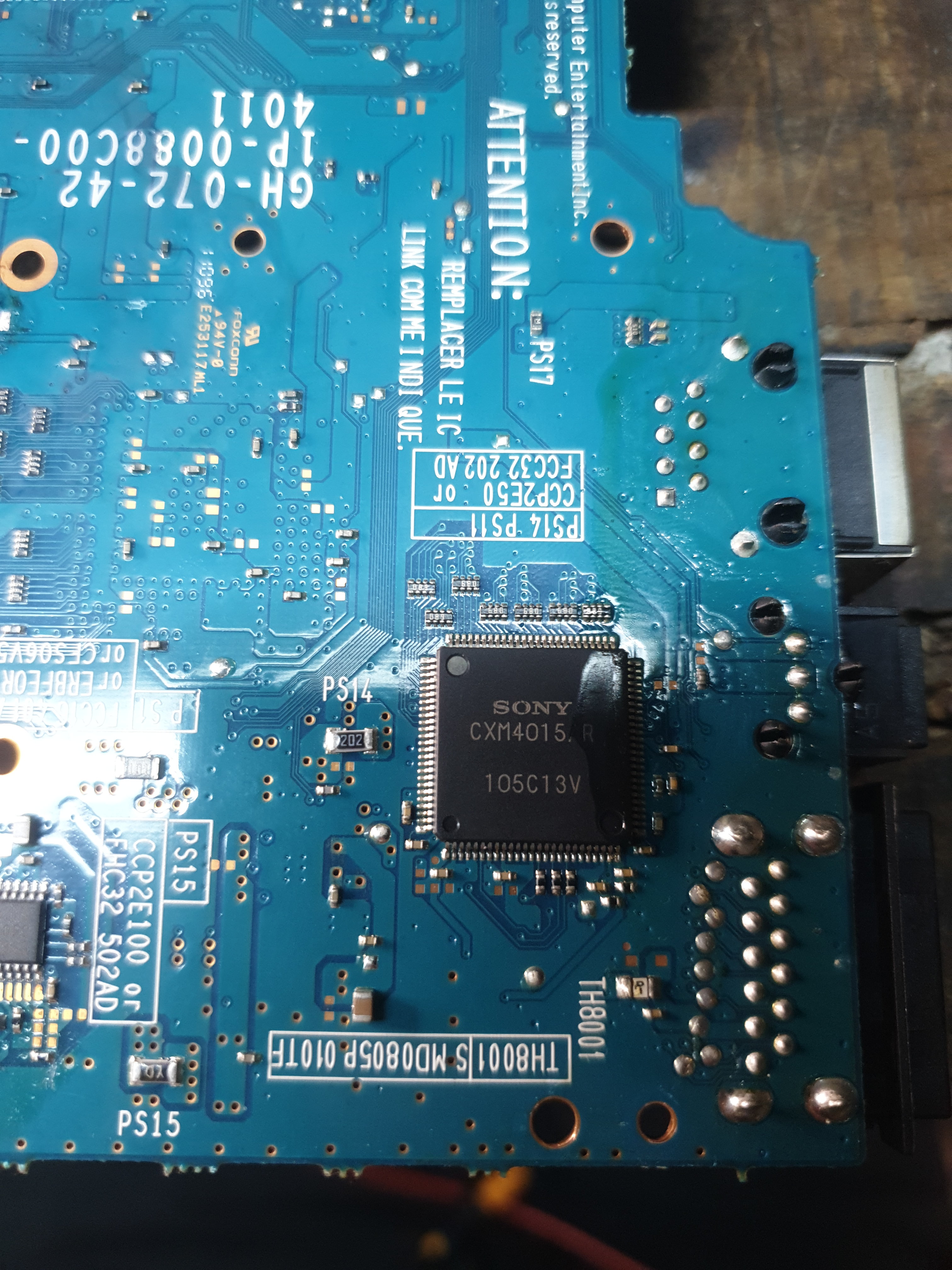

Hey guys. I have this ps2 90004 ,when turn on the AC, the red light doesn't come on, the power supply is fine, I measured the voltages and I don't have the correct values in the PWM, but with the multimeter I found a short at point PS14, both sides beep and I don't know where it could come from,otherwise I didn't find any other shorts. Thanks

Are you testing continuity on both sides for the fuse alone, or are you getting continuity between either side of the fuse and ground?
The fuse itself should have continuity, but if it's shorted to ground, then that's a bigger problem.
Its shorts to ground, the multimeter shows low resistance and beeps.
So it's only low resistance and not a dead short? (0ohms) what's the exact resistance your getting between that fuse and ground?
All multimeters have a certain threshold in continuity mode that will cause it to start beeping when theres low resistance but it doesn't always necessarily mean there's a short. For example my 79001 ps2 has low enough resistance on the 1.25v line that causes my multimeter to beep but there's not actually a short and it works fine.
The fuse that your testing is on the 3.5v rail so I'm assuming if your meters beeping then there is something wrong however I don't have a 90k ps2 to test to make sure.
What I would do is plug your PS2 in and test to see if your getting 3.5v standby voltage. Keep in mind that the 3.5v and 3.5v standby are kind of 2 different things, so test the dark green area as pictured at the top of this thread and report back
I have the correct standby voltages 1.8 and 3.5, at point PS14 the multimeter shows a resistance of 19ohm, but at point 7.5v LDO I have nothing, I don't really understand what he means, but I tried jamming the 7.5v for the 7.5v LDO and the standby LED turns on for a few milliseconds and then turns off, but I don't want to experiment too much with that for fear of burning something.
It sounds like the 7.5v rail is either shorted to ground somehow, or you have a faulty LDO. I would test any capacitor connected to the 7.5v rail to see if you can find any shorts to ground and also recheck your fuses (specifically any fuse that might be connected to 7.5v) whereas you put power to it.
It's likely something might be connecting your 7.5v to ground if your light came on for a sec then died.
Hey,I solved the problem, it was an open 1k ohm resistor block, the standby light already turns on but I press the button, it turns green, the console gives video but only a black screen appears and no sound, I also tried to change another resistor block responsible for the video and image, but nothing changed.
