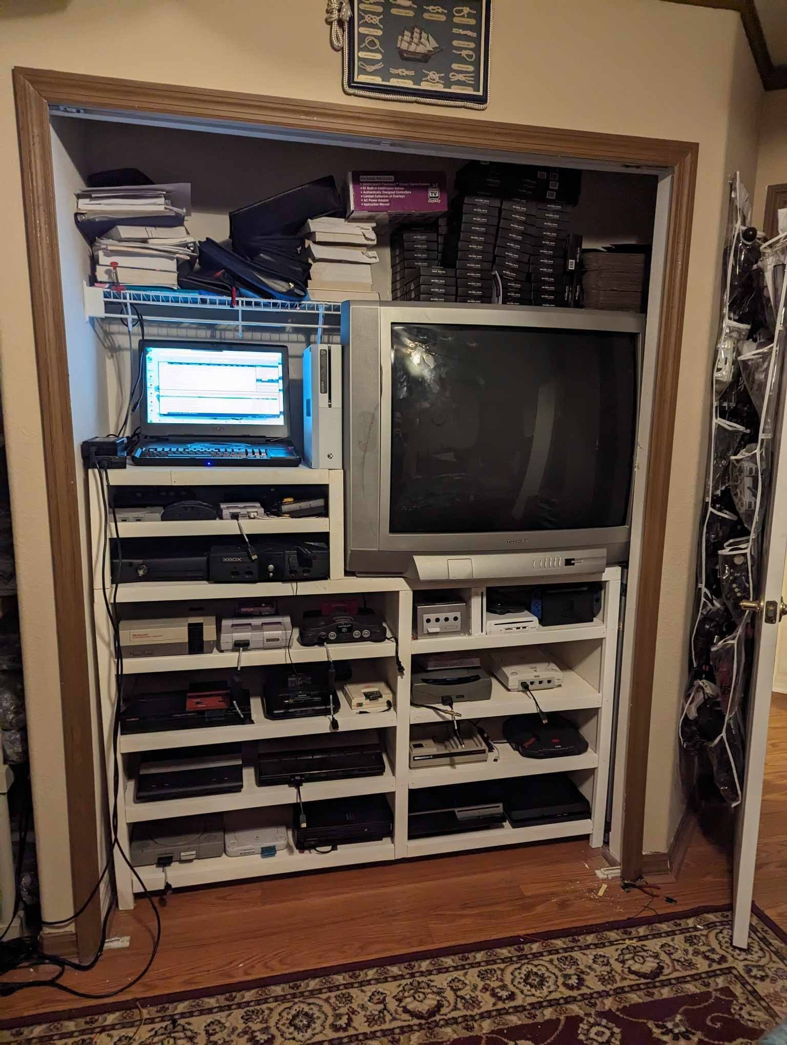

Hey, I'm using something similar, its more for older controllers on older console rather then BT. Not sure if its ok for me to post links, so I'll attach an image of my setup.
This is call the Bliss-Box Bridge. It supports nearly all older console and some of the new stuff. It will let you use controllers as paddles, tablets as mice, and swap out any controller for another.
That's a fine cabinet right there
LOL, yeah built it myself. Could not find one to fit right.

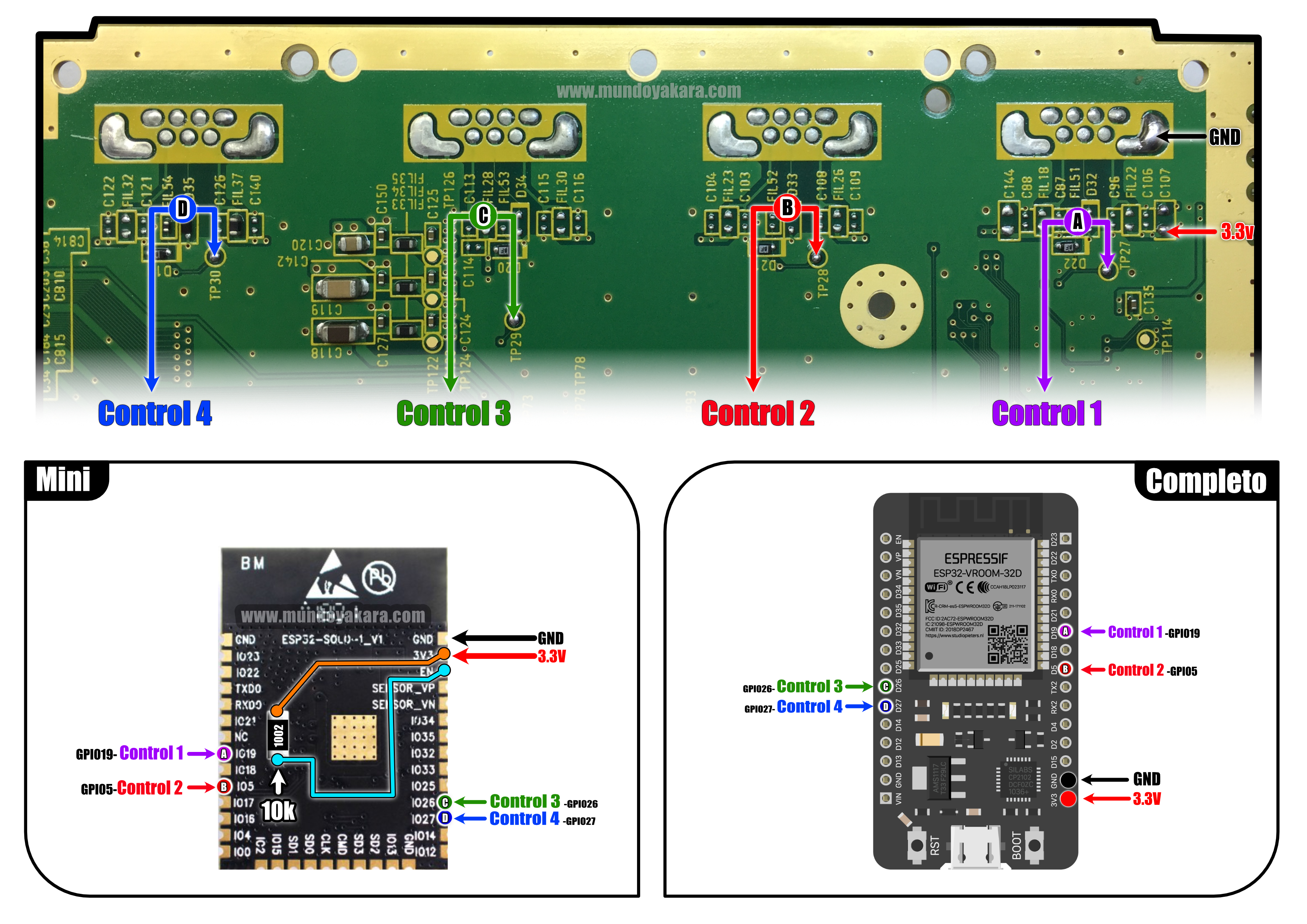

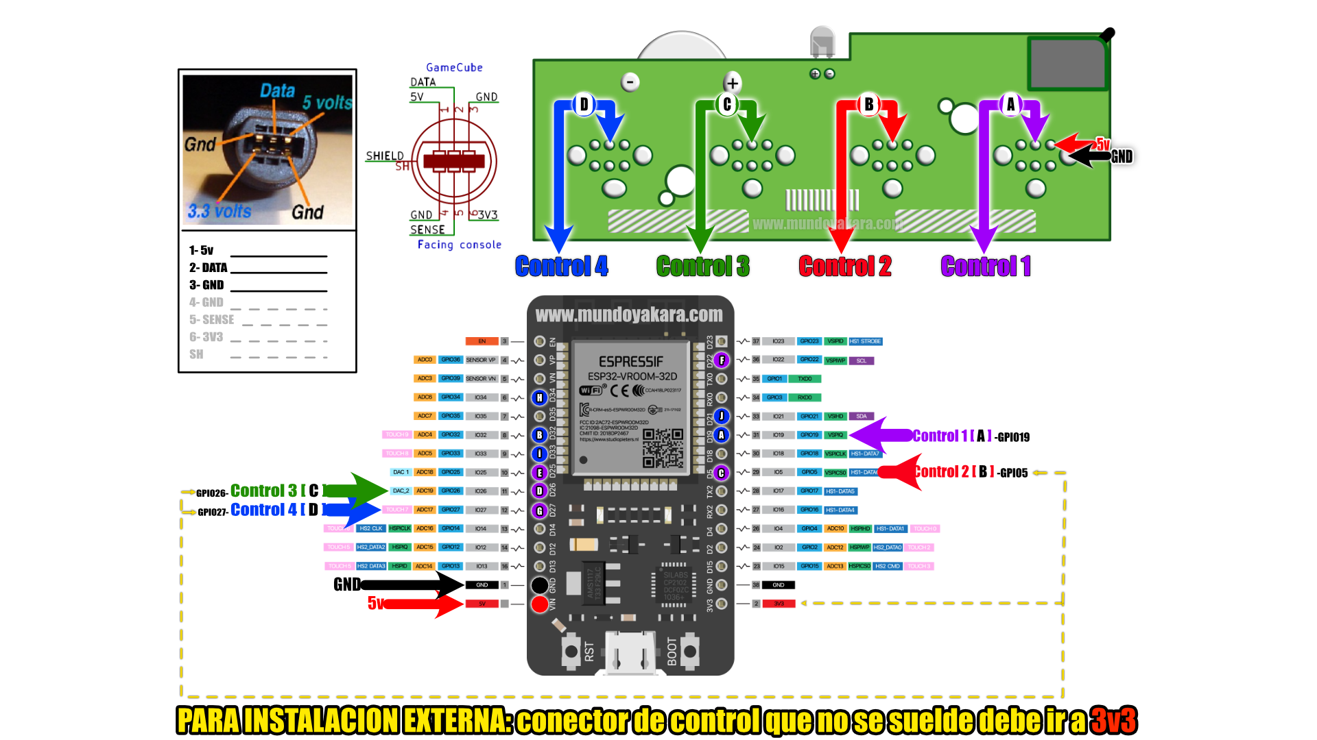

Have you considered a cheaper version like programming an ESP32 and installing it internally? There’s an open source blueretro software for gamecube
It will be the same as buying the internal version and installing it, but a lot cheaper… Last week I bought 2 ESP32 modules by 2dlls each one on Aliexpress
Here’s the module and the install diagram, you only have to program it, supply it with 5V (or 3.3V for the single chip) and solder directly to your actual controller port/gamecube data lines of your portable
There’s a software version for gamecube and wii separatedly and its compatible with almost every original wireless controller from other consoles
