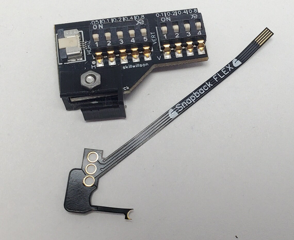

Also, I've seen most commonly the orangey kapton type flex PCbs, but I've also seen types like this that seem to have a solder mask material on them, likely making them more durable. Does anyone know what this is called, and where I might be able to get that made?
Image of this flex PCB type I was referring to above:

Thank you so much actually, GoldPhoenix should be really great to get some samples since with PCBway it seems like I'm spending like $150 minimum.
