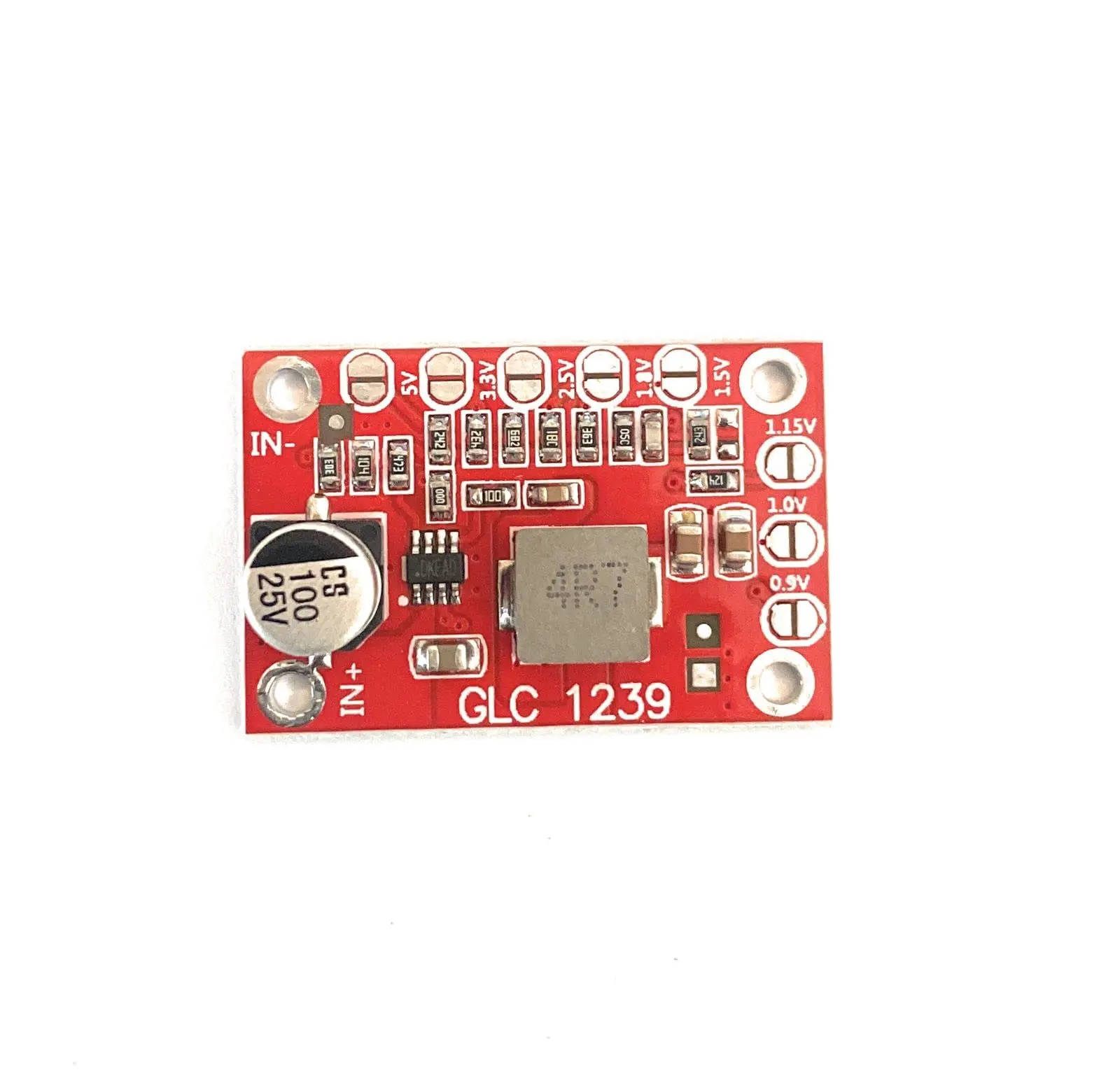

after a lot of research i found the glc1239 which looks promising with its different output possibilities such as 1v, 1.15v, 1.8v, 3.3v and even 5v what do y'all think ?
image: View attachment 44643
PTH regs were the standard back in the day because TI used to do cheap sample packs. They also happened to be absurdly reliable. You can use most any switching DC regulator that can handle 3A sustained output. The one you linked looks like it could be passable. No way to know its reliability under load without trying though.
You will have to use one module per voltage to meet the Wii's current draw requirements, and also solder in filtering capacitors on the outputs to protect your peripherals. I would recommend leaving the Wii's stock 1.8v LDO reg in place until/unless this platform proves itself safe. Don't want voltage ripple to kill your RAM.
Hard to beat the convenience of that GLC-1239 board's solder jumpers. Looks like it uses a Monolithic Power MP2315. That's an obsolete part, and the board is not optimized for low-voltage output. The datasheet recommends a ~1.8uH inductor for Vout < 2V, while this board uses 4.7uH, meaning for a given inductor size, the inductor resistance is 2.5x higher than necessary, causing the inductor to burn 6x as much power as heat! It would work OK for a Wii Micro but I wouldn't recommend it for a portable.
AliExpress has some other MP2315 modules, like this one. Same inductor selection issue, and a smaller board, so it'll run even hotter.
A TPS565201 module from YourCee will probably perform better. Much better regulator specs, and the correct inductor is being used.

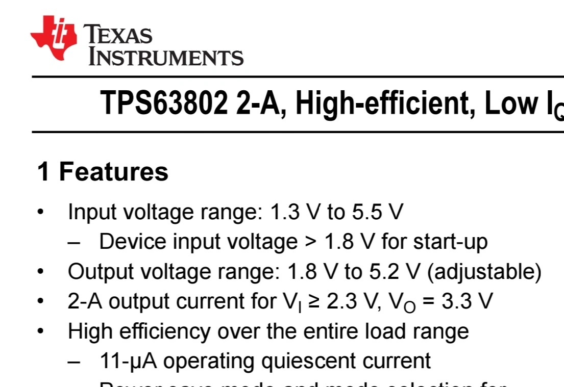

The 63802 can go down to 1v? I thought the min was 1.8v
Hi. No, I meant for all voltages from 5V down to 1.8V; besides not being able to operate at 1V, it wouldn't have the necessary current (that module has a tiny inductor anyway, so I wouldn't exceed 500mA for 5V in buck-boost mode).

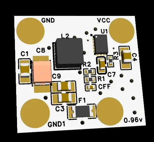

  • Regarding the semi-custom design: yes, you can use the TPS63802 for everything—it’s not a problem at all; in fact, it’s much better than using a single large TPS61088. For the 1V and 1.15V rails, you can use my "tiny beast" of a chip if you're comfortable soldering—you could even use it for the 1.8V rail. Remember, LDOs are "nice" because they output voltage without needing external resistors, but the voltage drop from input to output is converted into heat—meaning wasted power—so it's better to eliminate them if possible.

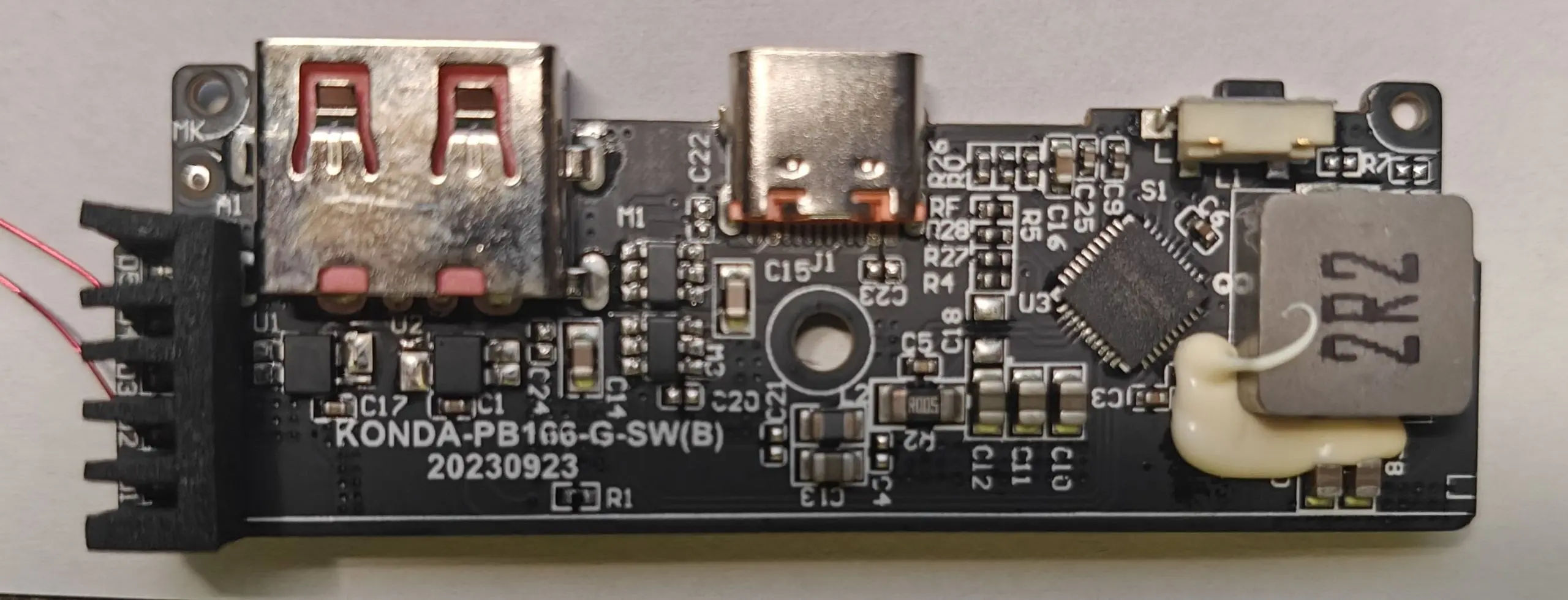

I have one on hand that i wouldn't call it the "ultimate solution" if I were to start sketching out the final design (and if it's usable) it would be convenient toi use for the prototype at least. According to the description, it can output 5V and 4.5A via USB-A, it's enough to connect all the previously mentioned DC-DC converters to it and skip buying the 5V module. However, if I go this route, would it still make sense for the 3.3V module (TPS63802) to be a buck-boost converter, given that it will always be receiving 5V?
Look, pretty much anything is possible, but we have to be realistic: using a power bank module to convert the 4.2V battery output to 5V—and then generating all the necessary voltage rails from that—creates a fundamental issue. Will it work? Yes. But you’ll face serious problems with heat and efficiency. If you want a "simple" solution, you still have to deal with the separate rails required for the CPU and GPU. You could use the 802 module for the 3.3V and 5V lines, and any "quality" module—one with low output ripple—for the 1.8V line (since the current draw there is relatively low). I would use the power bank module solely for charging the battery; this way, you minimize heat generation and energy waste, thereby extending battery life.
