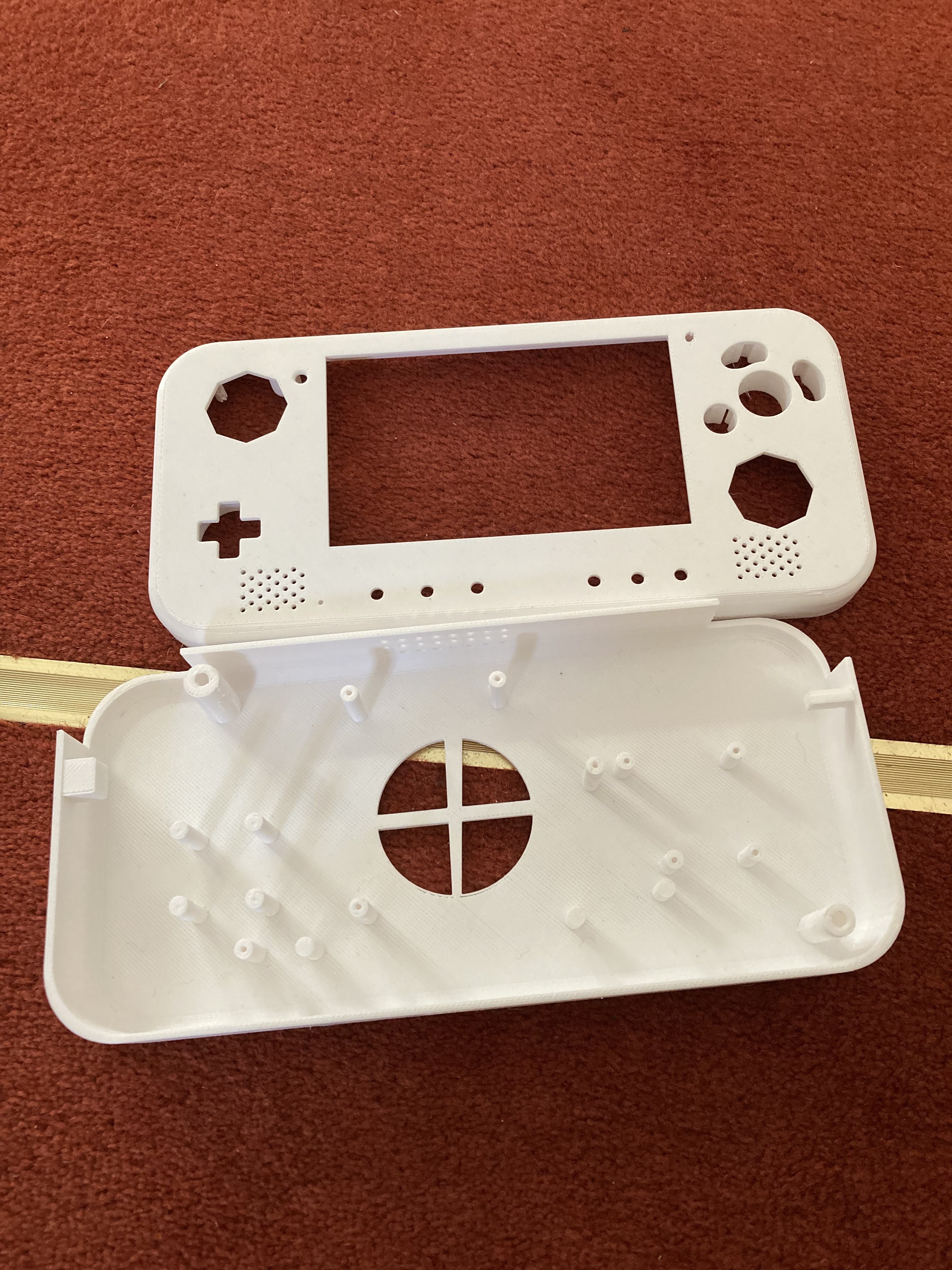

It needs a bit of work but I think it’ll be quite good for a first. What does everybody think?

keep at it, can’t wait to see more

Does anybody know the best way to deal with bad button holes (made to tight tolerances so now they stick) should I just sand down the inside or is there a better way? All that’s happening is that the buttons are grinding and sticking in the plastic. Also, is it better to wet or dry sand 3d printer plastic (I used PETG)
Dry sanding a little bit **evenly** should make them fit smoothly but test it in small intervals so it doesn’t get over sanded
