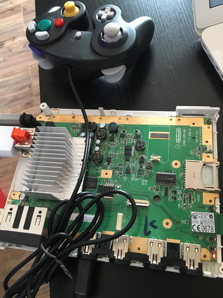

so I ordered USB ports and soldered my own port with twisted magnet wire, I used a drill to twist the wire, and also used the wiis original power adapter block in the wall and am still getting the same Exception (DSI) Occured. Is it just an issue with the board at this point? I would not think it is a USB issue as I am extremely positive and have double checked with continuity that the correct data pins are connected. Without a doubt a steady 5v is being supplied to the USB. And I cant imagine the Wii draws more than 3.7 A because that is what the original power source is rated at, and withso much of the board gone it should draw less. I am completely at a loss as to why this error keeps occuring.
It's hard to tell, it's most likely an issue with your trim. You can try sanding the edges of your board a bit more, just in case you shorted something. Also try shorting the reset via to ground (check the trimming guide to know where that via is) to get into priiloader on boot and see if that works well and you can also go in the Load/Install menu (don't install anything though)

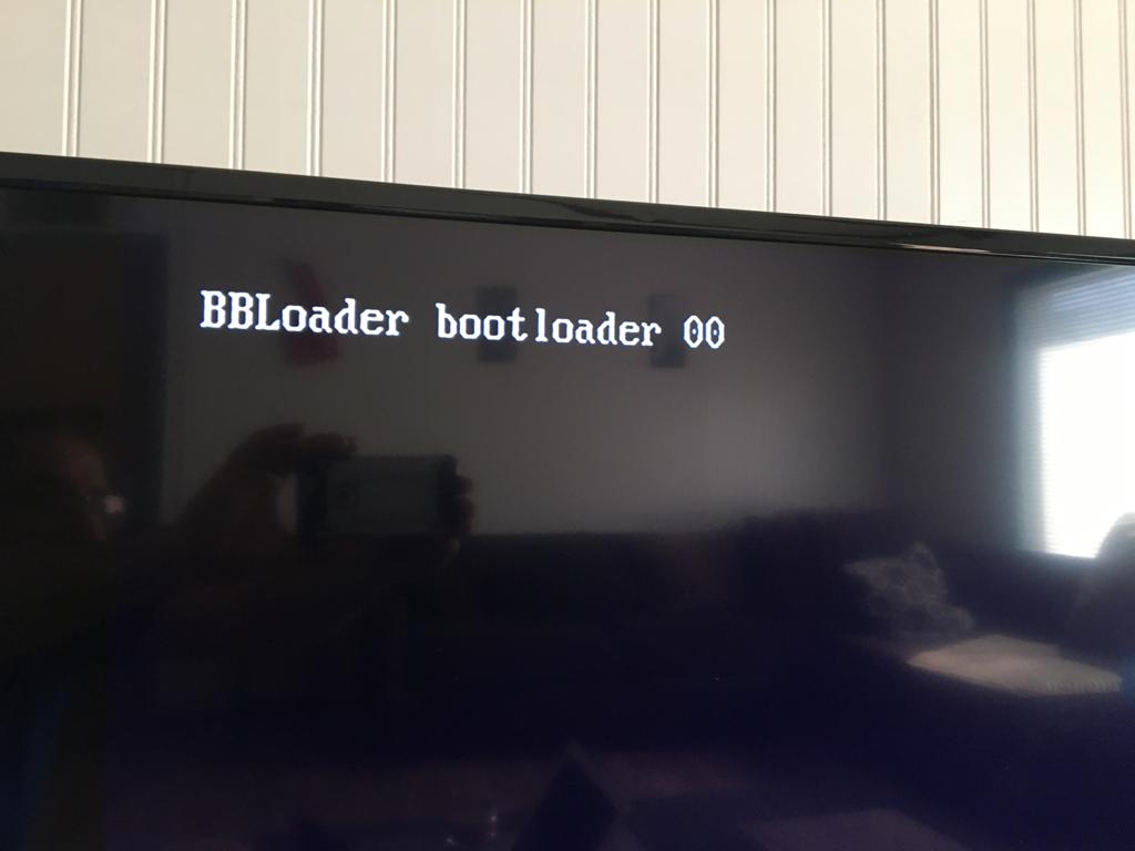

Hi everyone!
BBLoader version: Bbloader v1.1
Description of issue: BBLoader boot loader 00
How to recreate issue: when boot
Pictures of error and/or error codes:

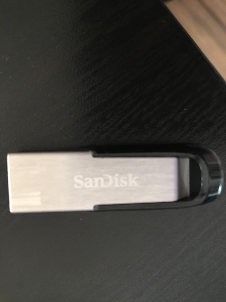

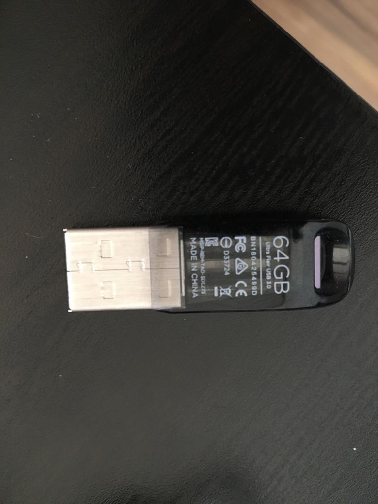

USB Drive: (Brand, Size)
Sandisk 64 Gb
Video output method: (VGA, Component, Composite) still testing with Wii2HDMI adapter
State of Wii: (Trimmed/Untrimmed) Untrimmed yet
It loaded the gamecube games, but since it didn't have a gamepad, it couldn't change to wii games and it couldn't play gamecube games. I have received the gamepad and I have a few days off to continue the project of making a portable wii with bbloader, but at first they loaded the gamecube games and today I have found this. The usb is formatted in fat32 and mbr.

Sadly SanDisk drives are not fully supported yet, especially with wii games. I am trying to fix them
but the gamecube games do not appear either, and before if it worked for me, I have also tried with a micro sd adapter, but the same screen appears.
