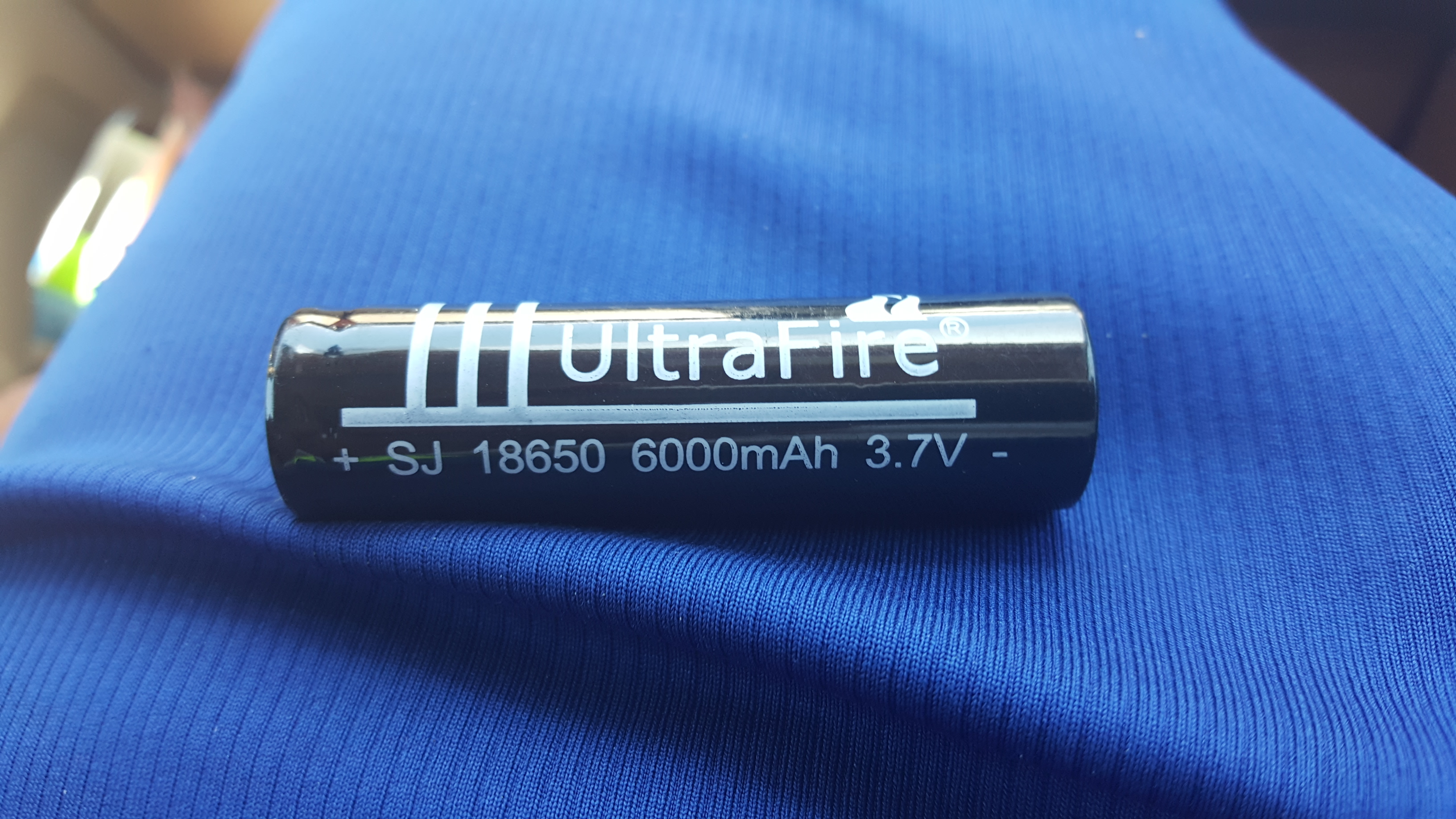

How many of these batteries would I need to power a Wii with stock regulators

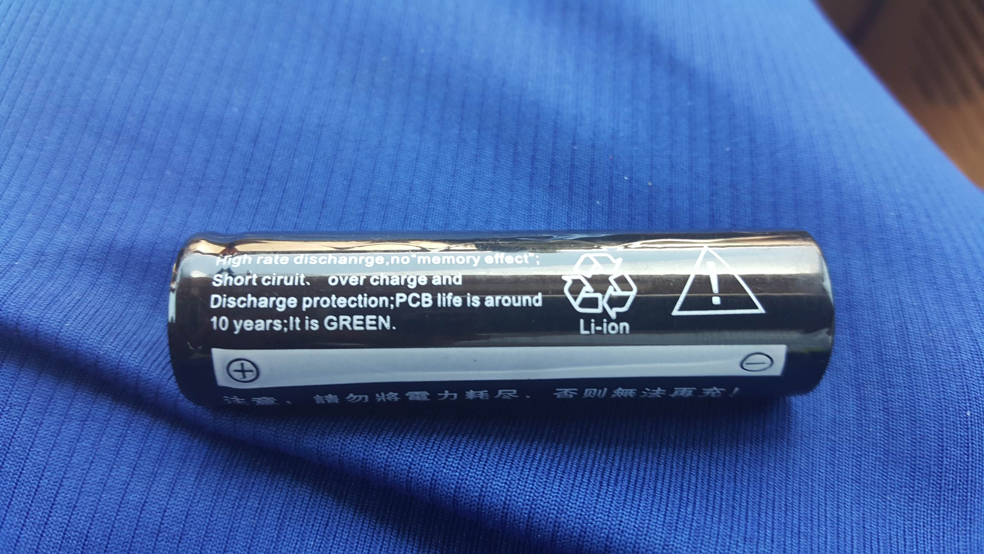

Probably a few dozen. Those are fakes. You'd be lucky if those are even a quarter of the stated capacity.
These are the best batteries you can get for the price, but I think they are having some shipping issues, so so can get them here also.
I know they are fakes, I meant like if the specs are actual ,voltage and stuff
So how many would I need for a portable?
Riiiiight.
4 3.7v cells is what you need. You decide if you want to get decent ones or these ones. Generally the range for 3.7v cells is around 3.2v - 4.2v, meaning if you have 4 of them in series, the voltage range will be around 12.8v to 16.8v, depending on how charged they are.
