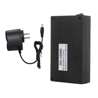

Would something like this work?
Or this
Or this
The power banks you're looking at here are 12v output they could be likely to cause a fire connecting to your charge input.
In the case of your portable the internals are unknown to the forum and the power circuit would also be unknown. That being said it would be difficult then to reliably offer a solution to you that wouldn't cause you to have a portable fire unit

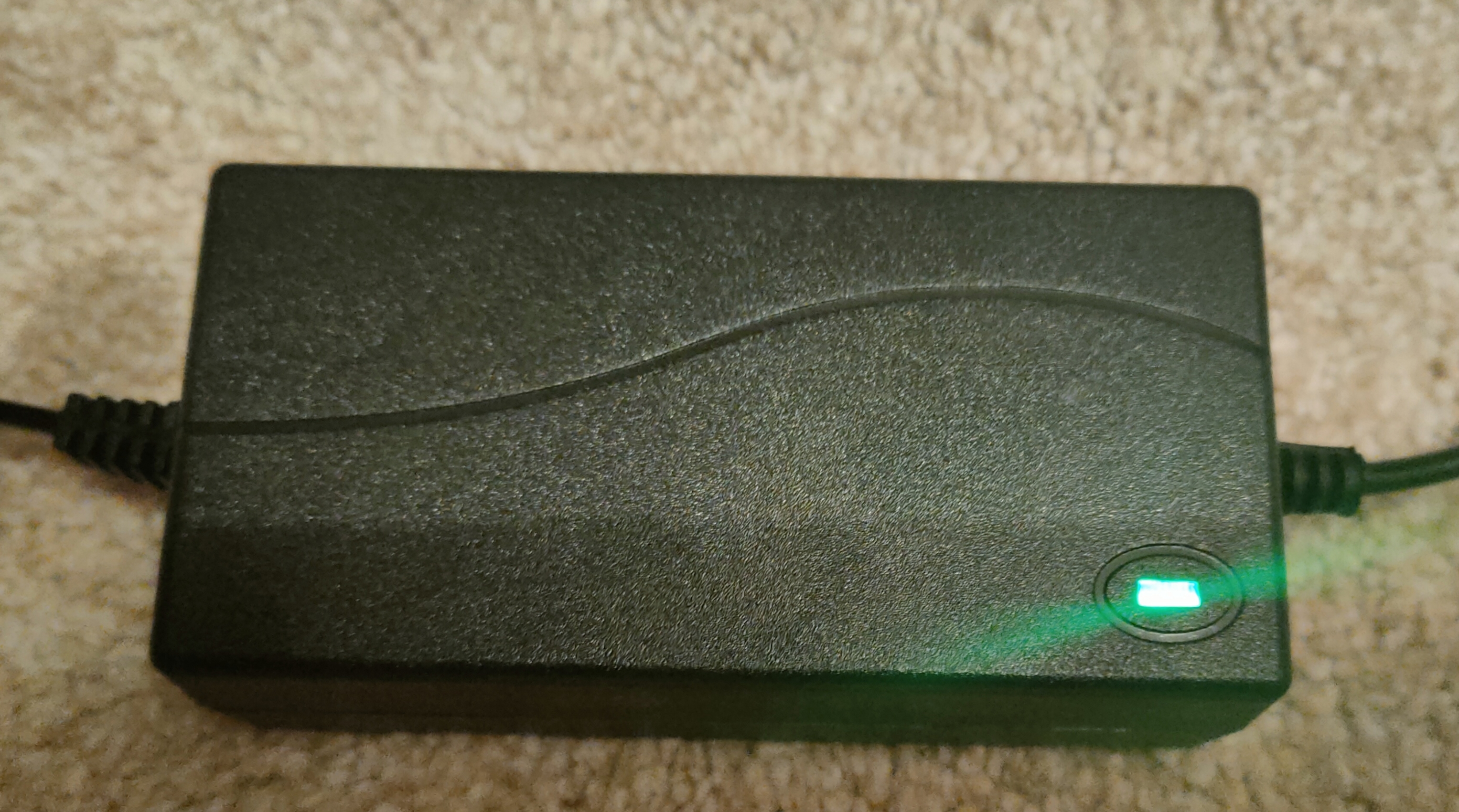

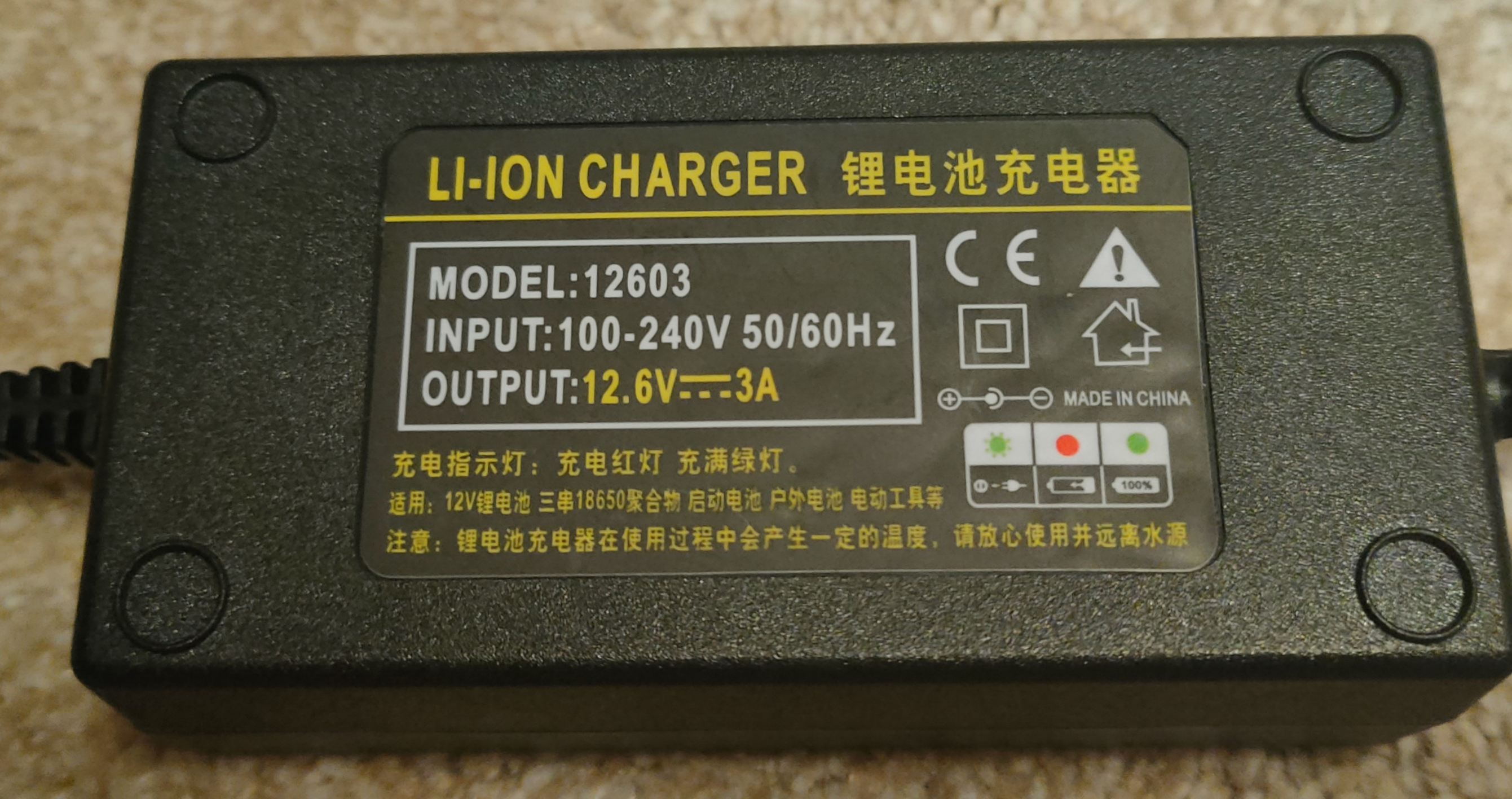

Can you post a picture of the charger?
Sure. Here you go.
Right. Thanks so if that's cotrect are there any portable options to charge OTG? Also because of the low battery life what mah are we talking about possibly? They've advertised the battery life as 2-3 hours but I barely get 1 to be honest.

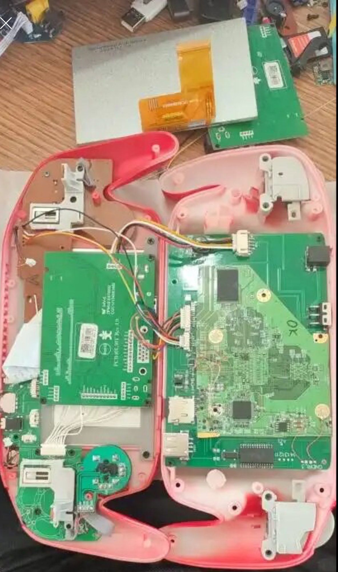

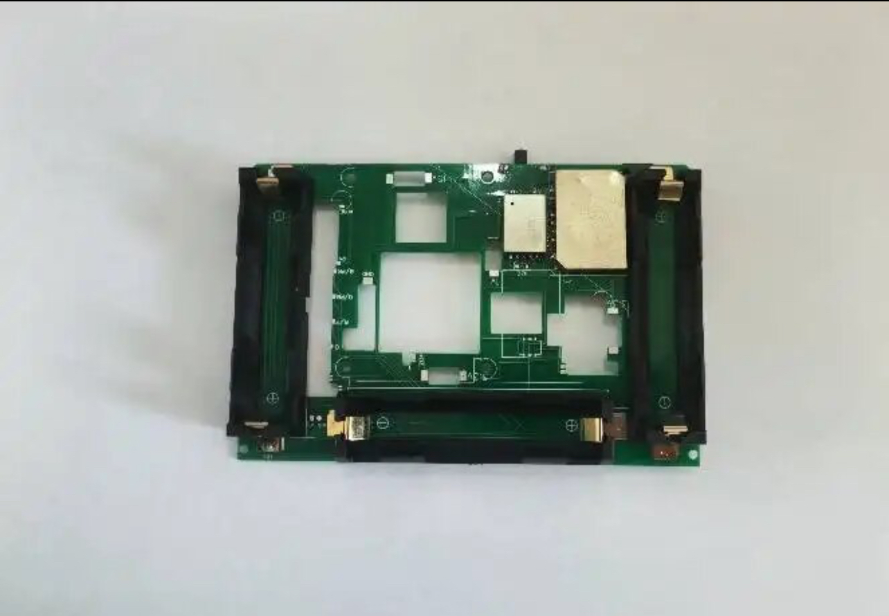

I can’t say for certain, but if your Ashida looks like the orange one in the provided photos, here’s what the interals should look like. I won’t provide any advice on a safe charging solution, but hopefully someone else can.
Hi. Yes. That's the one. Mine is in red though. I mean it works fine but just doesn't give me anymore than an hour's play. Maybe they have used inferior cells?

Replacing the cells will increase the runtime. If yours has spring tab battery holders like Bryce's does, then you can just swap the cells out

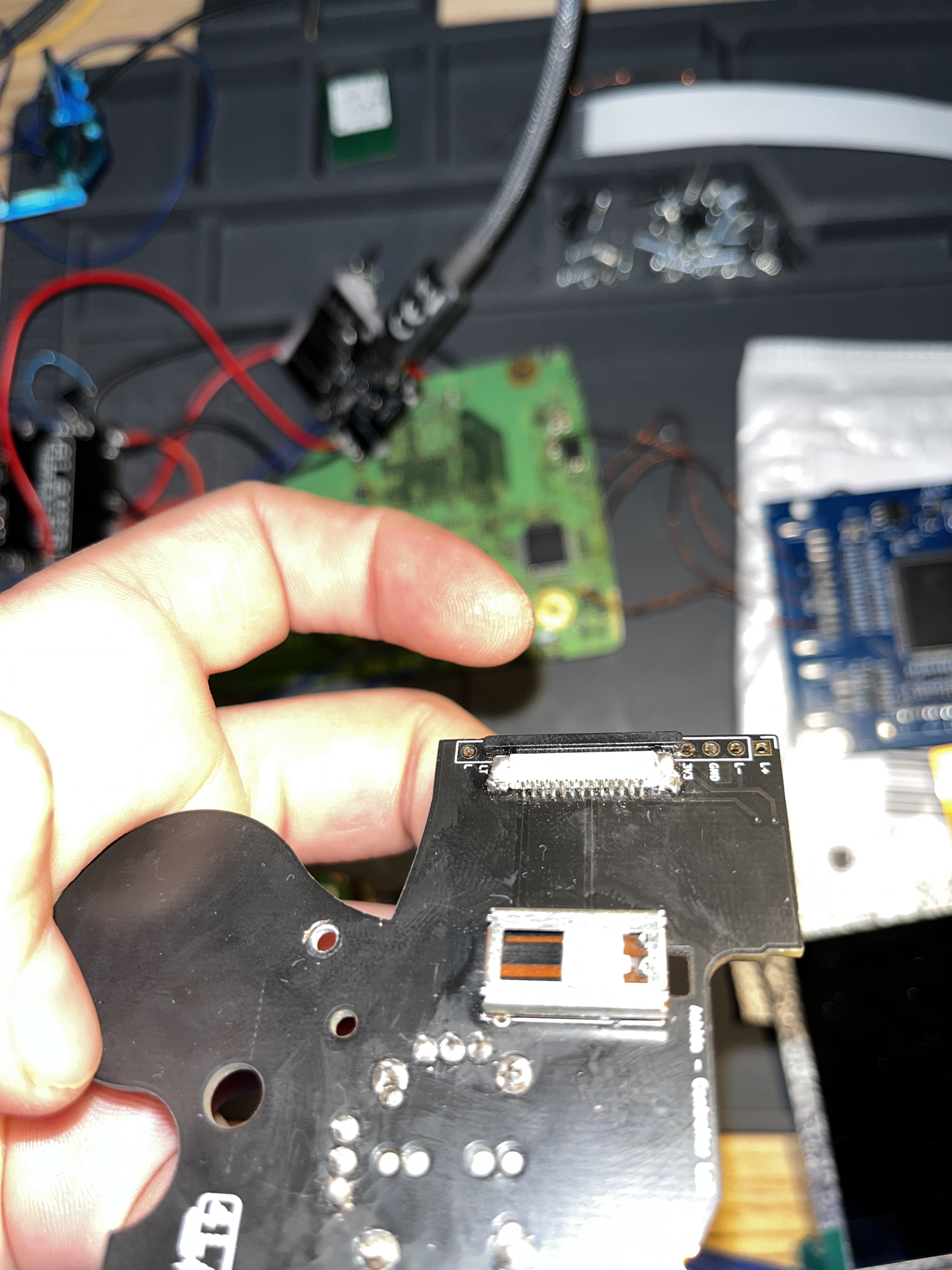

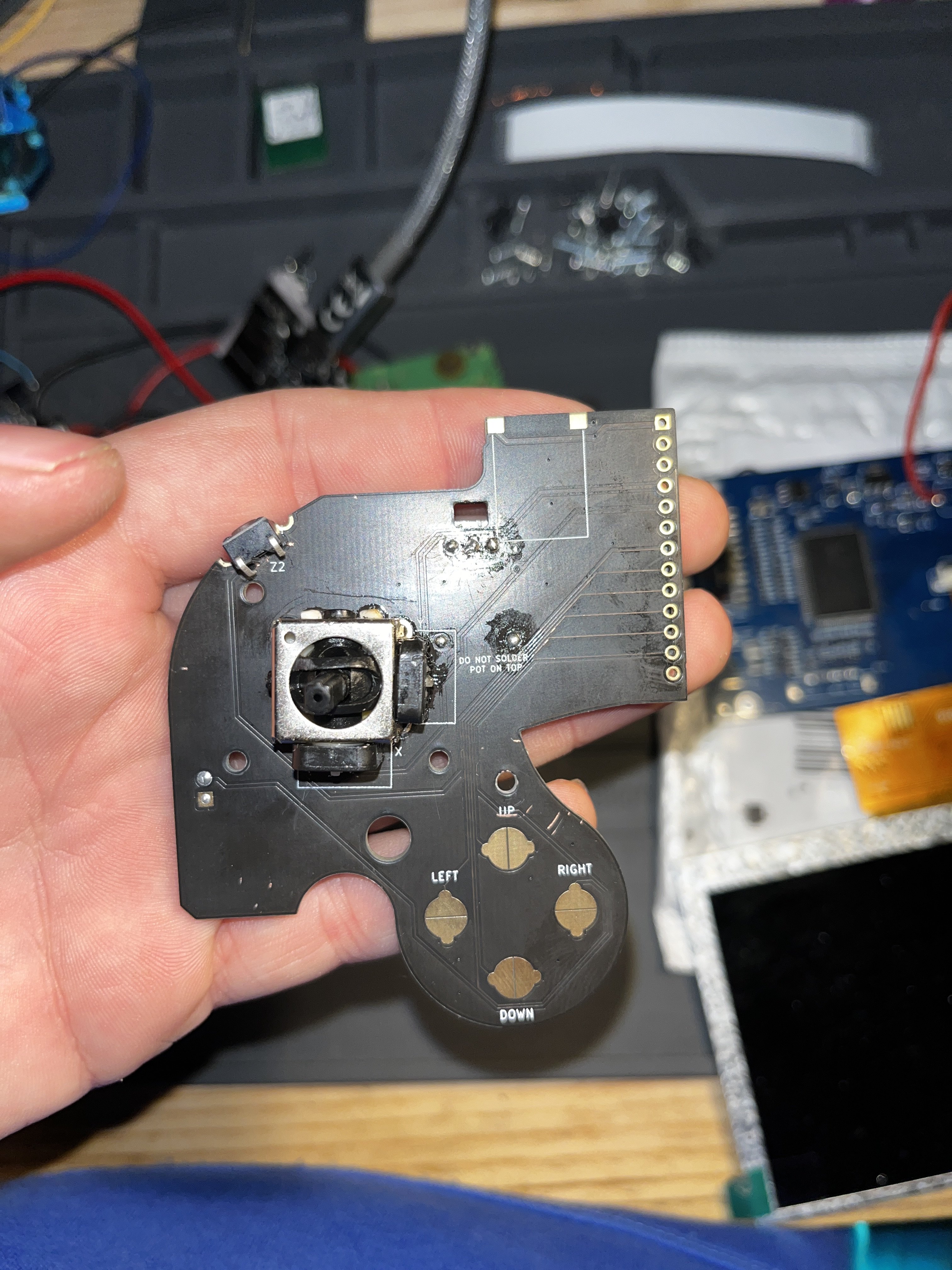

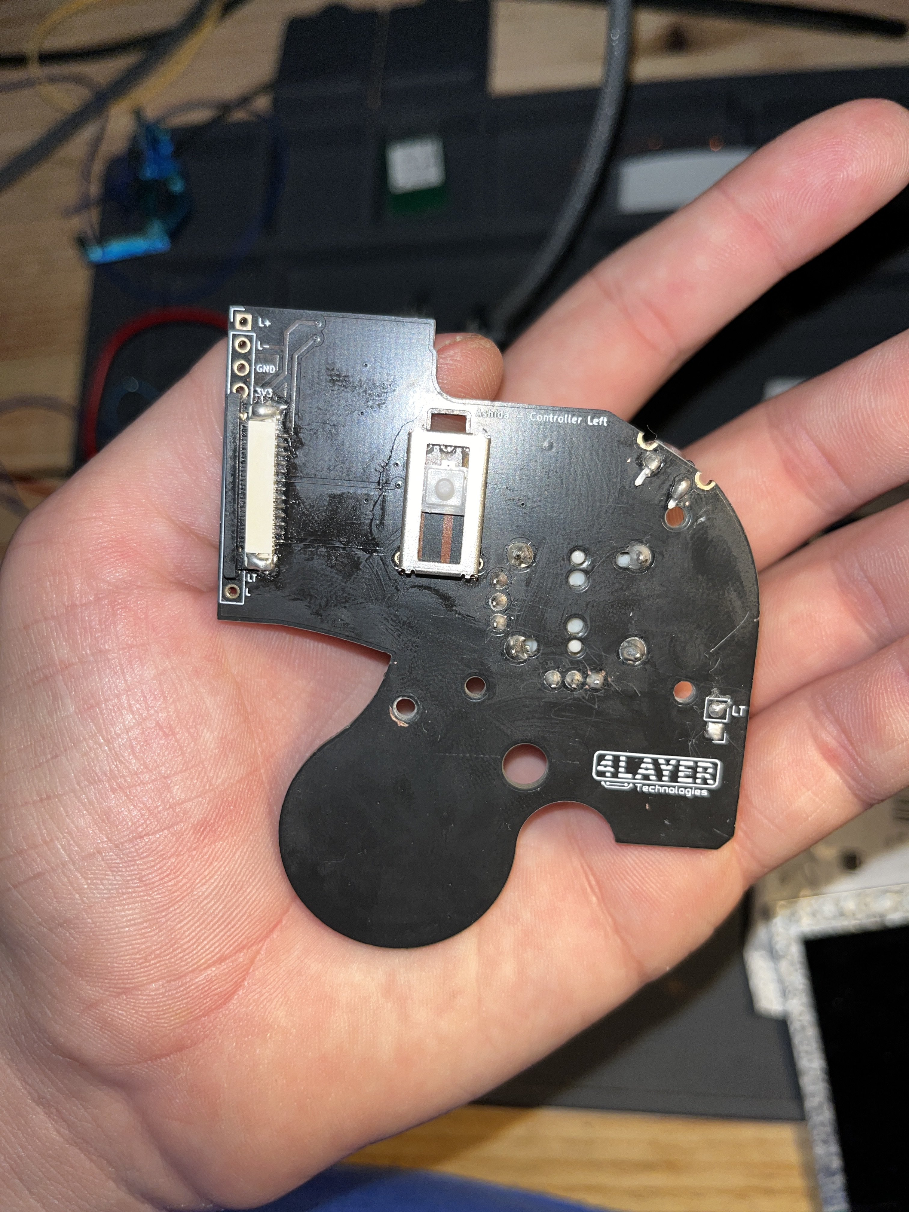

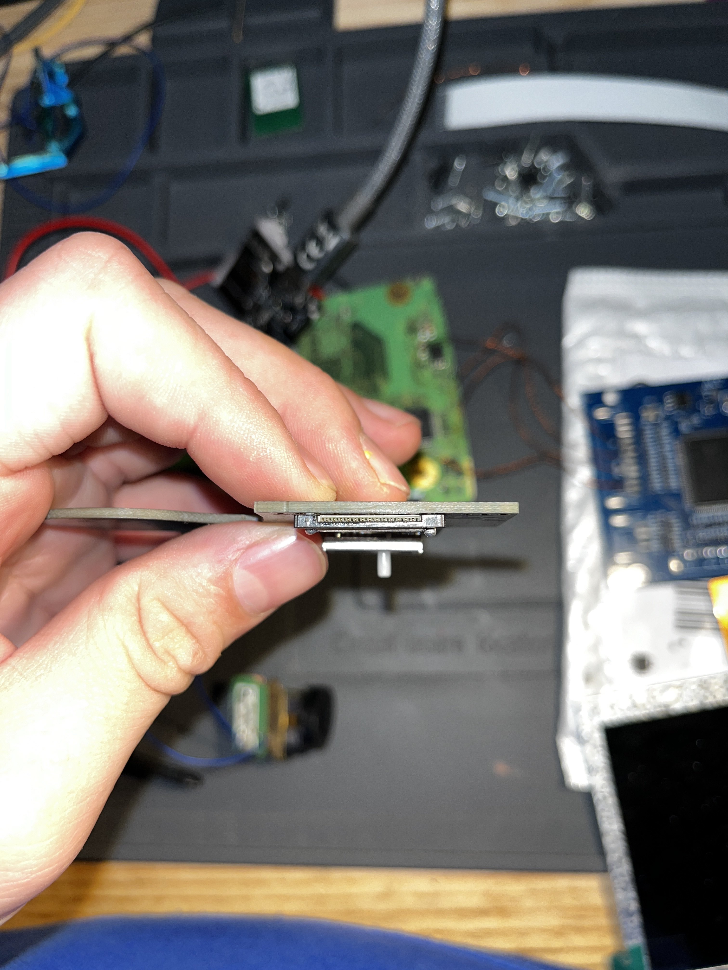

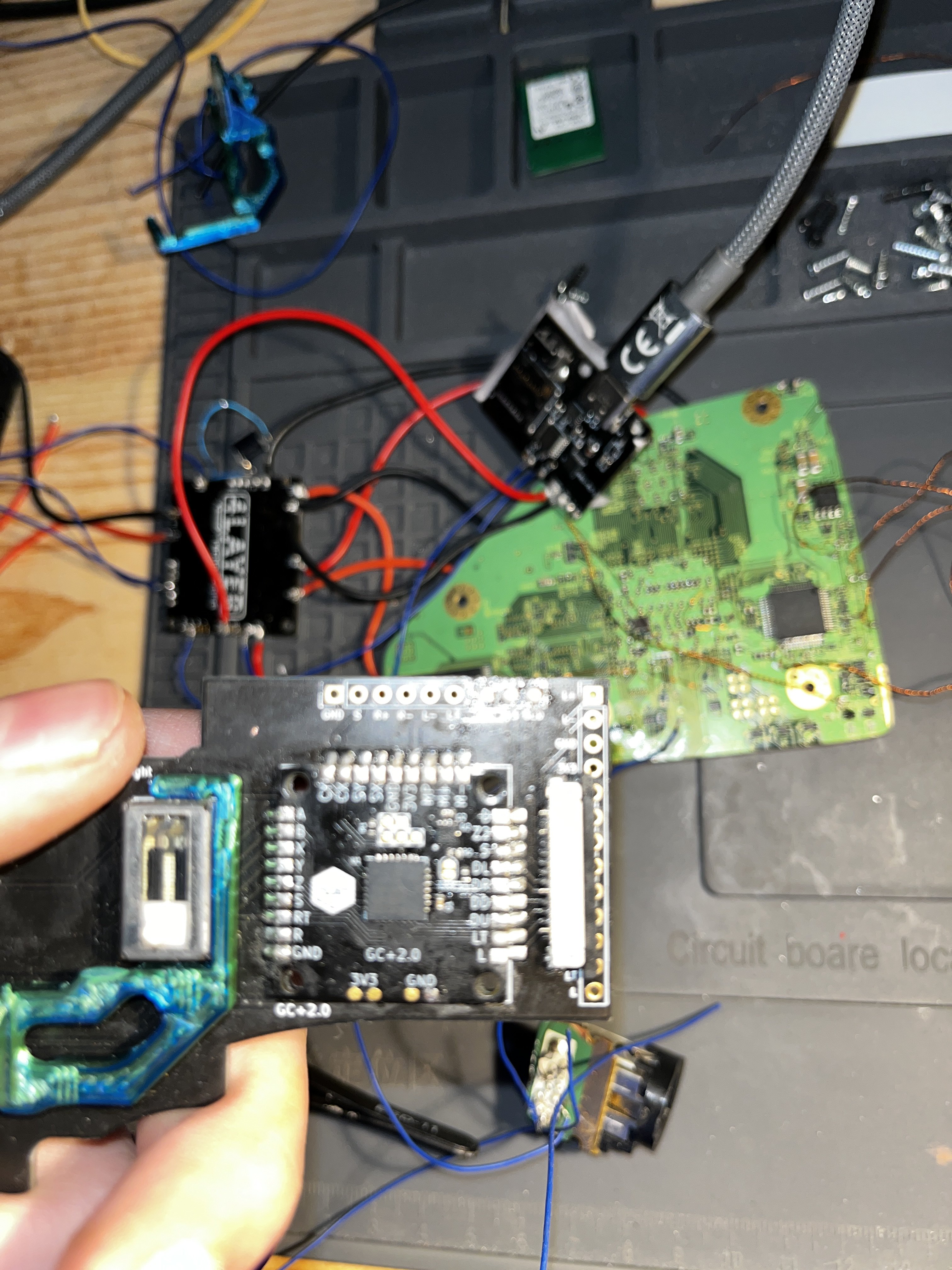

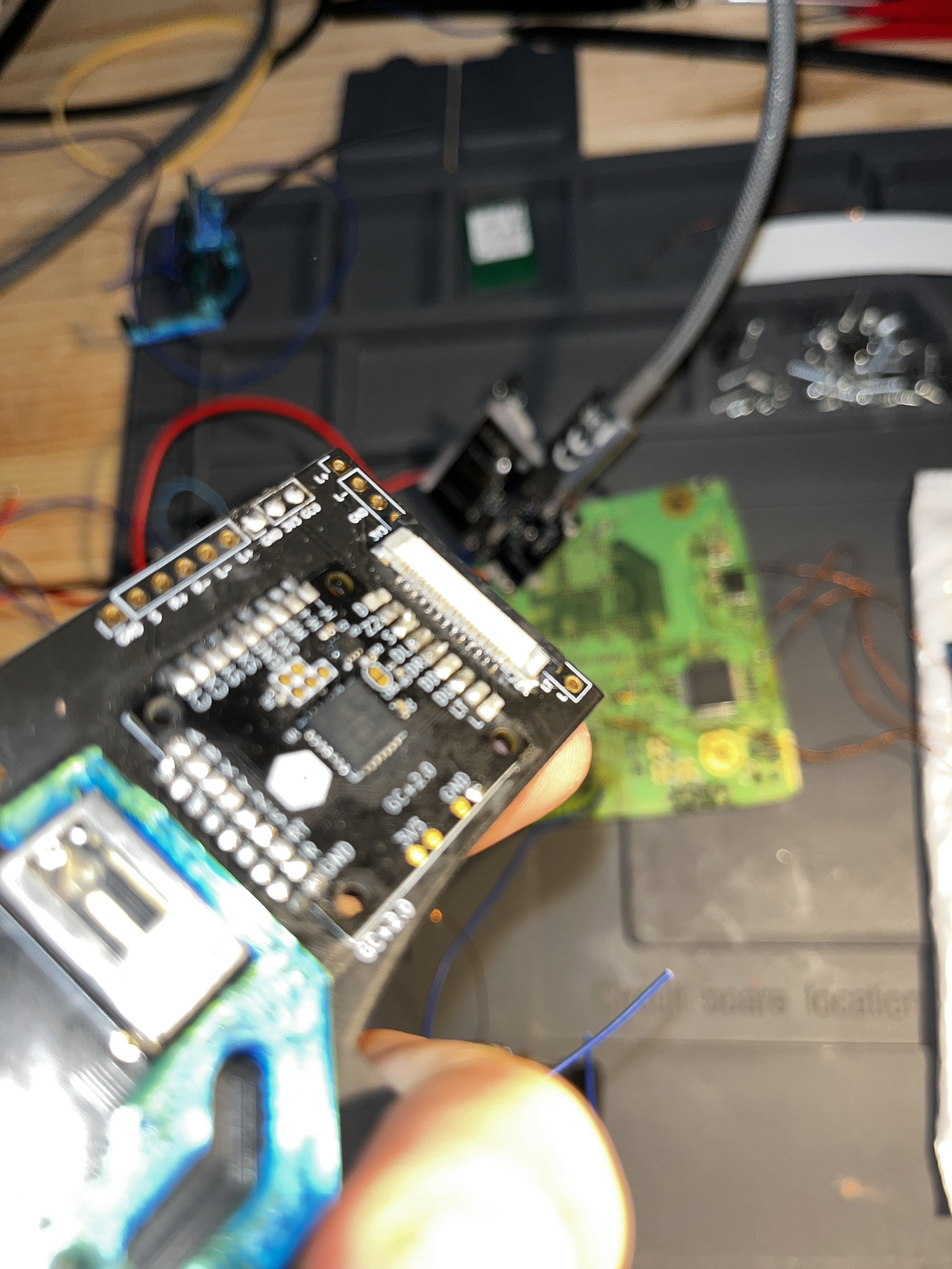

hello I have a problem with the controllers the right part where there is the GC+ integrated, and the C stick works very well even the A,B button.. on the other hand the left part where there is the left stick connected with a tablecloth does not work at all can you help me? (the first photos are the part of the controller that does not work)
