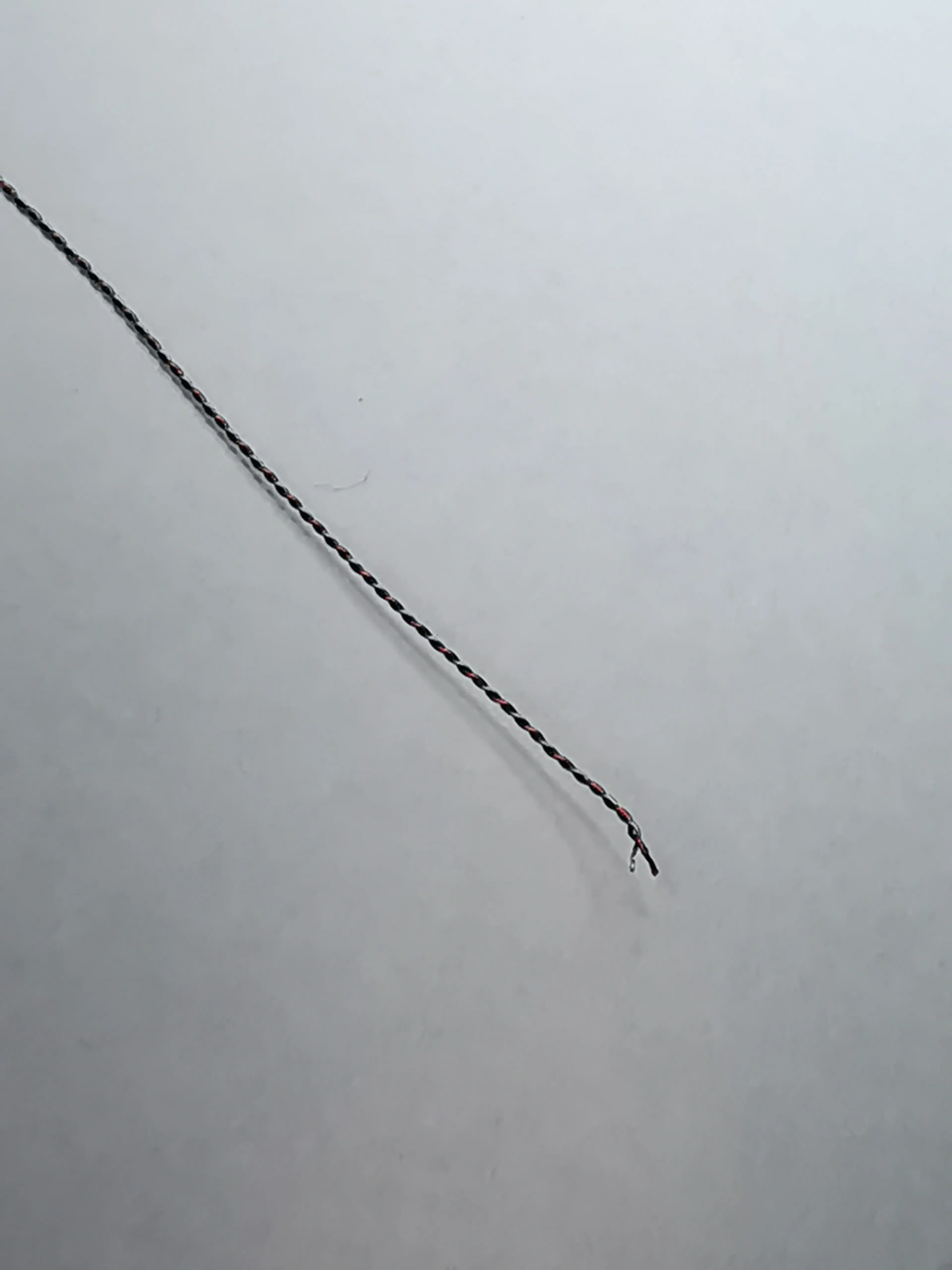

For the twisting, using a drill and twisting until it breaks off is the recommended method. Here is an example from YveltalGriffin on the discord for how it should look:
