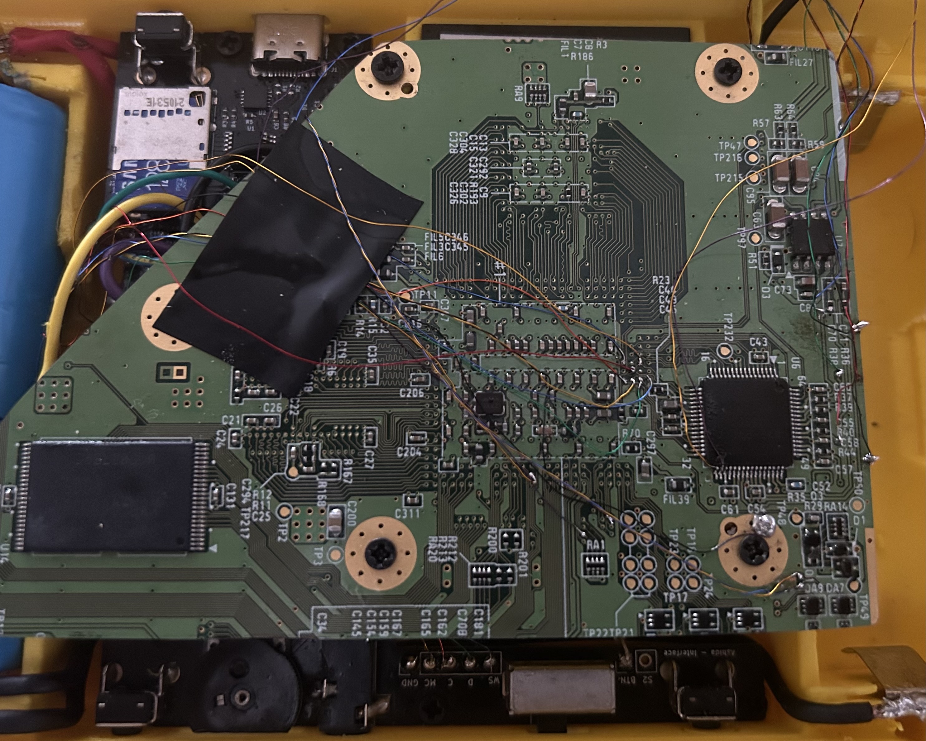

I have to say that at the beginning it went well, but know its almost finished im having some trouble.
while doing the build I constantly kept testing the functionality of the Wii incl RVloader with a AV connector. So I know it worked.

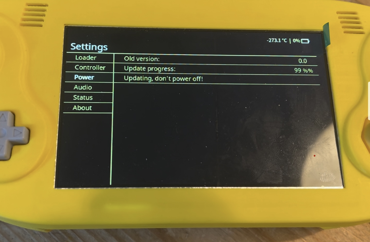

the download froze up at 51% and did not continue. So in the end needed to reset the console by removing the battery.

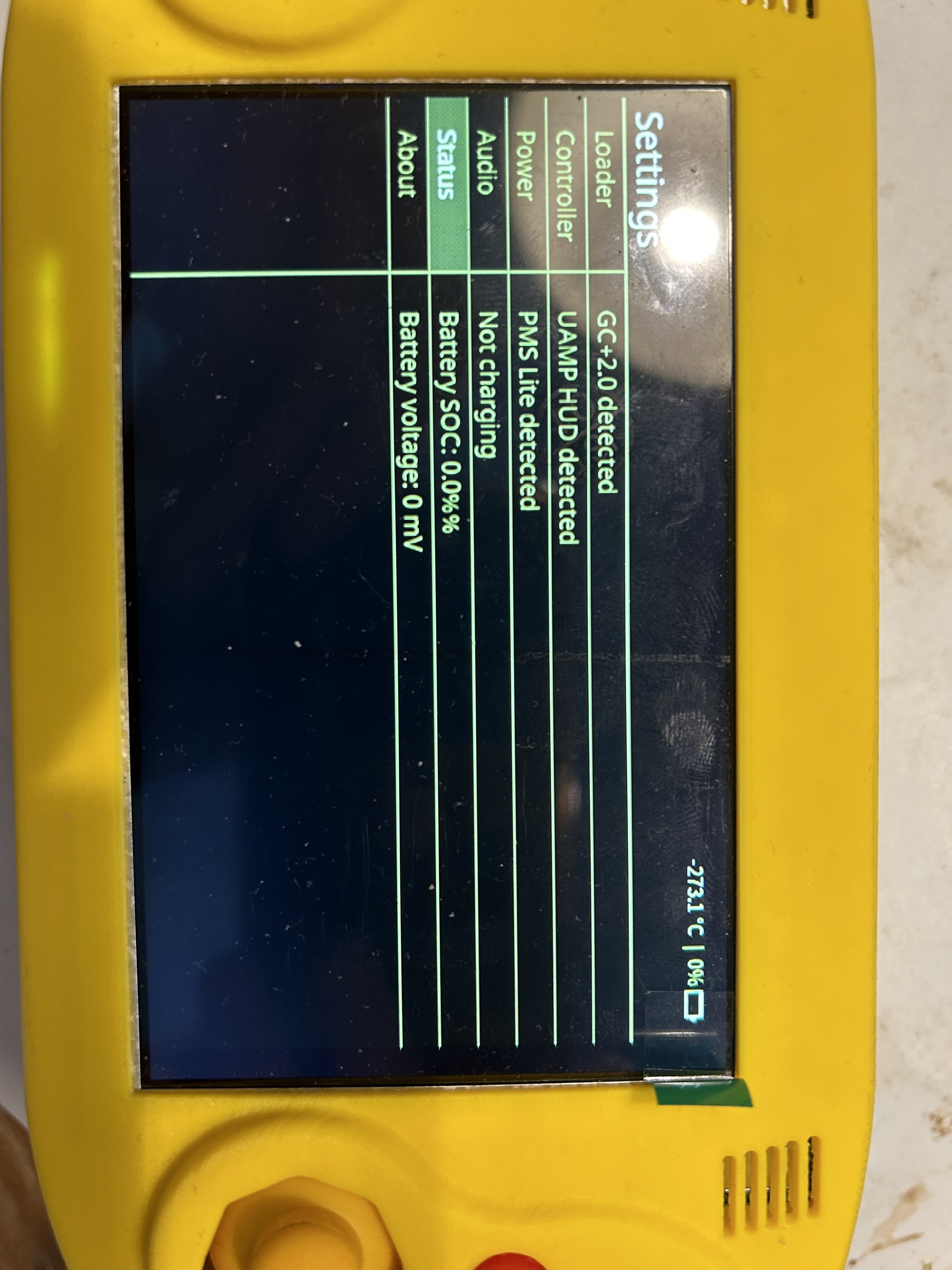

After reconnecting the battery I could re-do the update but at 99% procent the console reboots and the update is not done. (See picture )

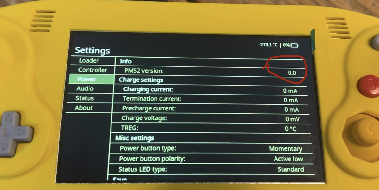

The PMS lite fw version currently is 0.0, is this correct? Im worried this happened after the first try of doing the update (see picture)
Sometimes the update succeeds, but it tell me it updated it to 0.0. And I double checked the downloaded 1.2 file. If i remove it the console tells me to put the file on the sd card. So file is at least seen but not correctly downloaded.
And im seeing all the modules. So I should at least have some communication.

I’ve contacted 4layer too, they told me to check my I2C wiring.
i re-did them. With new magnet wires. Directly from Wii to Pms lite, and from there to the Audio board.
Also to be sure, re-did my usb wires and made them as short as possible.
For know, no changes.

Did you accidentally flash pms2 instead of pms2-lite firmware? I don't know if there is any difference but your lite is reading as a pms2 so that might be the root of your issue

Not sure about the flashing problem, but the power button type needs to be set from momentary to switch mode for an Ashida
When I change the available changes in the Power menu (now it in Fw. 0.0) and I SAVE CONFIG, it doesn't save my settings.
Also not when I restart the console.
Other settings like background, audio can be changed and saved.
So my issue looks really on PMS lite related
This are the current issues I have PMS-lite related:
  • Does not respond to Power switch (re-checked my wiring, looks good)
  • Automatically turns on when battery is installed (no power switch needed)
  • Sometimes the Ashida does not turn on when I plug in the battery (but does not respond to power switch)
  • Running FW 0.0
  • Can't update it to 1.2 (but the file pms2_lite.bin is seen on the SD card)
  • Can't change/save settings in the Power menu
-Rick

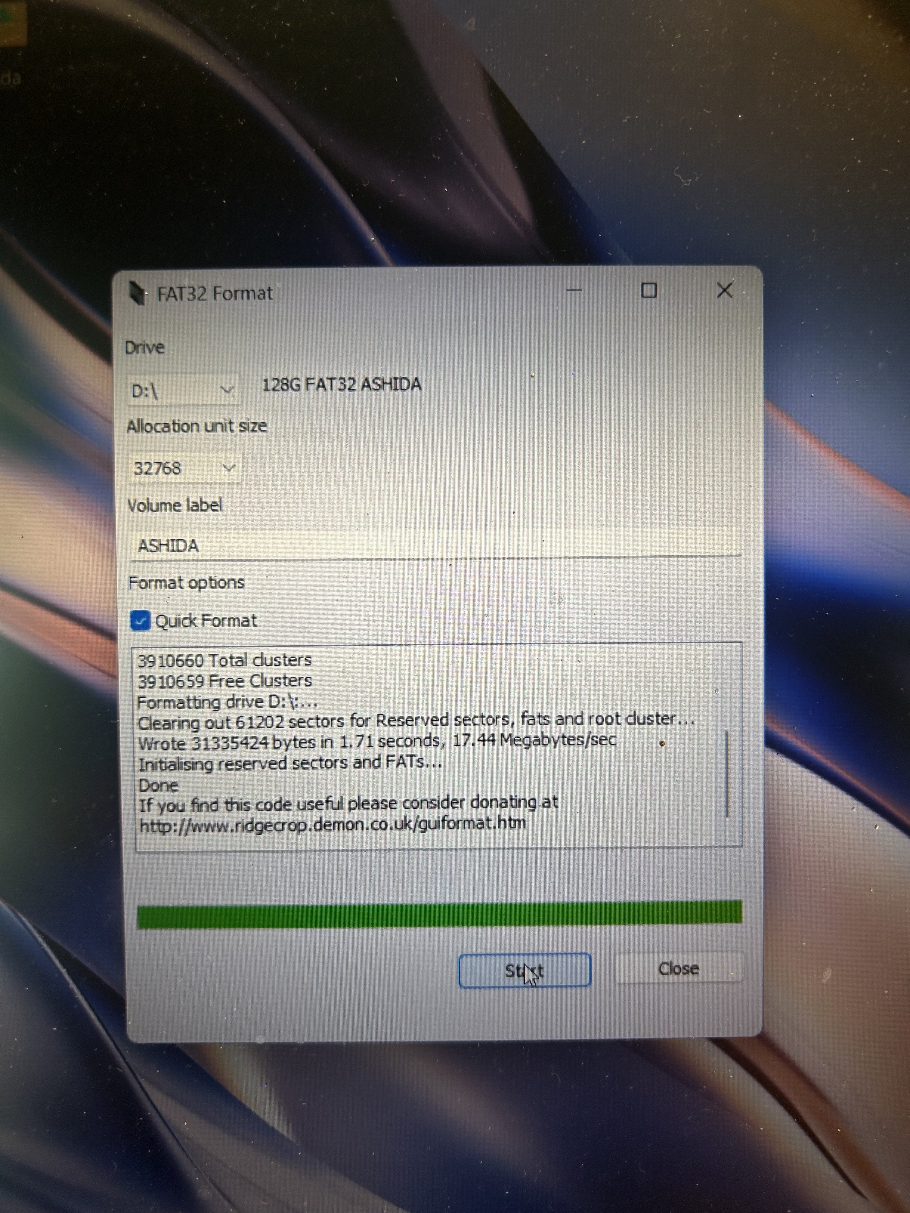

Hmmmmmmmmmmmm. I don't really know how to properly troubleshoot a firmware problem. All I can ask is whether the SD card has been correctly formatted as FAT32 with 32k clusters. If it isn't, that could cause the inability to properly load the update file
I would also redownload the firmware from the website it’s rare but sometimes files can get corrupted when downloading them so double check your SCL, SDA, D+, D-, and the format of your SD card then try flashing with a freshly downloaded bin file
I think I did format the SD card, but it would maybe help if I can get some instructions so I'm sure I did it the correct way.
I did it while ago, and I think I used Big FAT32 format 2.0.
Input for this would help, at least something I can start trying
We recommend using guiformat, you can grab it here http://ridgecrop.co.uk/index.htm?guiformat.htm. It may help to first format the SD card to another format like NTFS before reformatting to FAT32 with 32K clusters
Redownloading the firmware file might also be worth doing just in case the first saved onto a bad sector

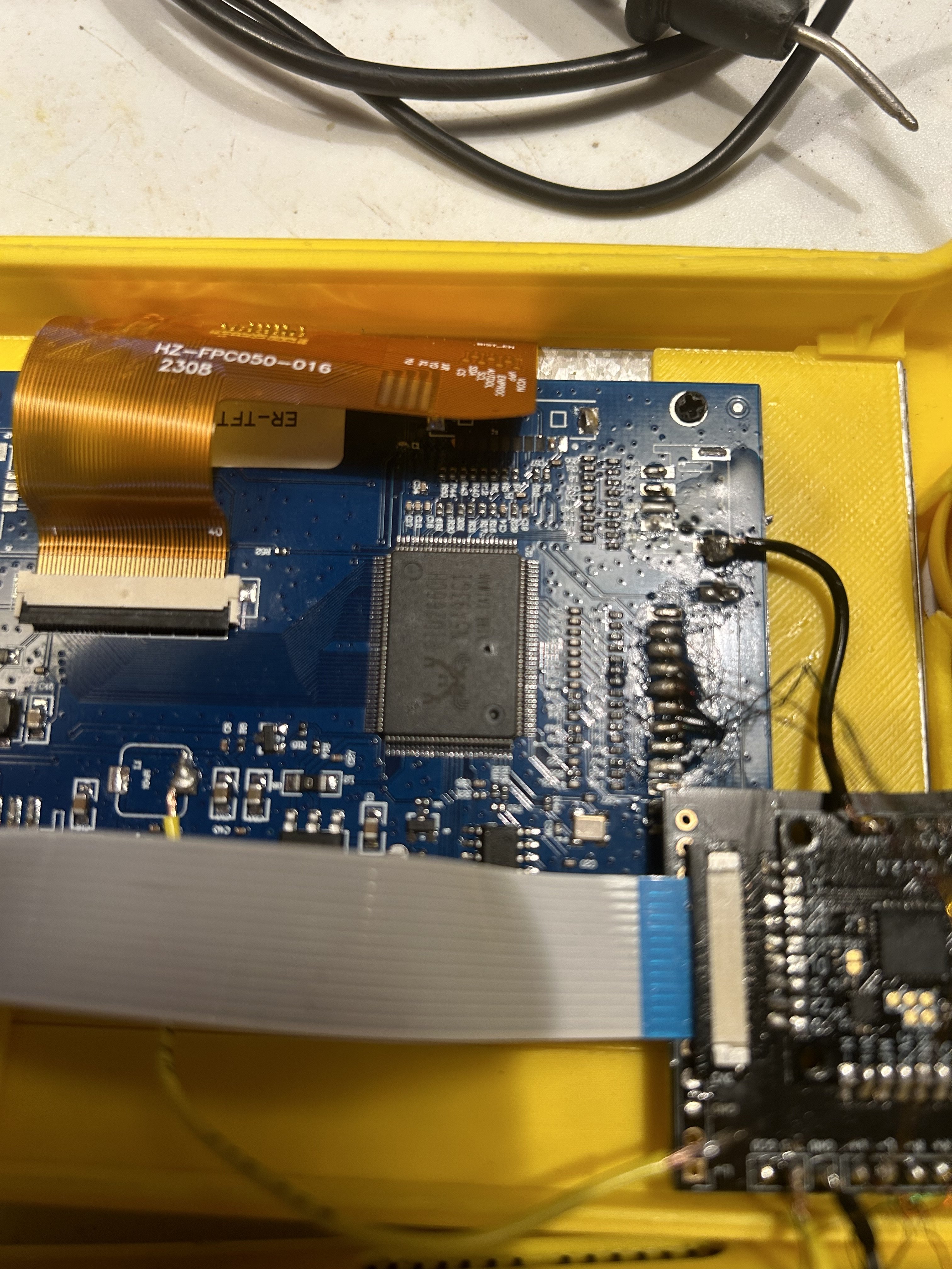

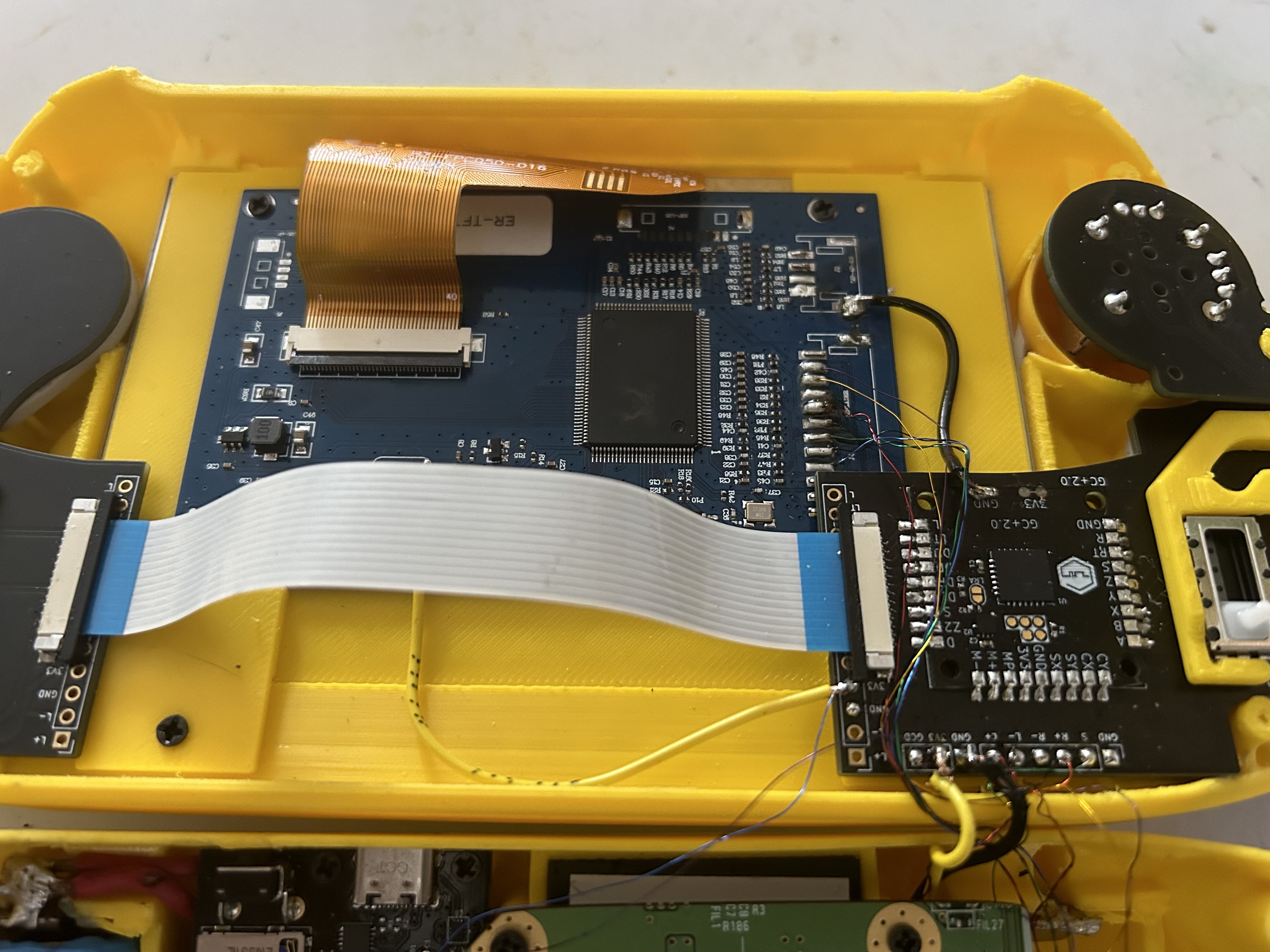

I formatted my SD again with the mentioned tool (see picture)
Re-installed all needed files again.
Re-downloaded the pms2-lite 1.2 with another browser. And installed it on the SD card
re-installed SD card.
After waiting for a few min, console turned on.
Did the fw update. This time is doesn’t even start, or in the best got up to 4% and froze up.
So, no improvement at all
The issue I mentioned in the beginning I can boot up games, only having audio and no video anymore (only blue screen) is something I will start with in my troubleshooting. It worked stable with AV, so maybe went something wrong there

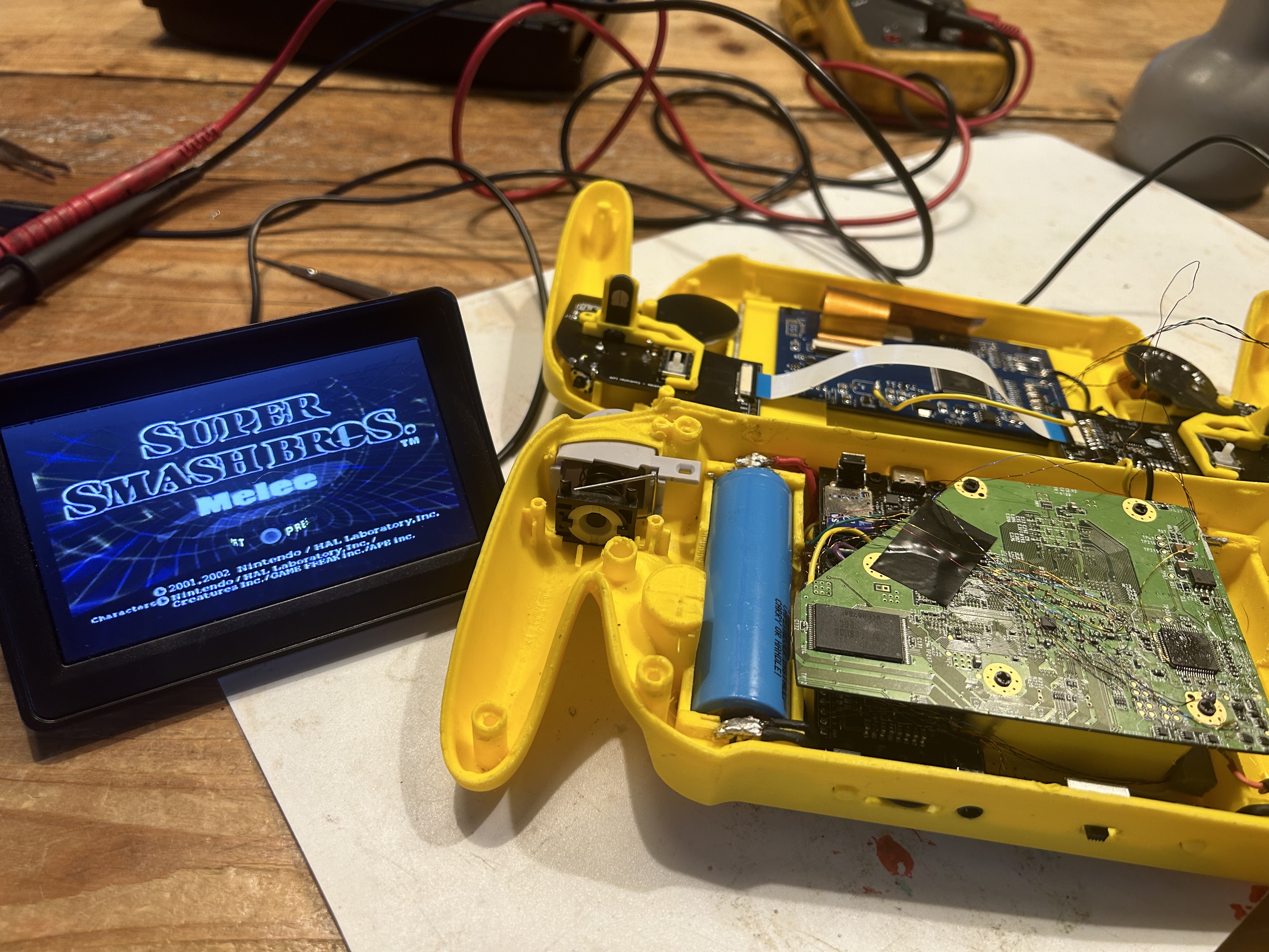

Update:
With the screen disconnected an an AV screen connected am able to boot games incl audio and video. (See picture)
So, at least need to re-do that.
Is it normal you measure around 80 ohm between each vga color and ground? (Measured on the disconnected screen board) I know the screen worked, but games did not appear anymore.

Yeah 70-80 ohms to GND is standard for VGA lines

The power button/switch behaviour is software based. If the firmware flash fails, anything that isn't just letting power flow is liable to fail
