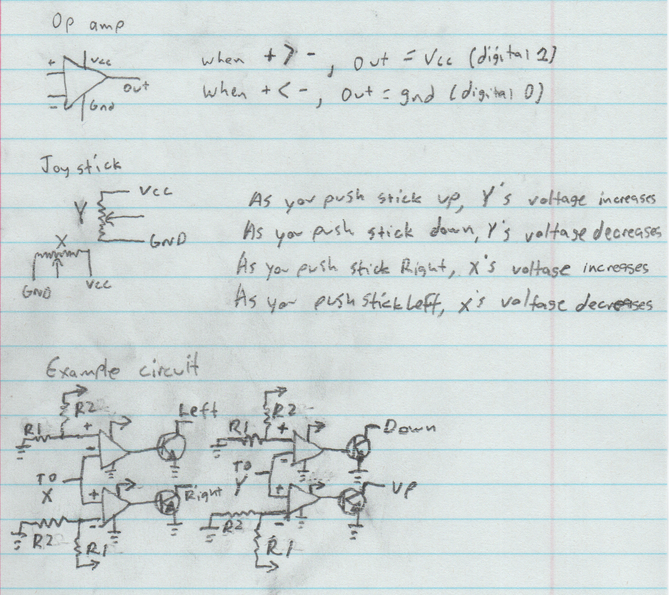

Thanks for the help. I'm most interested in the solution involving comparators. (I like making circuits.) However, the extent of my knowledge of circuits is measly, and transistors especially are tough for me to understand. Could you elaborate on the conparator thing?
An op amp would be the easiest comparator to use, as you input two voltages, power and ground, and it will output either positive voltage or ground depending on which voltage is greater. Here's a sample of what I mean (sorry my handwriting is bad...):
Yes, exactly what I meant.
A couple additional things:
- Make sure to get an op amp that can be powered with a single supply (+V and GND). Since you need 4 op amps you can use an LM239.
- To add the possibility to enable the circuit by pressing a button, use a button as an output enable for 3-state buffers (such as 74HC125). You want to place each one of the buffers between the output of each op amp (connected to the input of the buffer) and the npn transitor (the base connected to the output of the buffer). Also you should add a pull-down resistor to each base of the transistors to make sure that they are always disabled when the button is not pressed.
