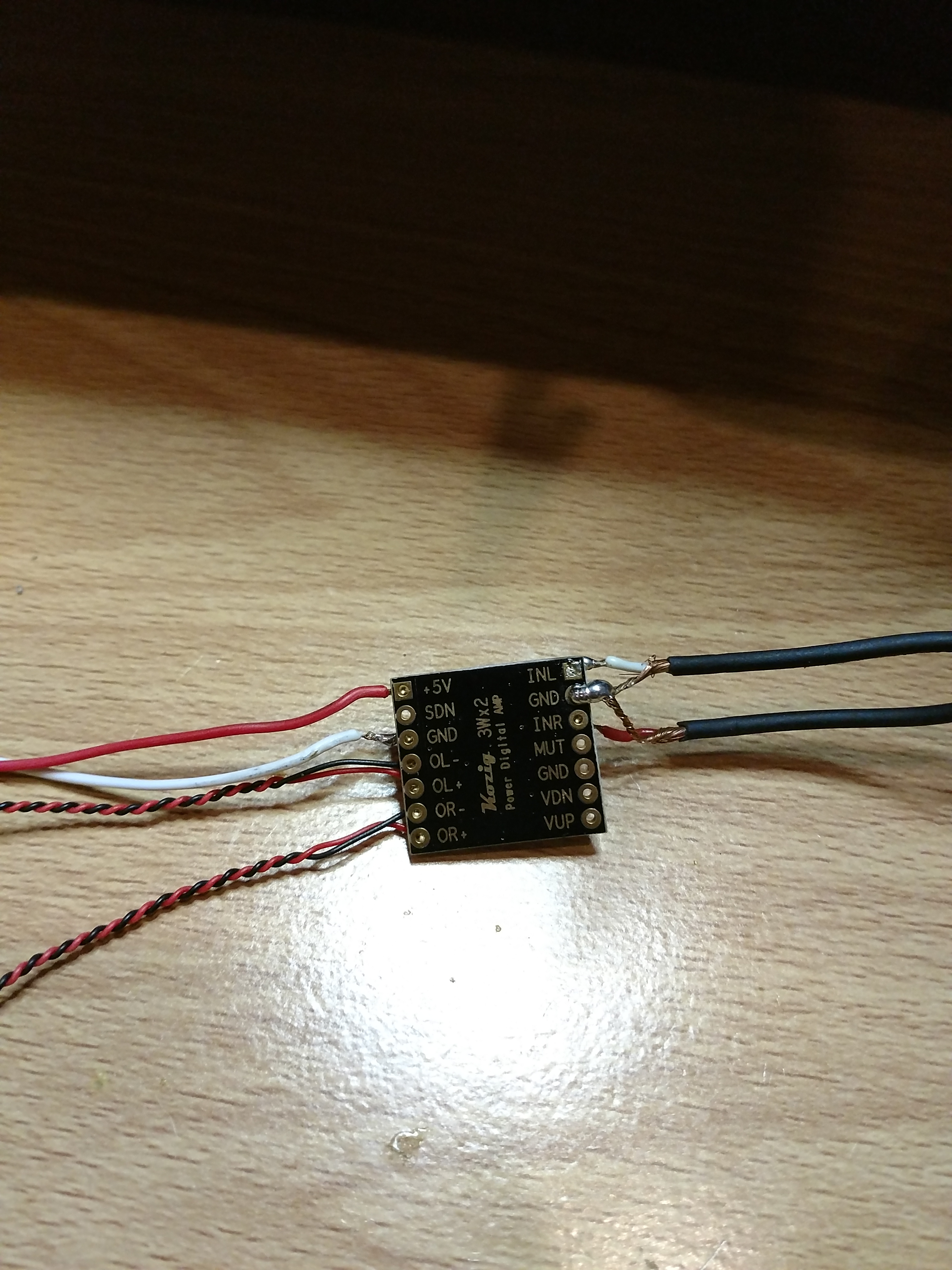

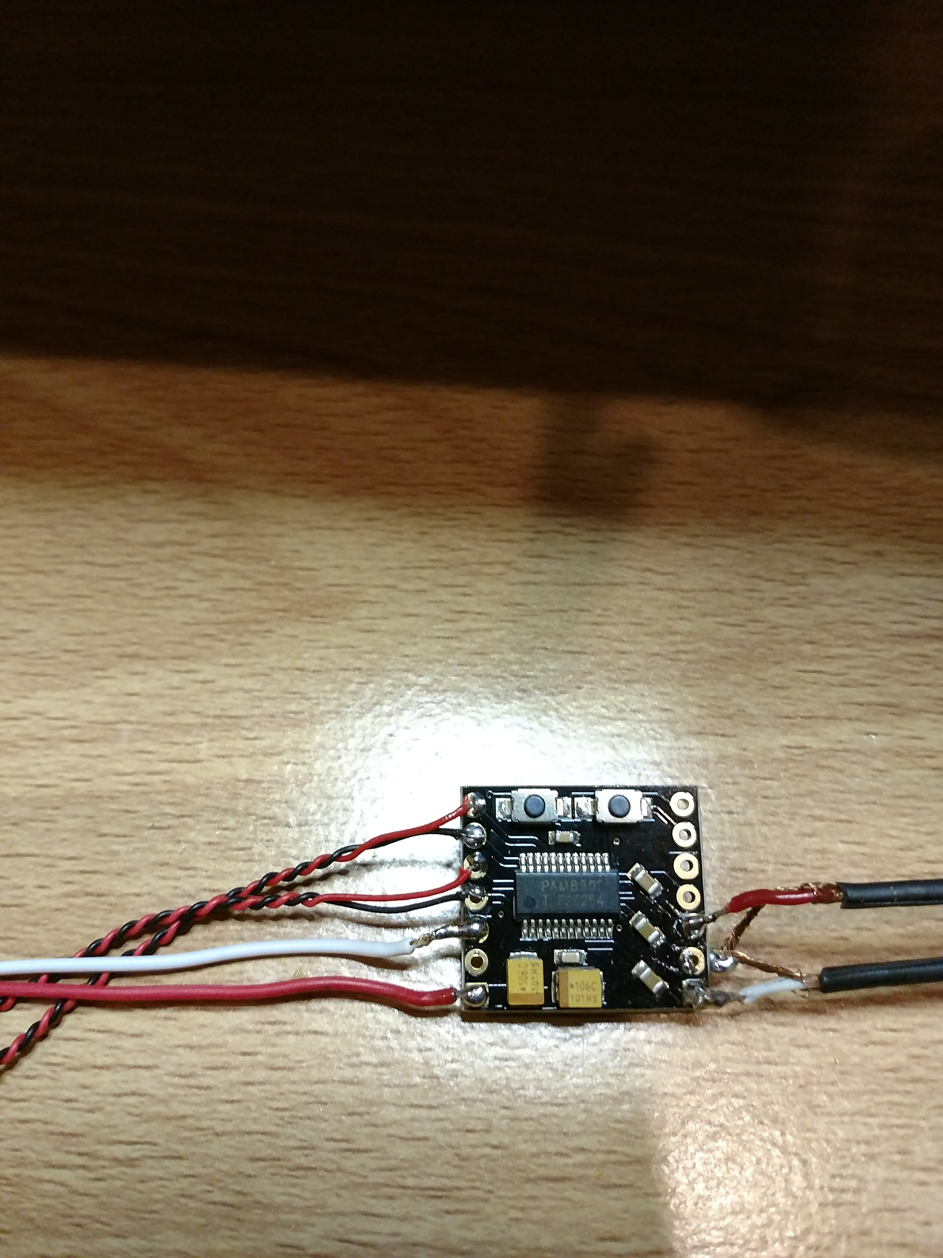

Paul3854 . Joined Feb 2, 2018 Messages 85 Likes 37 Jun 9, 2018 #1 Can somebody help me (this is the amp from the bom), I feel like I wired this correctly yet I can't get it to work. I just wanted to test it so I hooked up my left and right input to a 3.5mm jack. My 5v source is coming from a 5v 2a USB source.
Pacal . Joined Jul 30, 2016 Messages 166 Likes 361 Location Seattle W.A Portables RDP 64 Jun 9, 2018 #2 You need to bridge the 5v pin and the sdn pin to make it work
