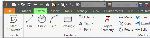

There are a lot of tools at the top. I've gone ahead and broken down the toolbar into two halves and I'll point out the stuff we care about.
This is the left half of the toolbar. Line, Circle, Arc, and Rectangle all have those little drop-down bars that let you pick other shapes as well. Use them to make the shape that you want.

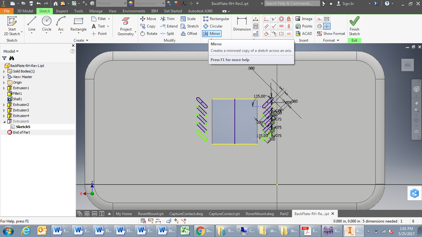

Moving on to the right half. The mirror tool is a life saver when making vents. You have to draw a line to reflect across to use it, but it makes it so you only have to tediously design and dimension one side of a complex vent. (Those vent holes were made with the "slot" tool by the way. It's under "rectangle".)

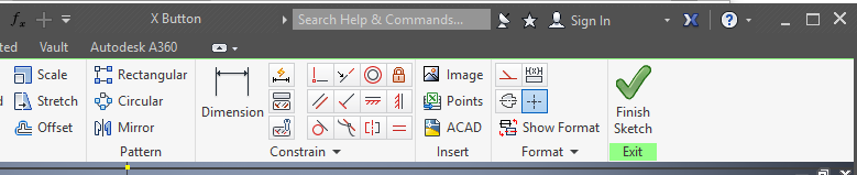

The next thing that we really care about is the 4x3 box with 12 different tools. All of these have different applications and uses, but the ones I use most is "equal" (bottom right) and "lock" (top right). I use the rest sporadically, but I would hover over each of them to get a feeling for what they can do.
When you are all done with the sketch, go ahead and hit the "Finish Sketch" button. This will bring you back to the 3D design area.

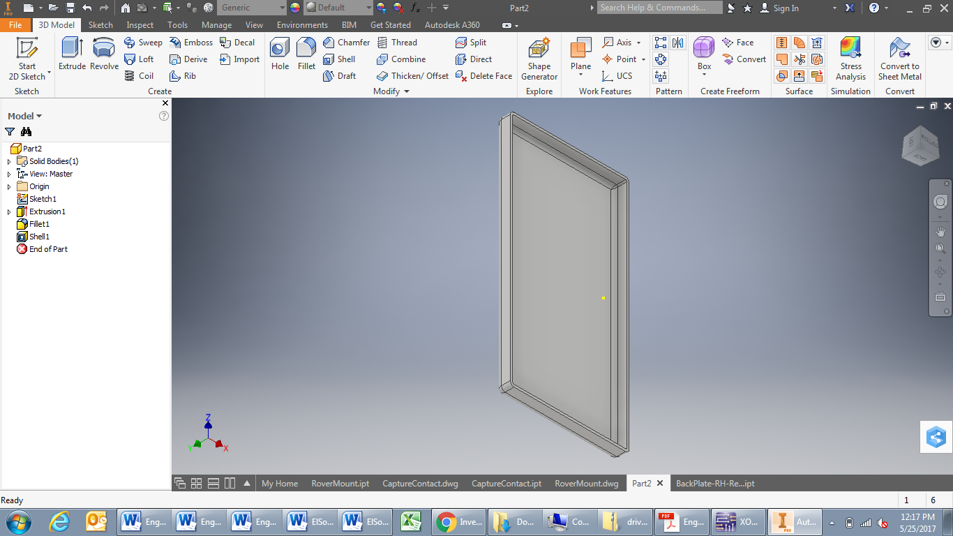

Want to curve that part? Use the fillet tool again, but this time the 3D one. Select where you want the fillet and how big you want your curve to be. Perfect.
Now assuming you want to be able to put stuff inside of you case, you're going to want to make the inside hollow. We use the "shell" tool for this. Click on the shell tool, and now select the BOTTOM of your case. If you pick a different face, your shell won't turn out like you want it to! The dimension you put in is how thick your case will be. I would recommend not going lower that 0.08, but you can get away with 0.05 on some printers. Now it's hollow!

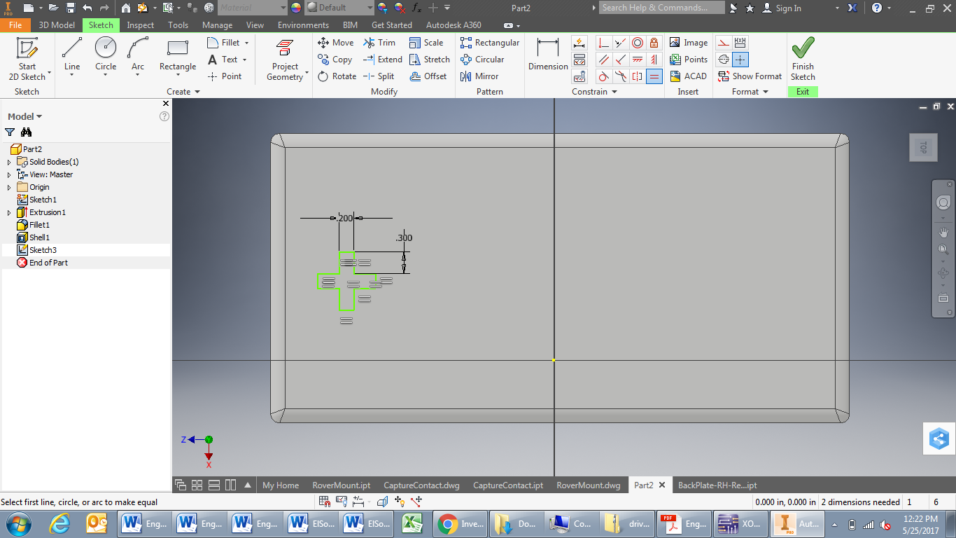

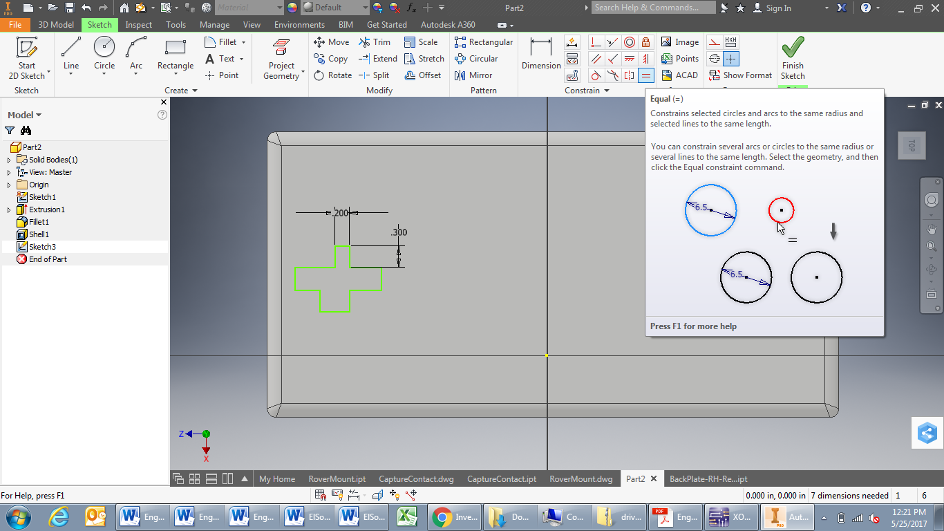

Now that you've got the basic shape for your case, the next step is to start making holes for buttons and such. To do this, hit the "Start 2D Sketch" button again. This will let you start a new sketch where you can make a new hole. I went ahead and designed a DPad by dimensioning two parts of it and using the "equal" tool to make it look (kind of) like a Dpad.

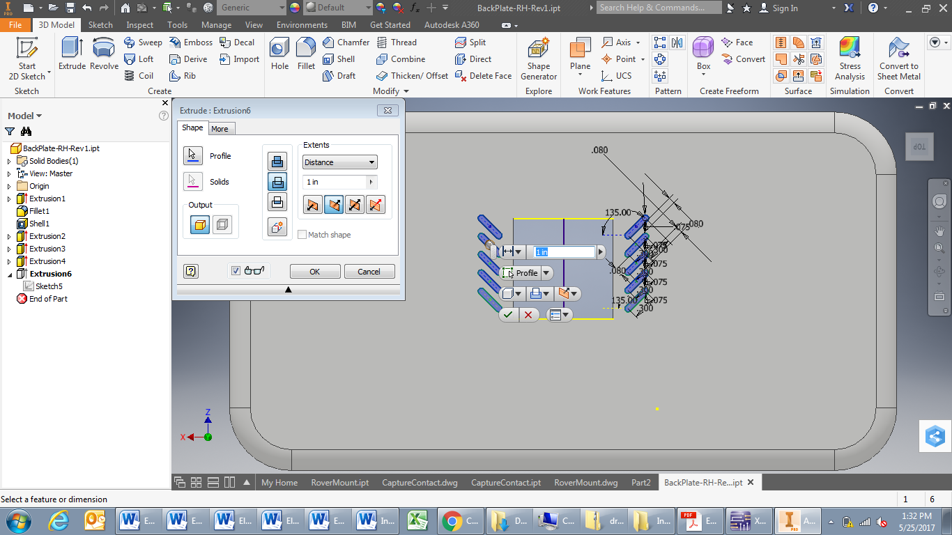

The process is the same for making ABXY holes, or a gap for your screen, or pretty much anything else. The one exception is that when you extrude, you should hit that drop-down bar that pops up. This opens up more extrude options, and one of these is to "cut". This is what you should use to make holes and gaps.
(To cut, just make sure what is highlighted blue in this picture is highlighted blue on yours.)
If you have more than one hole in a sketch, then just Ctrl+Click to hit more than one.
