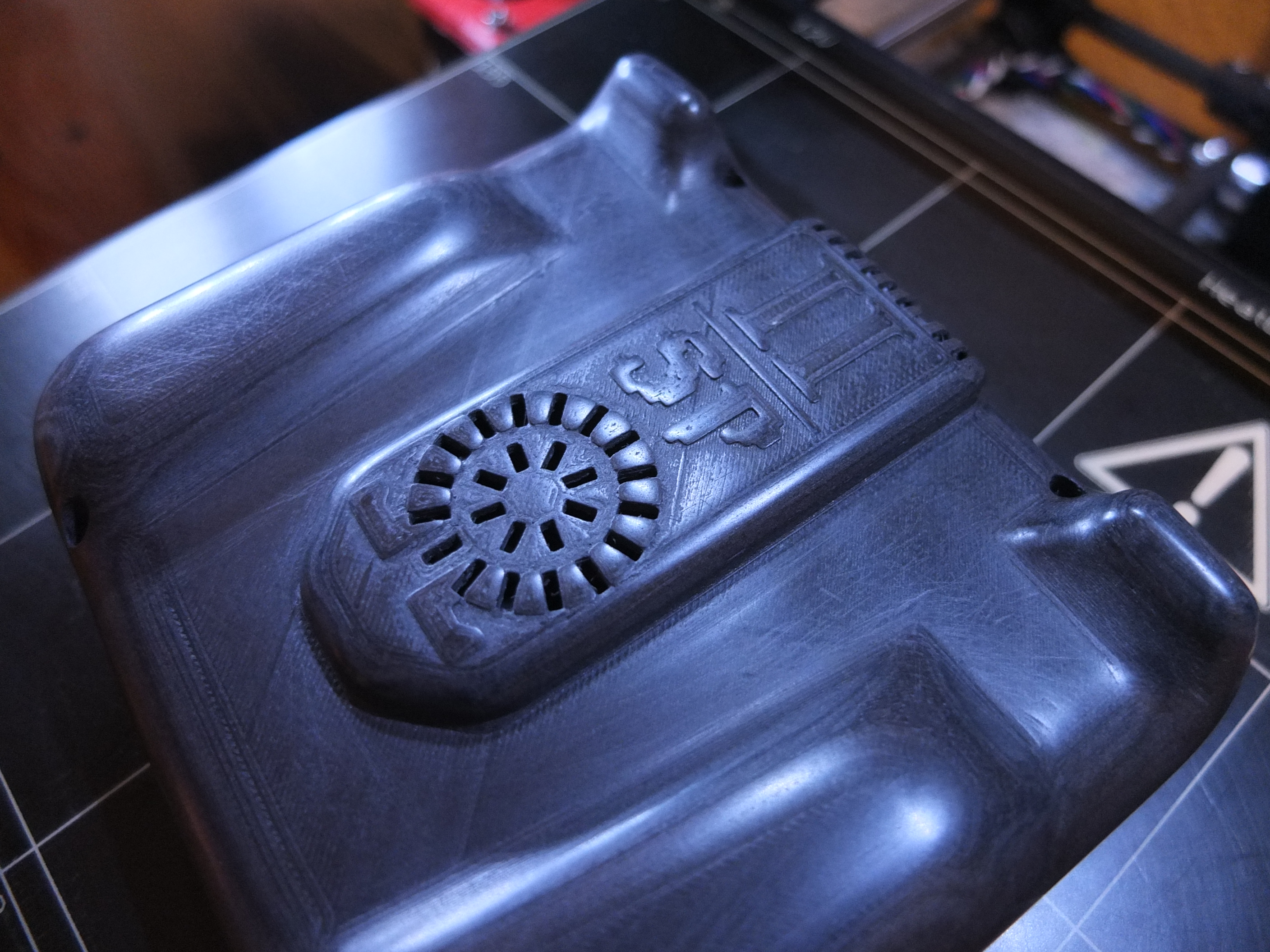

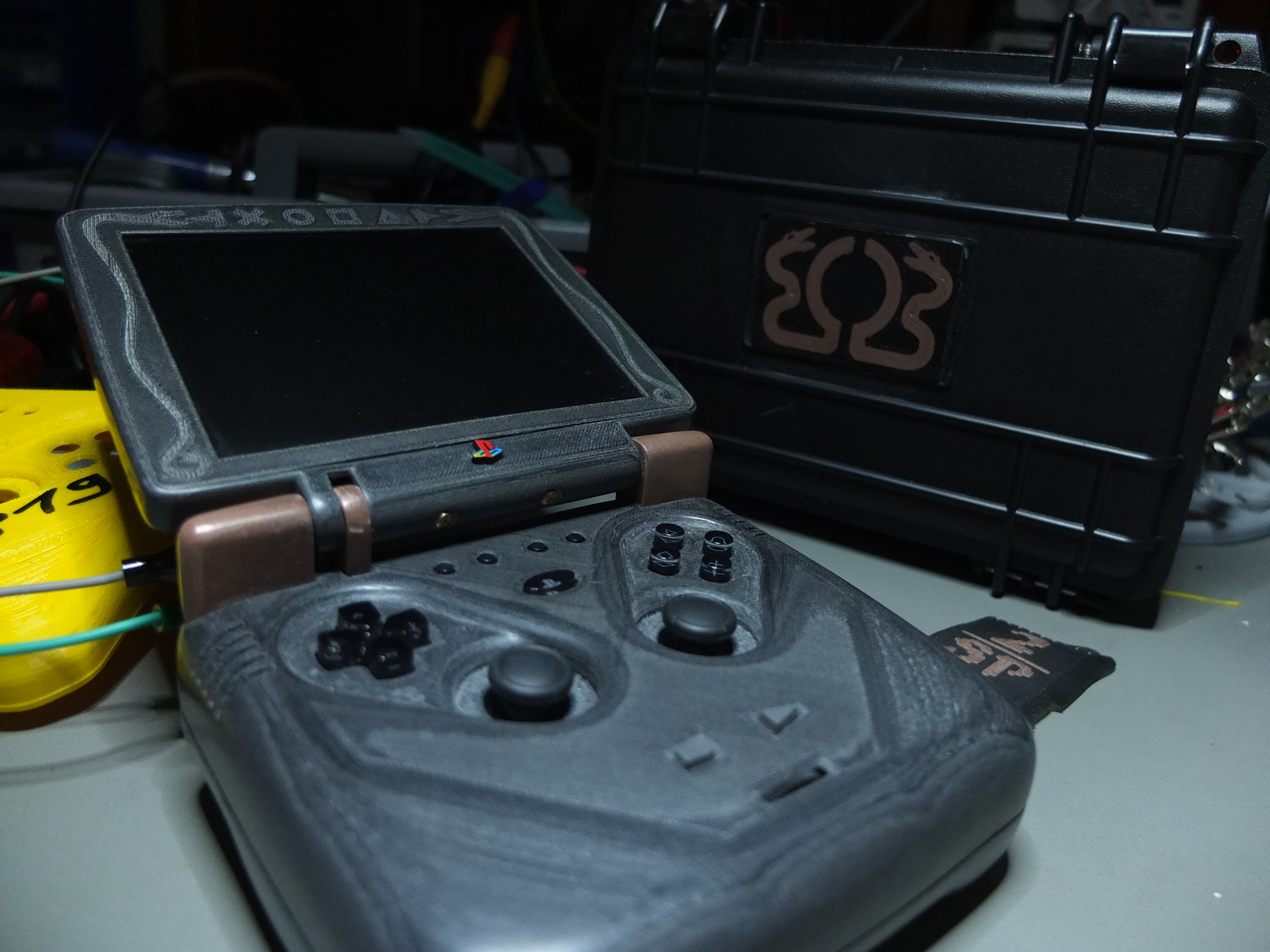

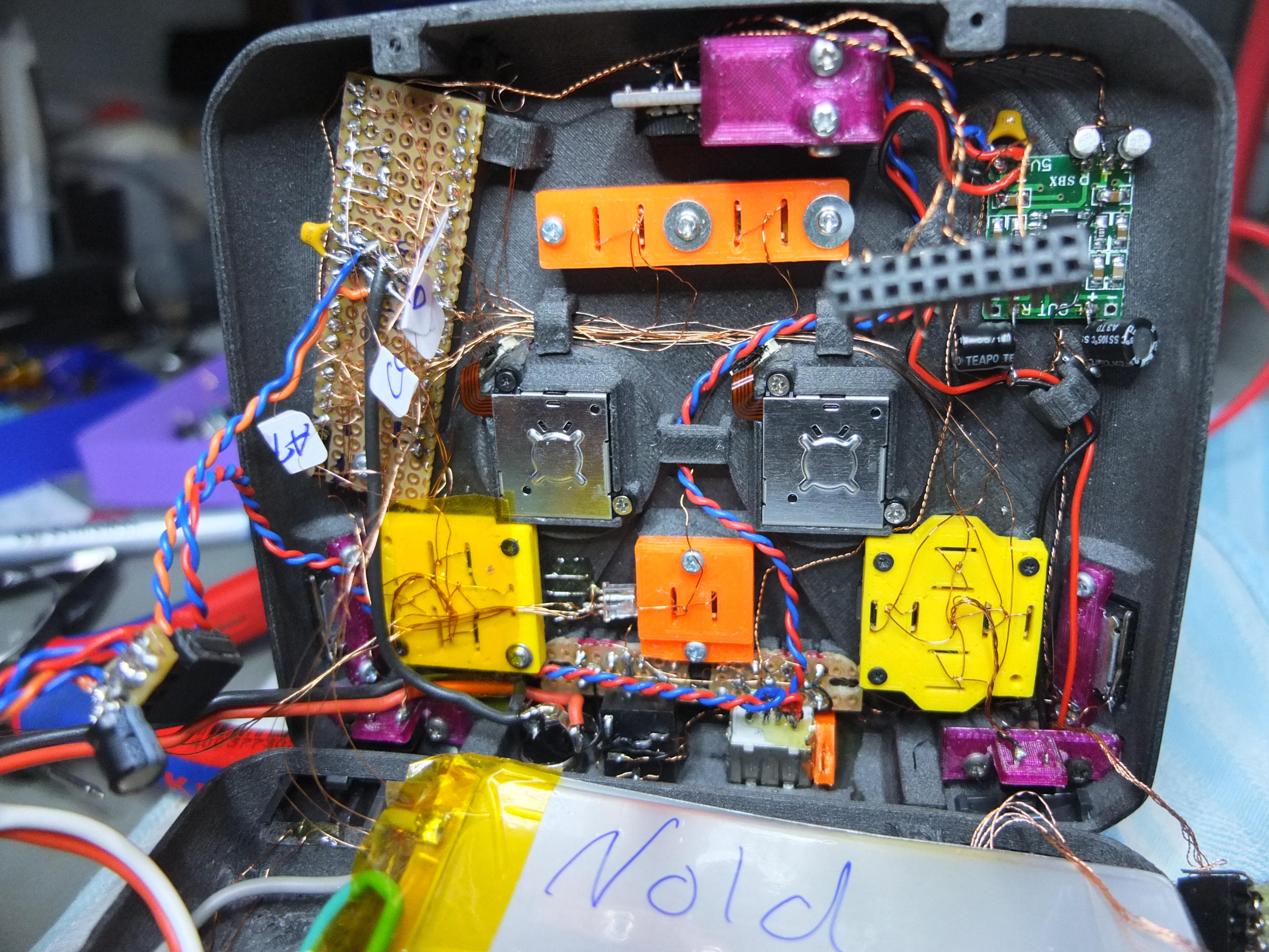

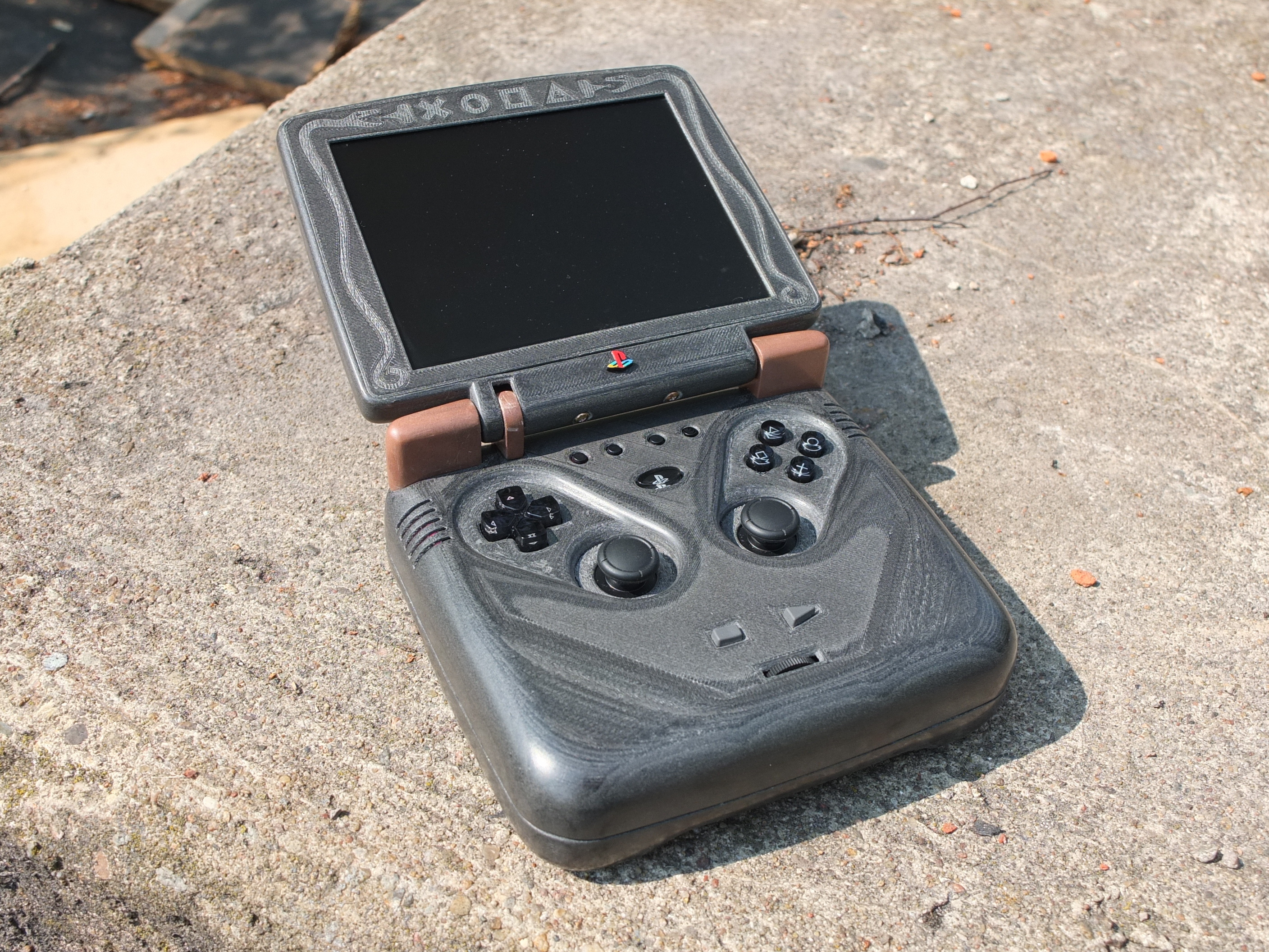

It"s finally done.. you should get all the details in the video.. might add more stuff soon.
Entry Video:
Another video i recorded right after finishing the build:
## features

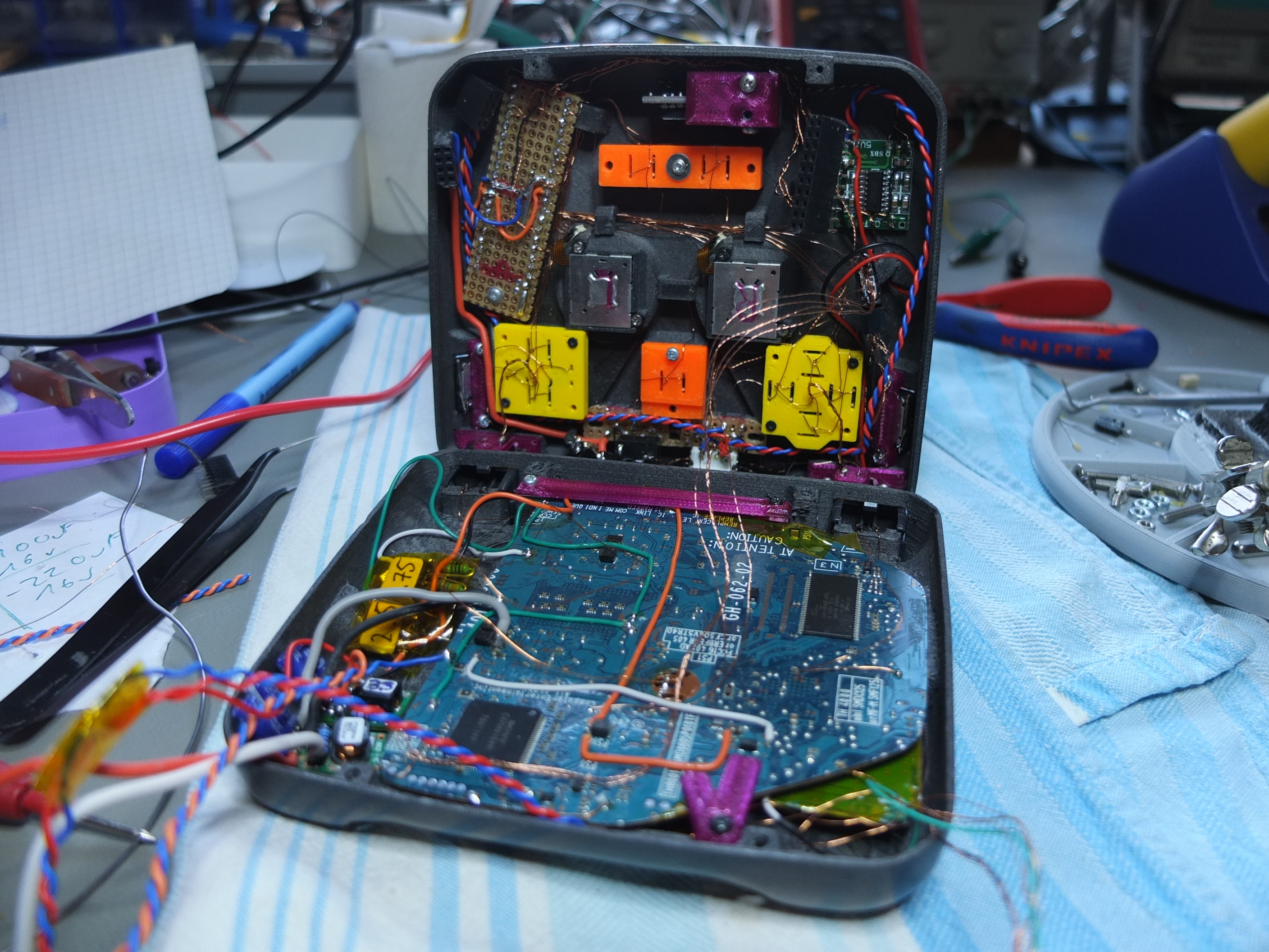

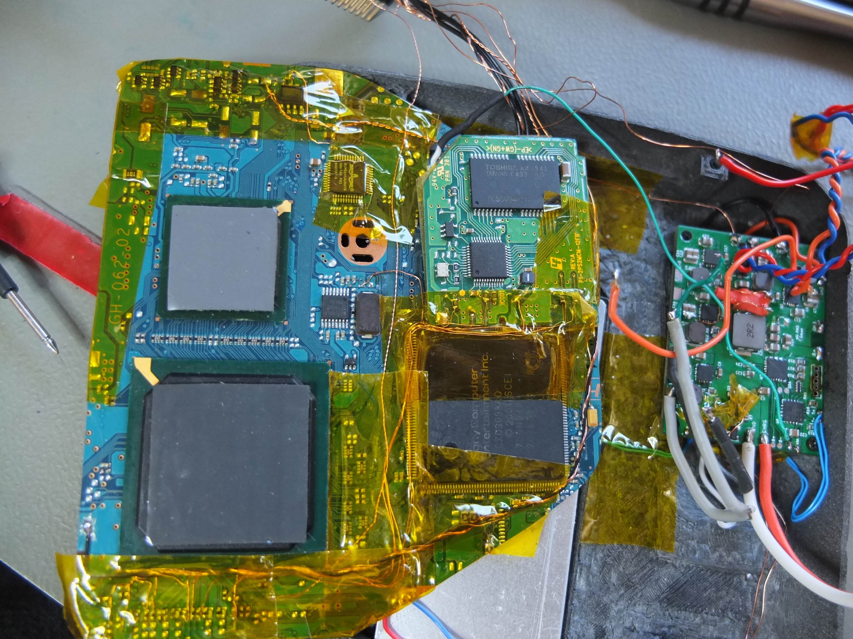

- ps2 with free mc boot
- ps2plus with switch analogs and ps2 vita / ps2 shoulder buttons

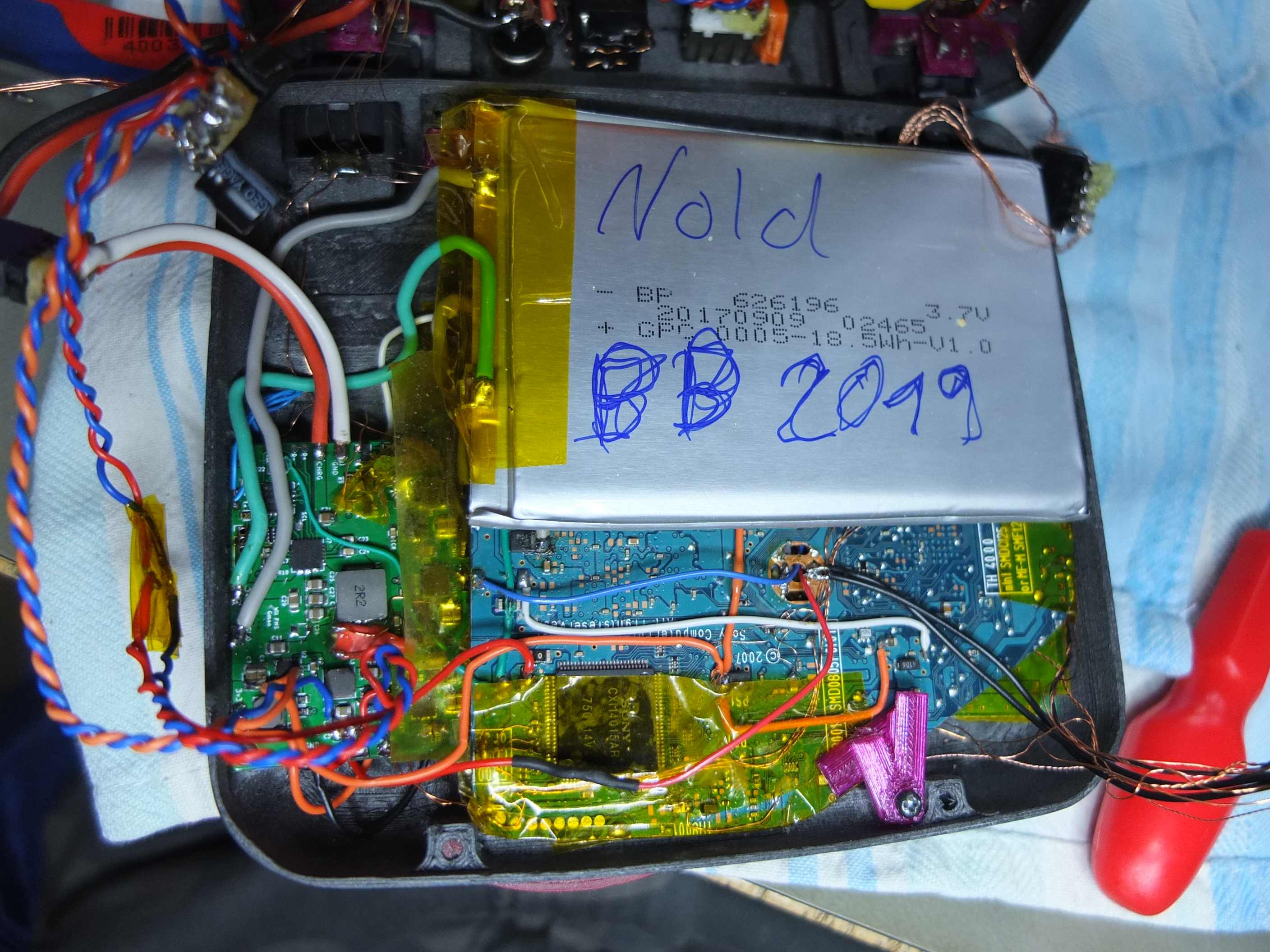

- modded pms and 5000mAh battery

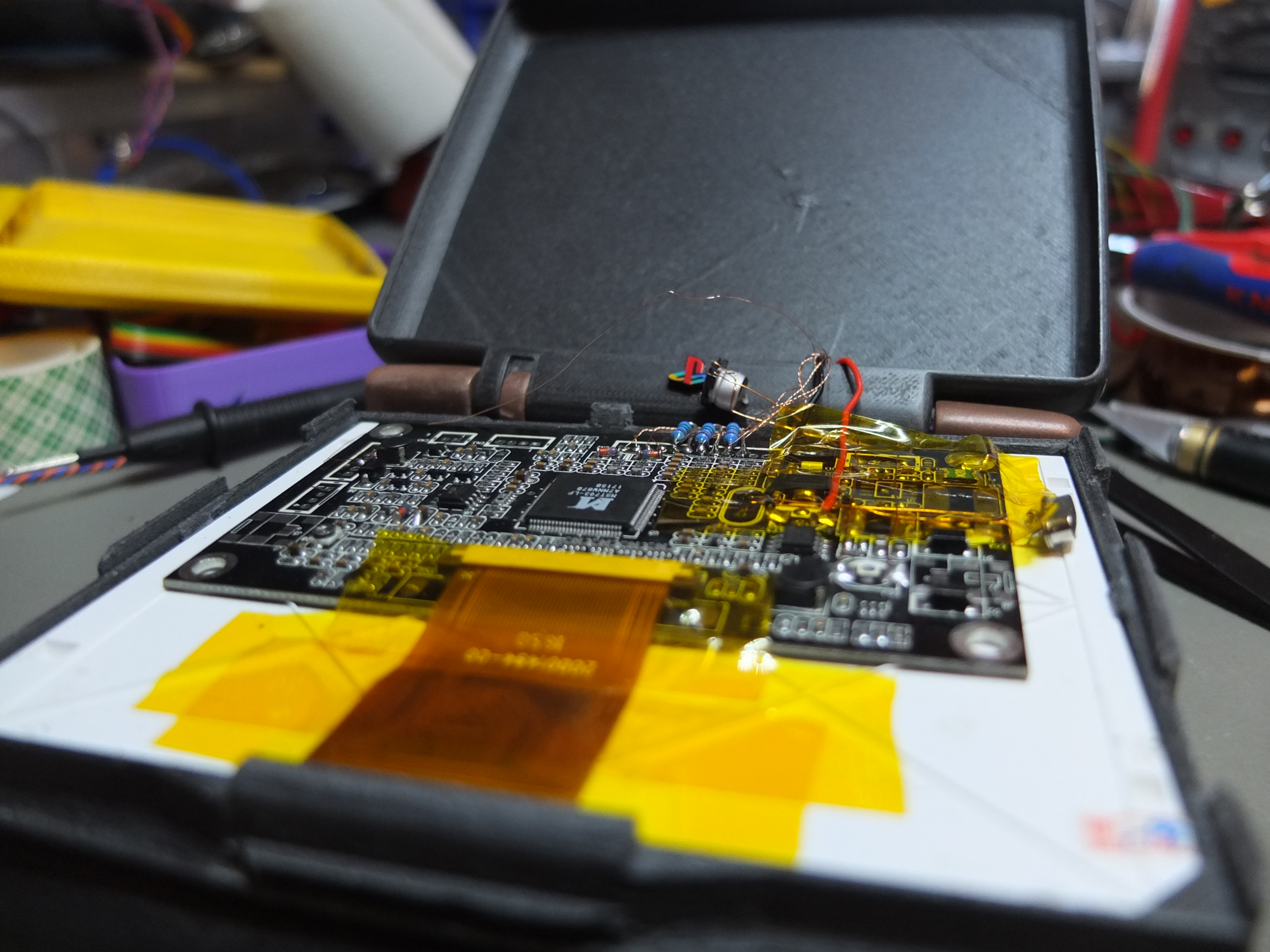

- 5 inch 4:3 screen / vga
- pam8803 speaker plus headphone jack
- plays games from usb
- clamshell case
- made from pet based carbonfil
- and pla based copperfil
- sanded for hours

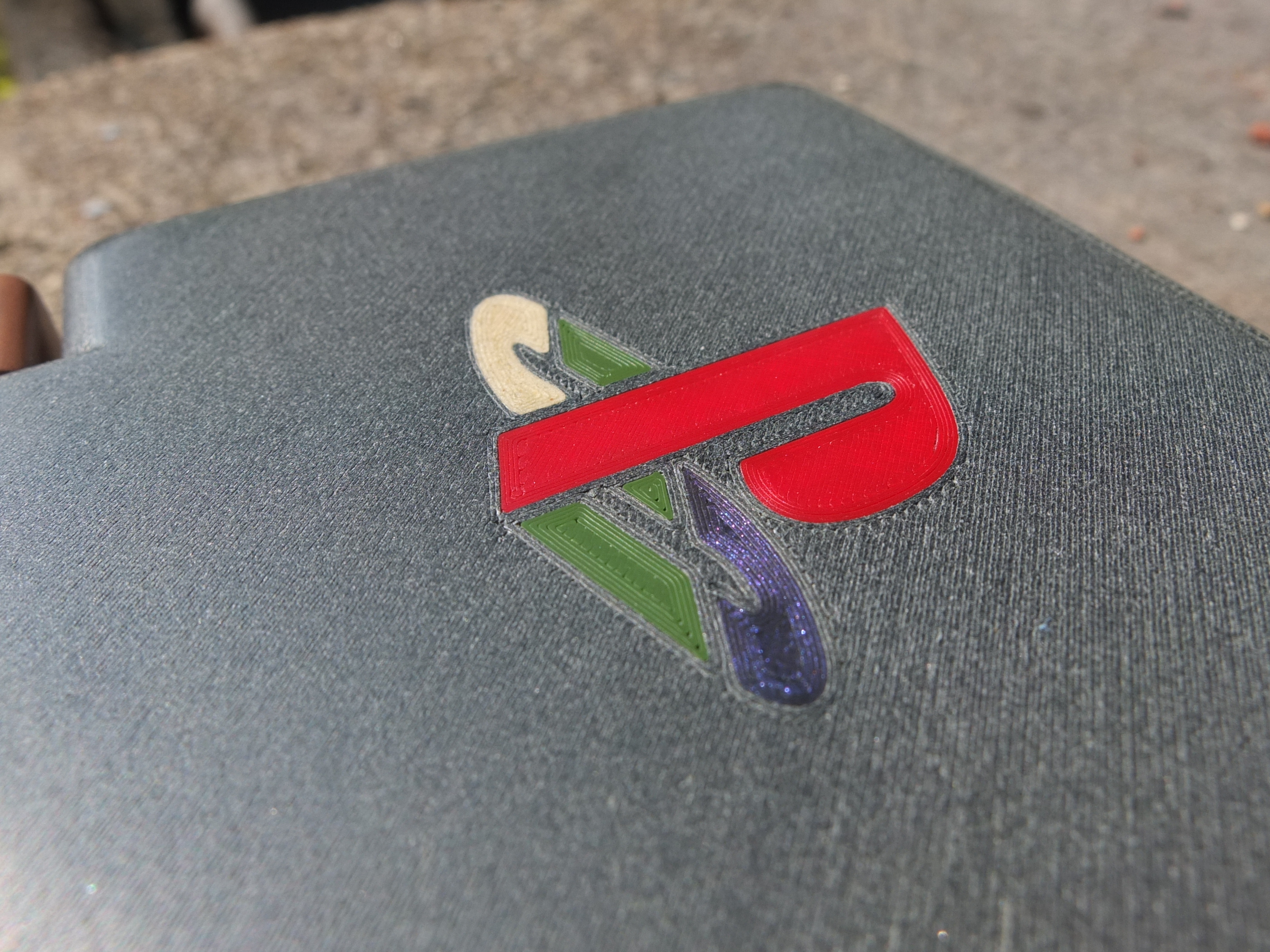

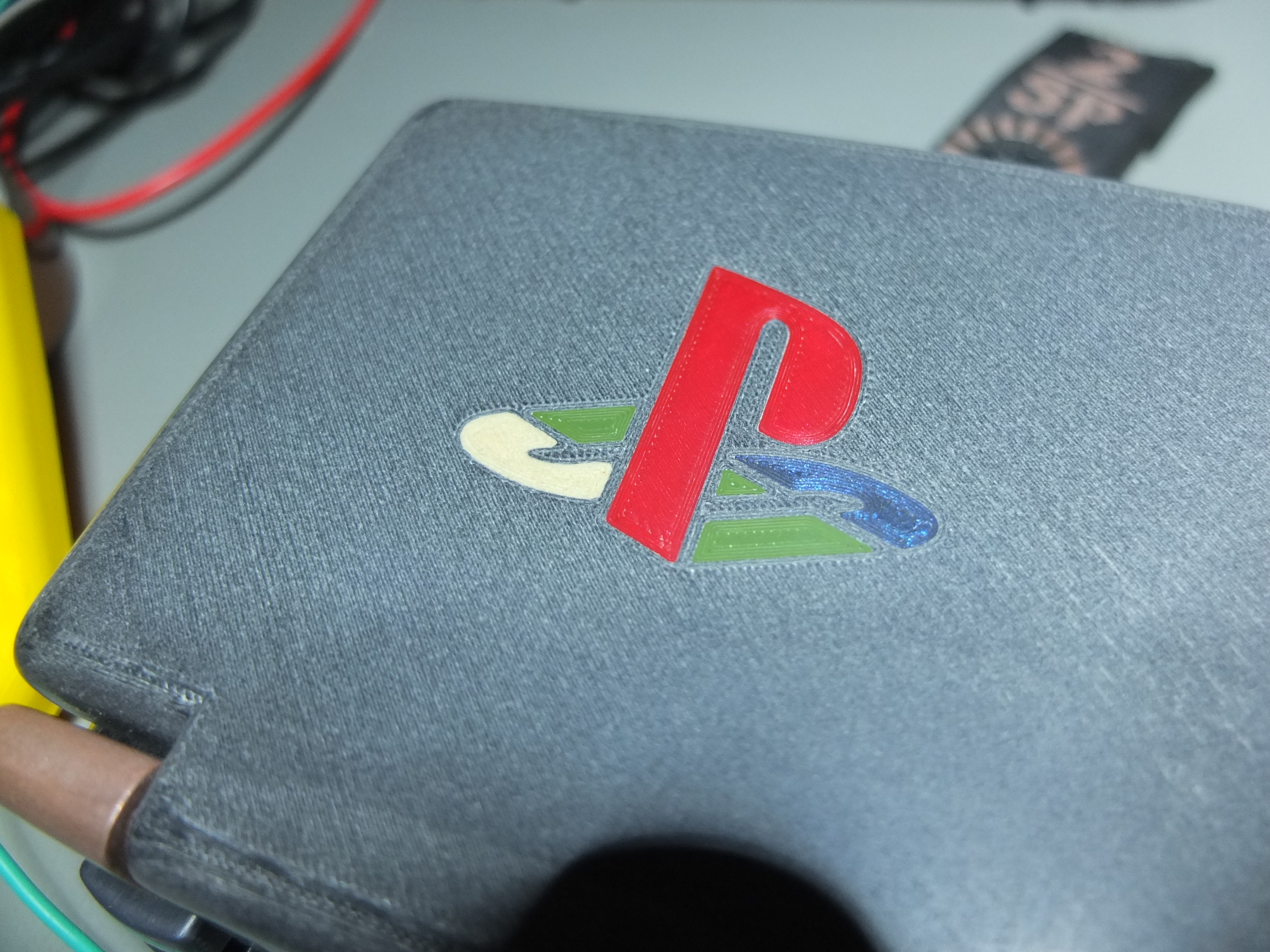

- special inlay on top

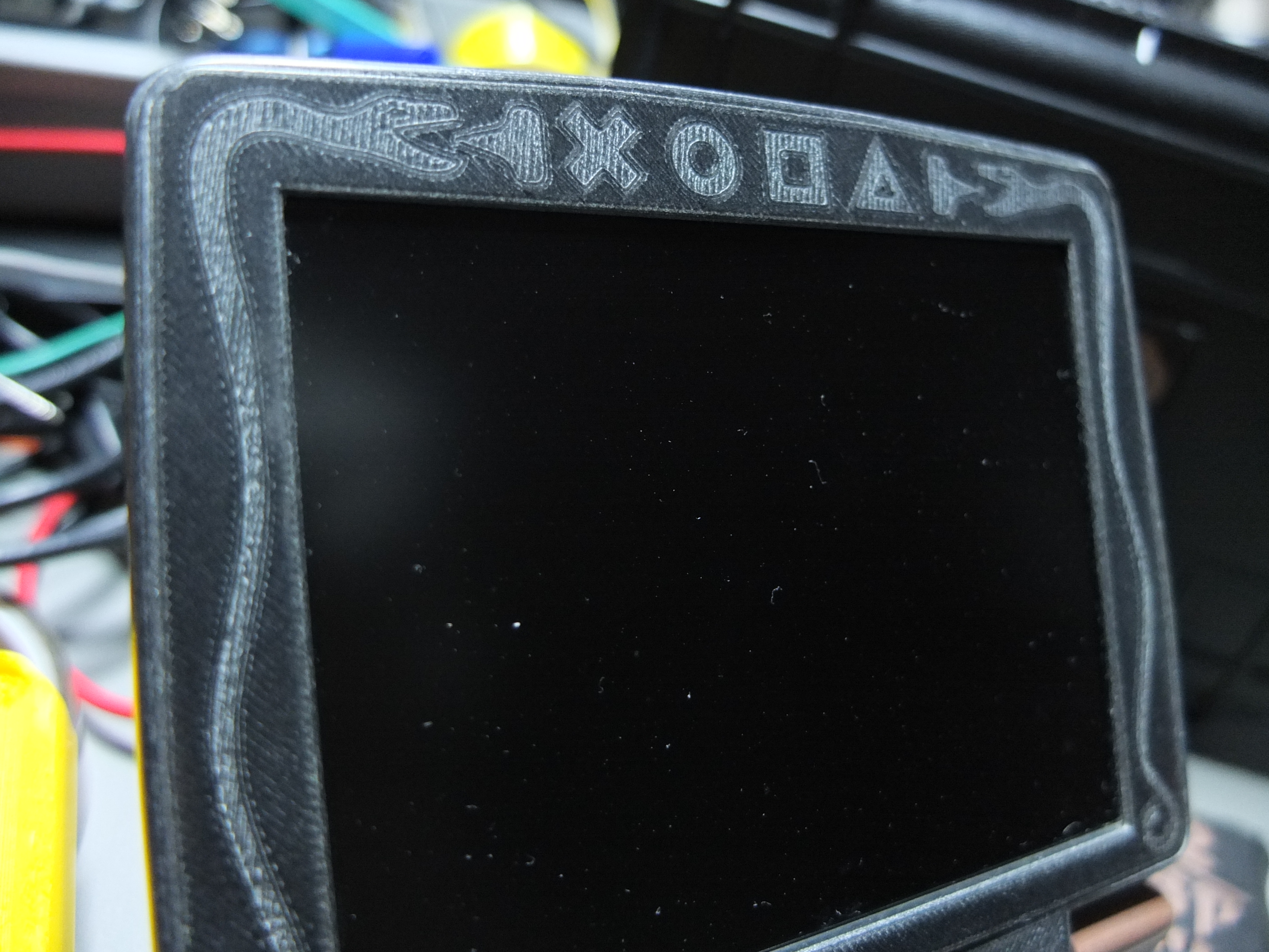

- inlay on display front
Worklog: https://bitbuilt.net/forums/index.php?threads/2sp-nolds-first-ps2p-clamshell-case.2714/

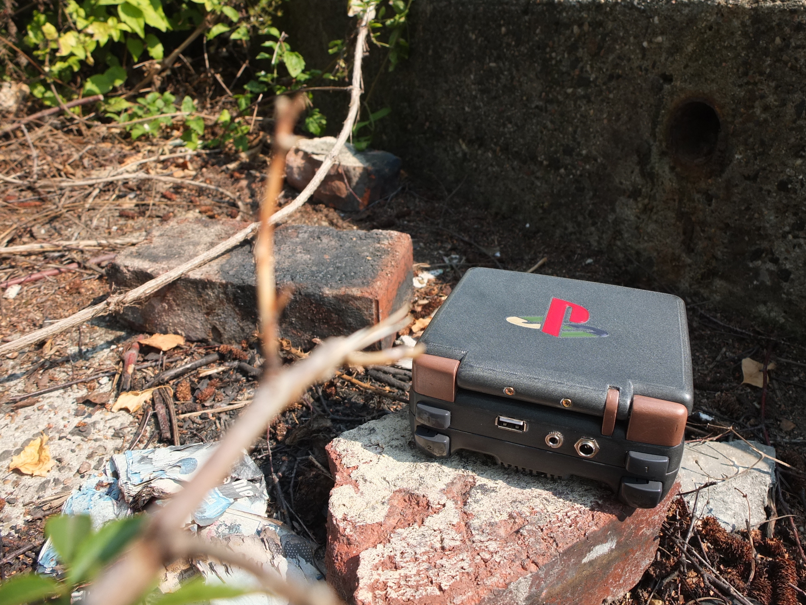

//Edit
We went outside today, so i made a few "promo pics". See main post.
