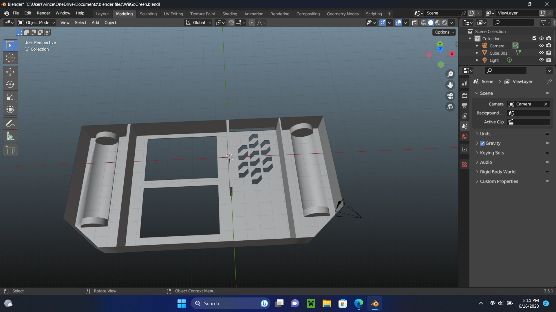

ok guys just a minor update i have the general layout of the bottom half of the case. i still need to add posts for the boards im using and the actual wii. my goal for the panels is to have the sit nicely in an indented area and the maybe use silicon or something to secure them.
You may find it easier to design the case in a CAD software like Fusion360 (it's free and what most people here use to design cases and such)
yeah i saw that most were using that but i alr had blender. ill give it a shot tho

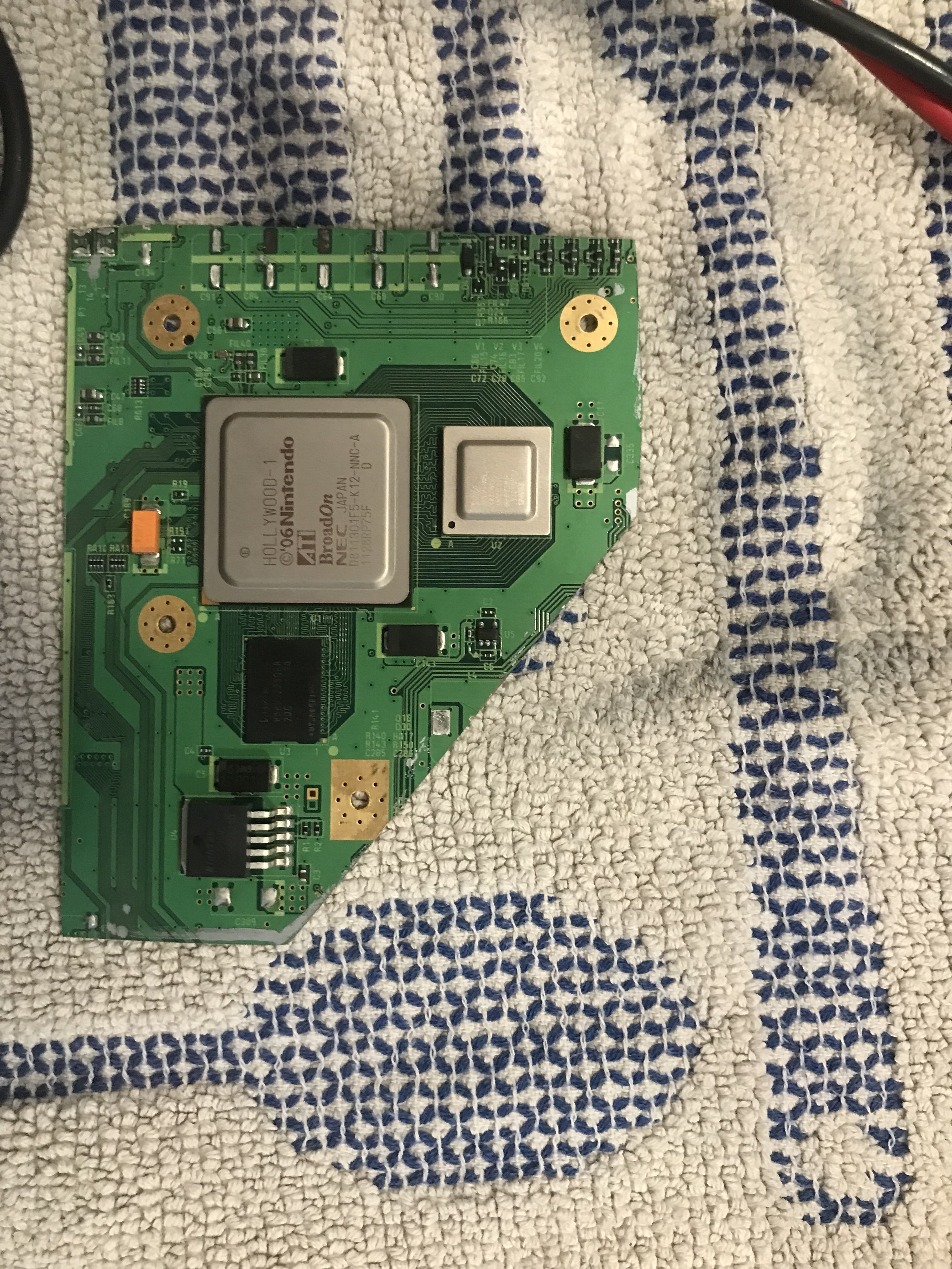

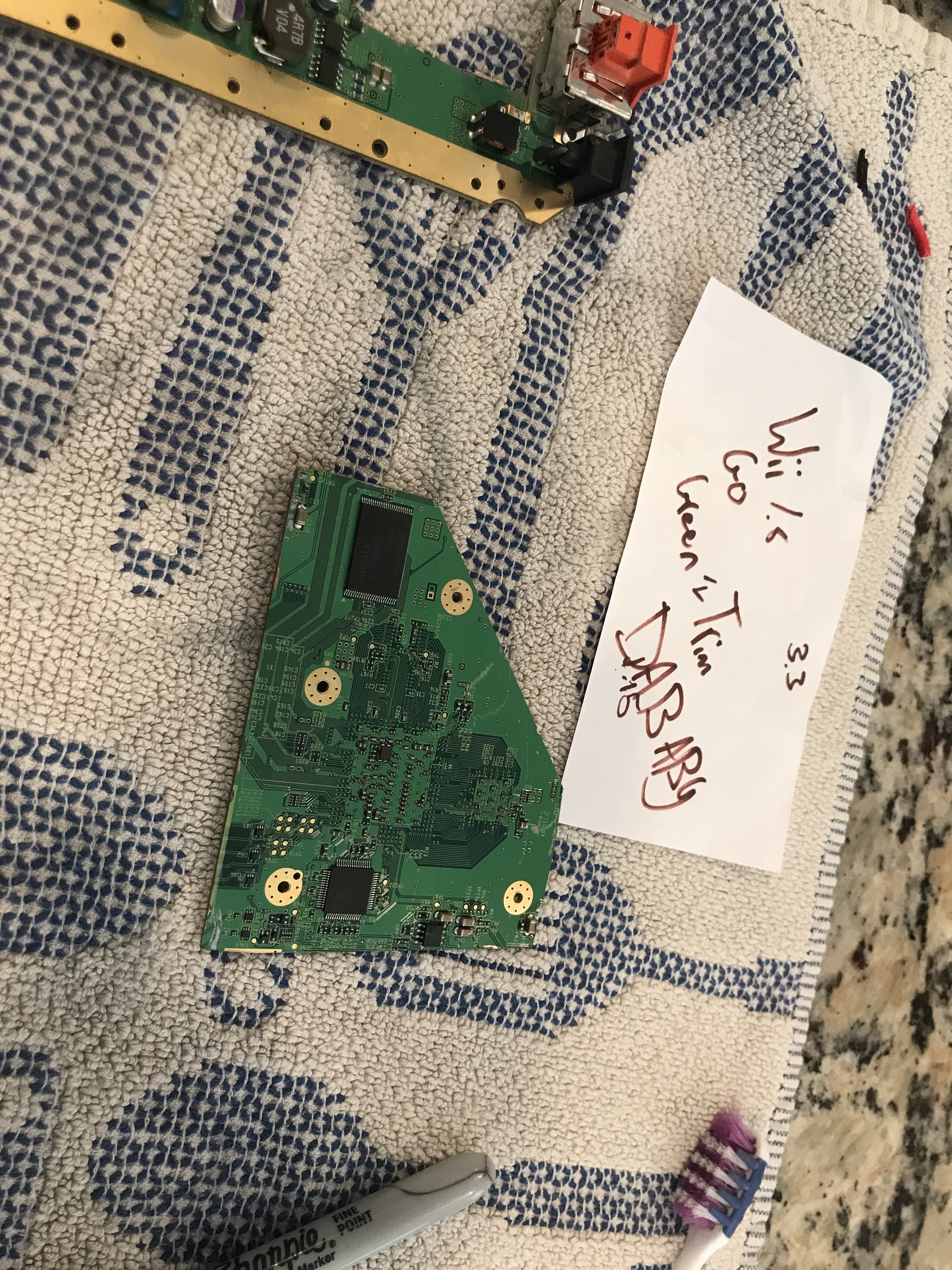

Ok so today i got the wii all trimmed up. I think my multimeter kicked the bucket a while ago so i haven’t measured resistance. However the trim looks alr and the edges are smooth as a babies ass so i think its good lol

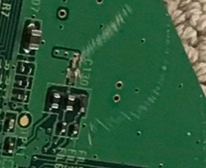

This nike swoosh concerns me

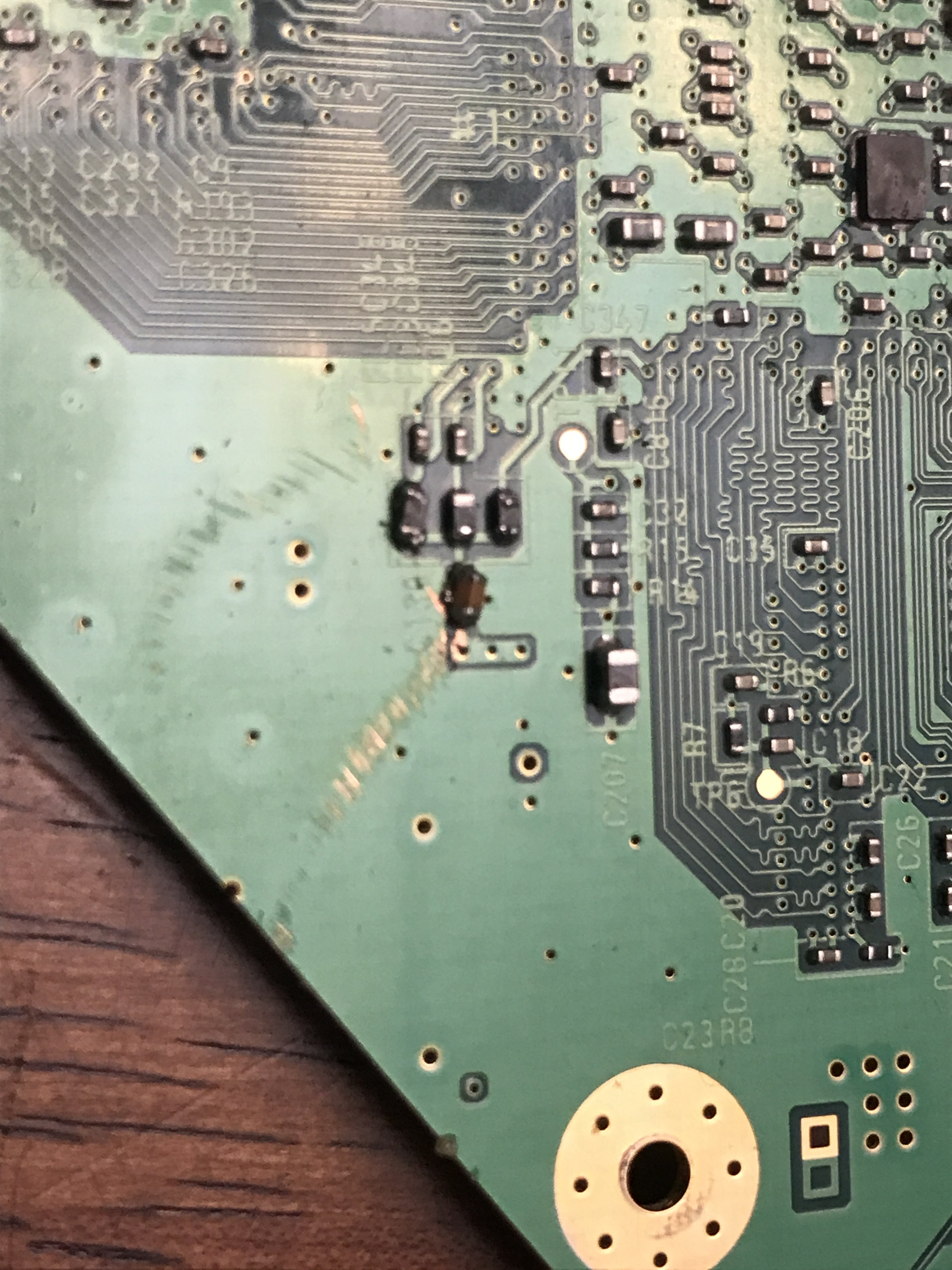

It looks like you may have damaged C130
yeah I know... ) : I do have a dead board tho that im prolly gonna transfer the components from. actually I was just abt to ask, what does that component do? Ok j hopefully sorted that out but not positive. How does it look
It's hard to tell once we try and zoom in on the photo. The way that component is sitting crooked on the board leads me to believe that the component is sitting on a blob of solder that bridges the two connections/shorts it anyways.
Can you post a higher res pic? if you're using a cell phone set the lens mode to macro shot
Personally I would redo that repair for safety. You can use some solder wick or just some exposed wire + some flux to suck up the excess solder on the pads
Another Blender user! I use both Blender and Fusion 360 - they've both got their place but I also tend towards Fusion for stuff like this. Are you using bool operations for controlling features? I feel like I'm the only person in the world to actually do that.
Lol yeah but was using bool operations. It takes getting used to but works like a charm!
