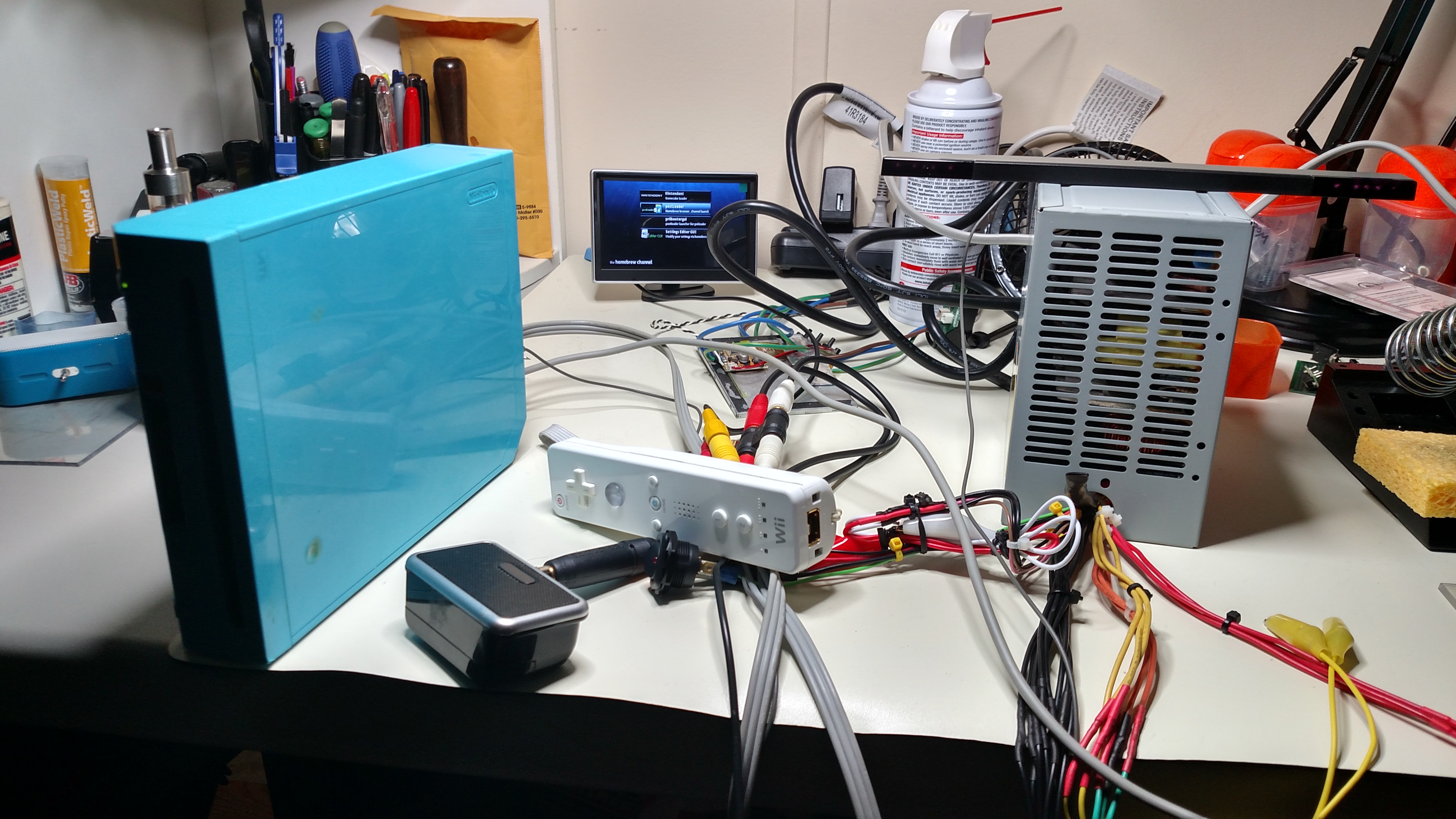

Ok, so I finally sat down EARLY Christmas morning, (like 4am) and built my first Power Regulator. I chose to do the 3.3v since this is pretty much a universal Reg. for the N64, GameCube and Wii and since I'm not sure if I will use it for yet, the Wii or the N64 portable. Either way I will have to make at least one more of this same Regulator.
It sets steady at a 3.336 to 3.337volts on the volt meter, even after letting it sit powered on for awhile. That bench power supply came in EXTREMELY handy for this project and I used some small red heat shrink to shield the resistor from the SMD components. How does it look? Anyone see any problems, (present or future) with how it is setup?
Just wanted to get opinions before going on with the rest of them.
