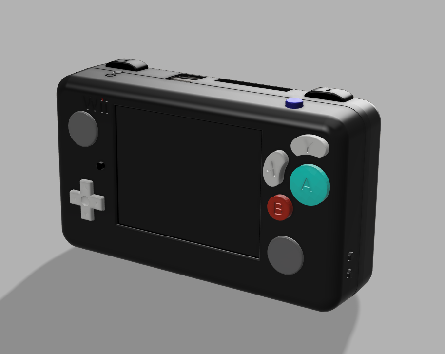

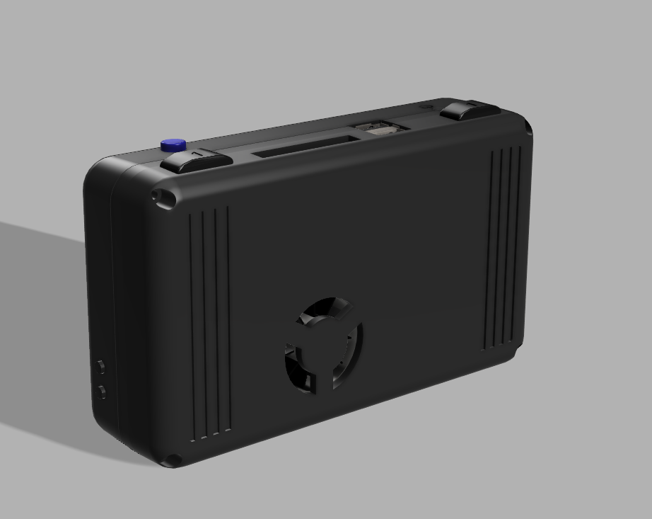

my wii portable design is based on shank's piiwii pocket(obviously)
same sl57 enclosure but 5mm thicker(based on polycase sl-57p 3d cad file, jeff's assortment of various 3d model files)

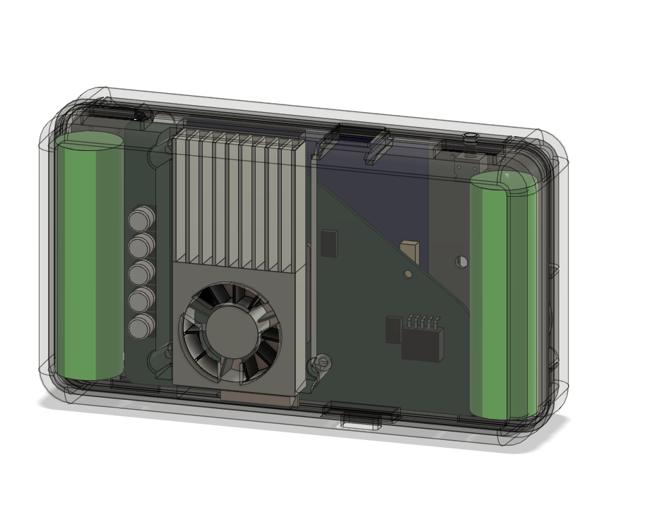

spec's gonna be.
- SLS Nylon PA 12 3d printing case(black dying)
- 3.5" TFT Composite, VGA Display
- 2x 18650 battery
- original gamecube buttons, 3ds slider
- 2x stereo speaker(sp-1511s-3)
- usb c charging port
- 3.5mm stereo jack
- 2x usb a port
- sandisk 64gb usb stick
- dualshock 3 shoulder buttons
- rubber cap tact switch for most button contact
- dual action tact switch for analog feedback trigger button
- 35x35x10mm cooling fan, heatsink and m.2 copper plate

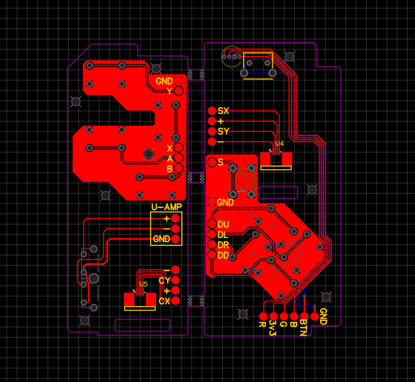

- RVL-PMS, U-AMP, GC+ 2.0 board (open source file)
- 2x custom design button pcb
- OMGWTF Trimmed wii motherboard
- analog volume wheel
so far i'm making case design, BOM now. so it's very early process
and i set the maximum price under $230

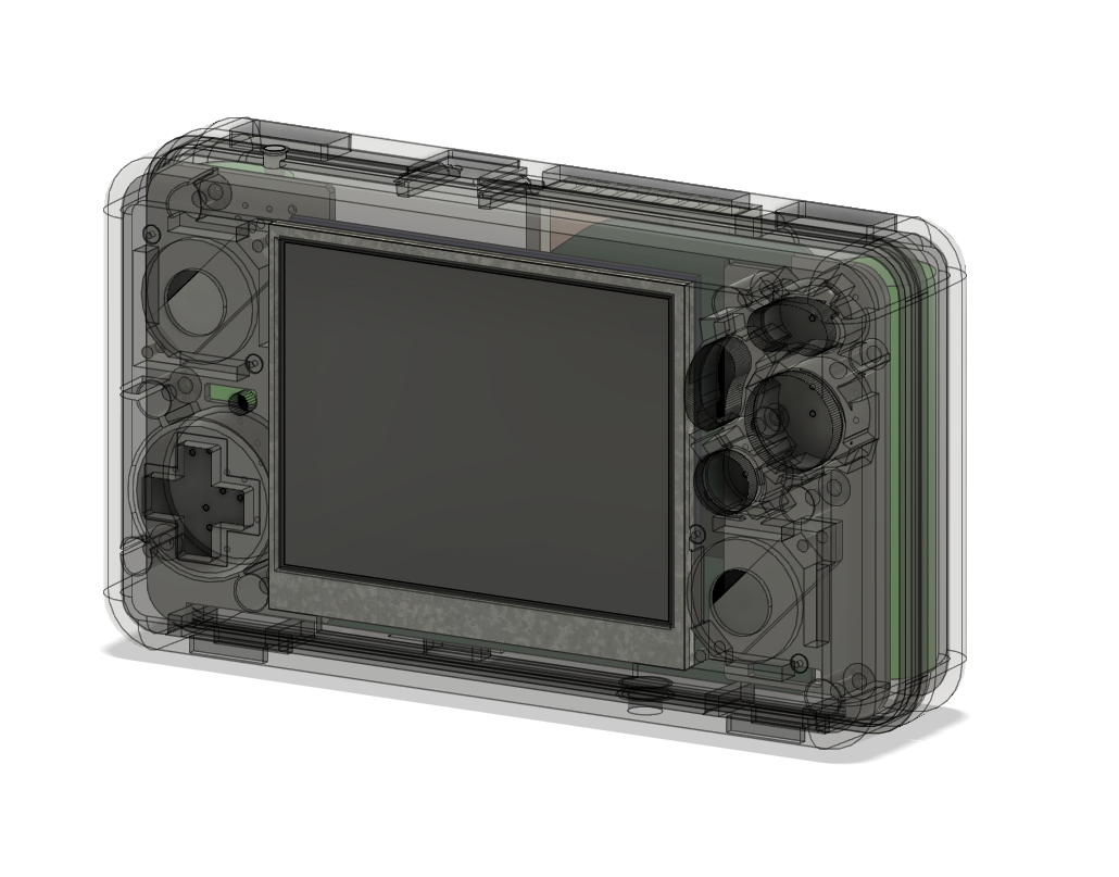

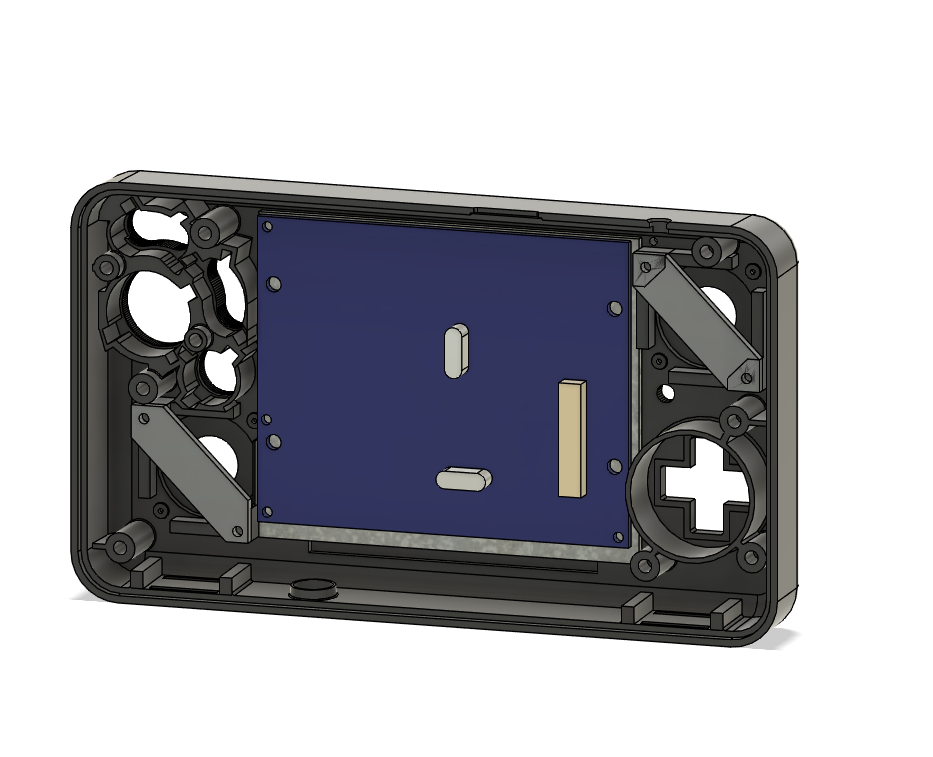

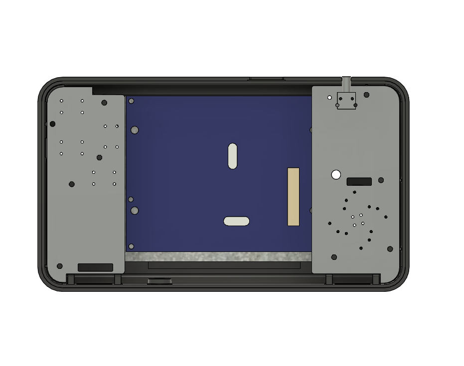

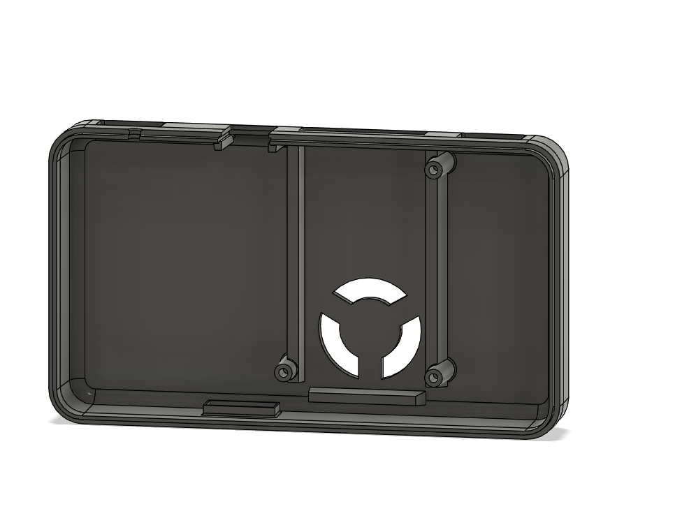

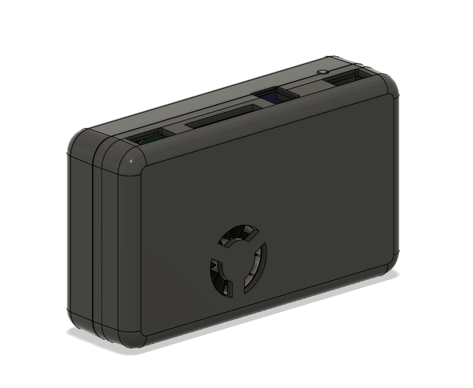

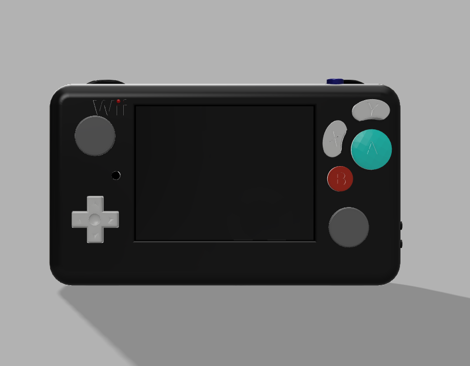

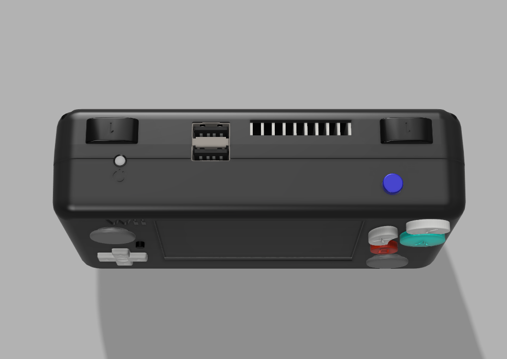

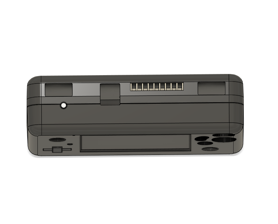

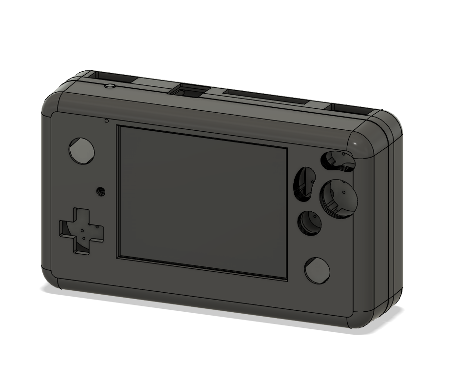

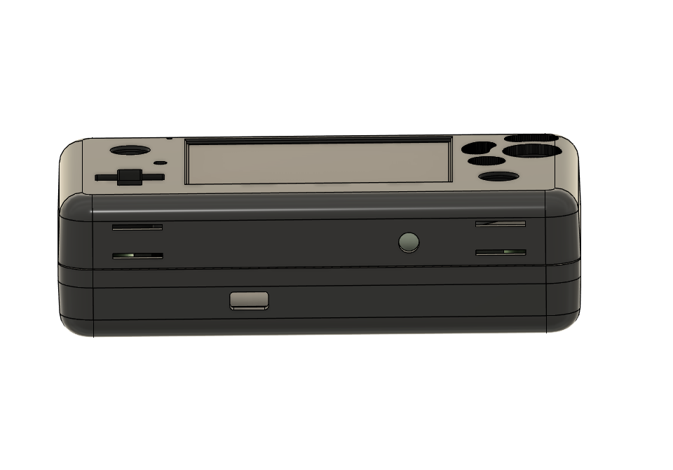

case design is done.
yea i'm copying piiwii pocket design too much but i like it's form factor and this is the reason why i'm making this
maybe i will make my own design on my next project.

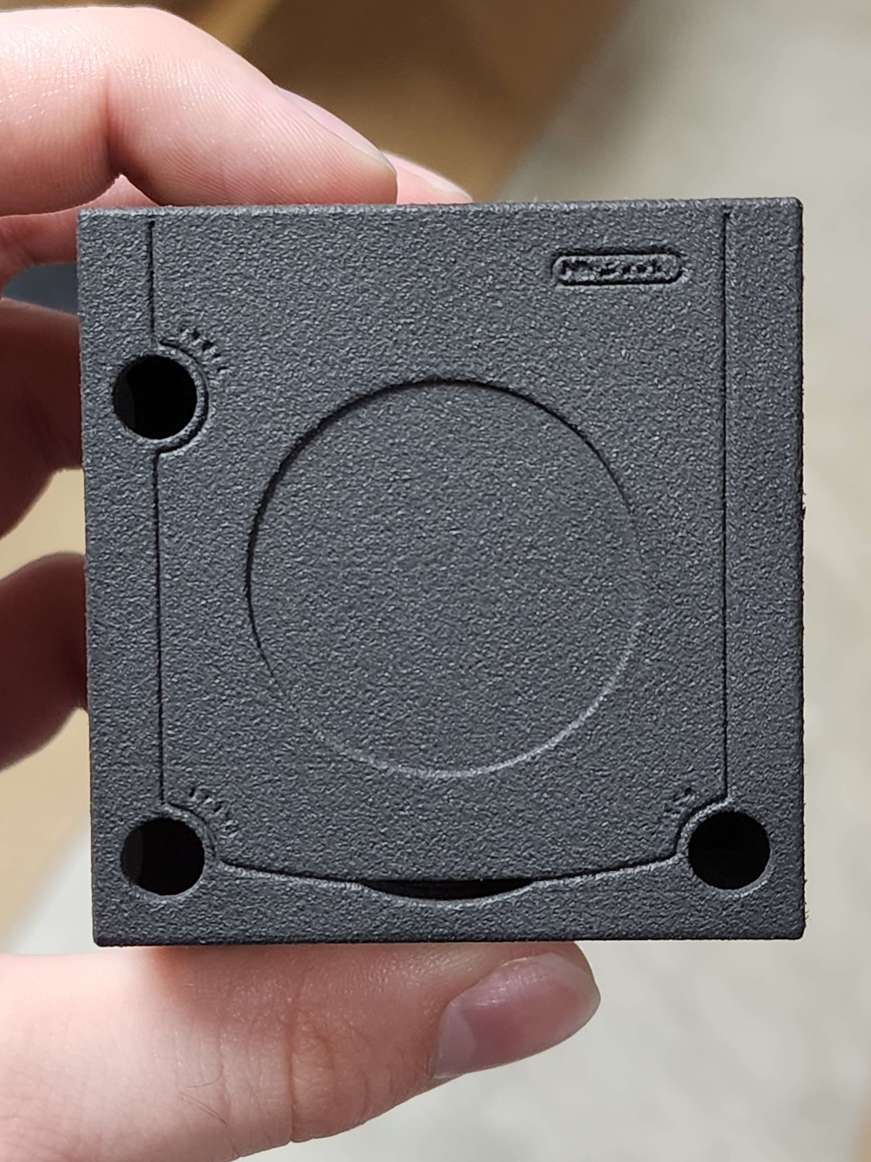

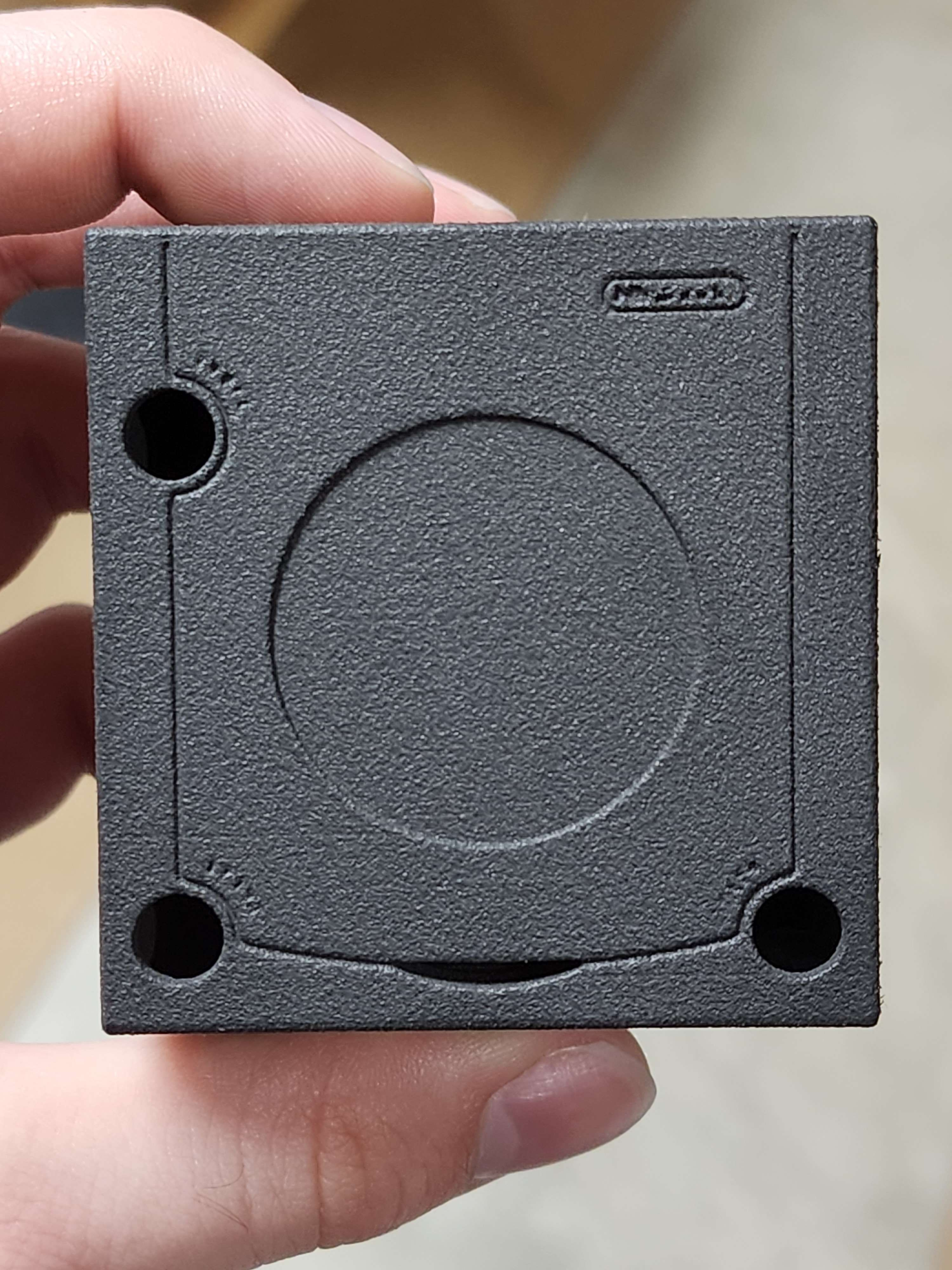

is someone has experience with sls pa-12 material?
seems perfect for me but i've never seen before the actual look
The SLS texture is similar-ish to the texture of a stock SL57 case.
(photo courtesy of CrazyGadget)
It's a very durable material. Well suited for this kind of handheld
yes durable and textured surface is the key but it's a shame the minimum engraving width and deep is 0.8~1mm
