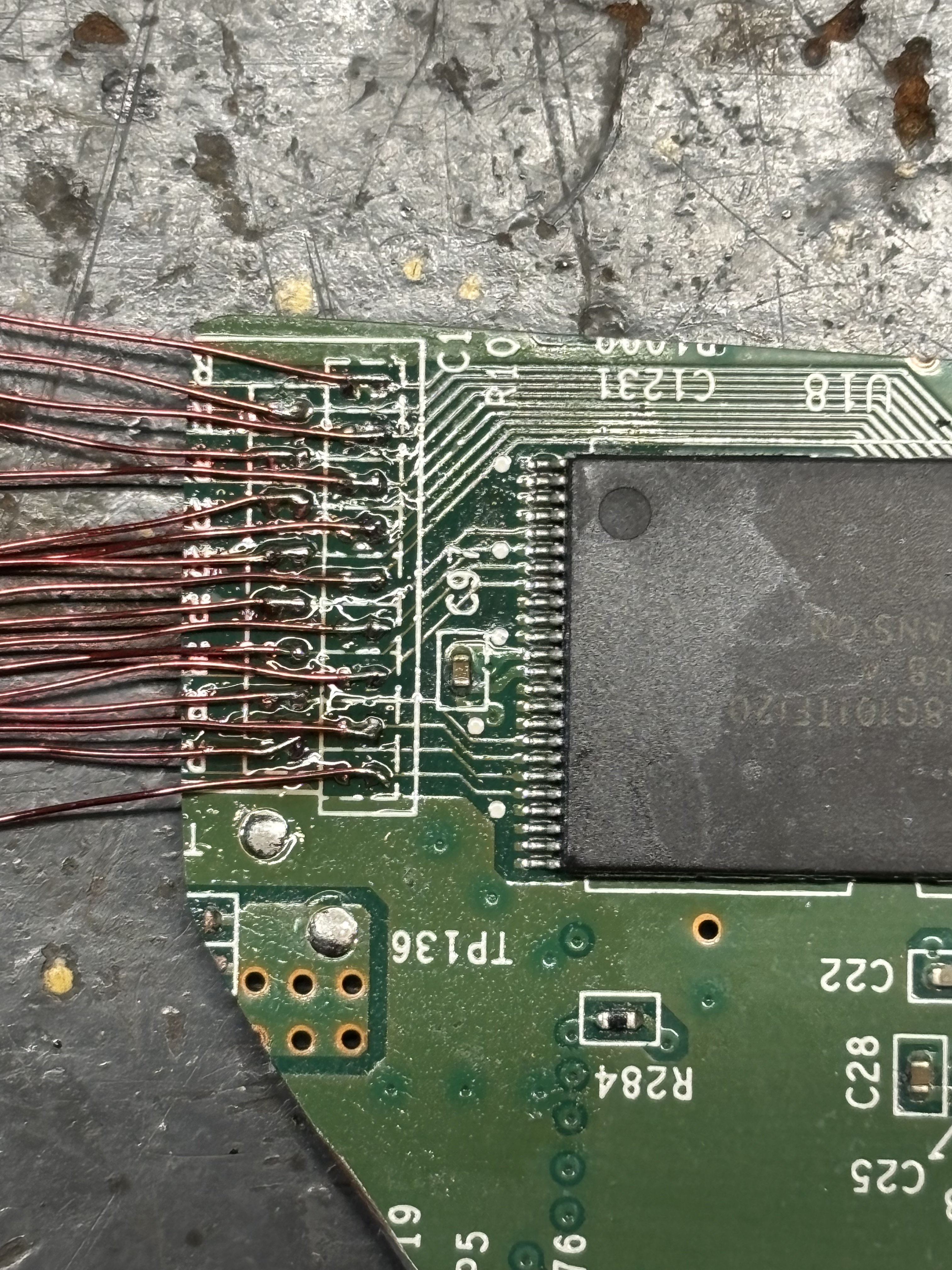

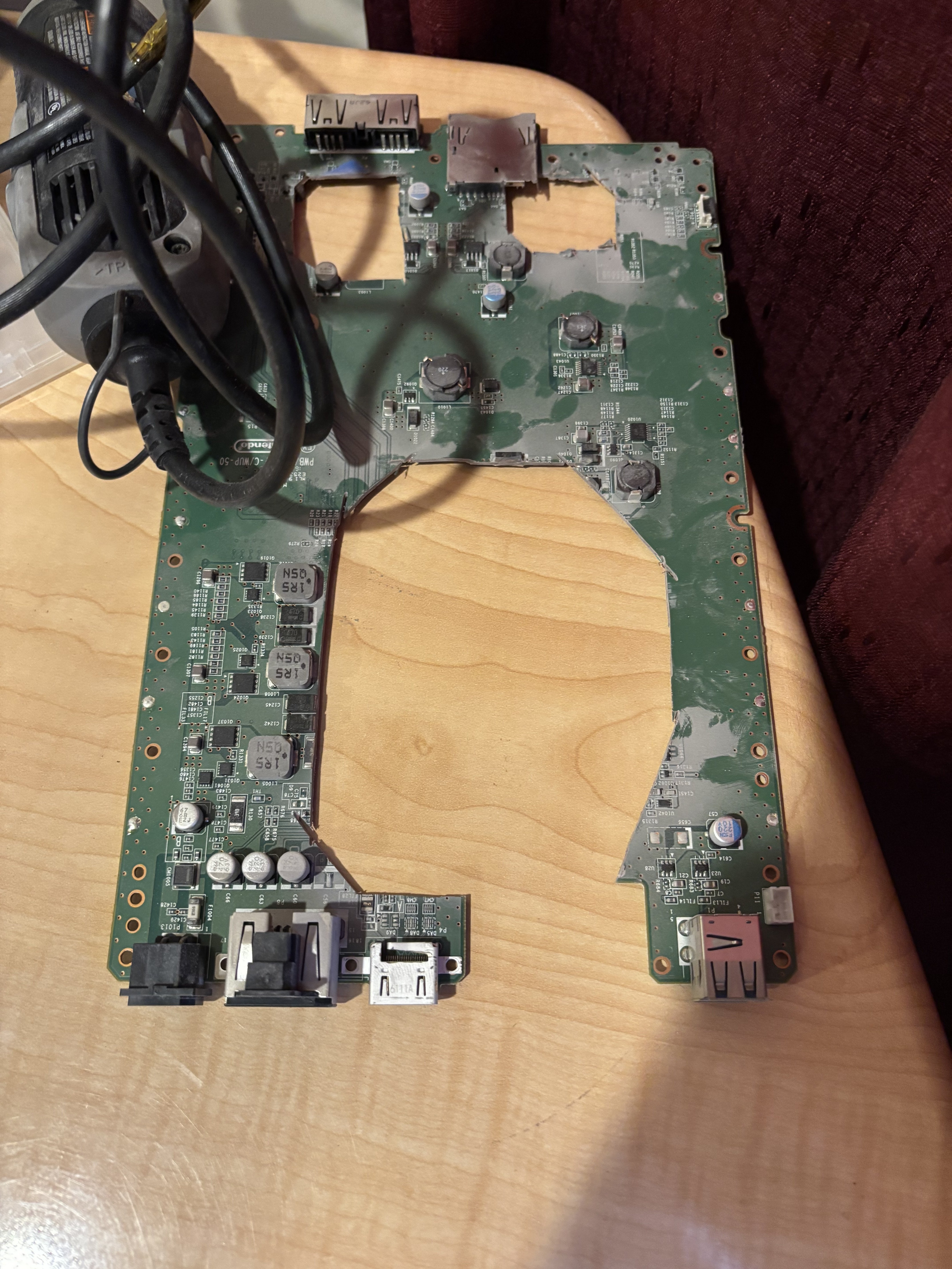

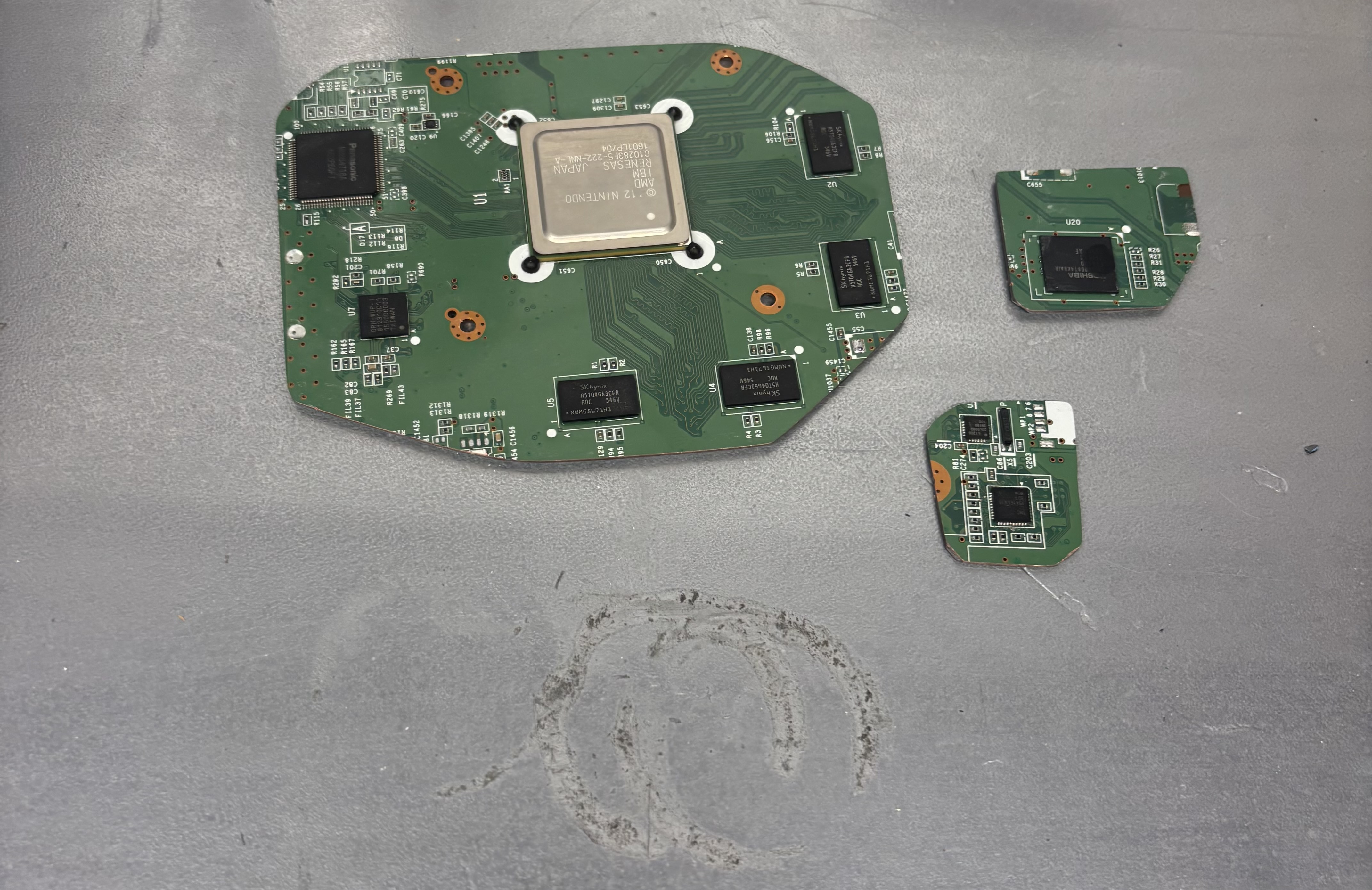

I've been following the updates with Wii U trimming for a while, so when I saw a good deal for a Japanese WUP-50 system, so I bought it. It's been mostly untouched since then for a few reasons. I was working on my summer contest project, and I wanted to practice more soldering before attempting a Wii U trim. I decided to try making a project with it now.
My idea is really simple: A portable Wii U console on the back of the gamepad, with batteries and HDMI output. I'll use homebrew to swap the gamepad and TV screen, so it should work for most single-player games as a portable, and it can also just be used as a regular console for multiplayer. Before I design this, I'm going to make sure I can make the trim work. I softmodded the Wii U with aroma and installed isfshax for the disc drive patch. I trimmed the Wii and started some soldering. I'm going to use Yveltal's bistro PCB for power. That reminds me, thanks to @YveltalGriffin and @Lazr for their work on the Wii U and Yveltal for answering some of my questions.
