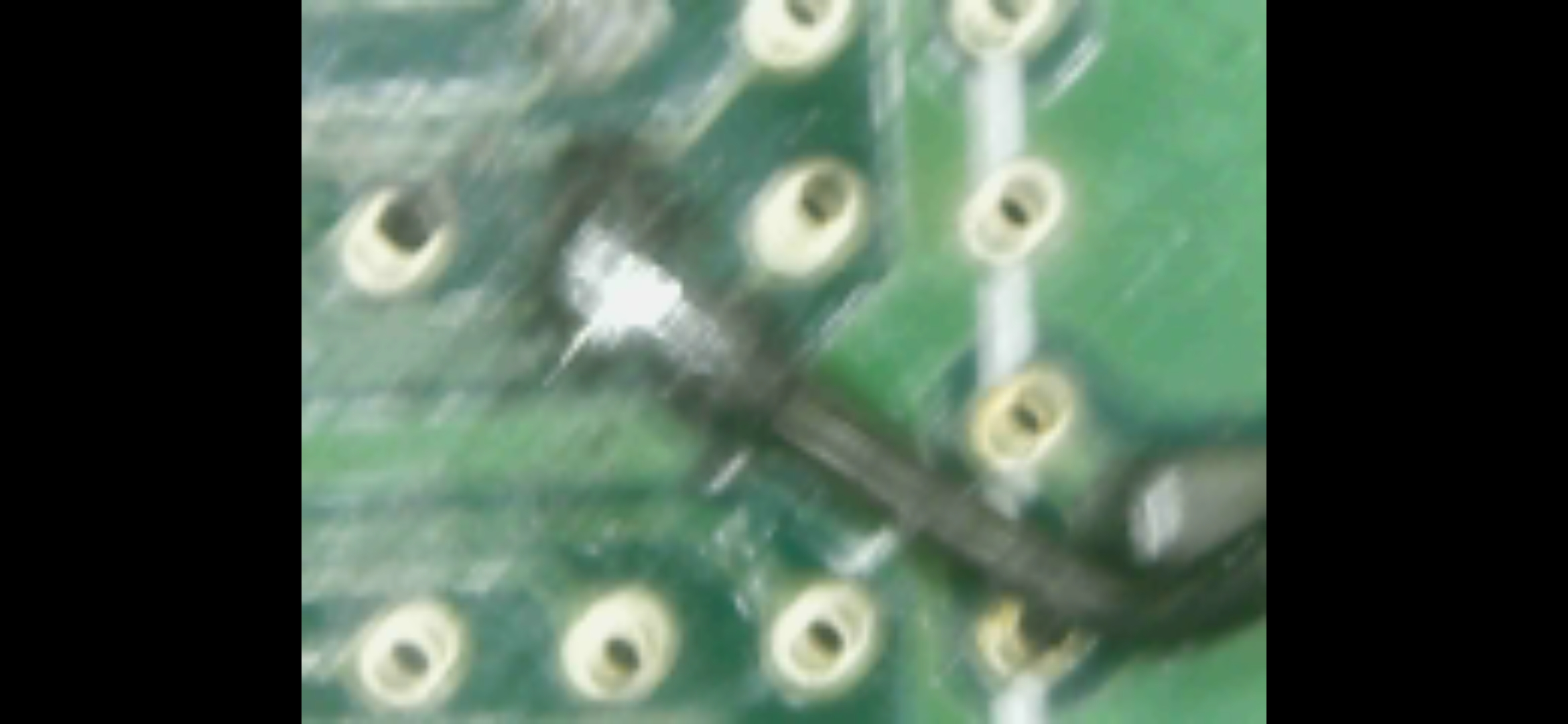

Installation and wiring of u10, ok.
3.3v are generated at the output.

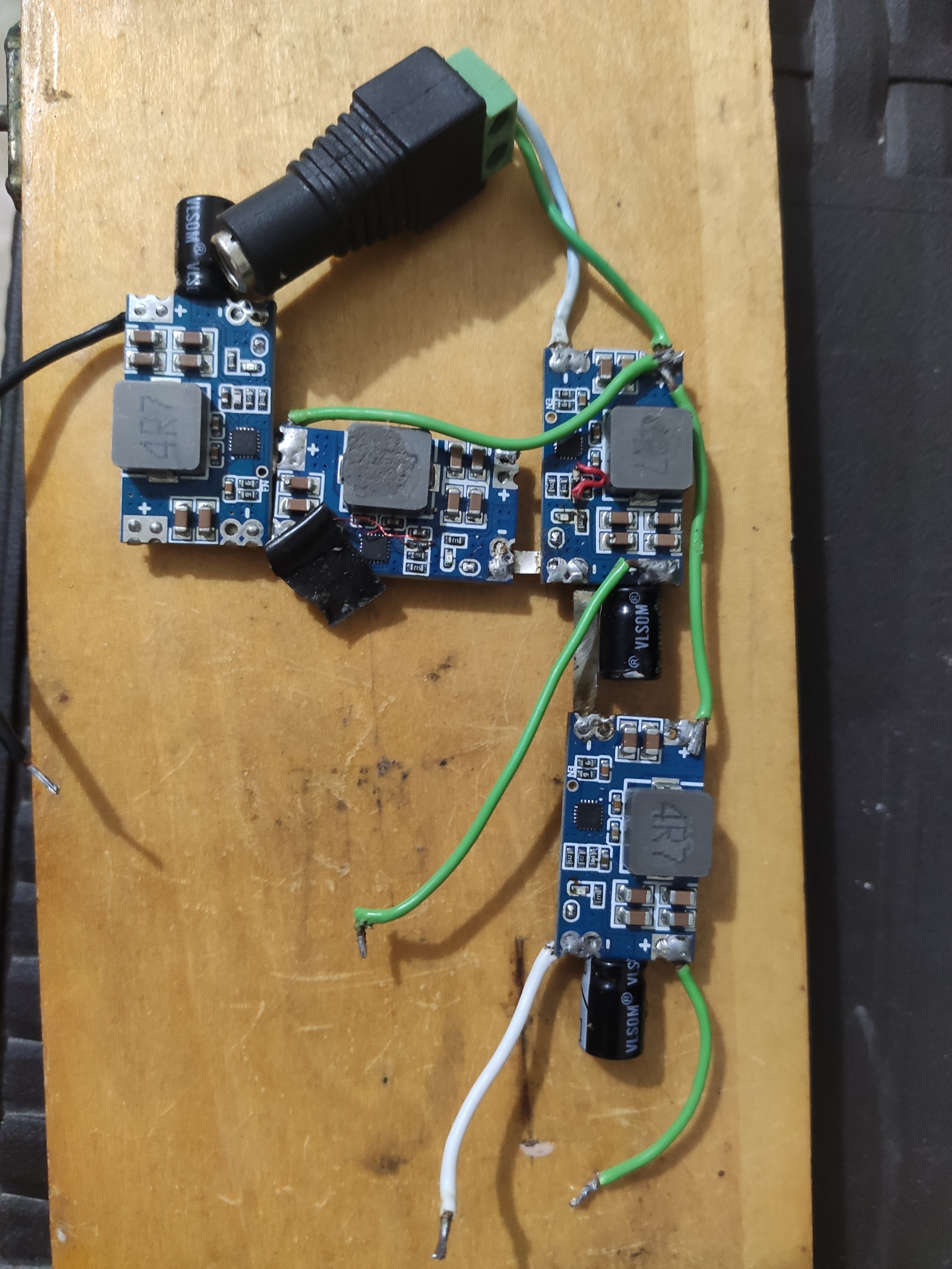

Power source, 8.4v 3a battery pack
Installation of custom mini560 regulators, stable 1v 1.15v and 3.3v voltages with 220µf 25v capacitors.

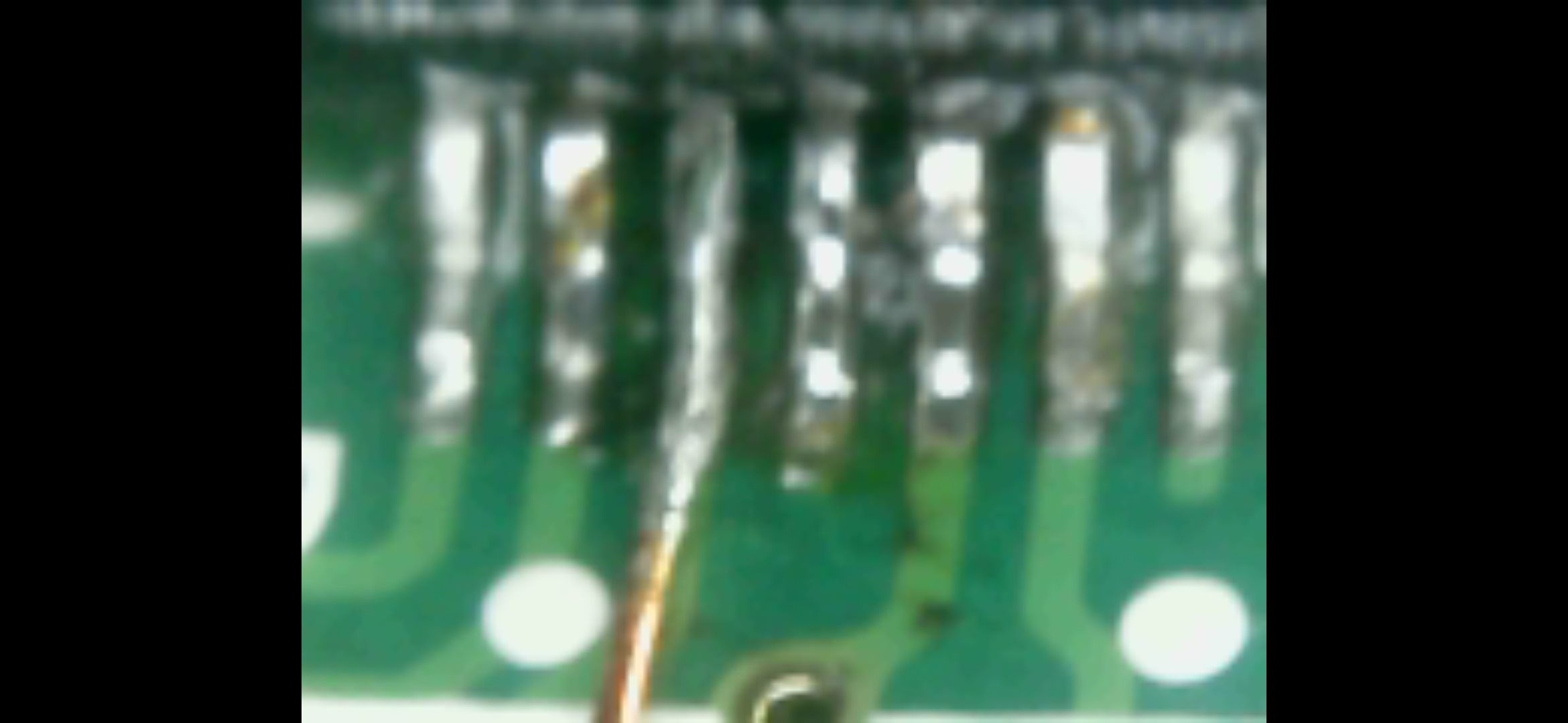

Video output with and without condenser, without image on TV or screen driver.
Test of wiitohdmi adapters with composite video output enabled, without results.

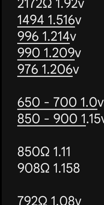

Cleaning with IPA generated a change in the values of the previously measured resistances, here is the graph.

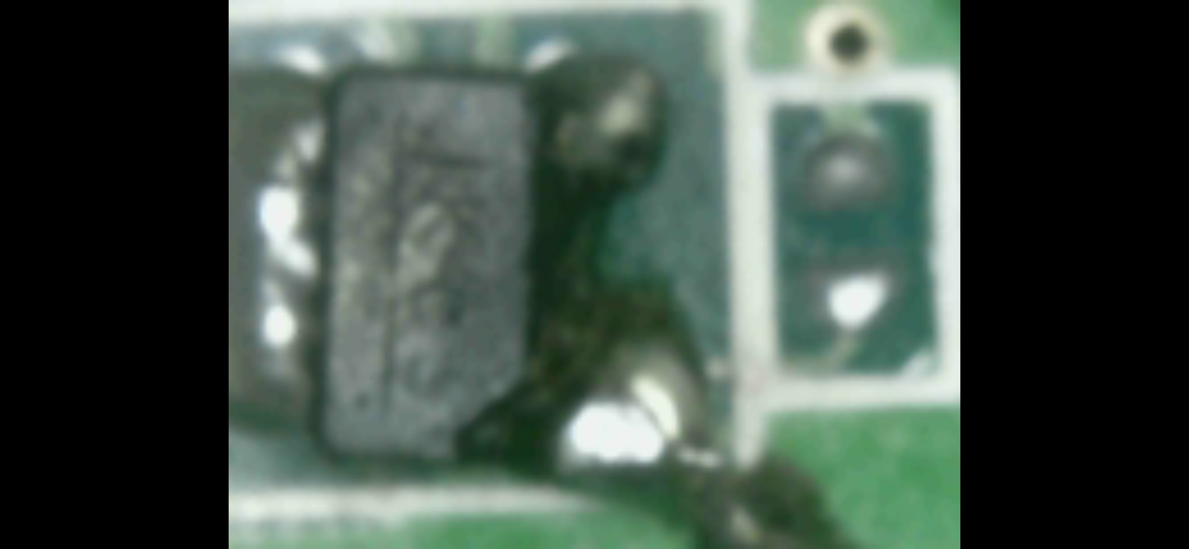

In the images you can see an area with exposed copper, but I have already verified that it is not making contact with the lower layers.
Cleaning with thinner, no results
There is a small part of the circuit near the video capacitors that disappeared due to excess sanding, but from what I see it was just gnd.
The regulator that can be seen in the images that has a coil in poor condition has already been changed for a new one and its voltage has been verified.

Your U10 wire might be shorting on the via next to it, and you have soldered your composite wire to the wrong place. With the big capacitor removed, that side of the trace is disconnected. You'll need to solder the composite wire to the AVE line on the other side of the board
Thanks for your prompt response.
the u10 cable was relocated at both ends to avoid shorts with other nearby points.
The video cable was soldered directly to the AVE output, without results.

After getting another 4 layer wii, trimming it and checking the resistors I am about to test the regulators, I would like to know if these values are appropriate or do they need to be adjusted more.
3.3v = 3.35v
1v = 1.08v
1.15v = 1.2v
the regulators are mini560
thank you
Sorry, I didn't understand the question You wanted to know if the voltages were okay You have already changed the regulators and the resistors as I can see from the photos I'm also making the modification to the mini 560 regulators I think the voltages are fine, I think they're within 5% of the gap One question, are the capacitors you put mandatory for the quality of the voltage or can I do without them? Since I've had capacitors like this I'll put them in too Thank you

Hola soy de Colombia y ese fue el video que use para buscar los reguladores. Si te fijas en los comentarios ya había puesto las resistencias necesarias para los voltajes del Wii, aunque después tuve que modificarlas un poco. En el video solo se ven. 1 capacitor muy grande en tu Wii pero no se que capacidad sea, estoy usando uno de 220µf 24v porque era el que tenia a la mano y te recomiendo que le pongas al menos uno de 100µf 16v que es lo que recomiendan en los foros. Mientras mayor sea la capacitancia menos ruido hay a la salida. Yo antes no los usaba y creo que esa fue la razón por la que mi anterior Wii murió.
