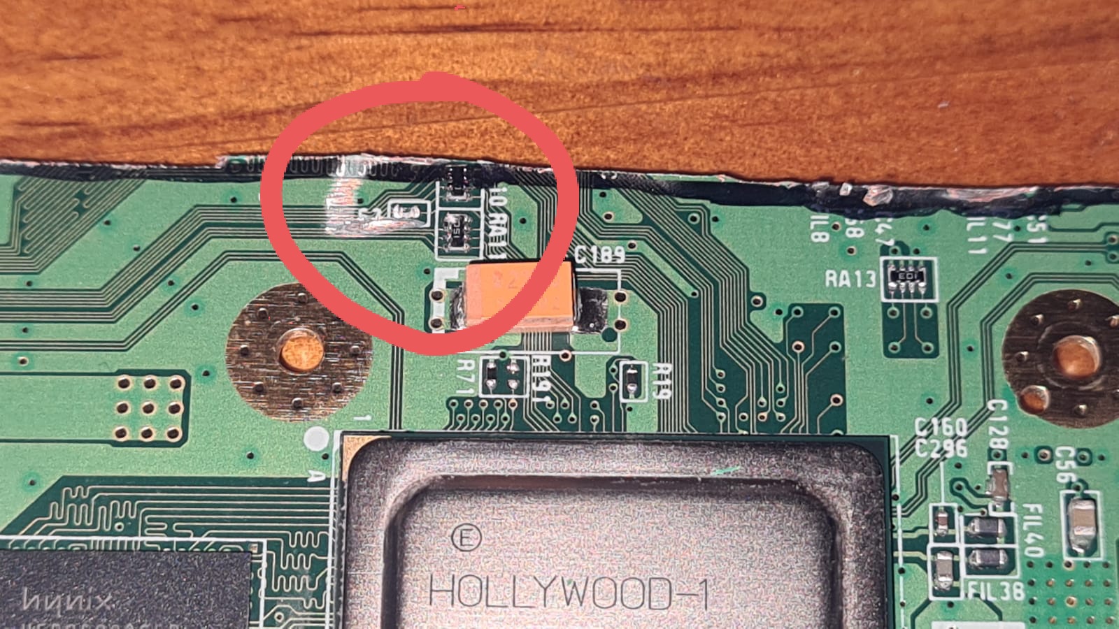

I scratched a bit on my trim.
Will this be ok or do I need to trim another?
Or is it fixable?

That should be fine, those traces lead nowhere after trimming anyways. You might want to remove those resistor arrays [RA11, RA10], cause you cut through at least one of them - also this will prevent any traces to get shorted to GND.
But the cut of your trim looks pretty ruff, make sure to give it some nice sanding.
