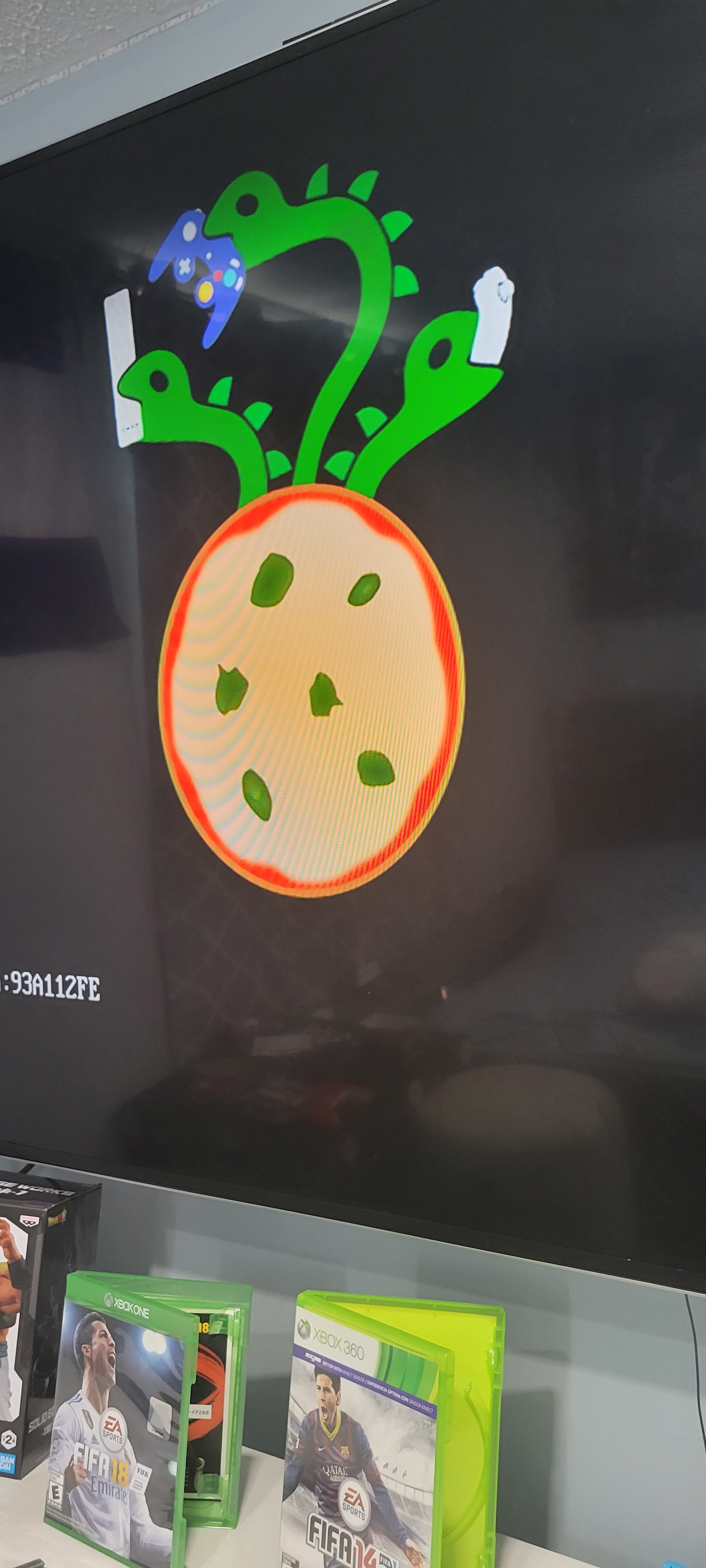

The wii is hacked so far

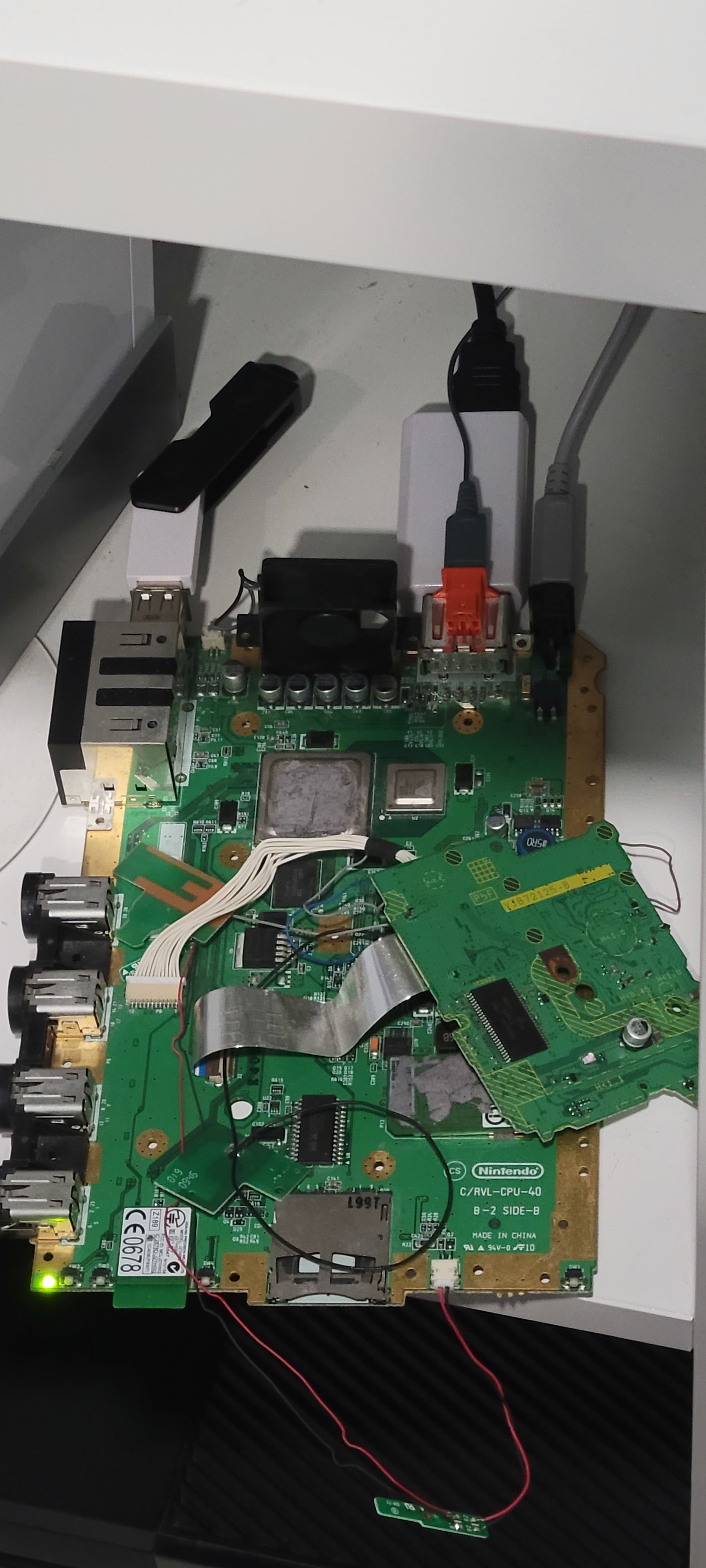

what tool do i get to trim the motherboard this is my first project so it will take a while to complete
Those floating PCBs are just asking for shorts..............
For trimming the Wii we use rotary cutting tools, like a Dremel with a diamond cutting wheel.

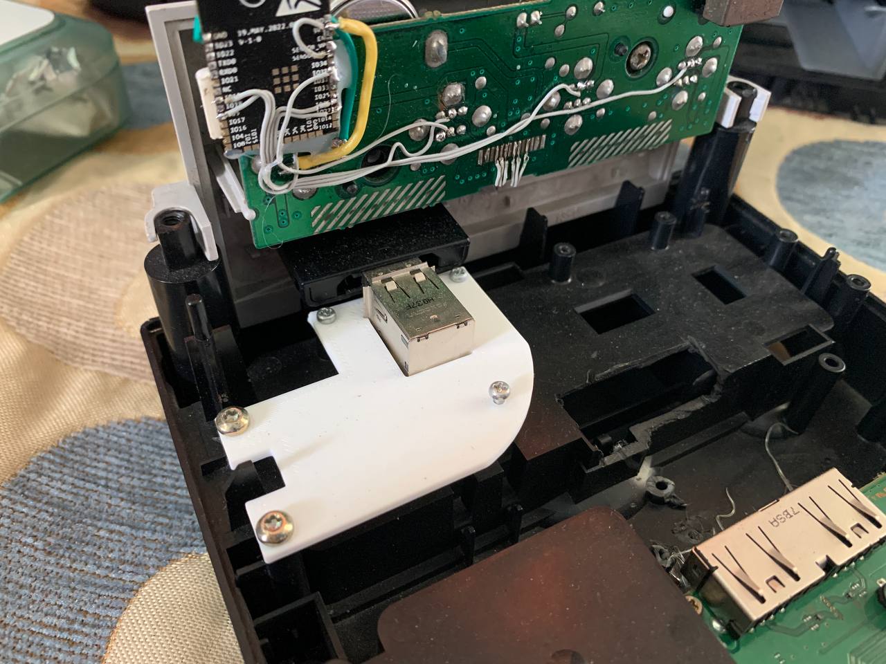

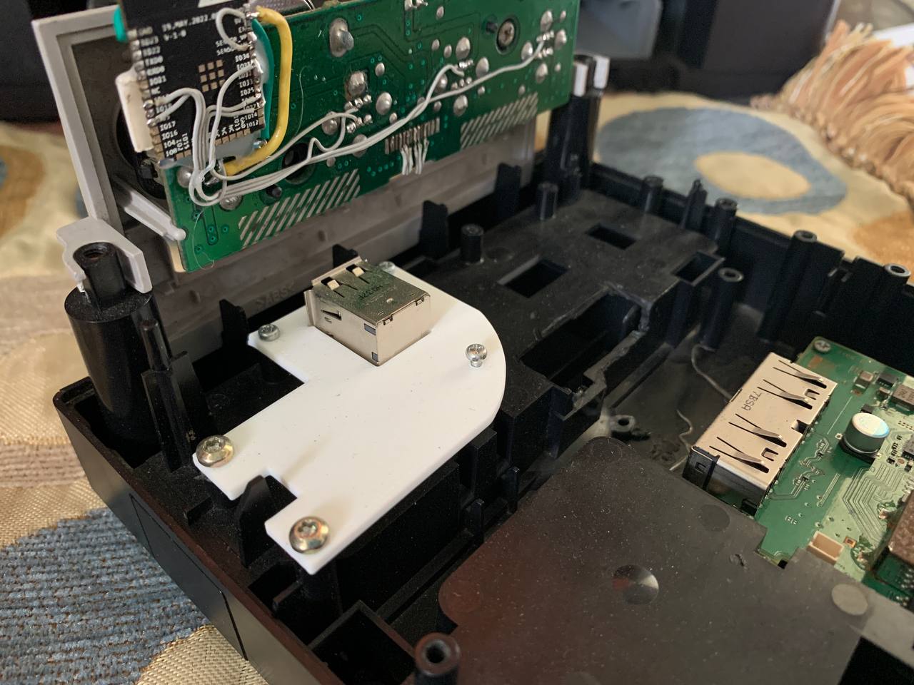

I am working on something similar like this, but I will also integrate a NX Switch dock inside it.
I mean, we have a lot of space inside it anyways.

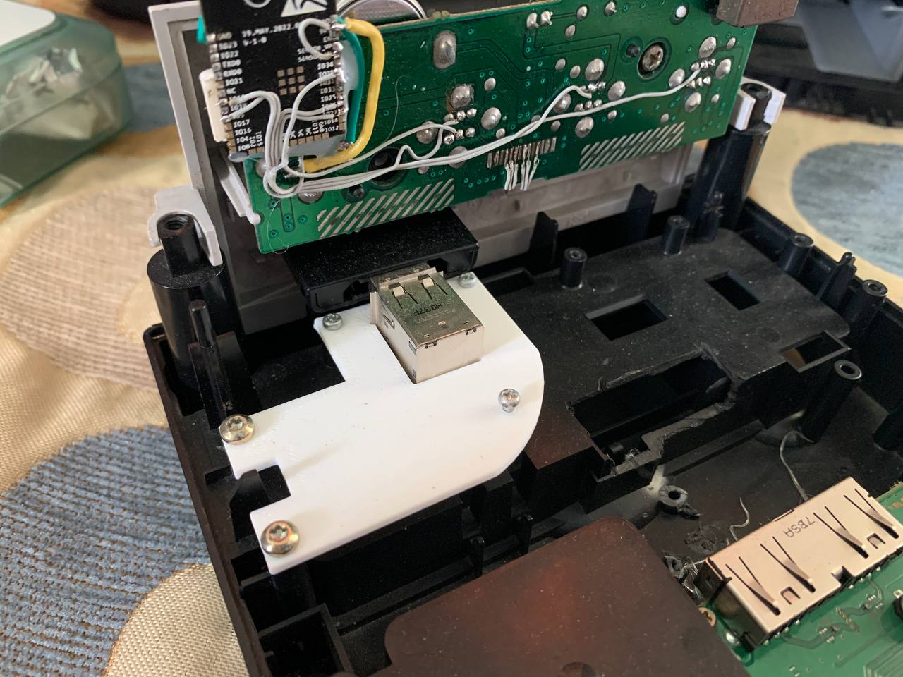

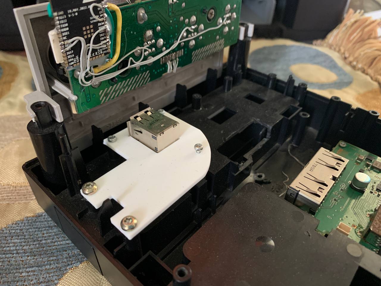

Look at this bracket to hold the Wii USB that allows you to use the memory card slot as an USB port:
I will also attach the STL in case you wish to use this design, the screw in the air is to hold the wii board in the orientation I plan to use.
You might need to cut the GC case screw holder a bit as there is one that is taller.
Also, this mount uses the original gamecube screws.
View attachment 29142 View attachment 29143
View attachment 29144 View attachment 29145

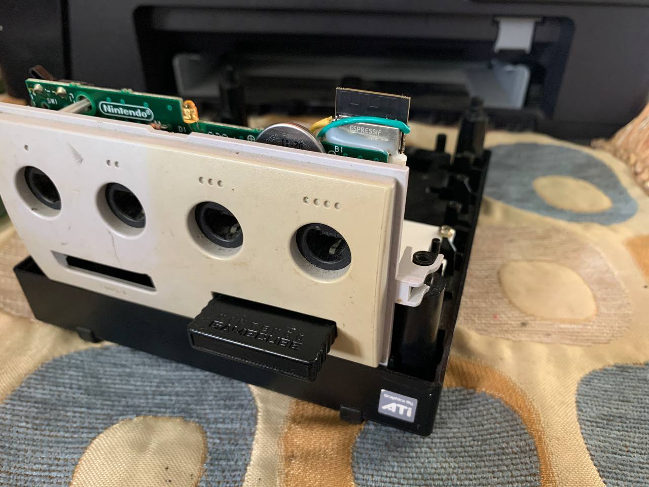

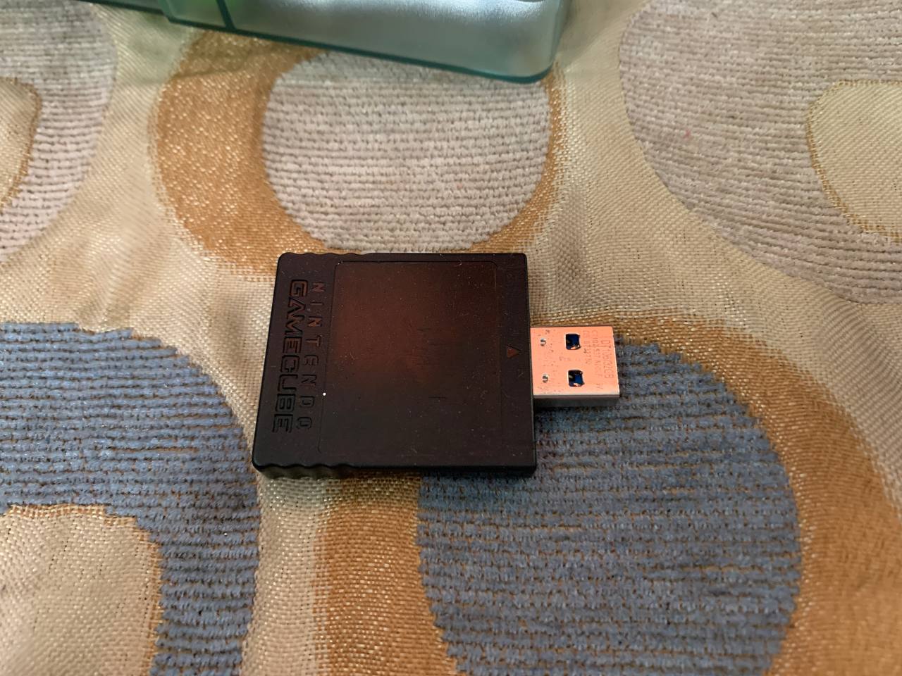

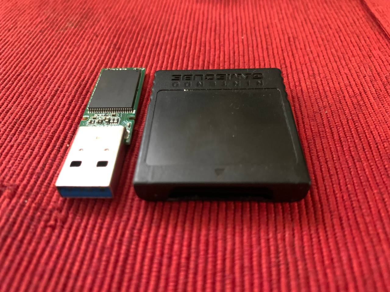

how did you make the memory card usb that looks really cool

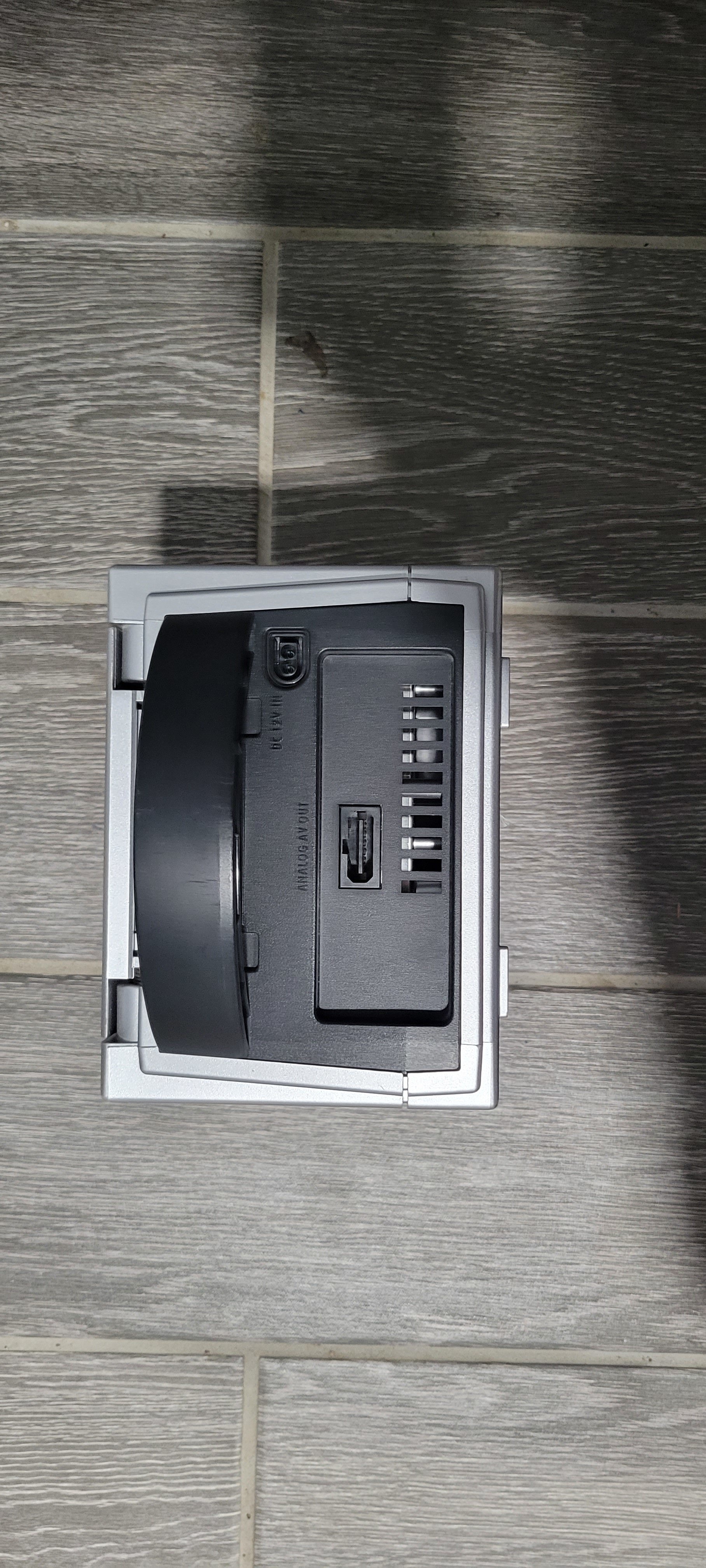

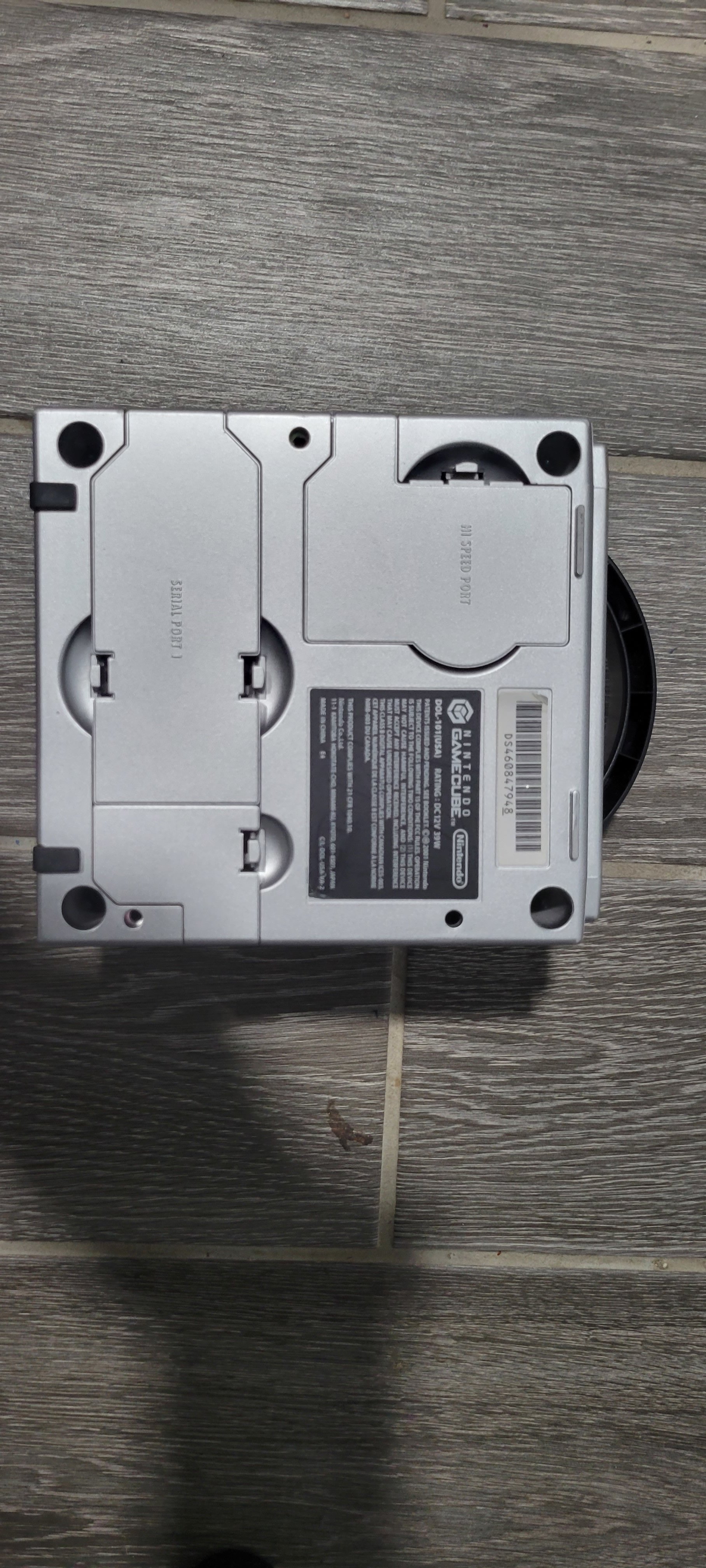

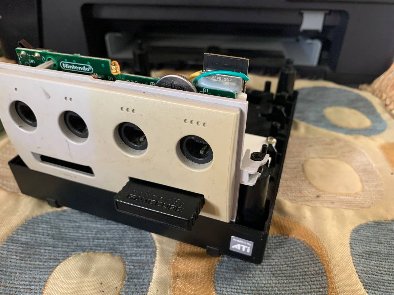

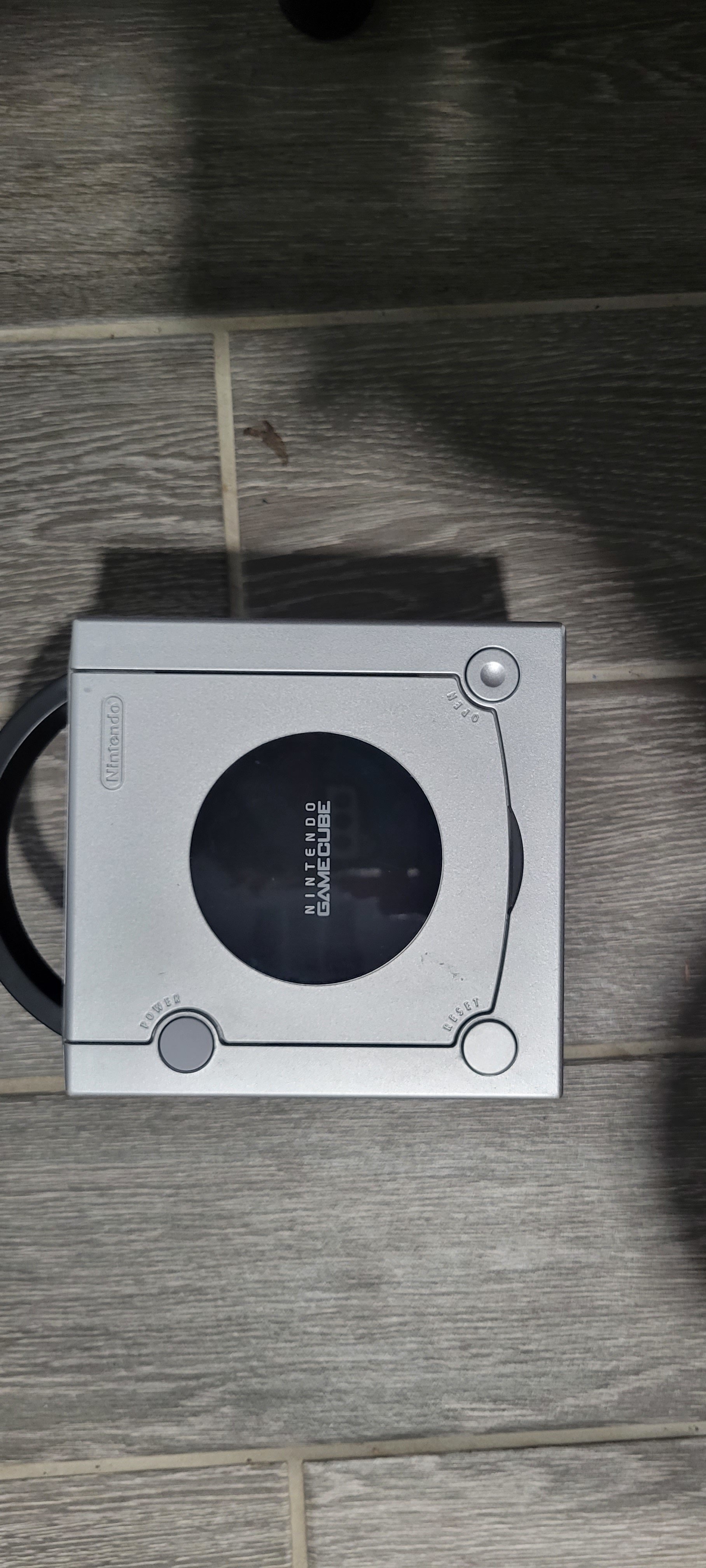

( Semi Update ): this is the gamecube I will be using it is a fully functional gamecube the only reason I will use it is because I have another gamecube I bought for 15 dollars at the thrift store

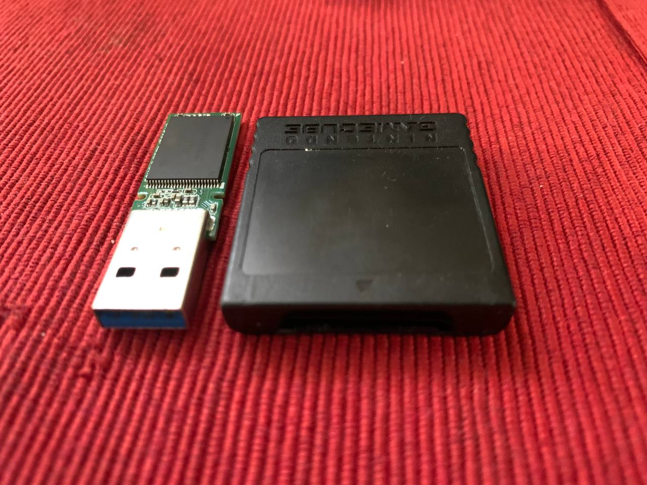

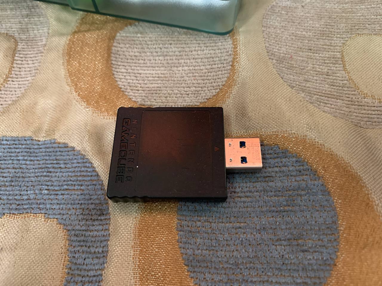

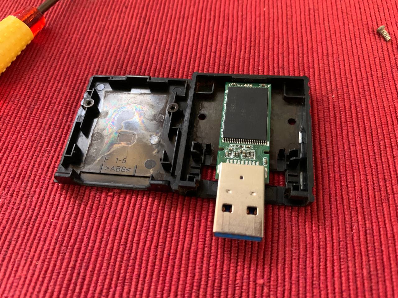

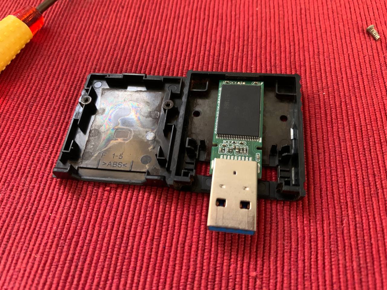

Sorry I forgot to reply to this.
Nothing too fancy going on here:
The USB fits right in the slot of the mem card shell, so once I get the job done on the gamecube case done I am just planning to put some hot glue to keep it inside and call it a day.
