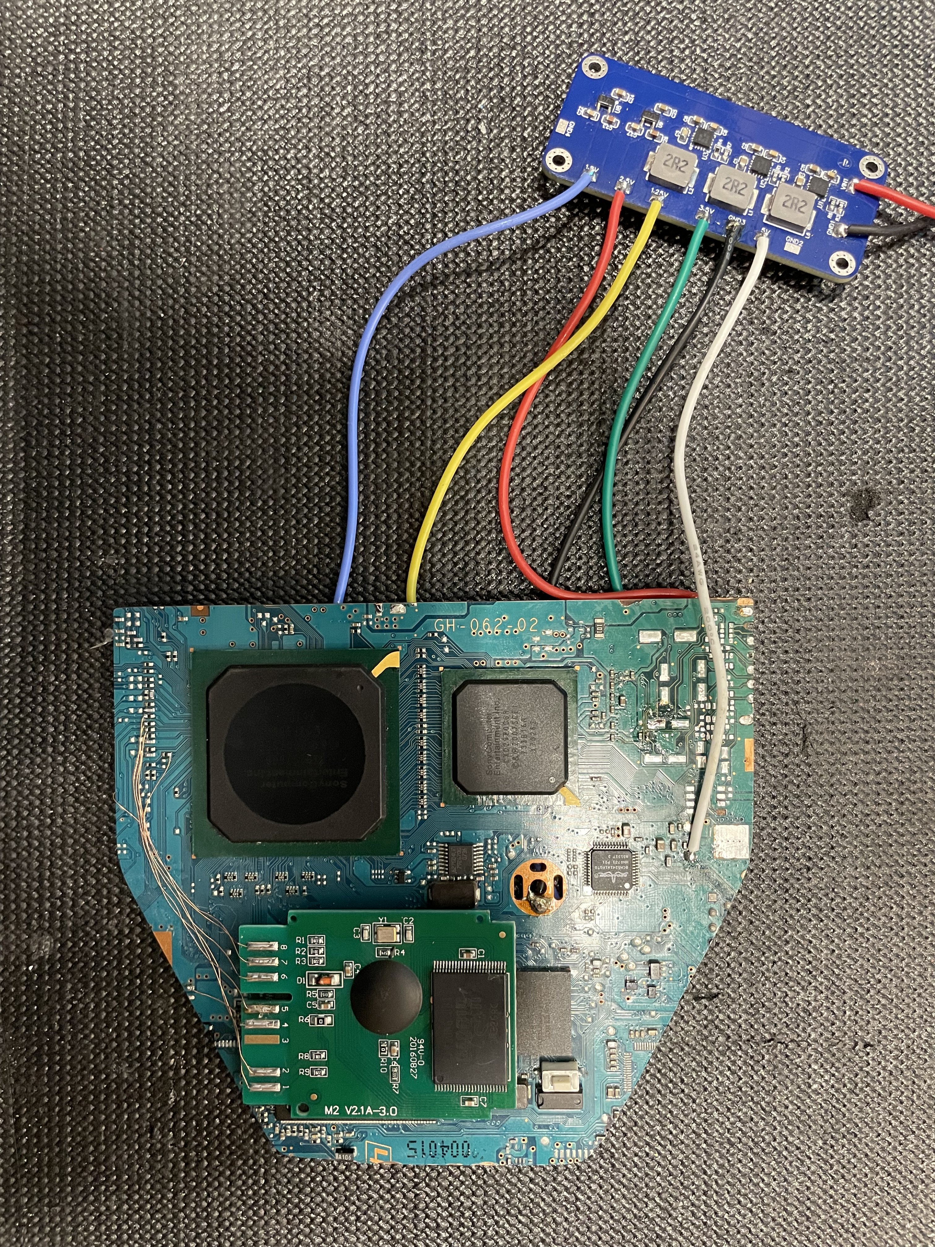

Hi, I’m currently building my portable PS2, and I’m now at the battery stage.
The problem is that even after reading the battery-making guide available on this forum, building a battery pack still feels unclear to me.
I’m using regulators to power my PS2, along with two 18650 cells (this information might be useful?).

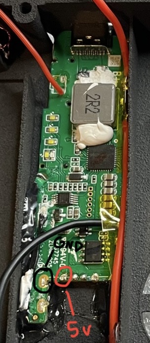

You can use this usb bank I linked here you just have to take it apart and use the charge board, connect them to your regulator board in parallel no series.
The only thing is that it doesn’t have charge and play you can use a 18watt usb c charger on it.
https://bitbuilt.net/forums/index.php?threads/updated-ps2-21700-use-these.6725/
Connect the 5v from power bank to your Vin on regulator board.

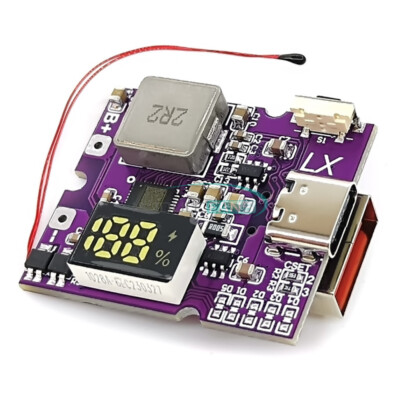

Hi You can try this also. You can charge and play.
