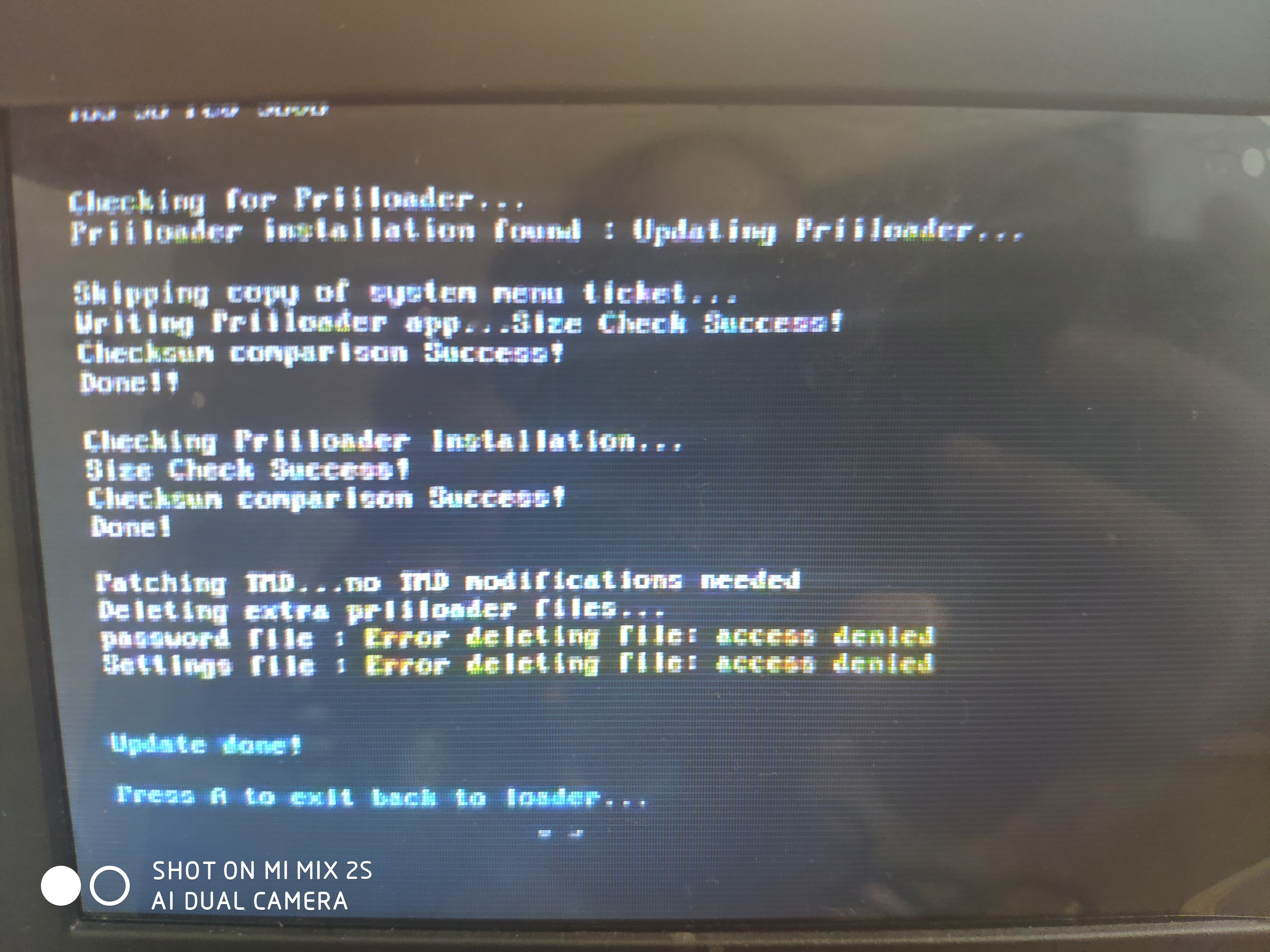

(problem solved)when install vga patchs,it said IOS36 isn’t ES_Identify patched: error -1017,i reinstalled portablizemii with no wifi as suggested by the previous solution,but nothing change, same happen,any more advice to solve the problem will be appreciated
remark:when i install the vga patch it says delete re some exrta file failed,access denied and when go to prriloder and select load/install file only with usb , it says no fat file,and when i connect vga ,no output,mode already connected to 3.3v, hs and vs also connected,but still no signal, i reinstall portablizemii again,problem solved
reinstall the patched ios36 on the sd card root file did the trick
