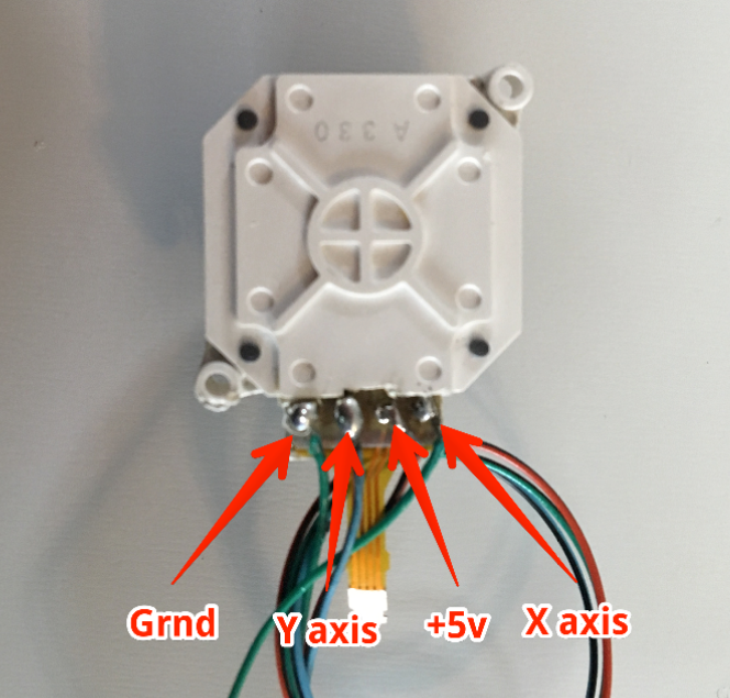

This is the pinout from the 3DS slider:
I've tried to upload and post a photo here several times, but the upload process does not appear to work for me for some reason.
(view slider from the back) From the mounting point that is closest to the pins, number from 1-4
1 = Ground
2 = Y axis
3 = +5v
4 = X axis

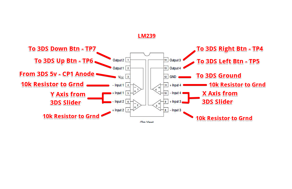

The concept is to use a single chip (LM239) that includes 4 opAmps on one circuit that can work as 4 different comparators. Each of the 4 connections to the Gameboy d-pad needs to have a 10k pull-down resistor.
1 = Ground
2 = Y axis
3 = +5v
4 = X axis

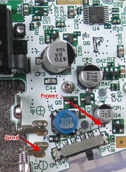

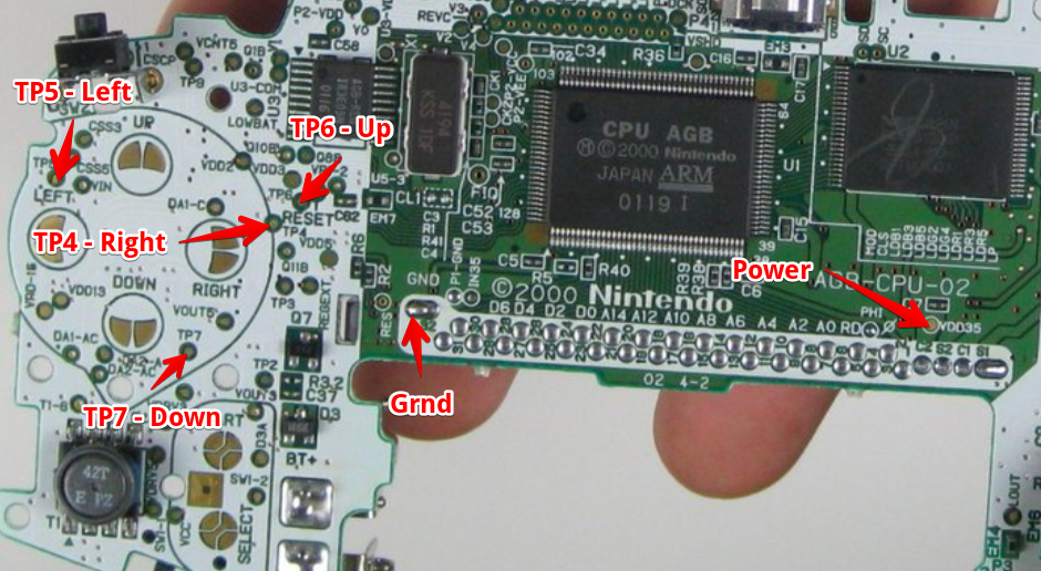

Here is are some screenshot of connection points for the D-pad, Pwr, and Grnd I found on RetroMod.com's site.

  1. I need an elegant way to supply the 5v and ground to the 3DS slider and the LM239.
  2. I haven't grasped exactly how to configure the LM239 for this purpose. I'm consulting this page (http://www.ti.com/product/LM239) but a visual guide of how to use it for this exact purpose would be very helpful. How do I best ground the 10k resistors?
