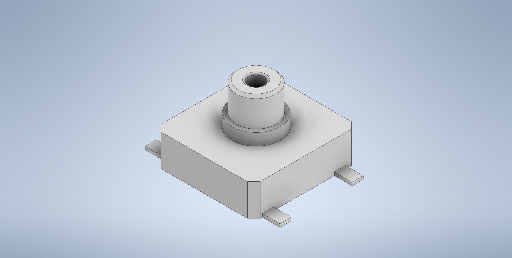

Saw that there was no model for the Dual Action Tactile Switch, so here we go you guys.

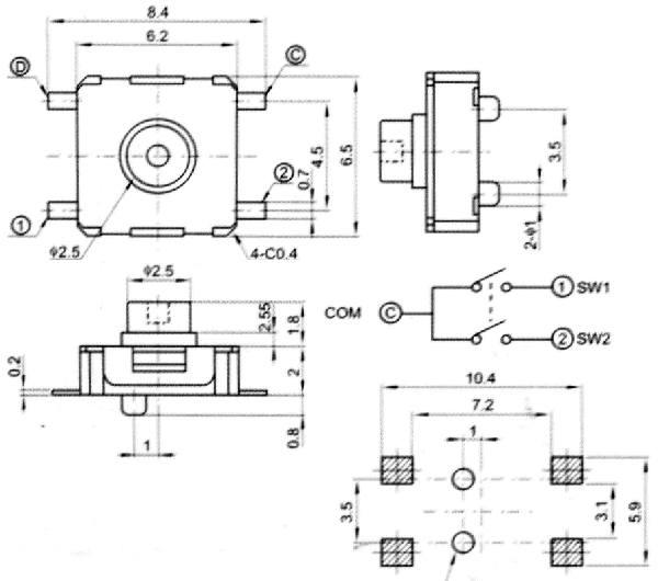

Source of Dimensions: http://www.bentex.com.hk/catalog/switches/tact/html/h-series/tmhf07.shtml
Note: Some of the circular dimension were not truly explicit. Also, the depth of the extrusion for the button has a bit of a confusing measurement (see source), so I cannot truly confirm the accuracy since I am still awaiting for my tactile switches from the store.
Nice! This'll be helpful since I was literally just about to model this for myself.
Hey, this is really good. I got my dual tacts a few days ago and checked them against your model. It's almost perfect, but the extrusion of the button is off by about 0.5 mm
I made a quick edit to your model to get that part right, here's the STL
