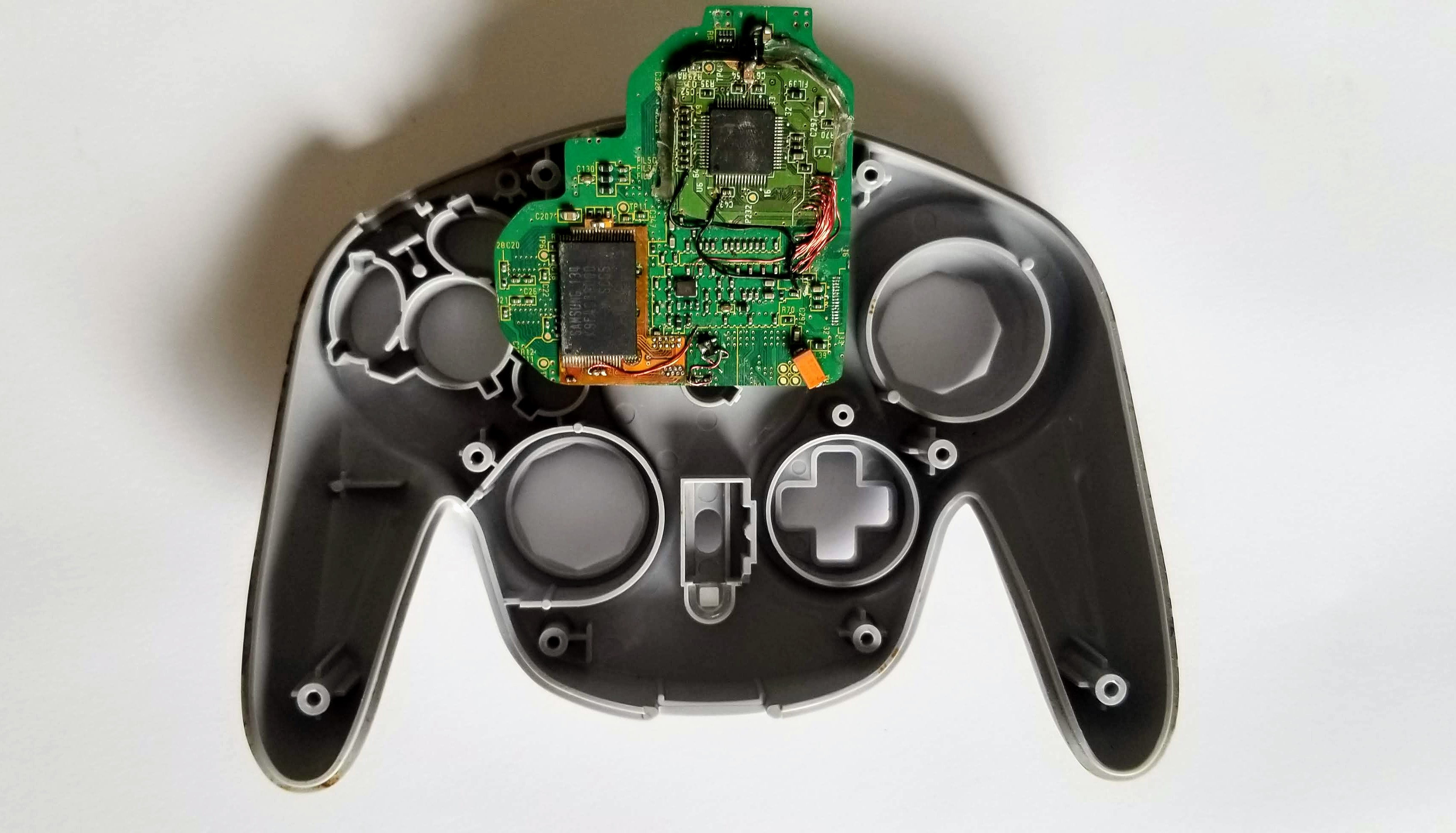

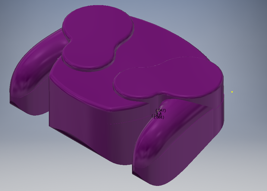

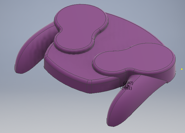

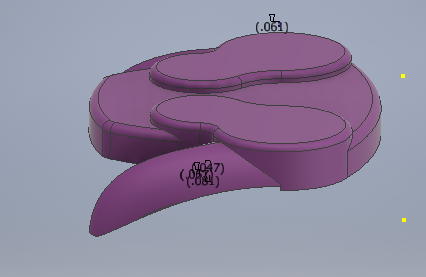

So far I haven't made much progress on this portable, aside from starting to design a GCC shell as exactly as I could. It went surprisingly well, and I do have some pictures to show my progress thus far:
The entire shell together does look somewhat chunky, but that's mostly because the back of the case still needs some shaping done to it. My biggest concern was whether or not it would even be possible to get close to OEM feel with CAD, but I'm very happy with how the front of the case looks thus far, and am looking forward to using these case assets in projects beyond this one.

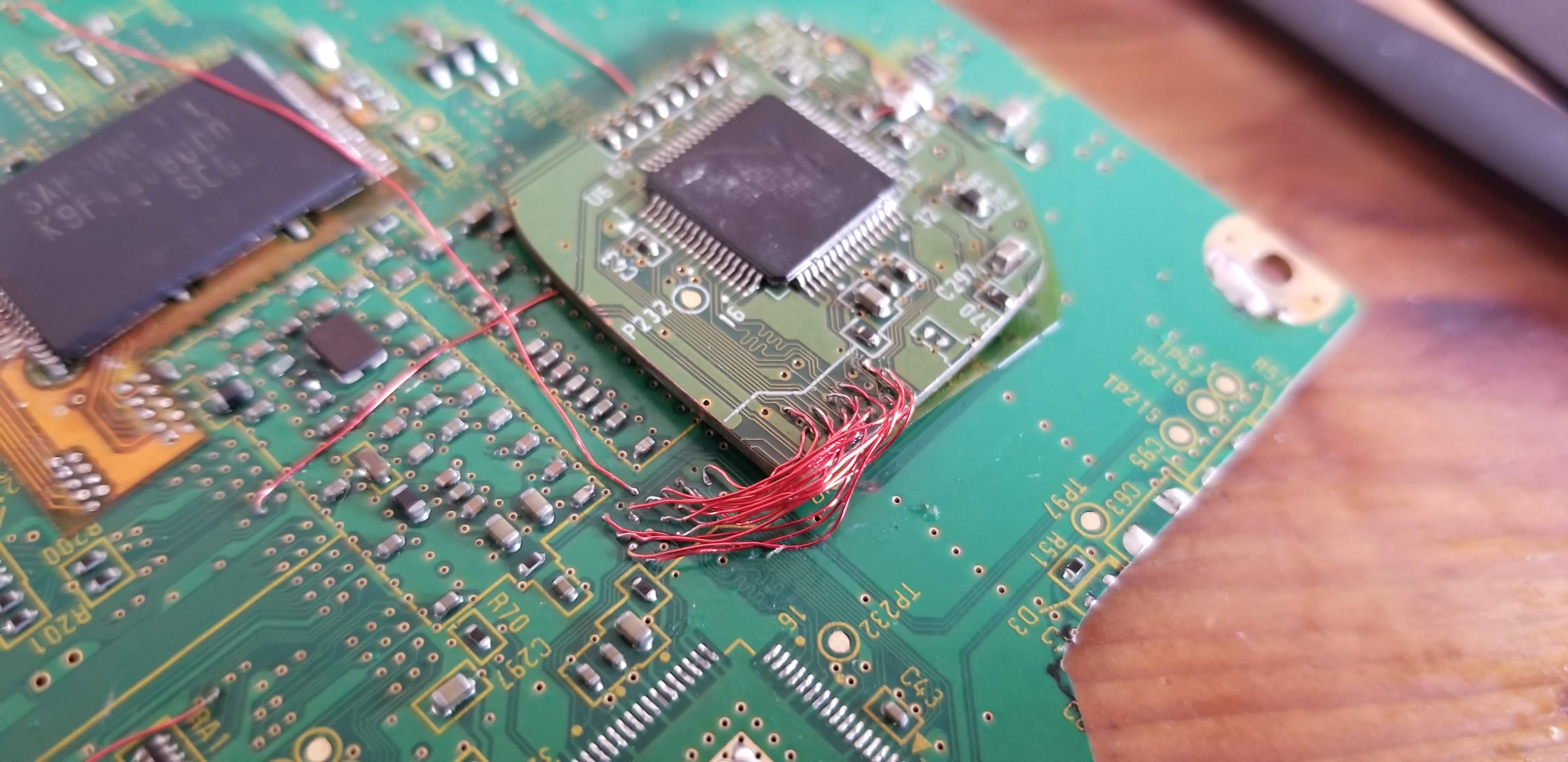

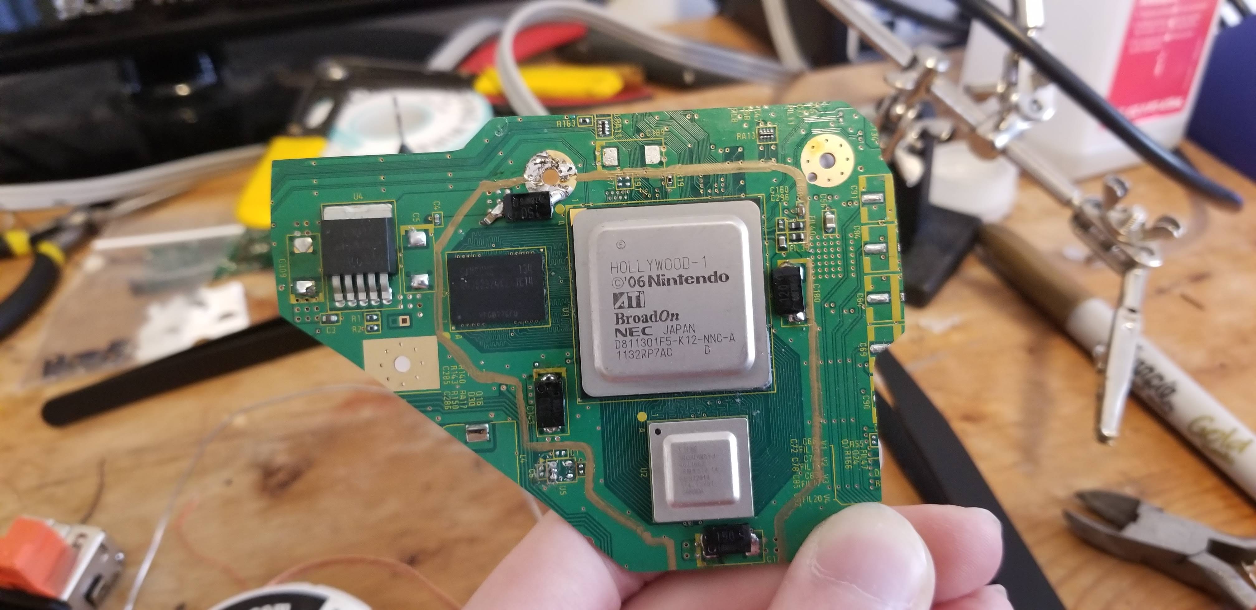

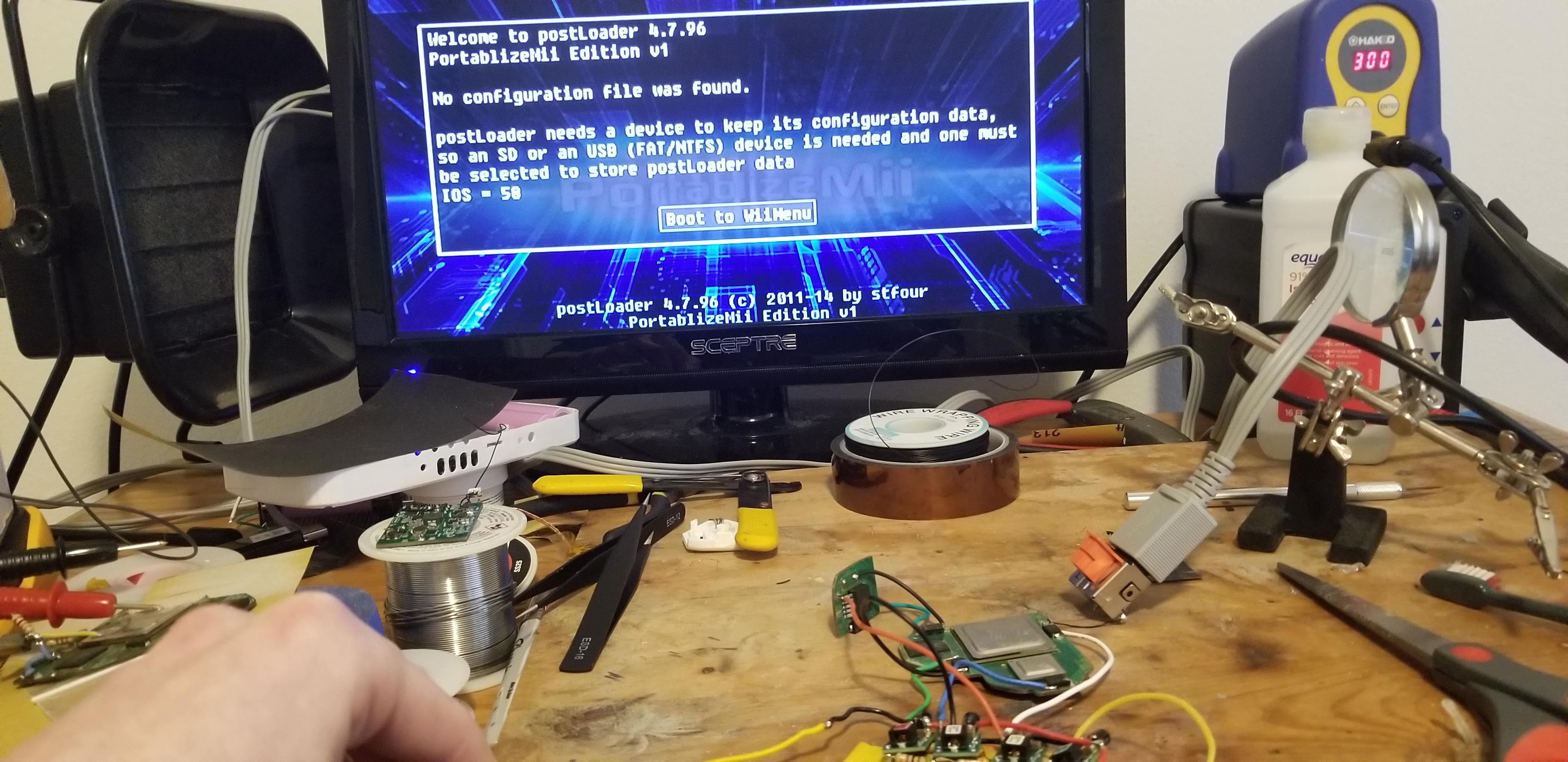

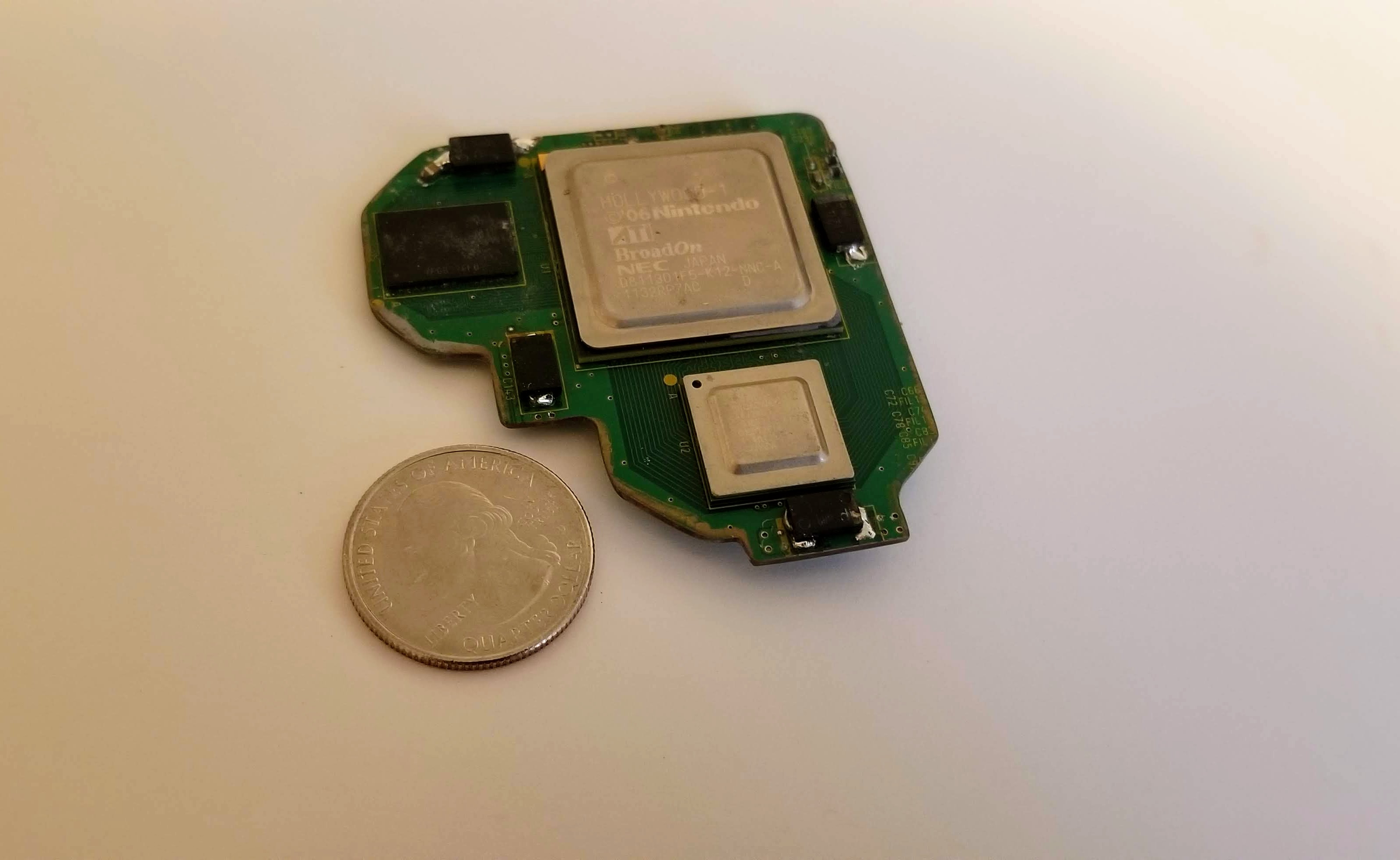

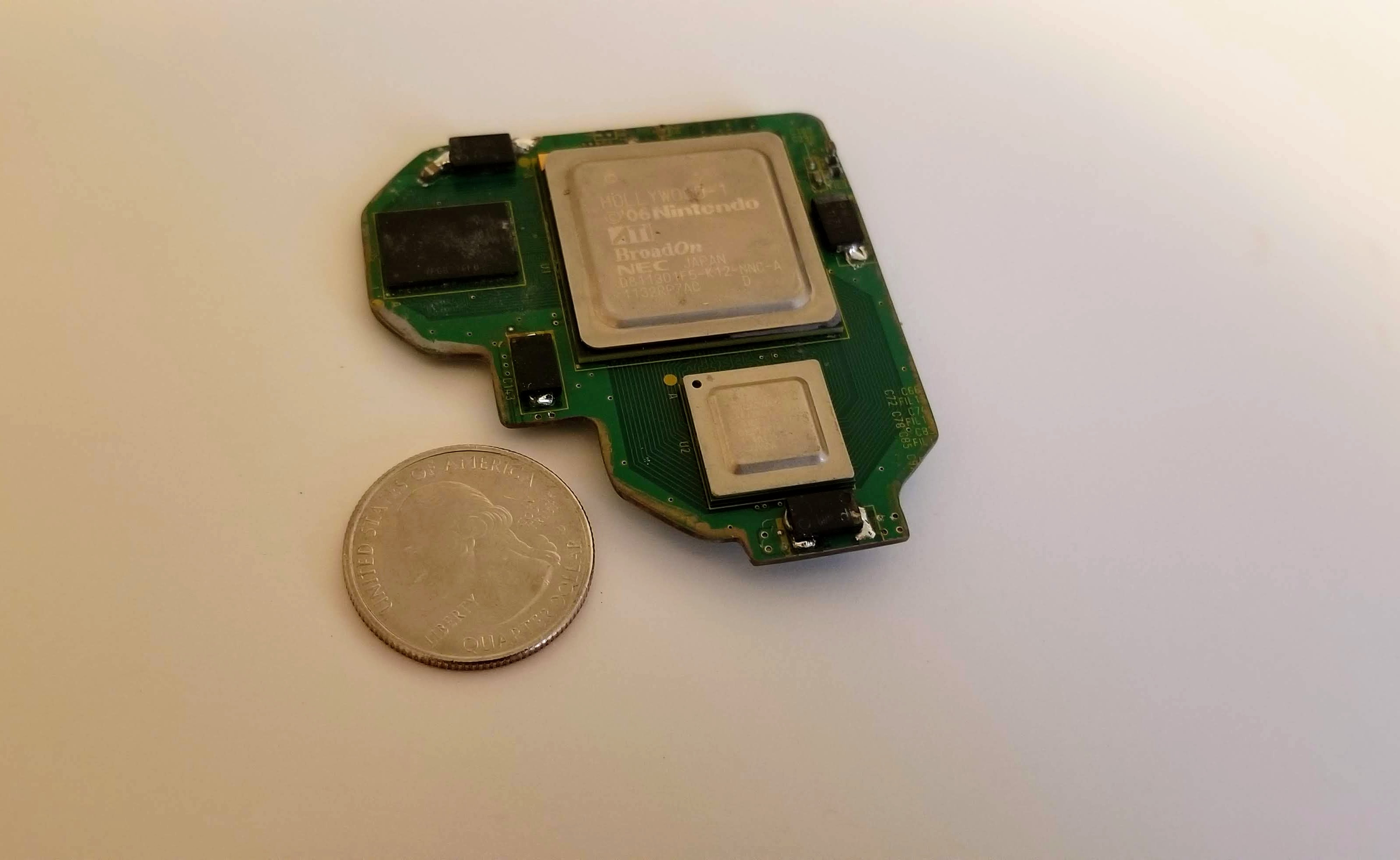

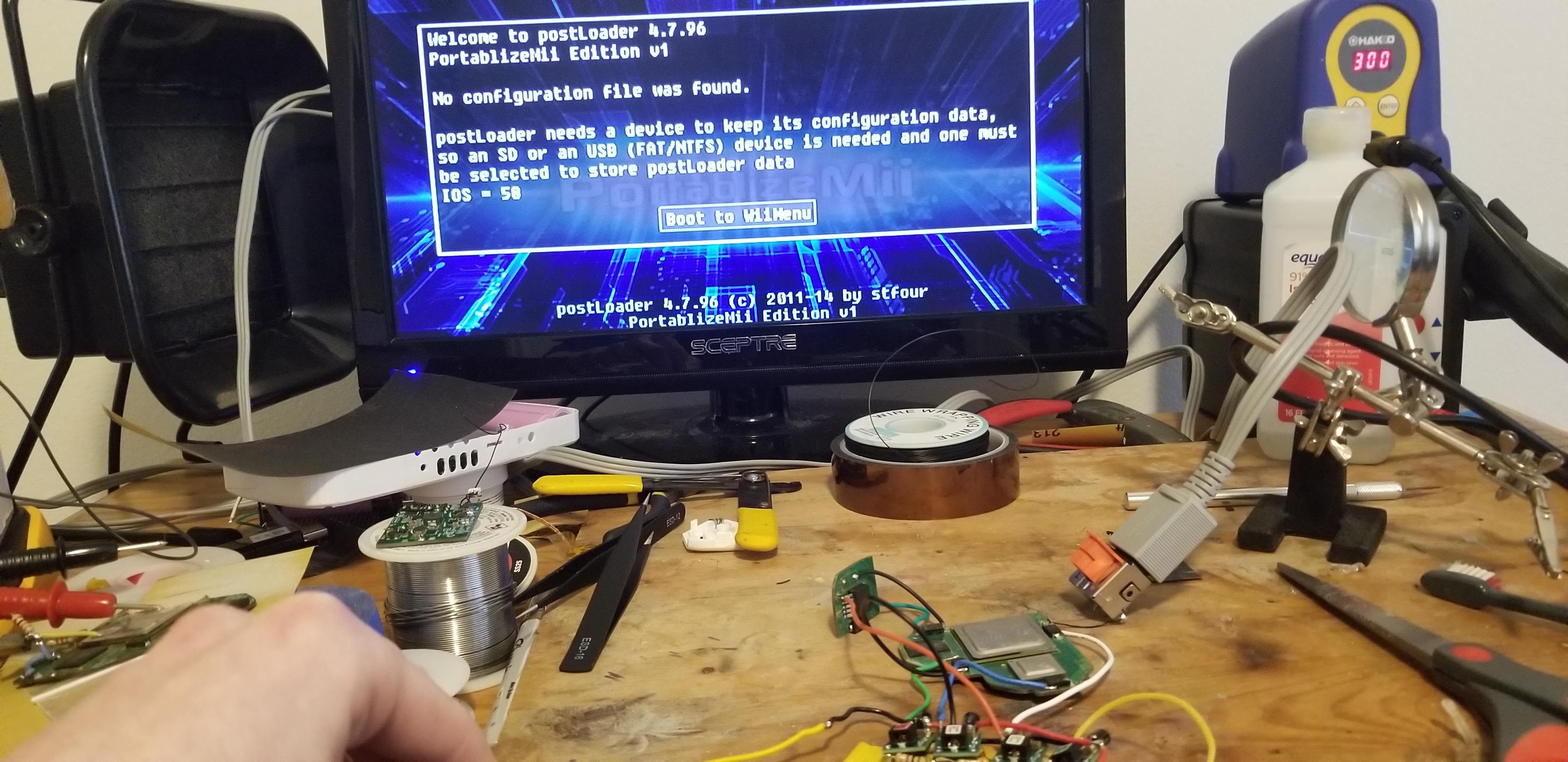

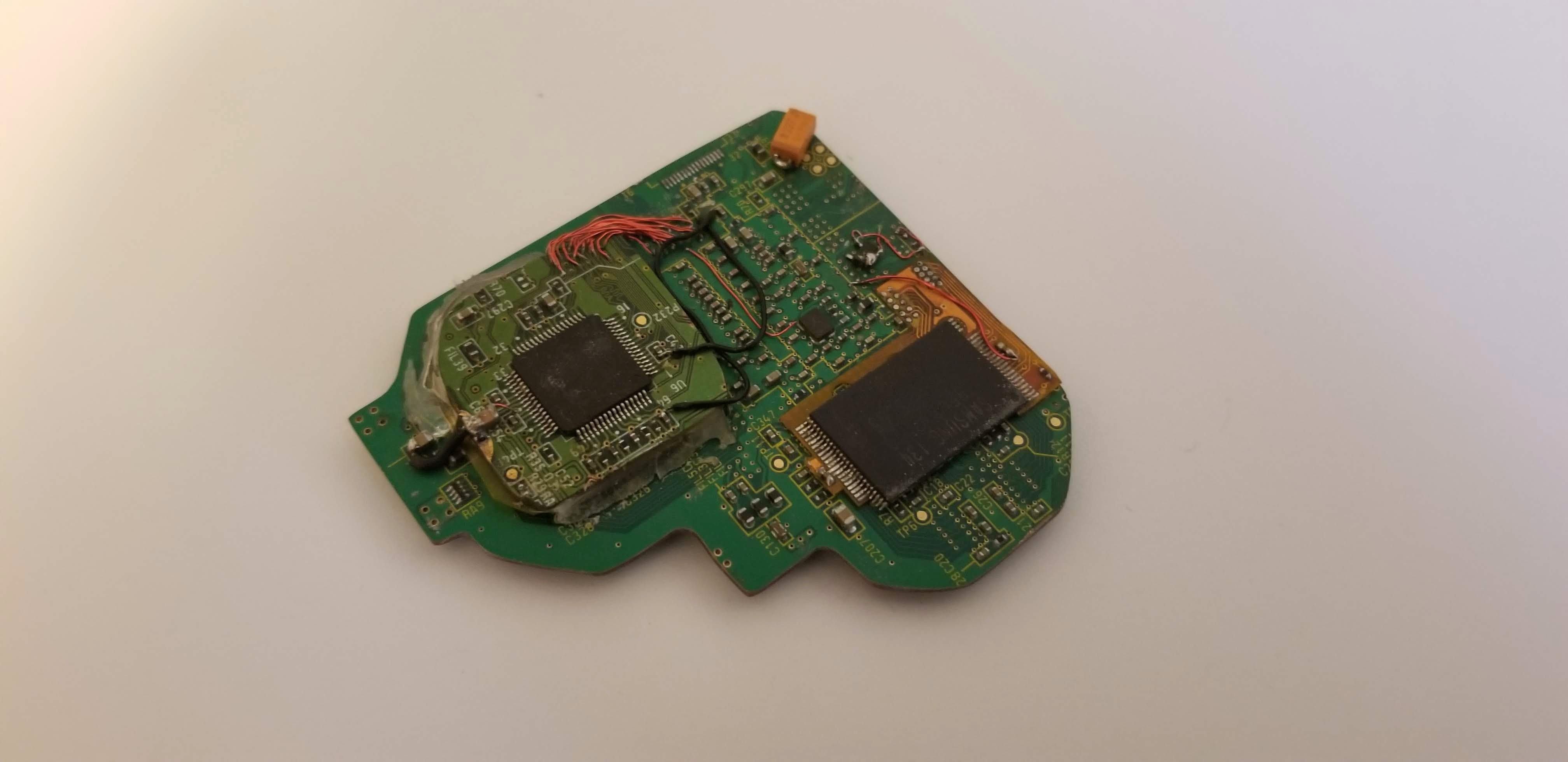

I had the itch to solder something this weekend, so I decided to tackle one of the more daunting parts of this portable: the OMEGA trim.

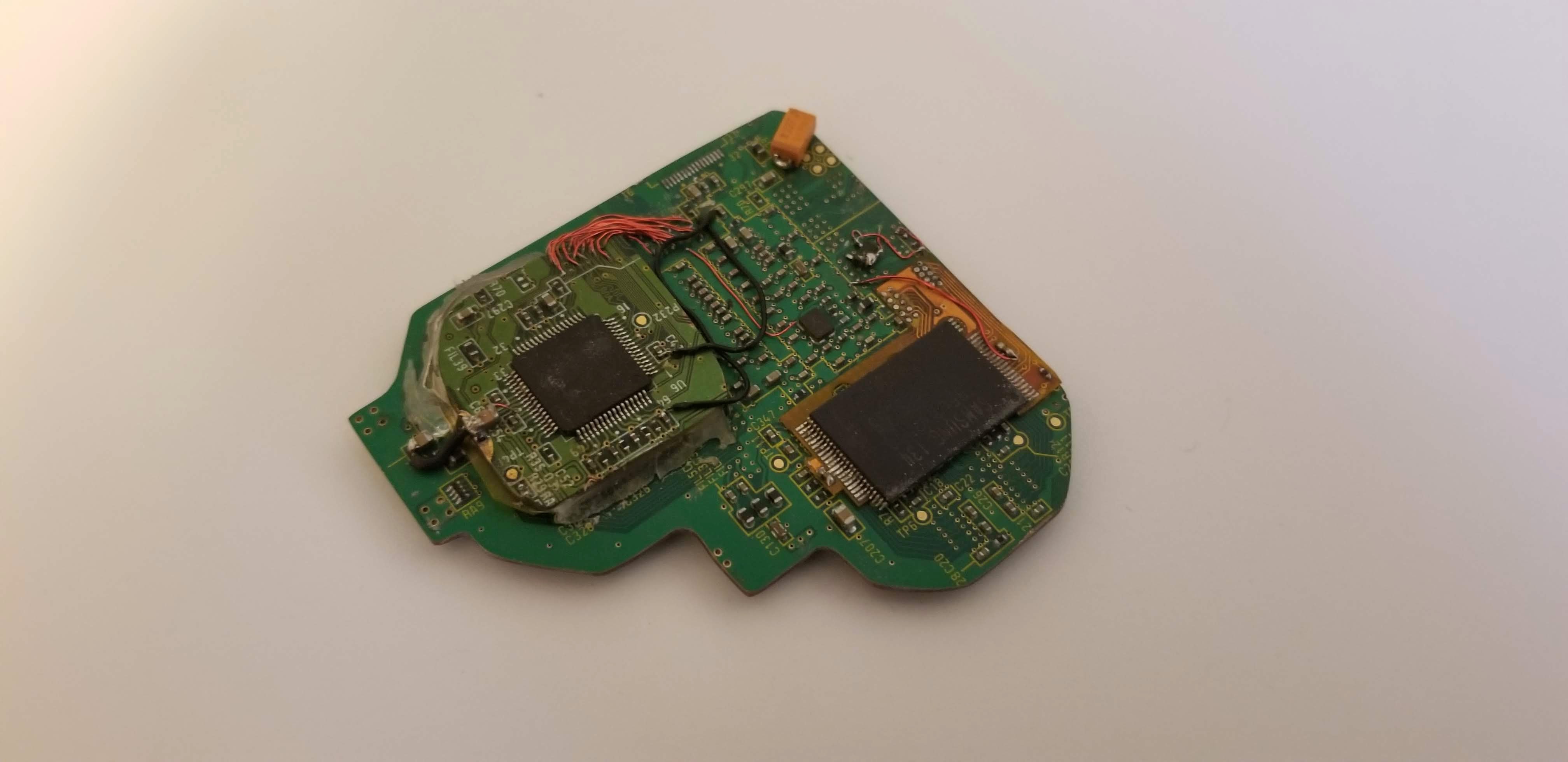

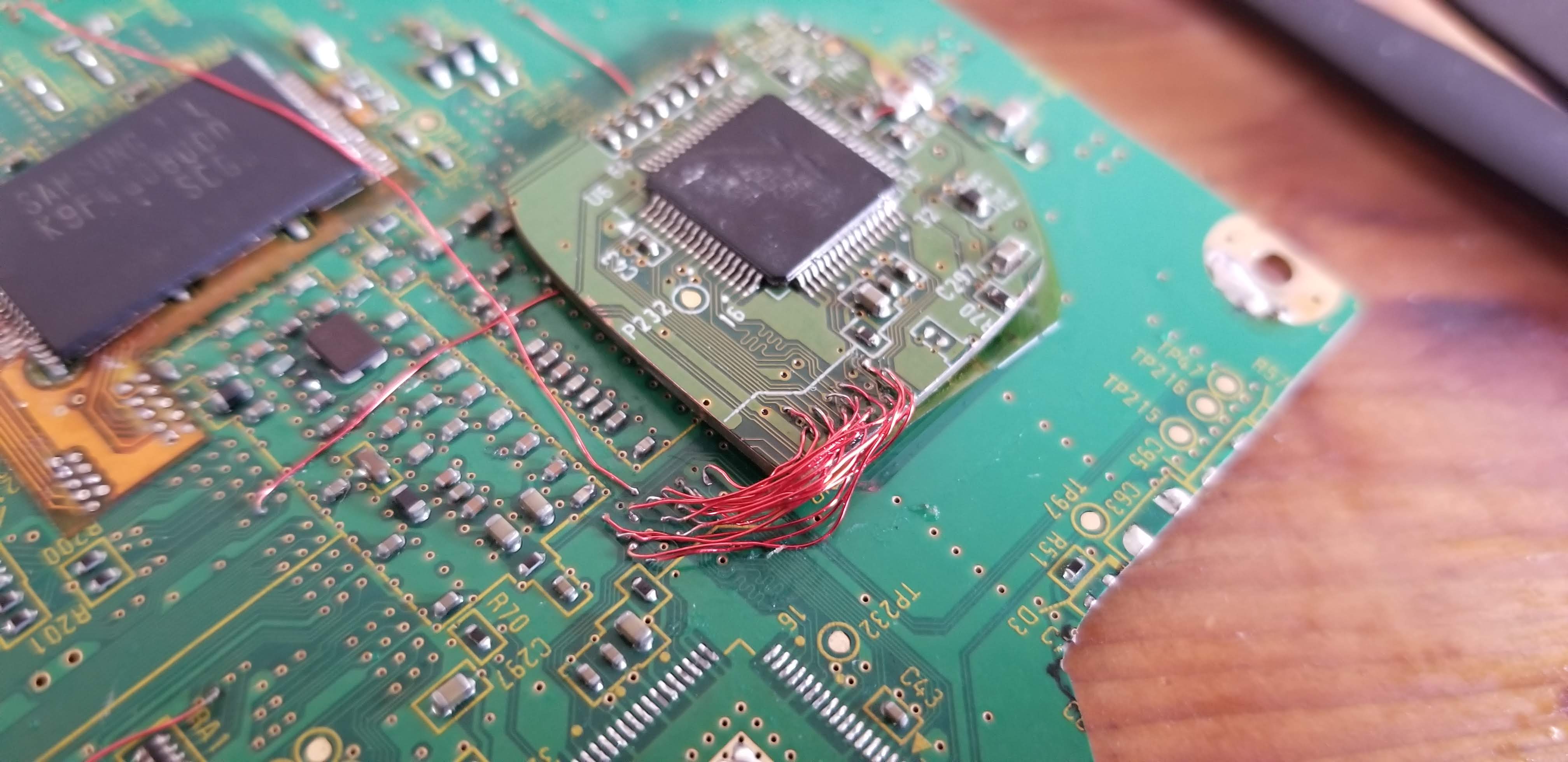

I decided to use a Wii that already had a full NAND relocation, as I had used it to test Aurelio's flex boards a while back. With that out of the way, first up was to relocate the AVE. I had a dead LMAO trim from a long time ago, so I chopped the AVE section of the board out of that. It took 3 hours of careful soldering, but it was worth every second, as turning on the Wii showed that I was still getting video!
Next, I worked to relocate the last couple of resistors and capacitors that would be chopped off in the final cut. Testing after this revealed that the Wii was still working properly, so it was time to slice and dice!

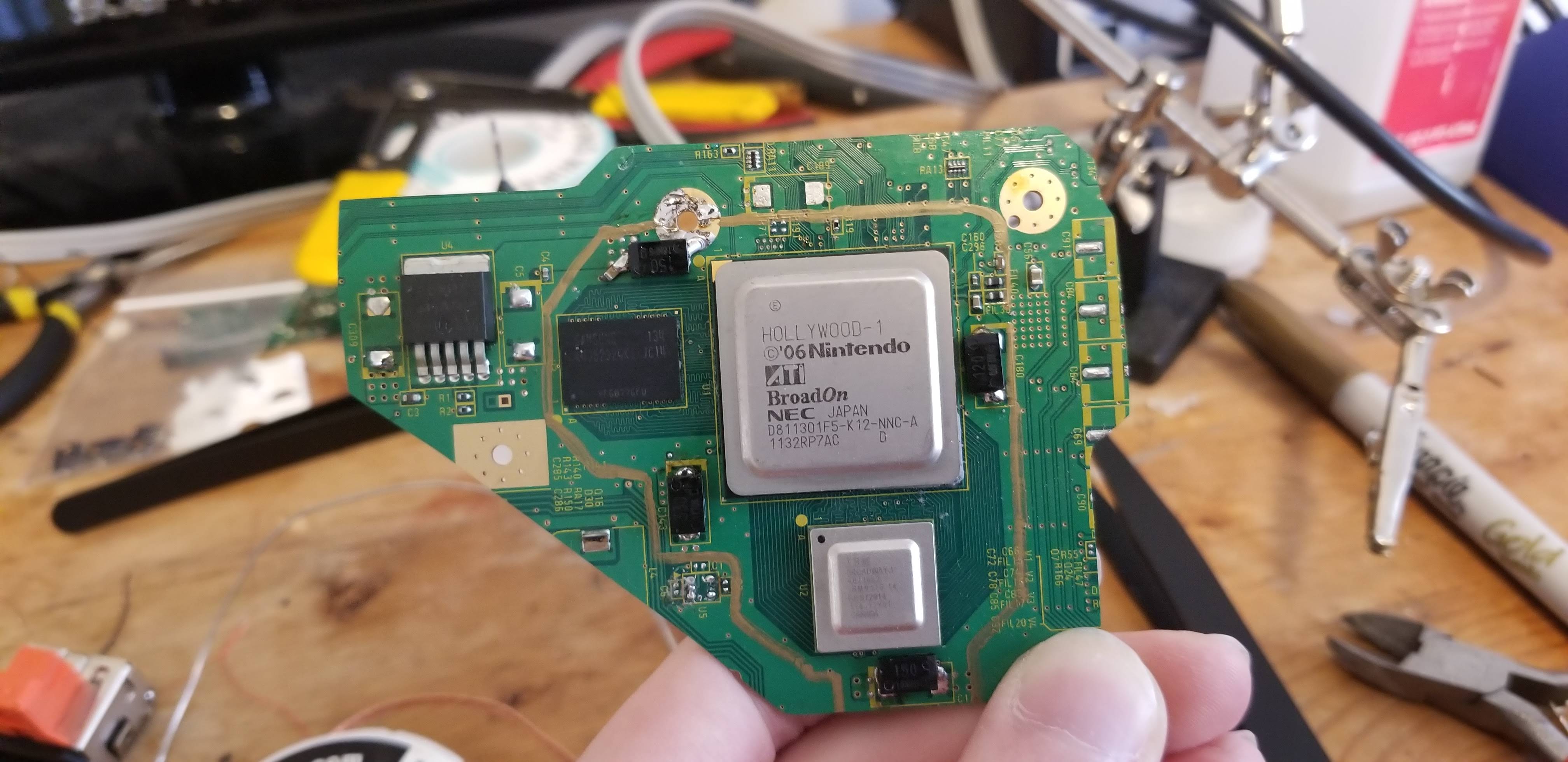

A few minutes with a dremel, an hour with some sandpaper, and one LDO wiring up later...
It works!
A huge thanks to Nold and Madmorda for allowing me their help and documentation. Without them, this would have been much harder to pull off.
The dream lives on, so next up is a LOT of brutal CAD work. Progress on this may be put on hold for a little while as I would like to wrap up my Waker v2 project soon, but I will begin working in earnest on this portable soon.
A few minutes with a dremel, an hour with some sandpaper, and one LDO wiring up later...View attachment 8745
It works!
View attachment 8746 View attachment 8747

Dude...
I solder for a living, and have been doing so for like 10 years,
i could not do that, that is art. I have never seen such well done rework.
