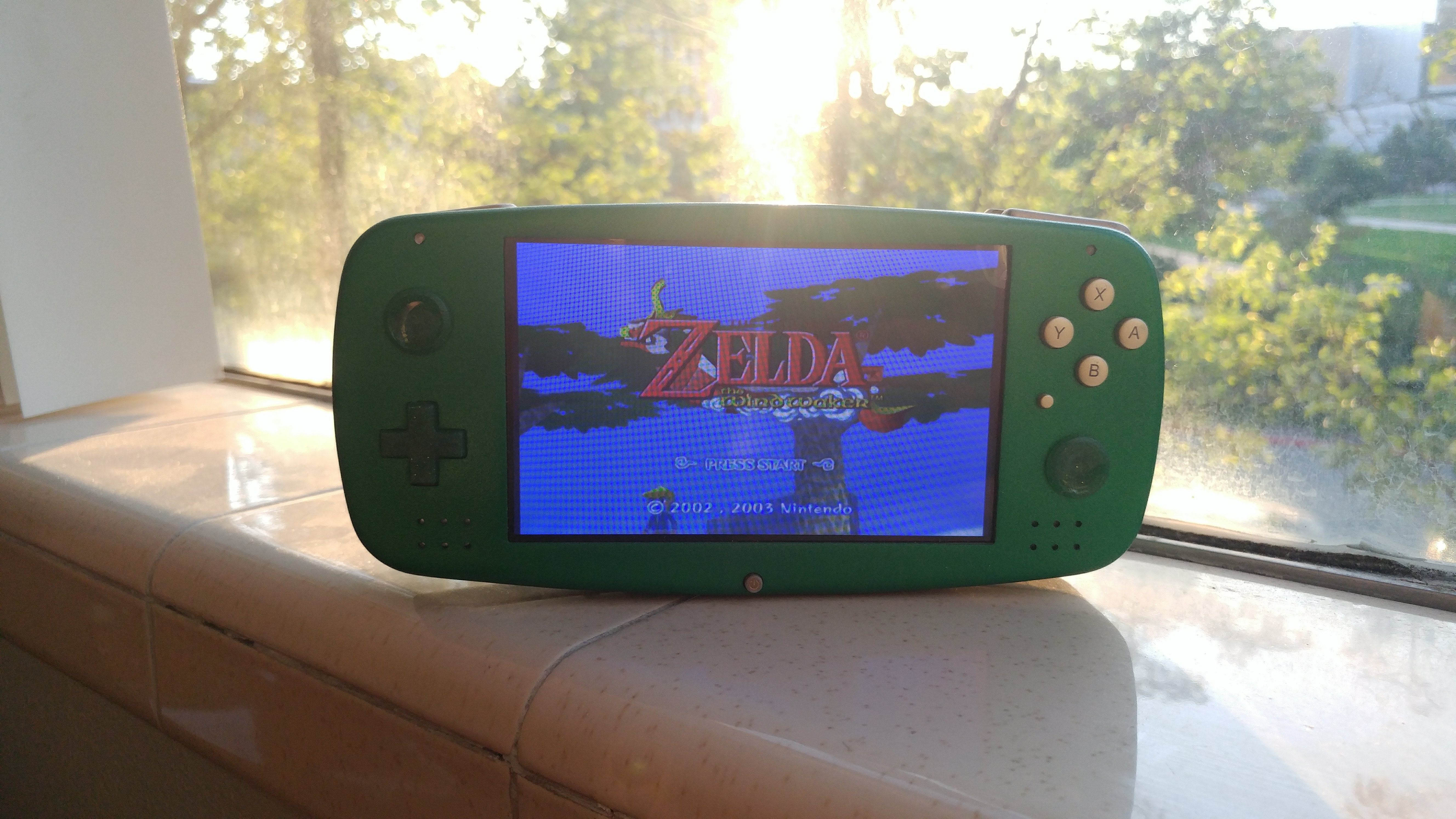

The quest of a year and a half of trying to build a working Wii portable finally came to a close when I screwed this guy shut a couple hours ago. Meet your Waker:
I am so happy with how this turned out. It works, it's super comfortable to use, it's responsive, it's gorgeous, it's everything I want in a portable.

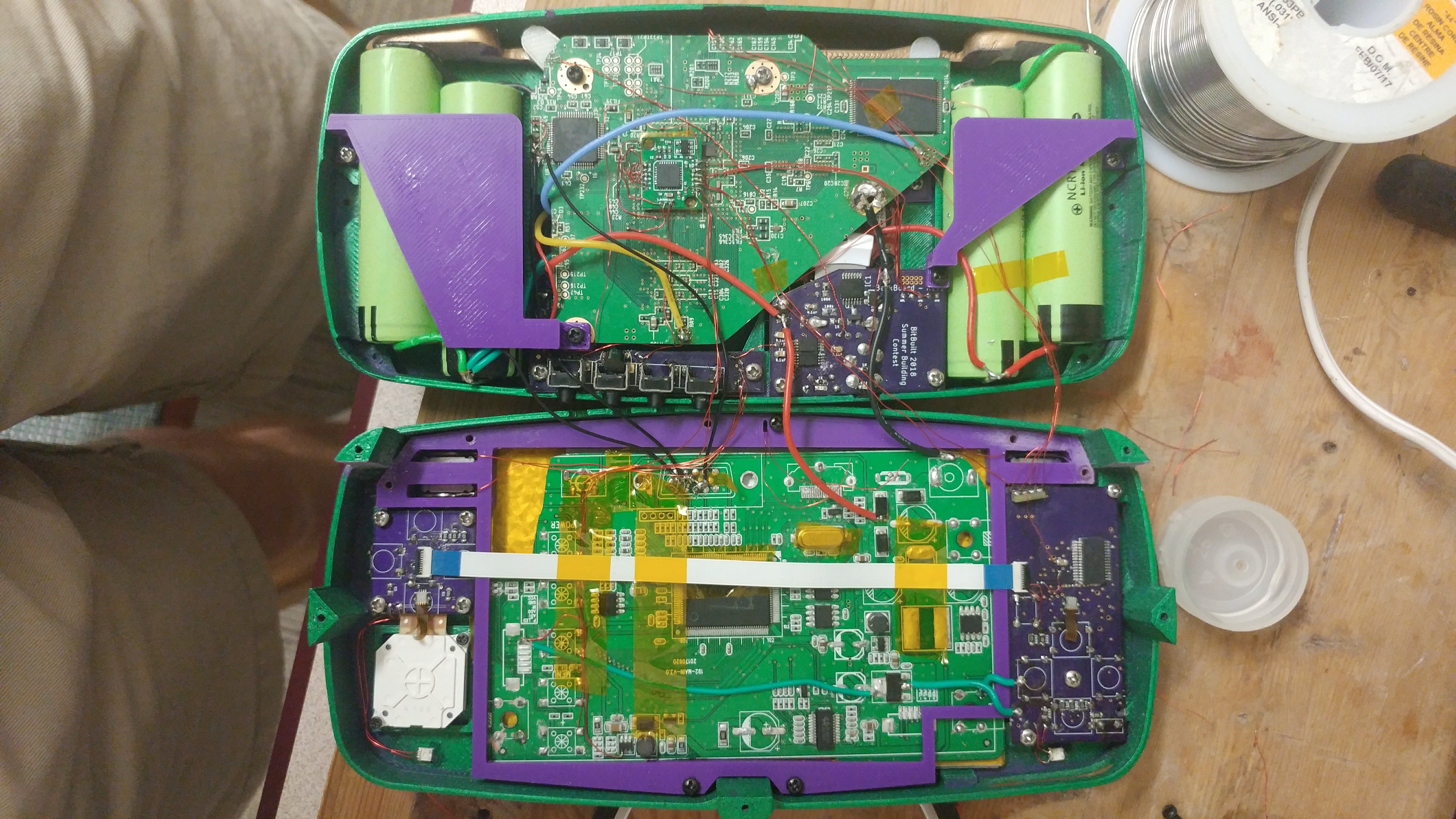

Can't have a portable without internals! This image is slightly dated, but the only thing that changed from this picture is that I connected the power button to the other half of the portable.
My wire routing isn't all that great, but other than that I'm very pleased with how my internals turned out. I don't remember the exact number of screwposts this portable has, but it has a lot. Glue was a last resort for a couple of the smaller bits, anything that breaks in this portable can be swapped out with nothing more than a screwdriver and a soldering iron.

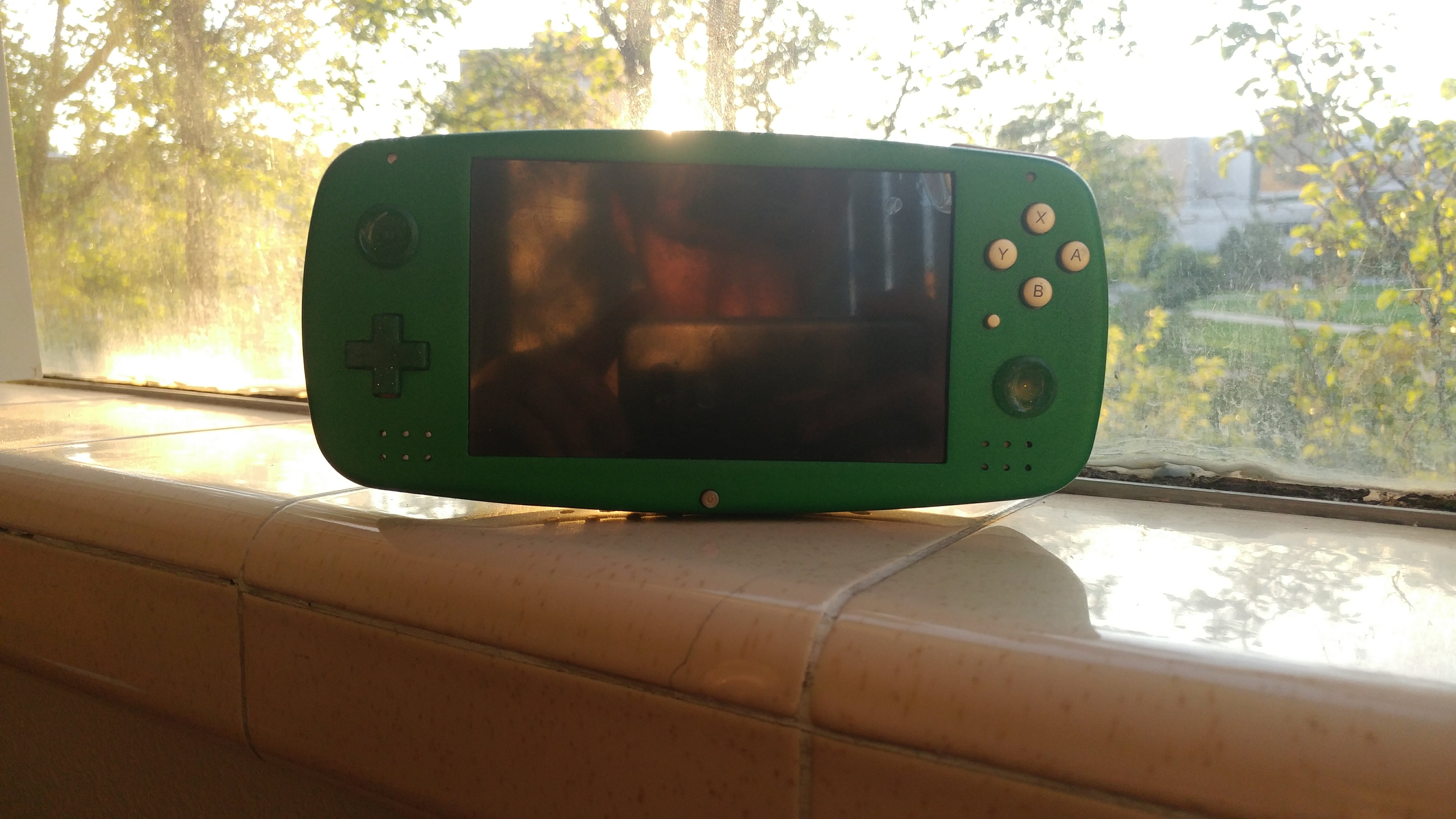

Features:

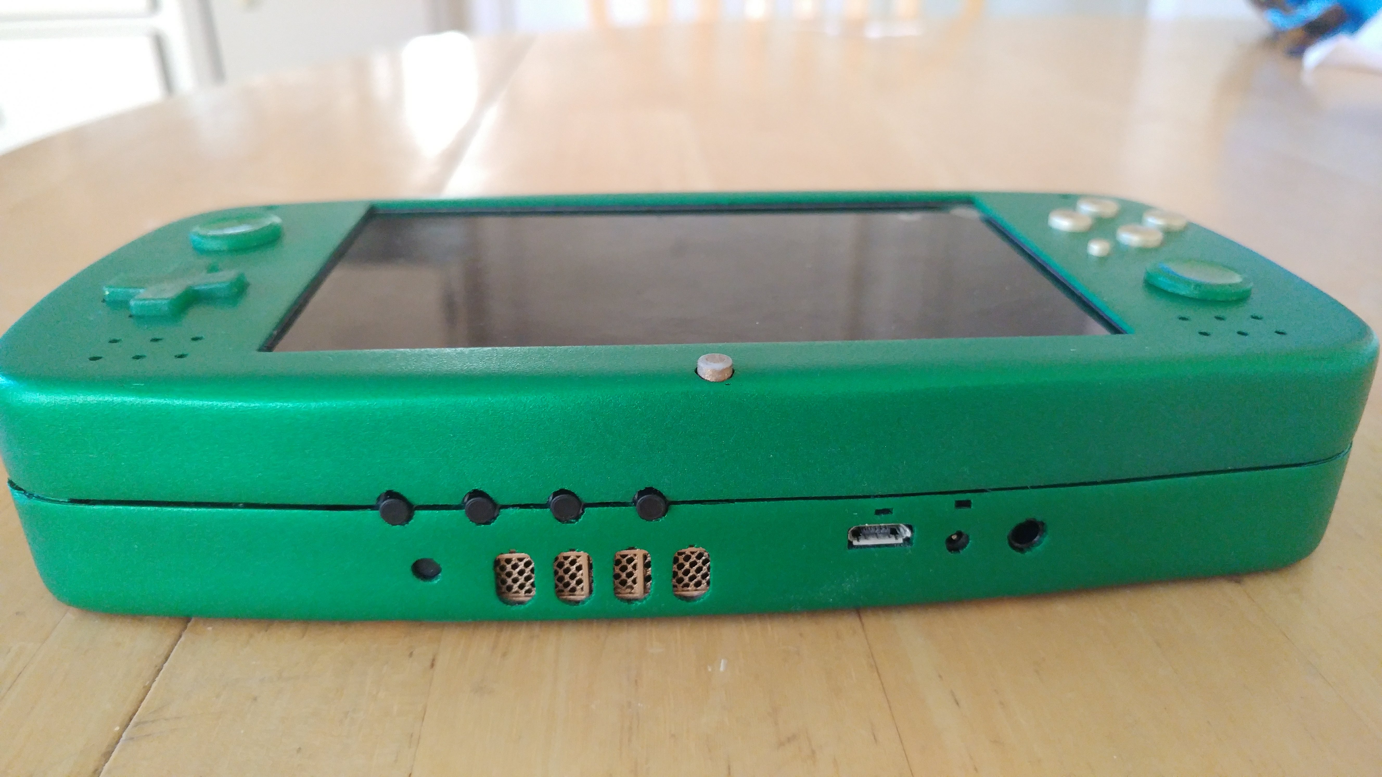

- 5 inch 480p screen thanks to component video. Looks absolutely amazing.
- 3D printed case designed entirely by yours truly. Printed out by Shank.
- Single push on/off button
- Simultaneous charge and play thanks to the red board
- Custom molded buttons from Madmorda that look and feel amazing
- Powerful speakers and switching headphone jack controlled via the built in GC+ thanks to Aurelio
- Internal USB drive accessible through a micro-USB port
- Screen control buttons with the "down" button doubling as the Wiimote sync button thanks to the help of Gman.
- Recessed reset button just in case
- IR LEDs to allow for full Wiimote compatibility

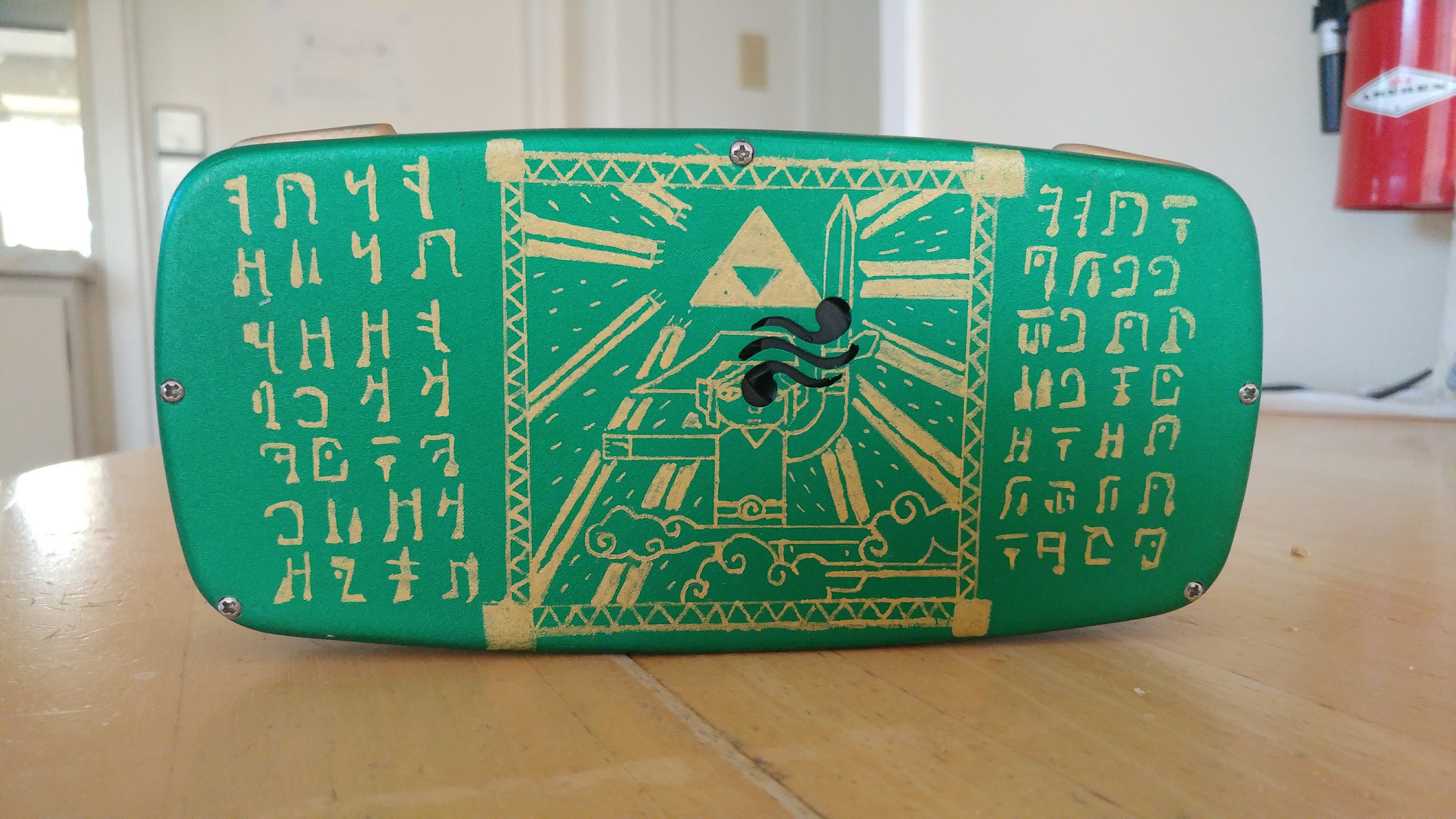

- Freakin' sexy design on the back
- Final dimensions at its largest points are 180mm x 86mm x 32mm.
