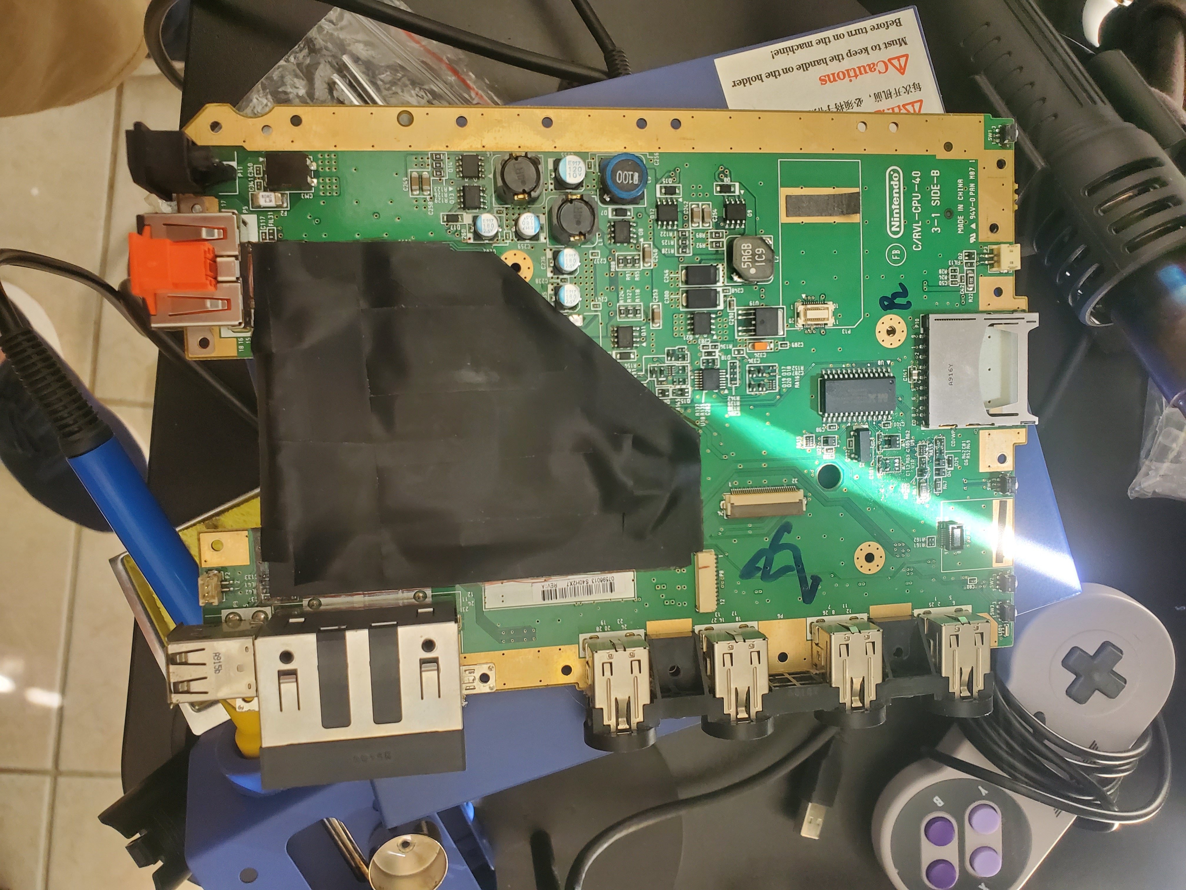

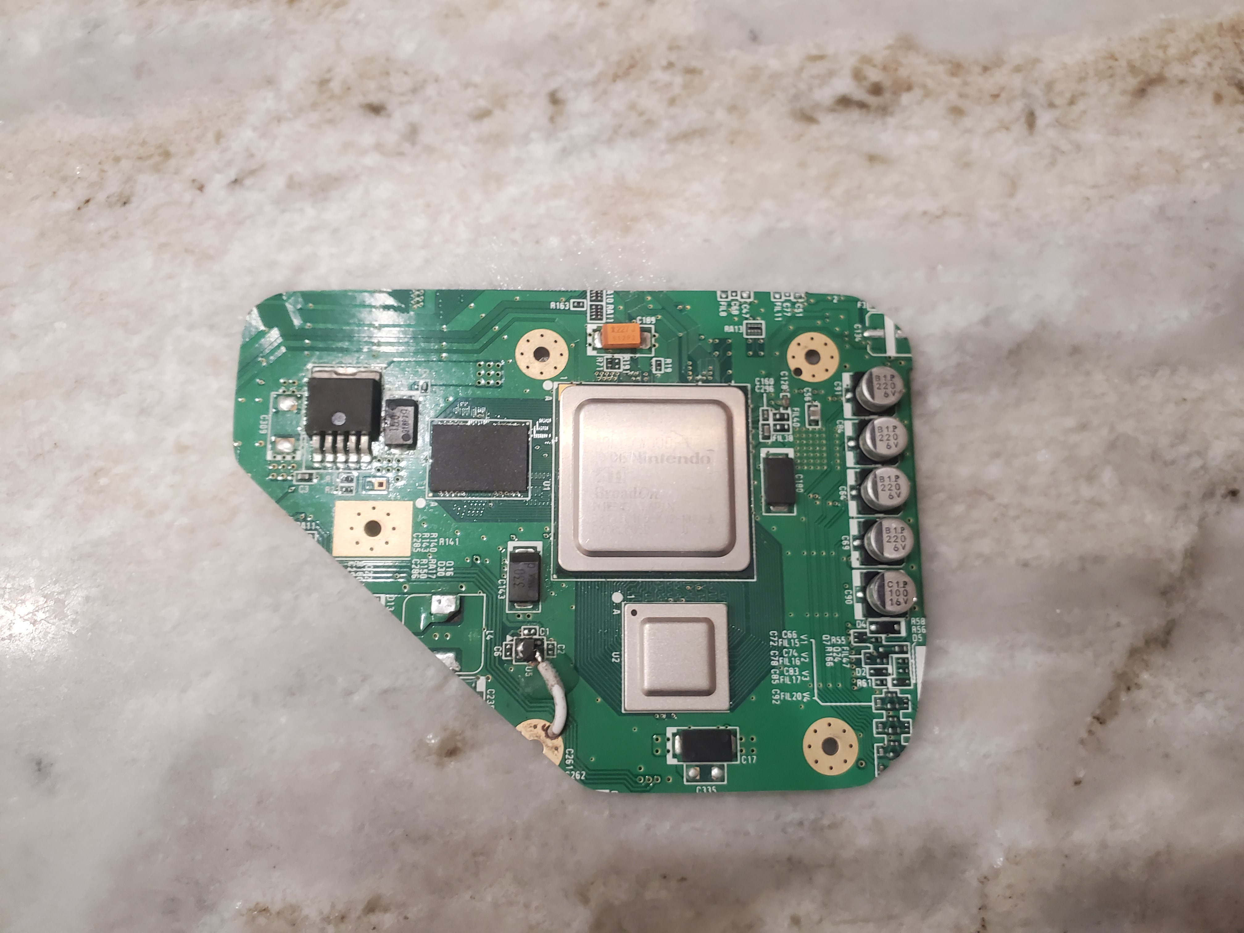

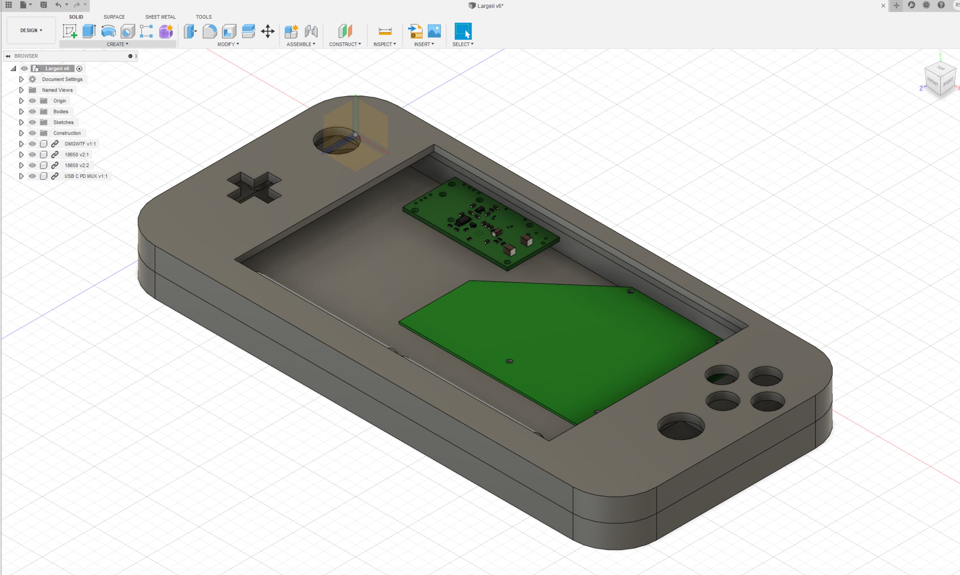

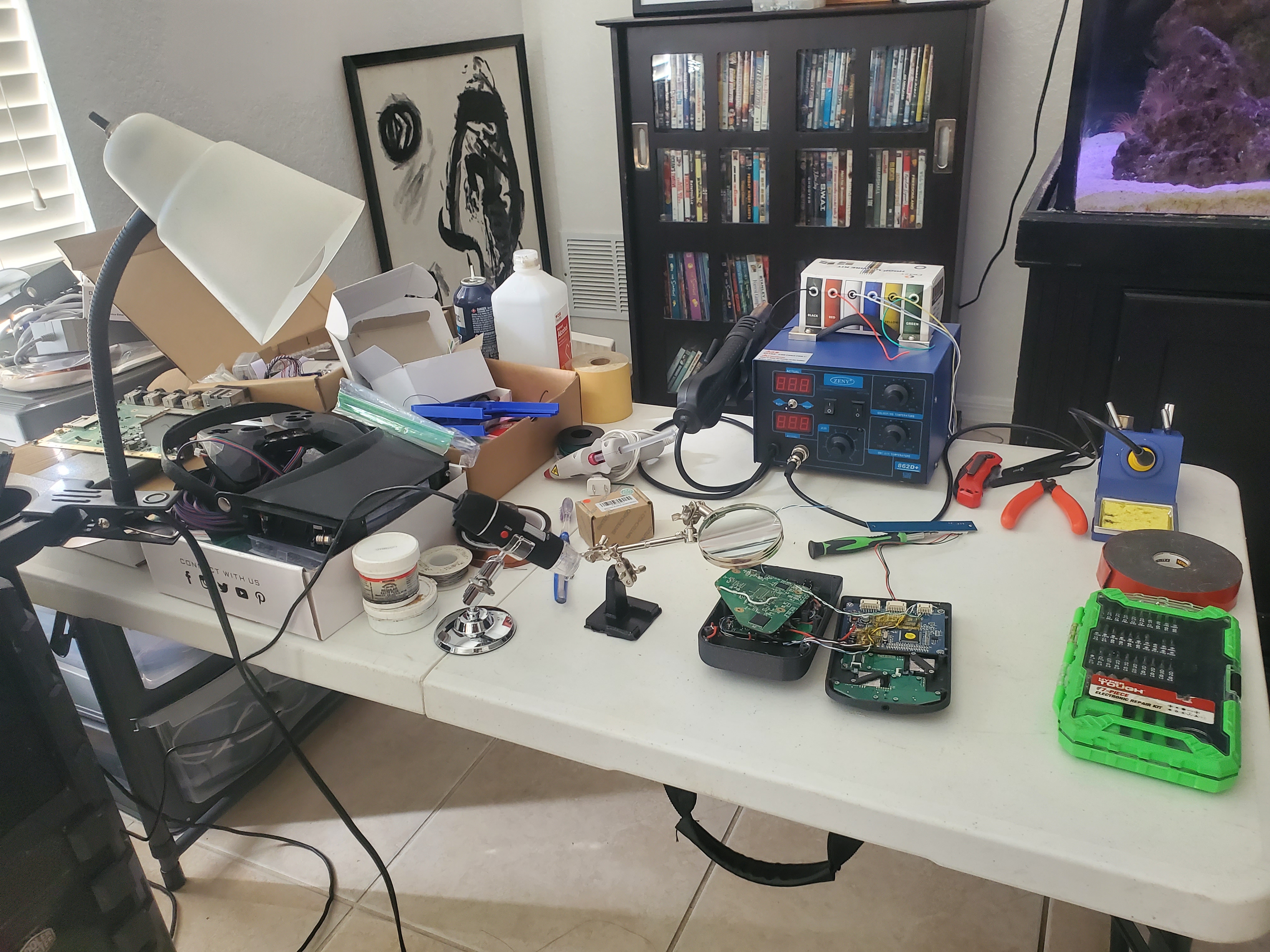

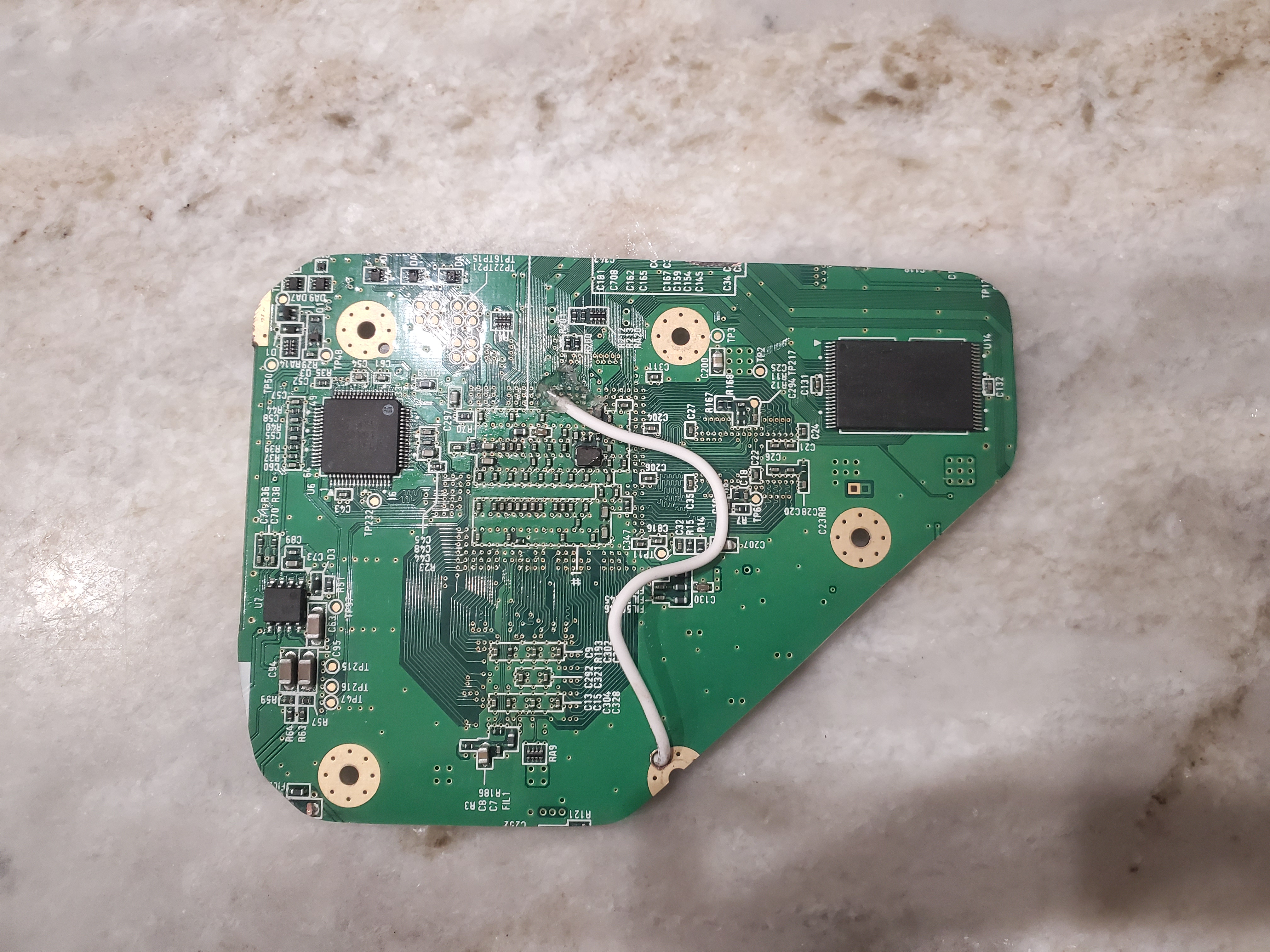

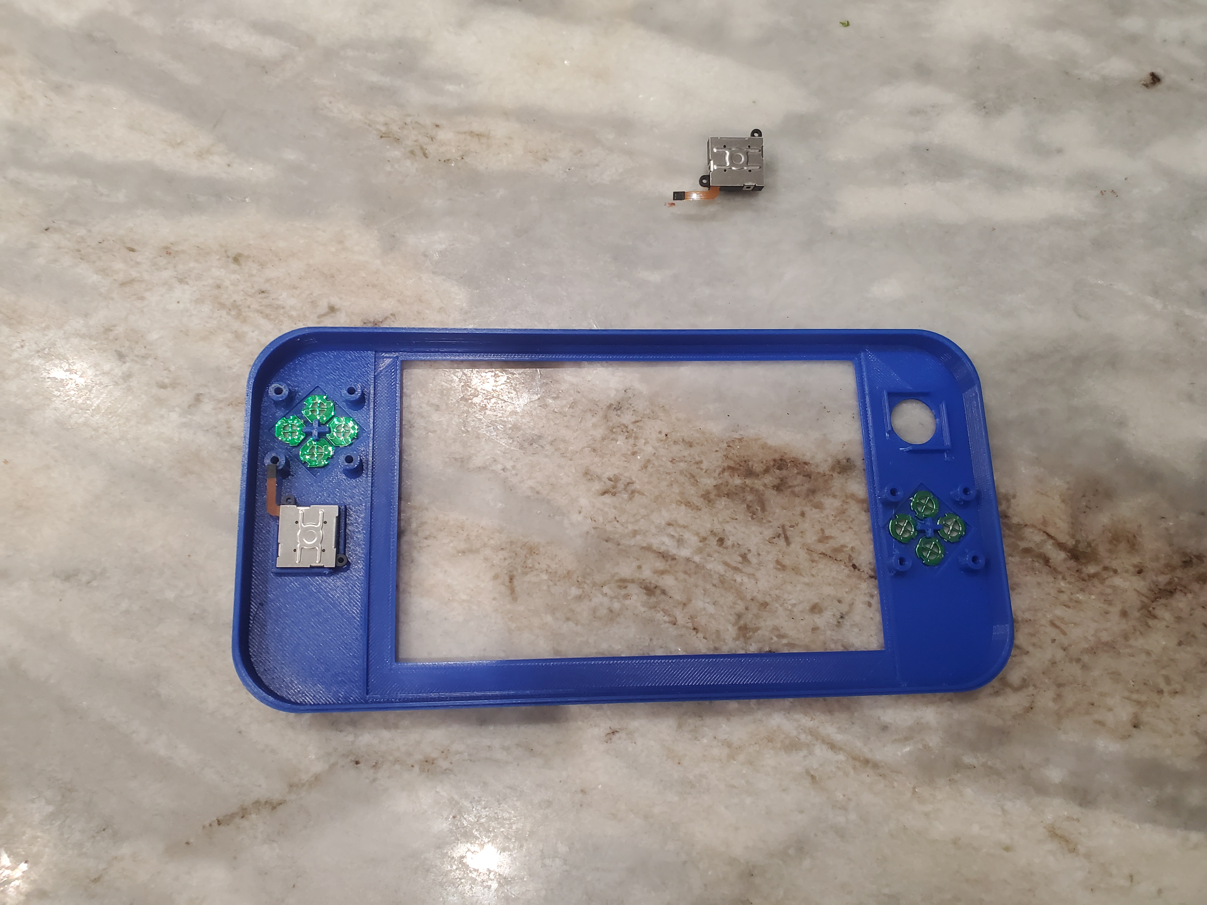

This is the start of my Largeii Wii build. Figured i would post a worklog thread of the build progress. Beginning of the design (WIP) My work area and motherboard trim. The build will use a large 7inch IPS screen, wii motherboard, switch joysticks, fullsize buttons and dpad.

That's a mighty thicc U10 wire you've got there, you may want to replace it with magnet wire.
Yeah I have the magnet wire now. When I first started that trim, it had not delivered yet, but wanted to verify before the trim. I will replace soon.
I can't believe that fat fuck wire actually works...... trim looks fine tho

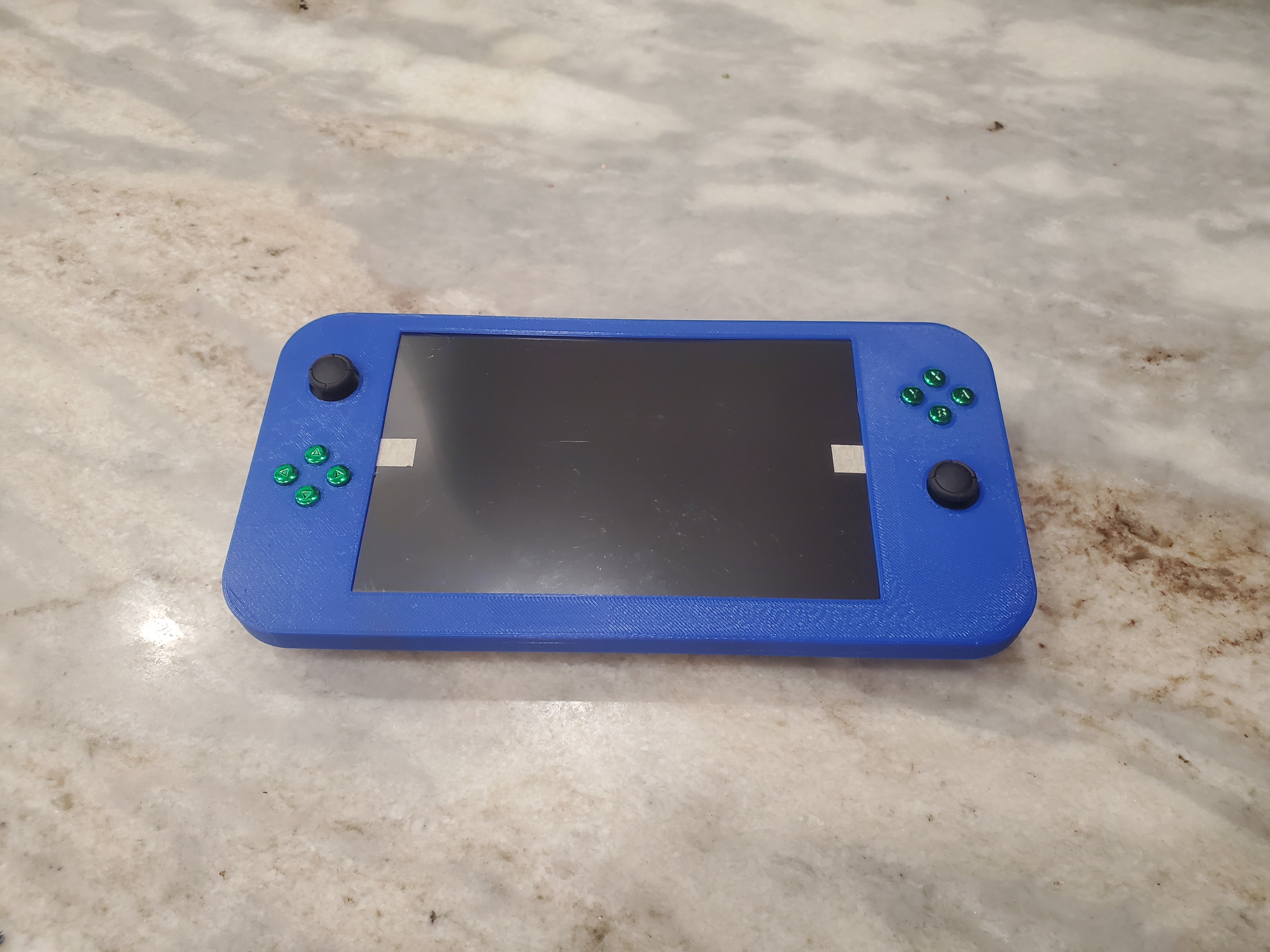

8 versions later, and we almost have the top half of the largeii. Maybe 3 more versions for top and I'll have it. Still need shoulder buttons, screen clamp, joysticks clamp, and screw mounts to hold it together.
