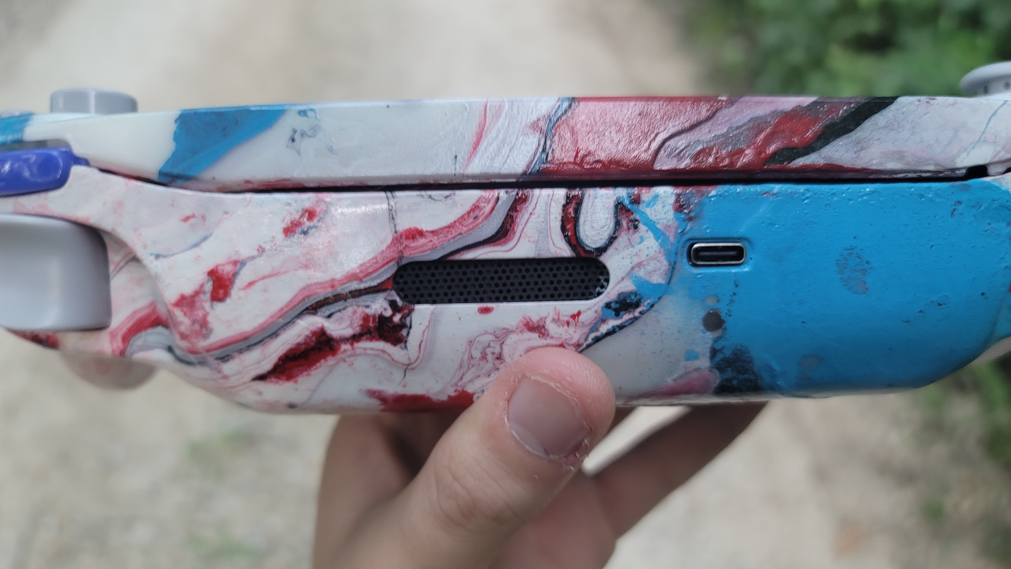

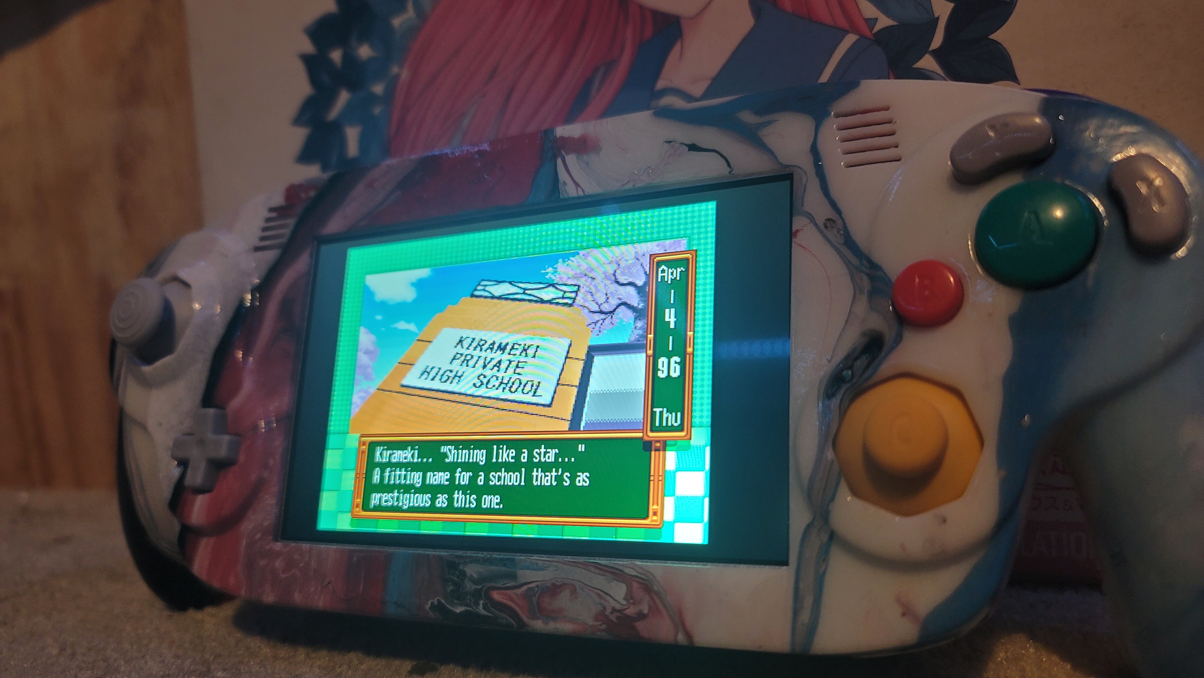

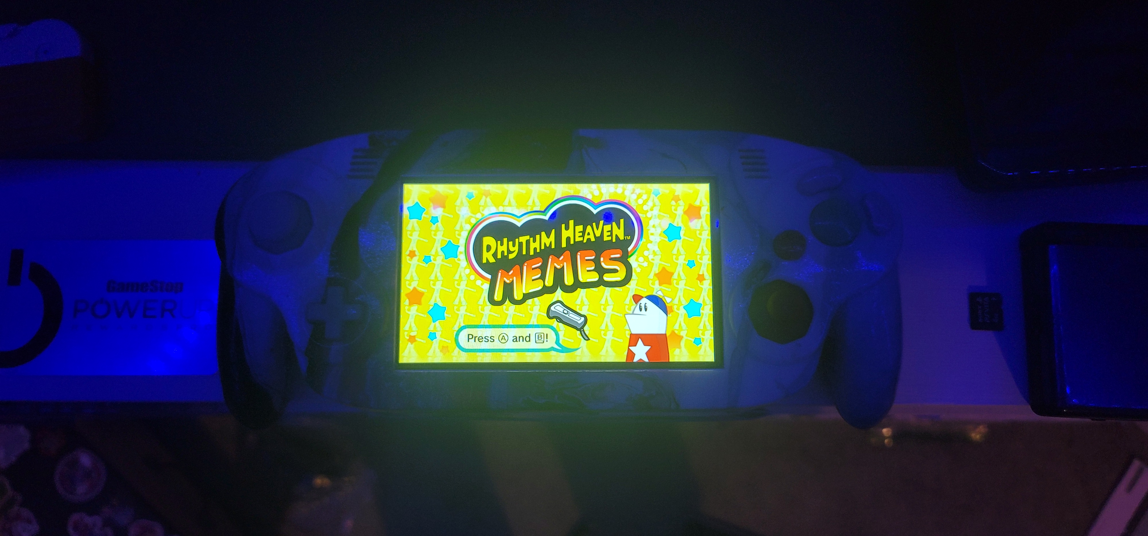

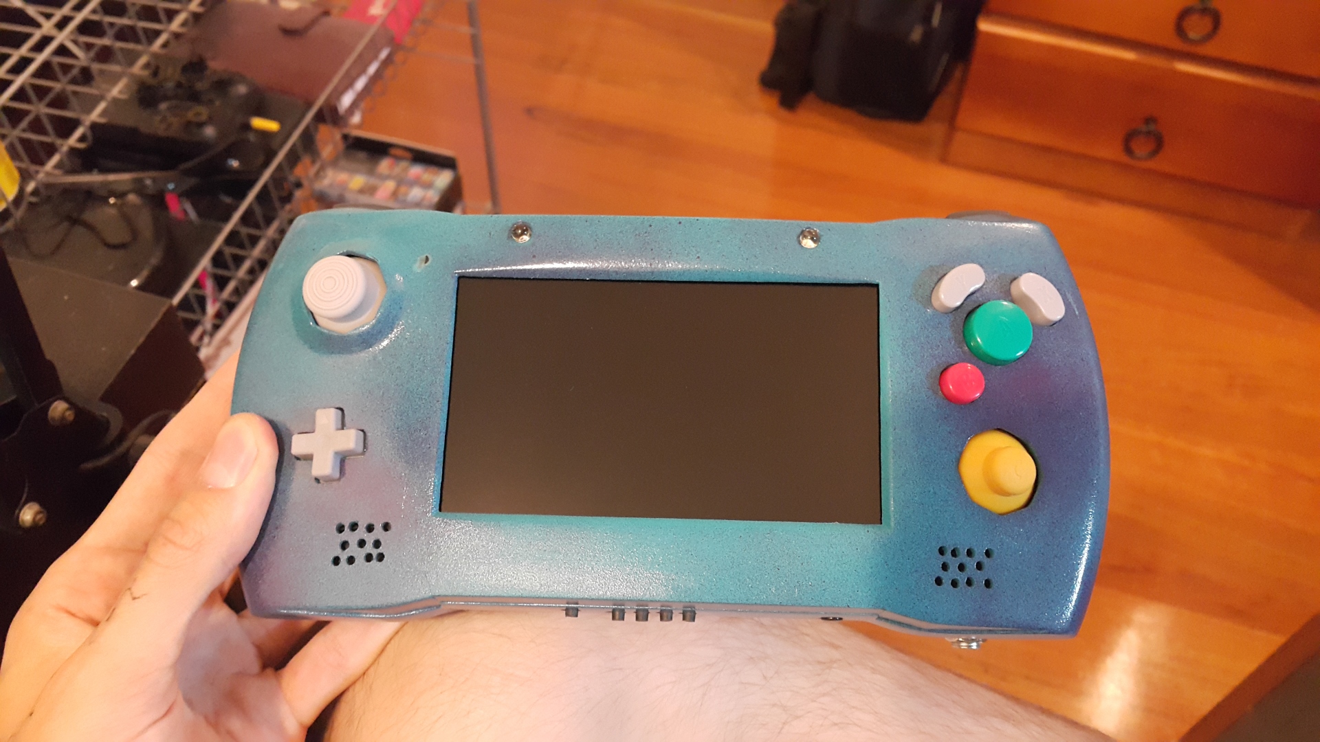

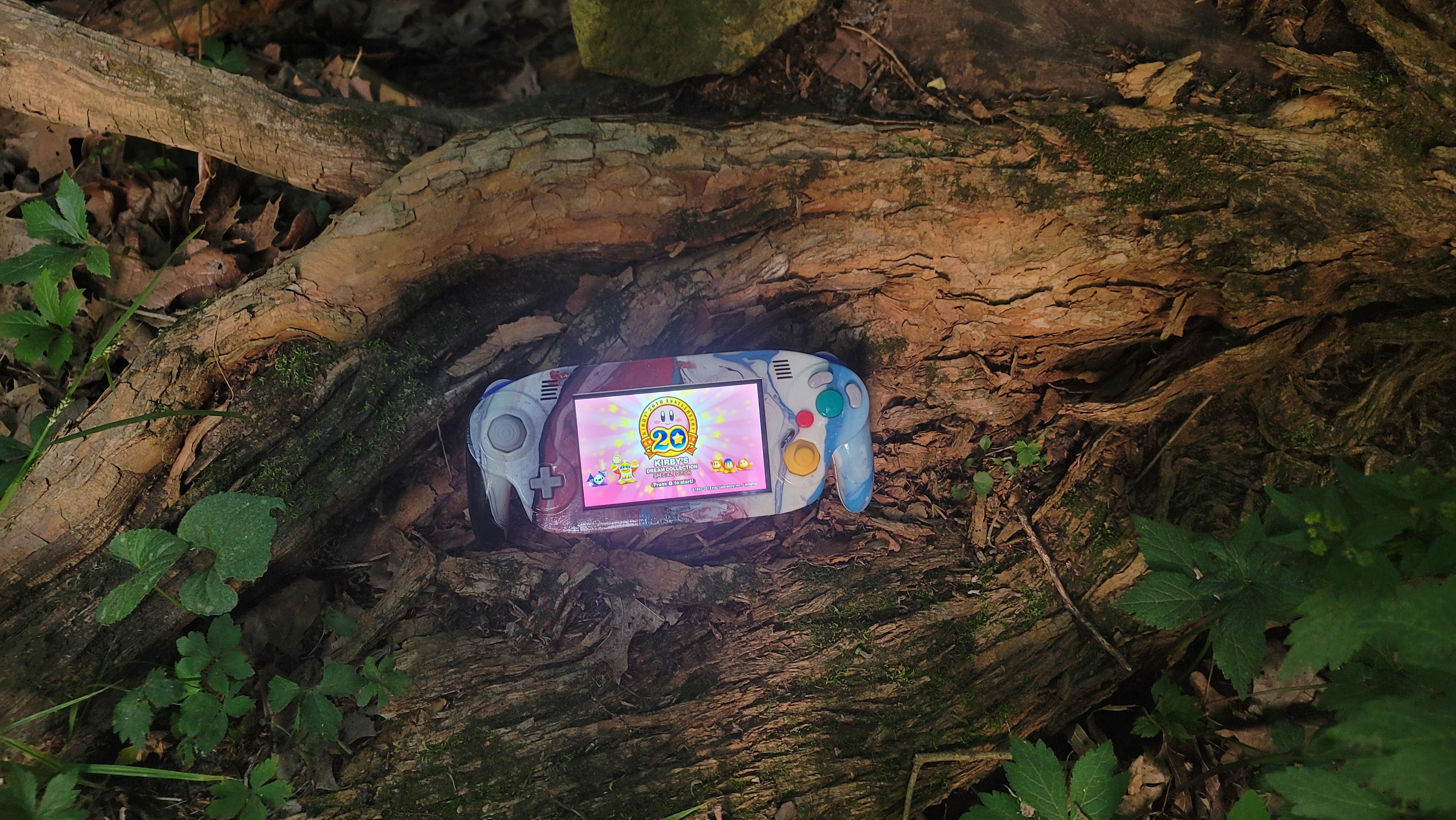

I just "finished" my first portable. I call it "The Jawbreaker", though really the shell has more of a marbled pattern. It has everything I could stuff into it. Bluetooth, an MX chip, 2 Wiimote rumble motors one in each handle, dust filter meshes on the speakers and fan ports (an idea I stole from PiR8_BTY) and WiFi, all in a resin printed hydro dipped shell featuring the 4 colors the Wii originally came in.
Now what do I mean mostly complete? Well I accidentally damaged my RVL-PMS-2 when soldering, I knocked resistors R14 and R15 off the board. Nothing I can't fix, but for now that means I can't connect the SDA and SCL lines to the Wii, which means some features, like the power LED and battery charge indicator don't work for the time being. Until that point, I think I'mgonna enjoy myself some portable Rhythm Heaven Fever.

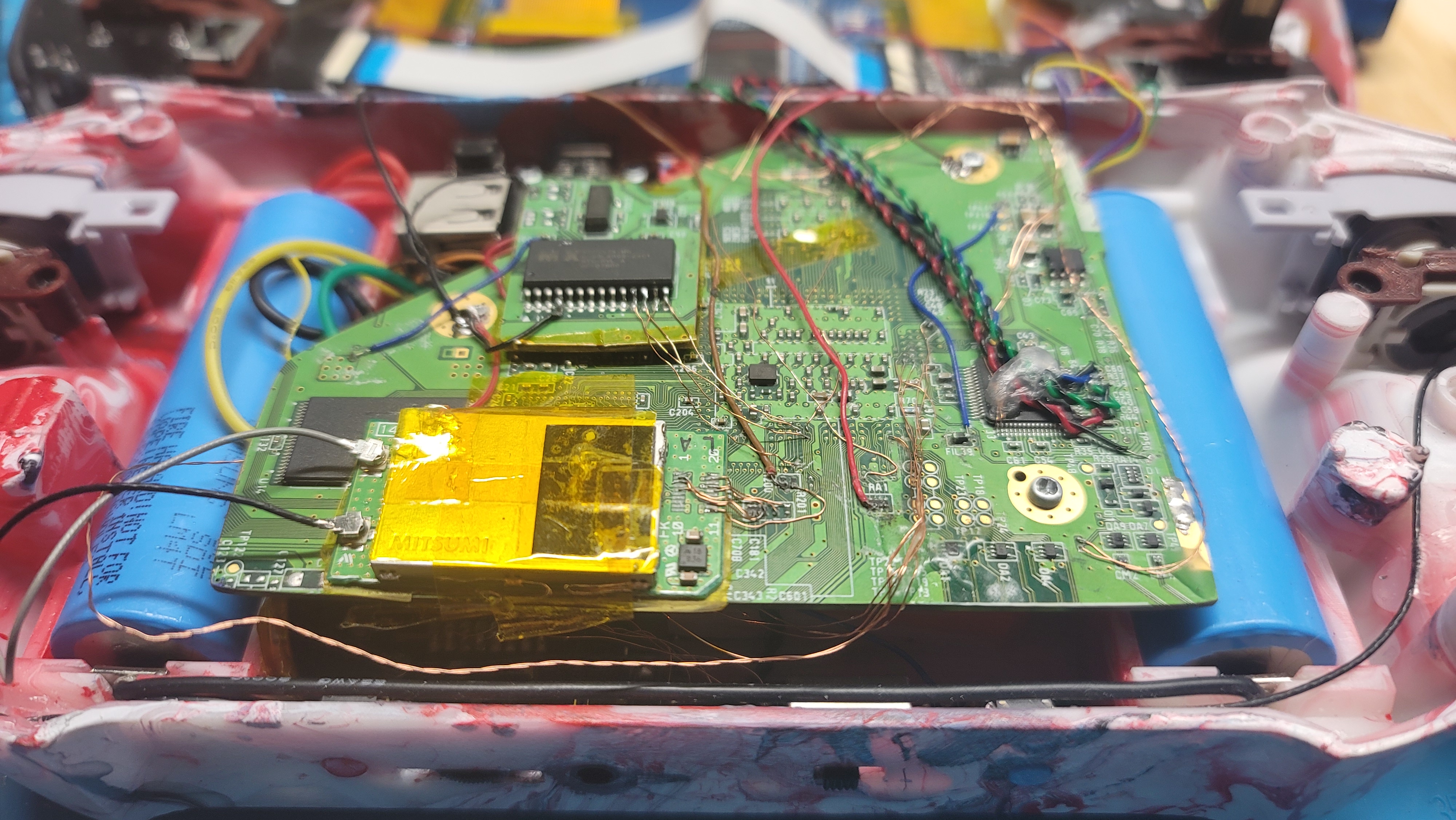

Well done! Do you have internal pics? Curious to see how you wired WiFi. I’m looking forward to playing some MK Wii with only portables!

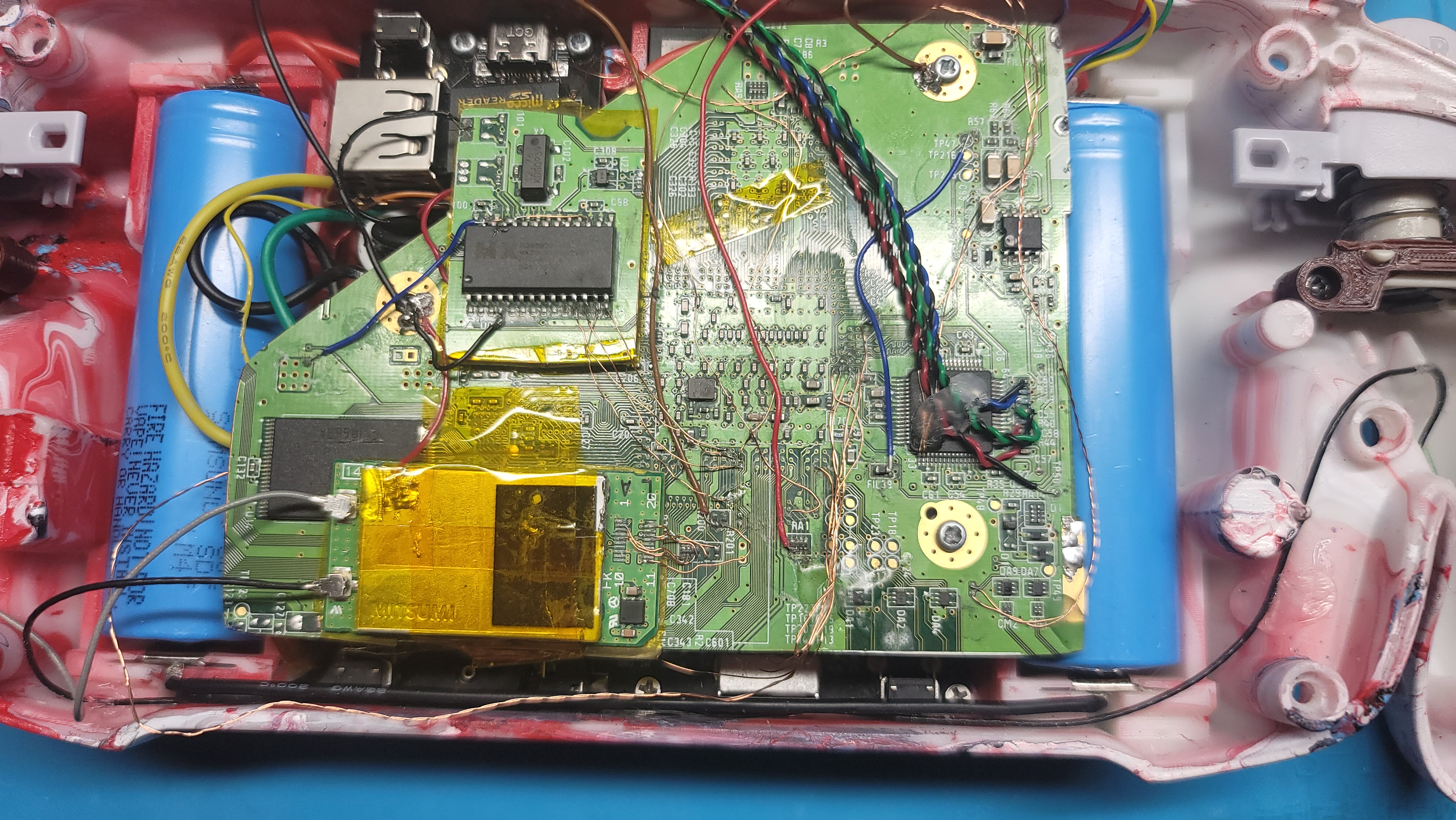

I got some right here. My wire management skills still need some work though. Like I said in the initial post, I still have some work to do on this, like wiring up the sda and scl lines after I repair the pms board, getting to mx chip to work (even though it's wired up correctly as far as I can tell, ) and installing Crazy Gadgets screen controller board.

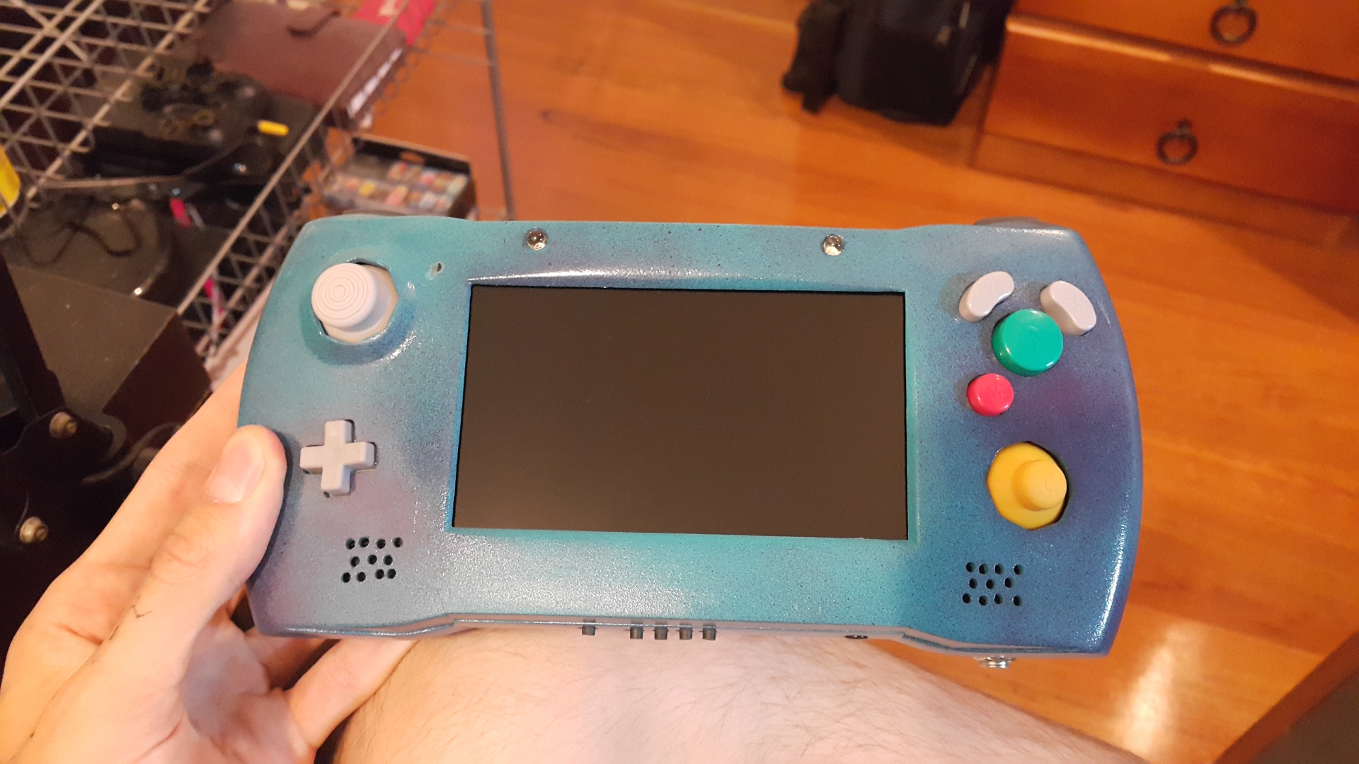

There are no diagrams or tutorials for it, no. I can't remember any worklogs showing it in any real detail either, but I can show you a portable I made once that used IR LEDs to show functionally how it can look.
As you can see, you really just have to have a hole for the LEDs to just crest the face of the case. I did end up having to recess the LEDs a little bit further into the case than is shown in this photo, but it worked just fine. I didn't use diffused LEDs tho, and I recommend that you do use diffused ones as they interfere with each other less than undiffused diodes. I will be using diffused ones when I finish rejigging this design. You need at least 10cm of space between the LEDs for the Wiimote to see them, with a larger distance being preferable if it's possible to have. You can also use two or three LEDs together in series on each side of the case to improve the detection range. A single LED on each side won't give much range and can be unreliable outside of point blank range.
The only technical thing you need to do for the LEDs is to find the correct current limiting resistor. Most LEDs can't just be powered and left to glow, they need a resistor to limit current flow or they'll burn out. There are several online calculators that will help you find the correct resistance value needed, for which you'll need the Supply Voltage (most people use 3.3v) as well as the part specific "Forward Voltage" and "IMAX" which can be found either in the datasheet for the LED or in the listing description if bought from a site like Adafruit. Infrared light is invisible to the human eye but can be seen by digital cameras, so you can use your phone to check that the LEDs are working and are equally bright.
