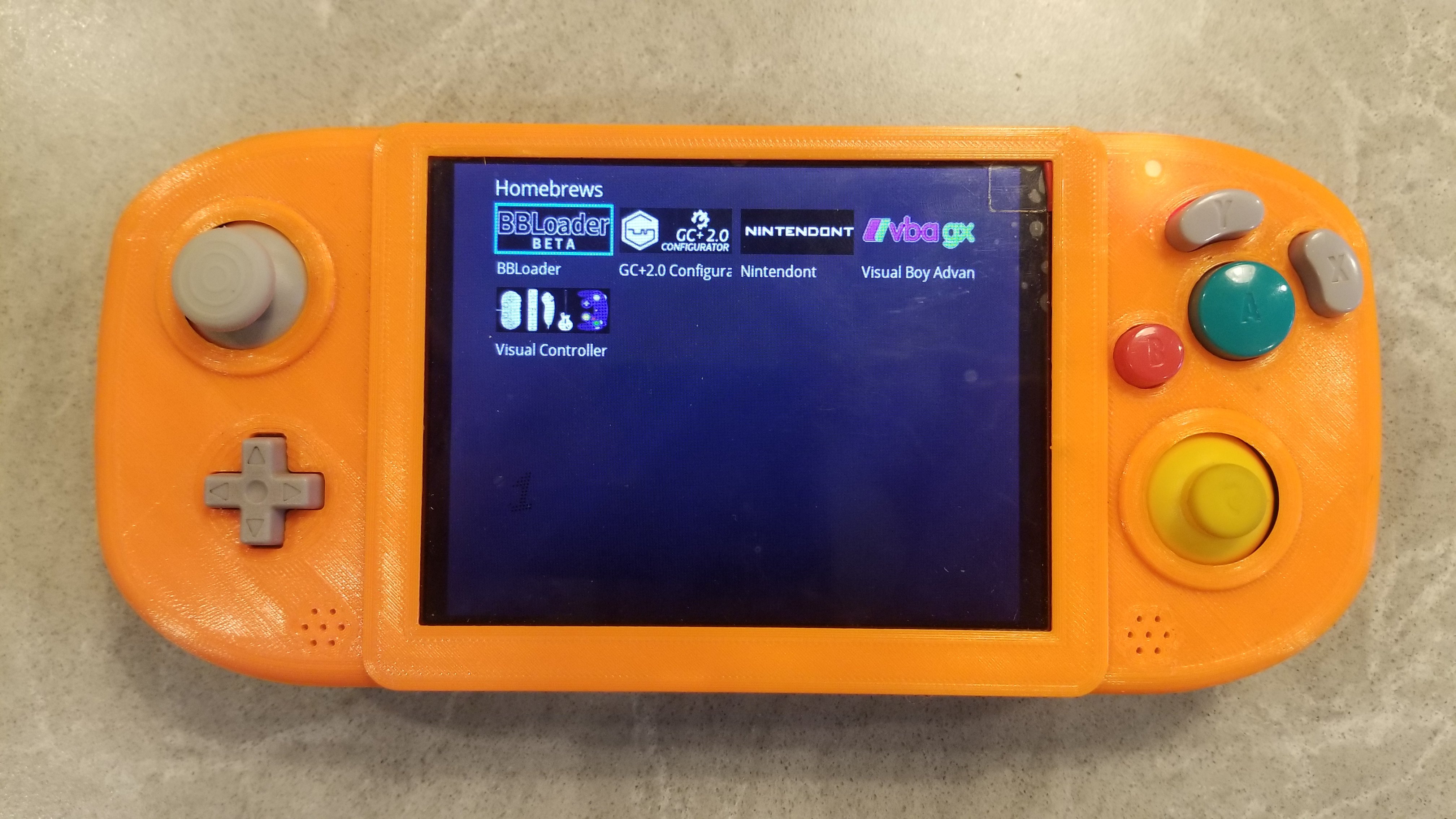

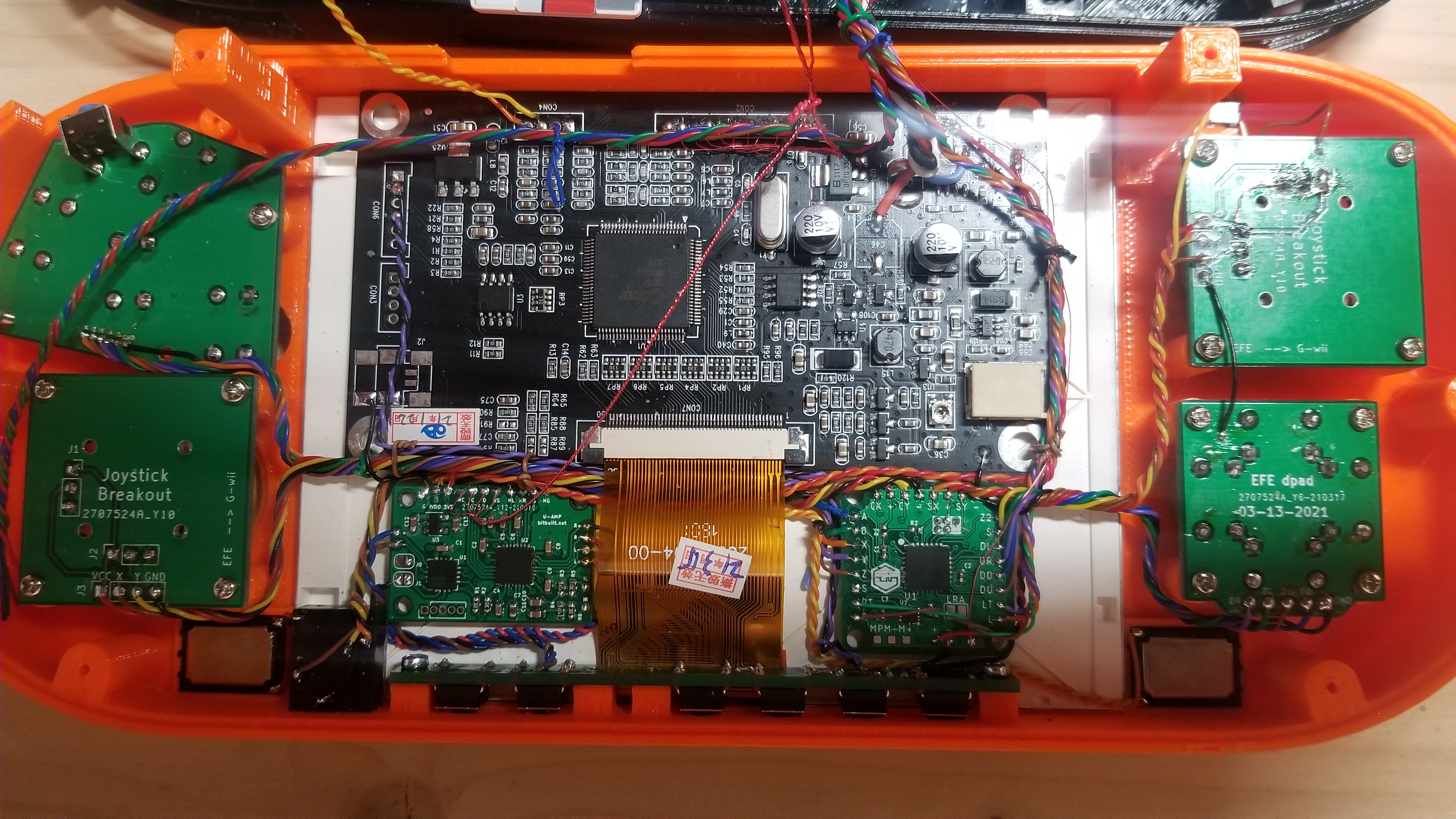

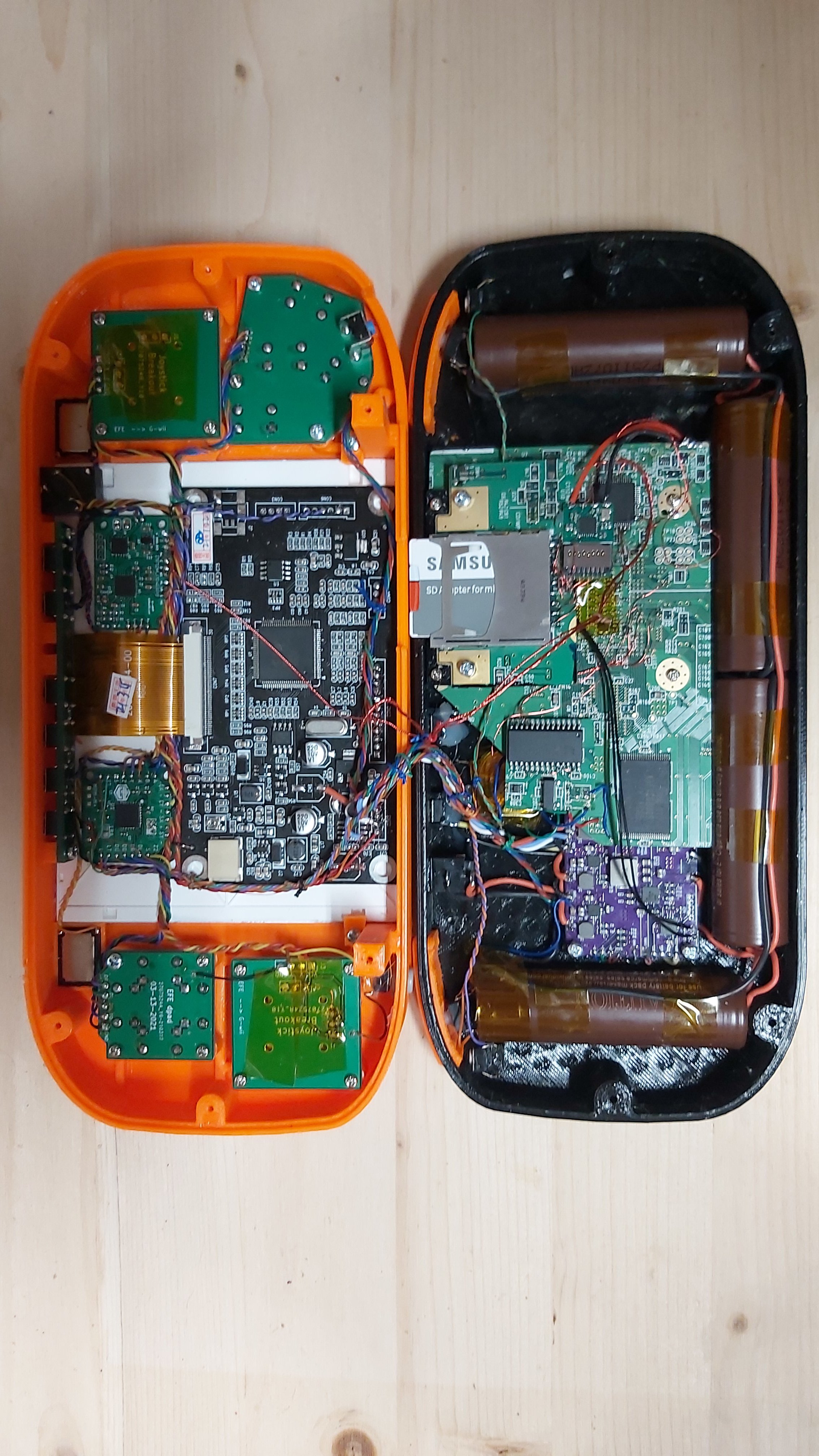

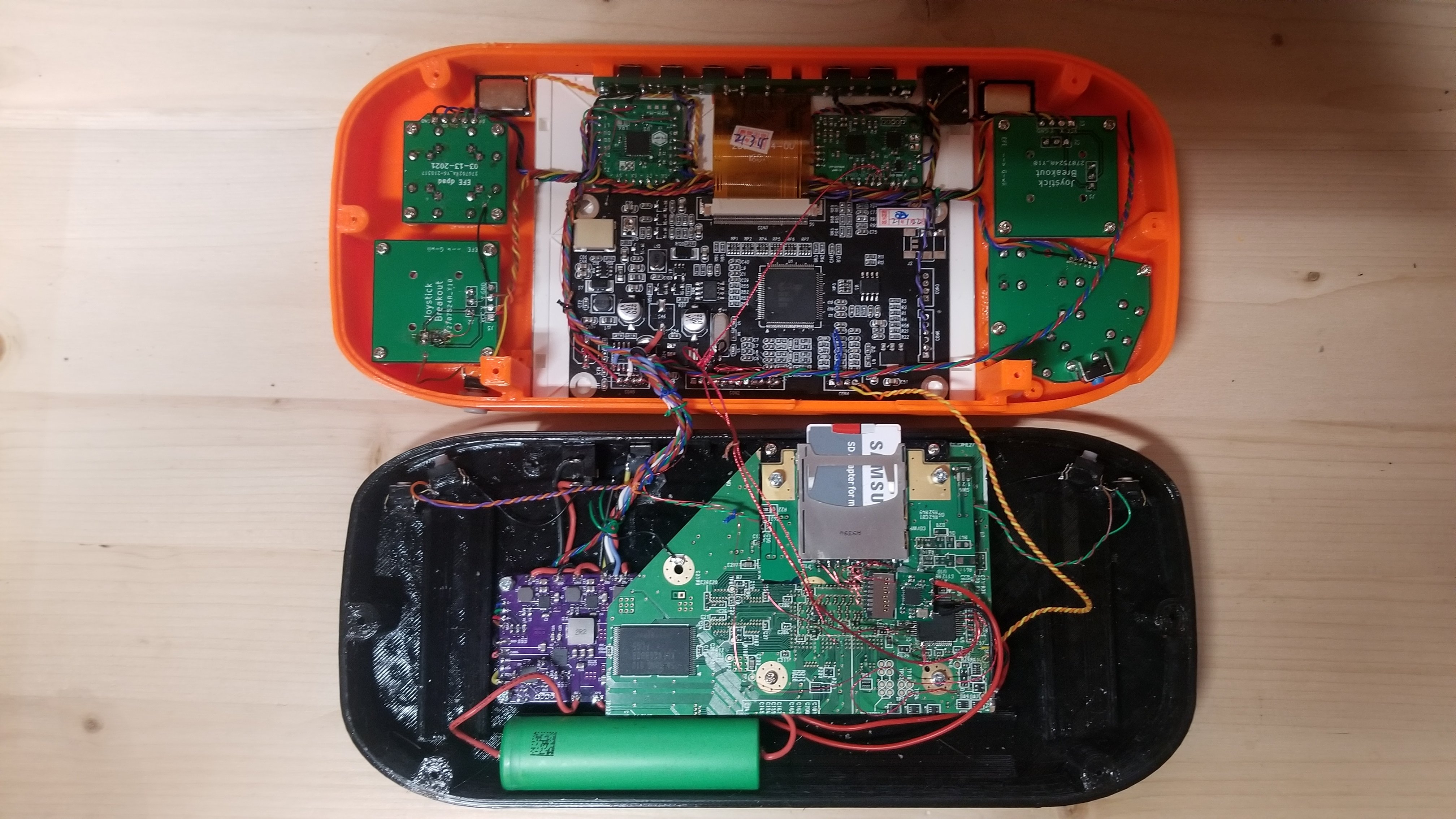

Hi there I decided I would build a Gwii for myself to gain experience
Then build one for my friend
Then build a few more to sell with the experience gained so I could be proud of the workmanship and time I put into them.
Behold an Orange and Black G_SD_ wii
Fully printed in PETG, so it doesn't melt in your car
Gman's RVL PMS
Hand assembled
Thermal protection
battery and mode indicator led
Gman's U amp
Digital audio
Speakers and headphone jack
Aurelio's GC+ 2.0
and GC controller breakouts
tidy up the wiring
really sturdy joystick mounts
BT relocated fully working
MX relocated and fully working
Dual tact mod for LR
Squishy tacts for ABXY and Dpad

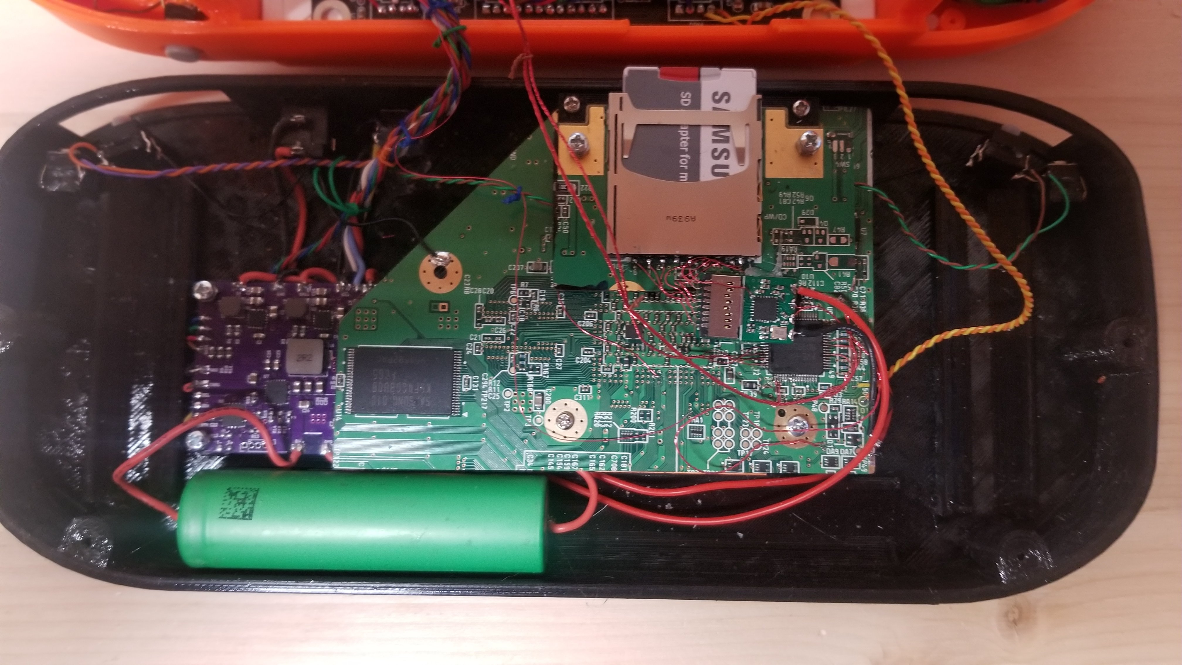

4x lg 3Ah 18650s for 4+ hour runtime
I has BBloader 1.3 running with no isses
Plays Wii
GameCube
N64
SNES
Gameboy
and many more
Uses the Stock Wii sd card slot to make it pretty and still have it accessible

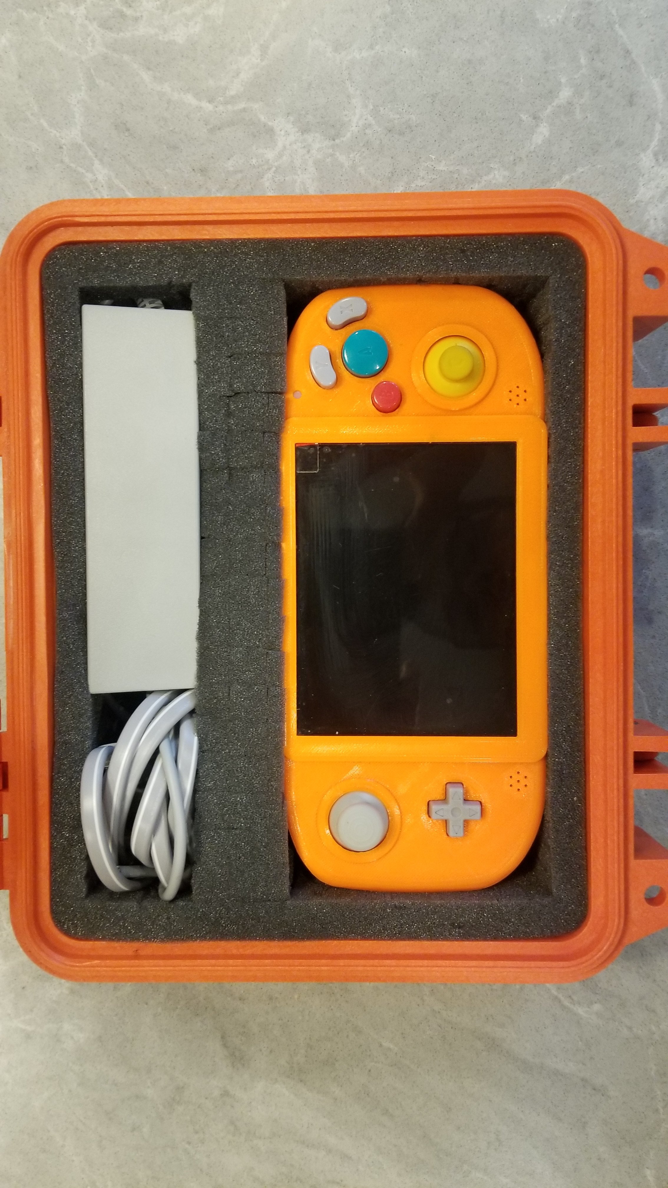

Comes With
G_wii
128GB sd card
Pelican Case
Wii power Brick for Charging
This wii is SOLD
Any Questions feel free to ask!
