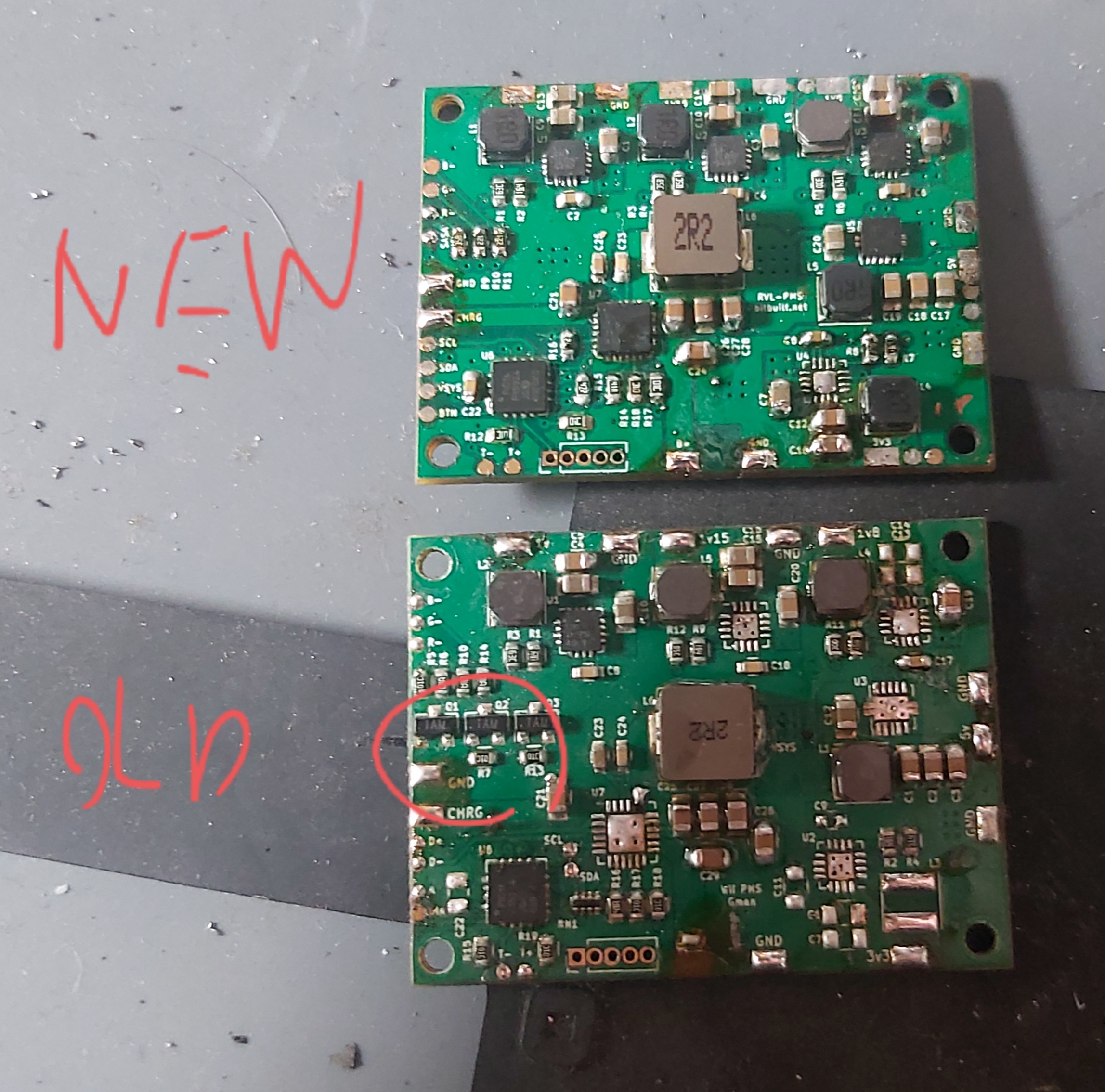

I've been trying make my own version of Gmans old Rvl-Pms and noticed some parts that aren't in the BOM (the ones on the left with 3 connections to be specific) and was wondering what parts they were so I can look them up.

I believe you are looking at the older version of the board. Make sure you order the updated version. The new BOM reflects the parts on the new board.

The GitHub matches the pms1 what left side components are you talking about, one side has the 5v outputs with 3.3v and such and the other has the pic with led resistors and connections to a pd board that wasn't open-source released.

those are the rgb led neg transistors iirc those were used in an early revision of the pms1 but eliminated in later pms1 revisions
ps pictures are an excellent resource :)
