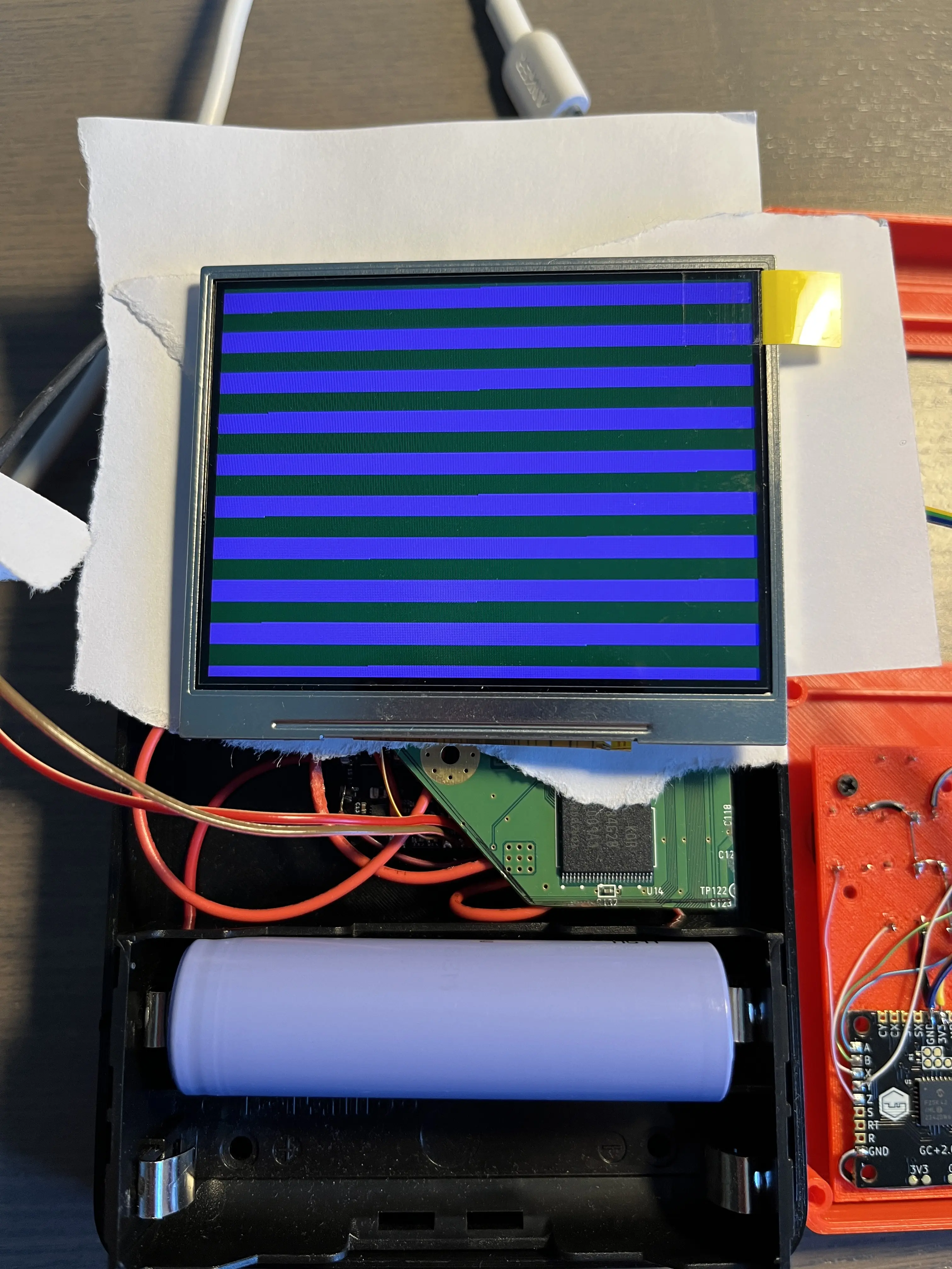

So I’ve been working on my build today and my screen randomly started acting up. It’s a 3.5” RVL-DD. All of a sudden whenever I boot, the text “crawls” up in a way it shouldn’t and the screen freezes on these horizontal bars. Eventually the system shuts itself down after about a minute.
Prior to the issue you see on boot in the video, the screen was freezing on most boots as soon as RVLoader loaded.
UPDATE: I tried using the button combo to enter into safeboot, but it didn’t work on either a real GC controller nor a GC+. So I tried wiping the SD card to force it to do something else. That fixed the problem, and then I was able to get into priiloader and the homebrew channel.
I just dragged and dropped my clean RVLoader files to the card and the problem went away. So I guess my RVLoader install got corrupted somehow?
