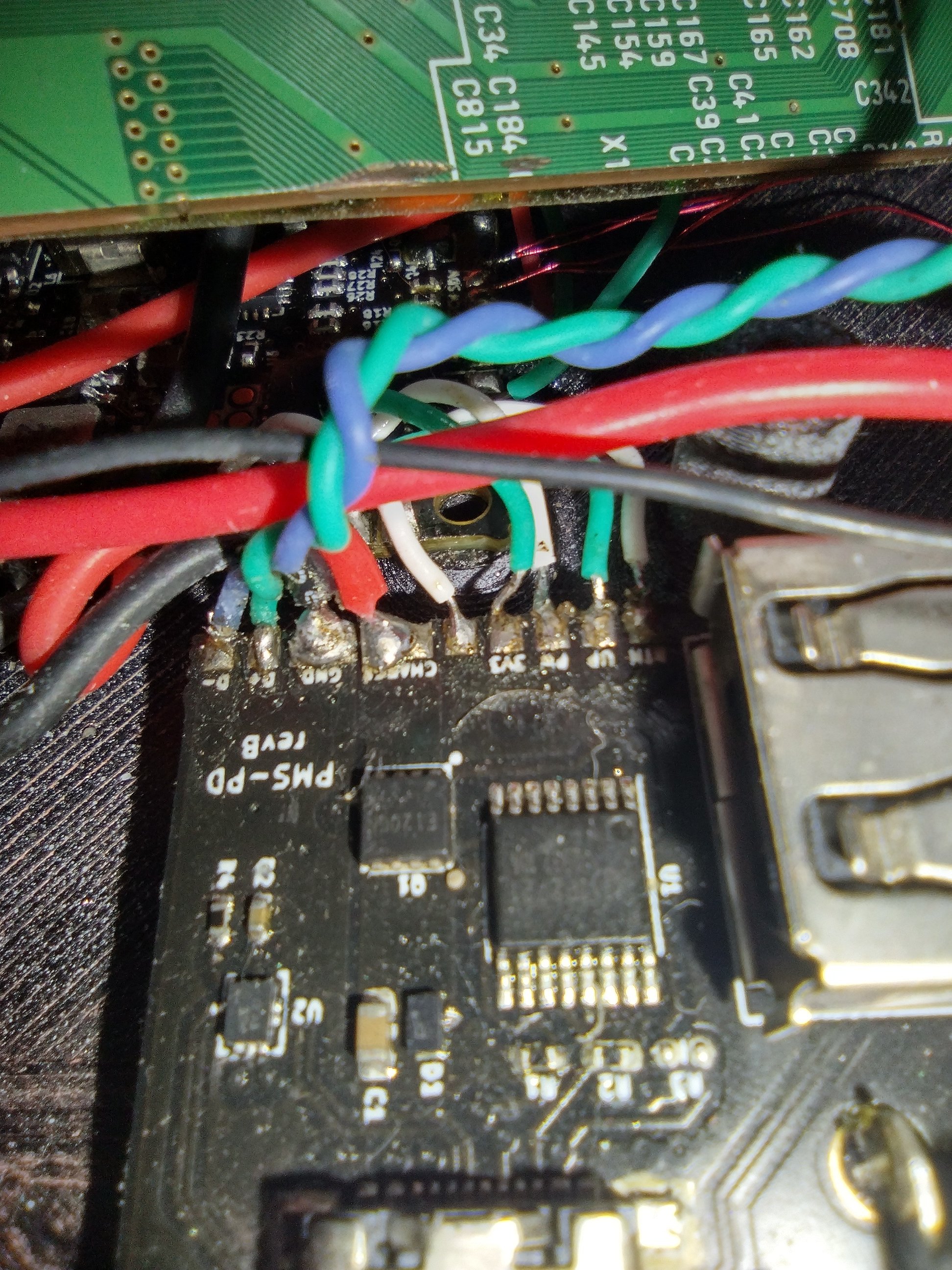

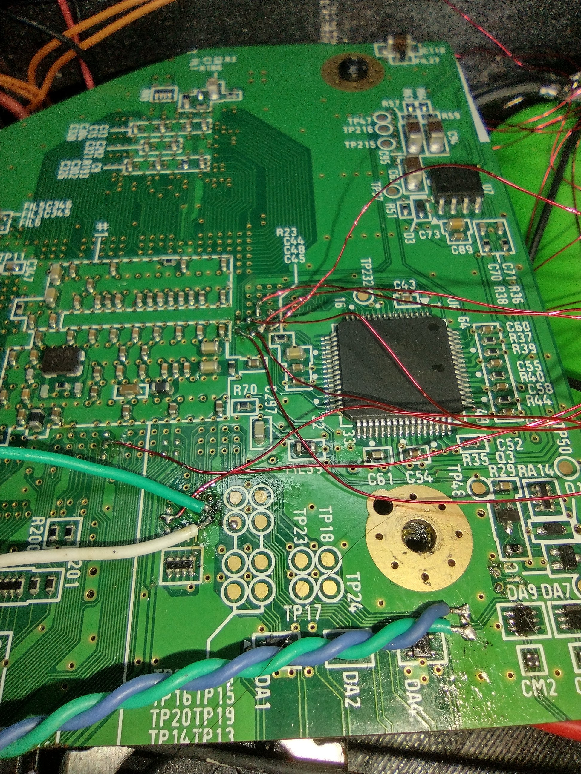

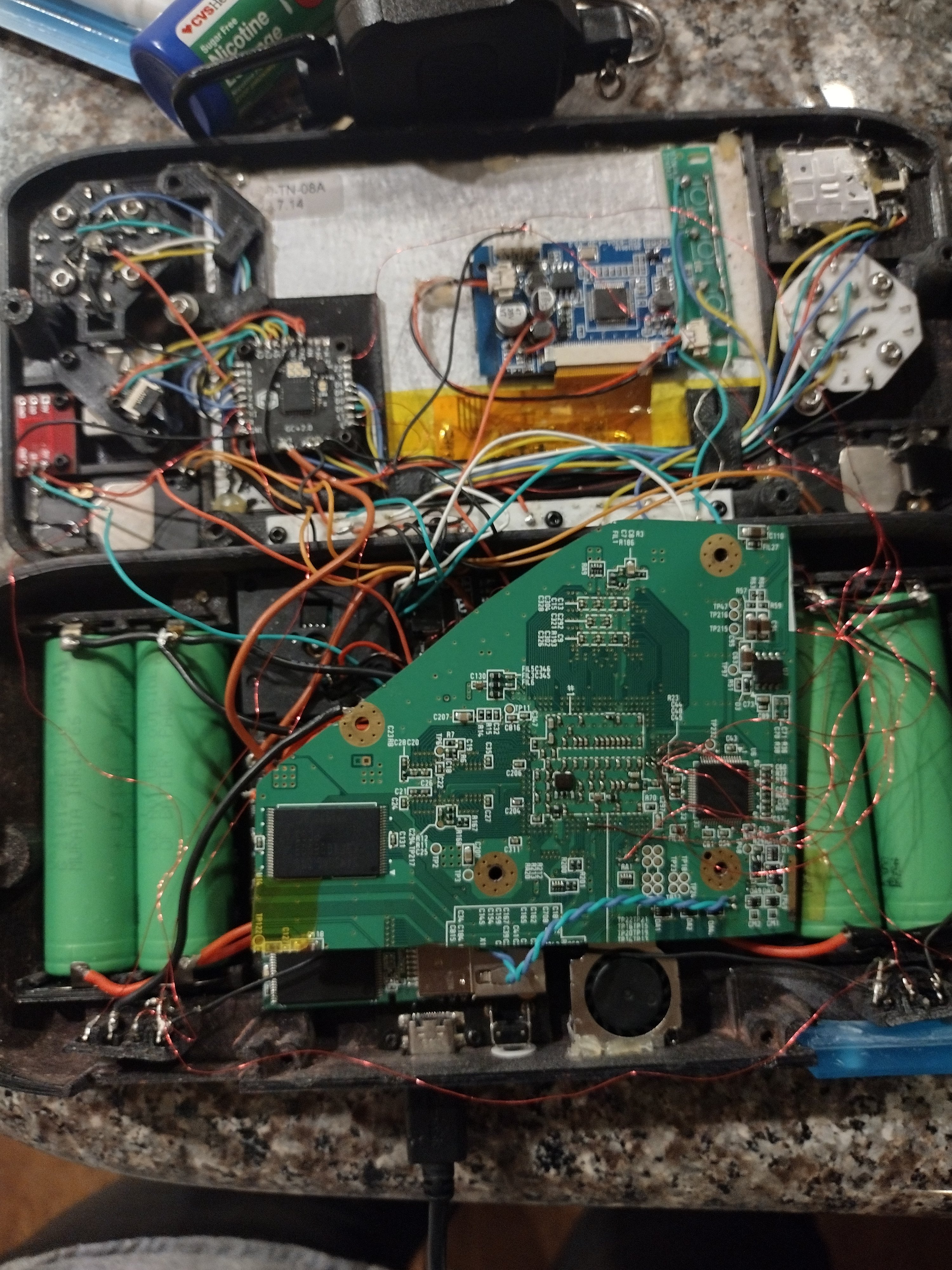

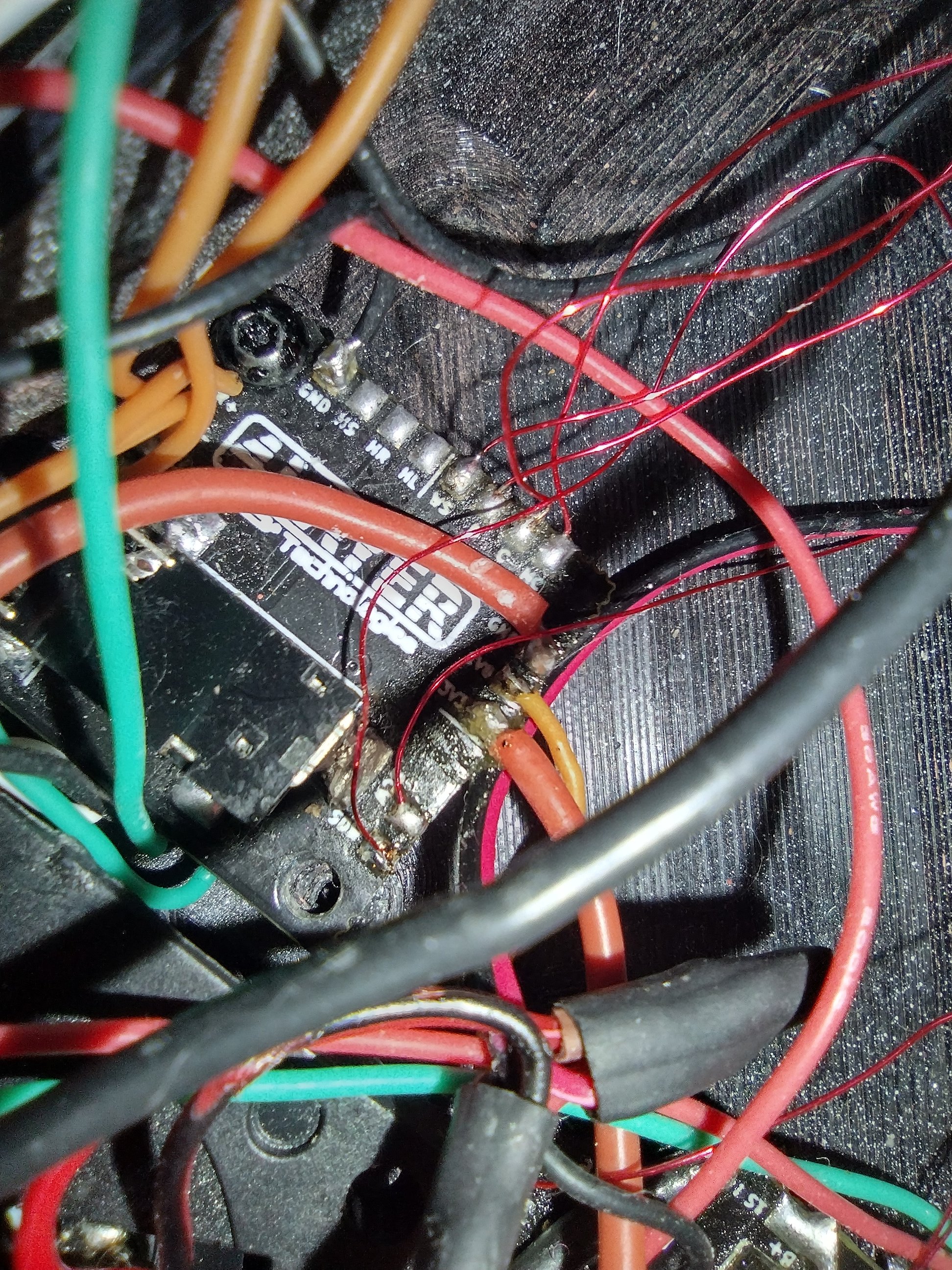

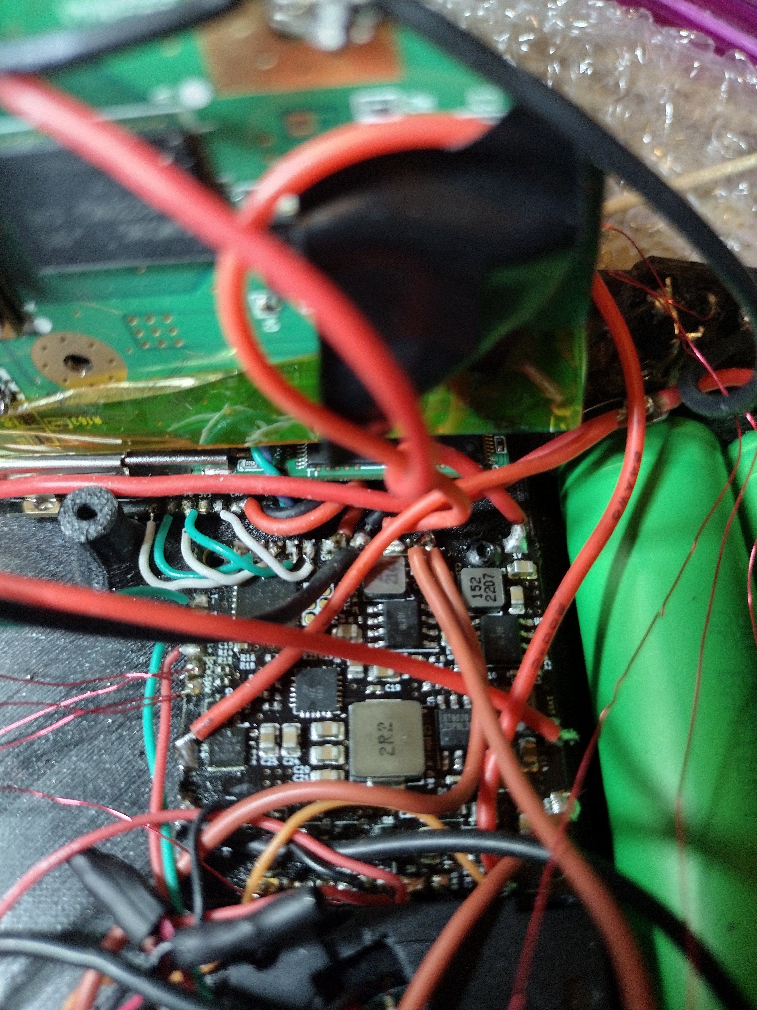

So I went ahead and re-did my usb data wires, and it seems to be functioning a lot better, but I still need to do extensive testing. It has frozen a few times so I'll probably switch over to magnet wire for data lines and see if that fixes it. I'm still adding pictures Incase anyone sees something else that could cause issues or that I should address. (Pictures are from after I redid the usb data wires)
Thank you all for the suggestions/advice and saving me from starting over from scratch. Again, please let me know if you see any other issues I should address. I'll try to give another update before long

Yeah I'd definitely swap out that data line pair for a tightly twisted magnet wire pairs. You might also see some freezes or hang ups in the SW based on what USB drive you're using.
There's a list in the RVLoader FAQ page of supported drives.

Most things seems to be in working order now. I had to redo my data lines a few times, and I swapped USB to the approved SanDisk. I think the data lines were causing the bulk of my issues.
I still can't access files when I plug my portable into my computer, and it seems that my batteries aren't getting a full charge , but I can live with these issues.
