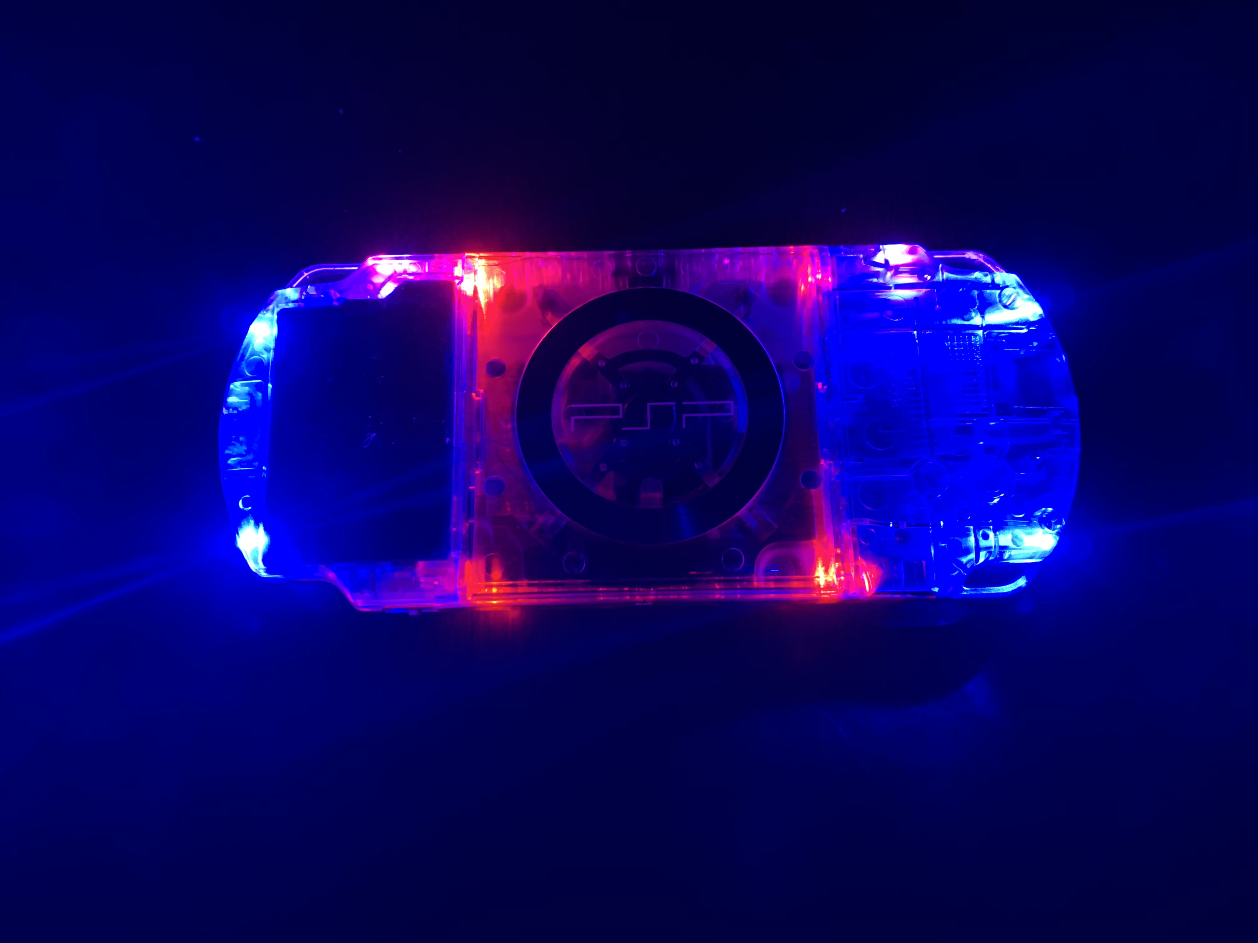

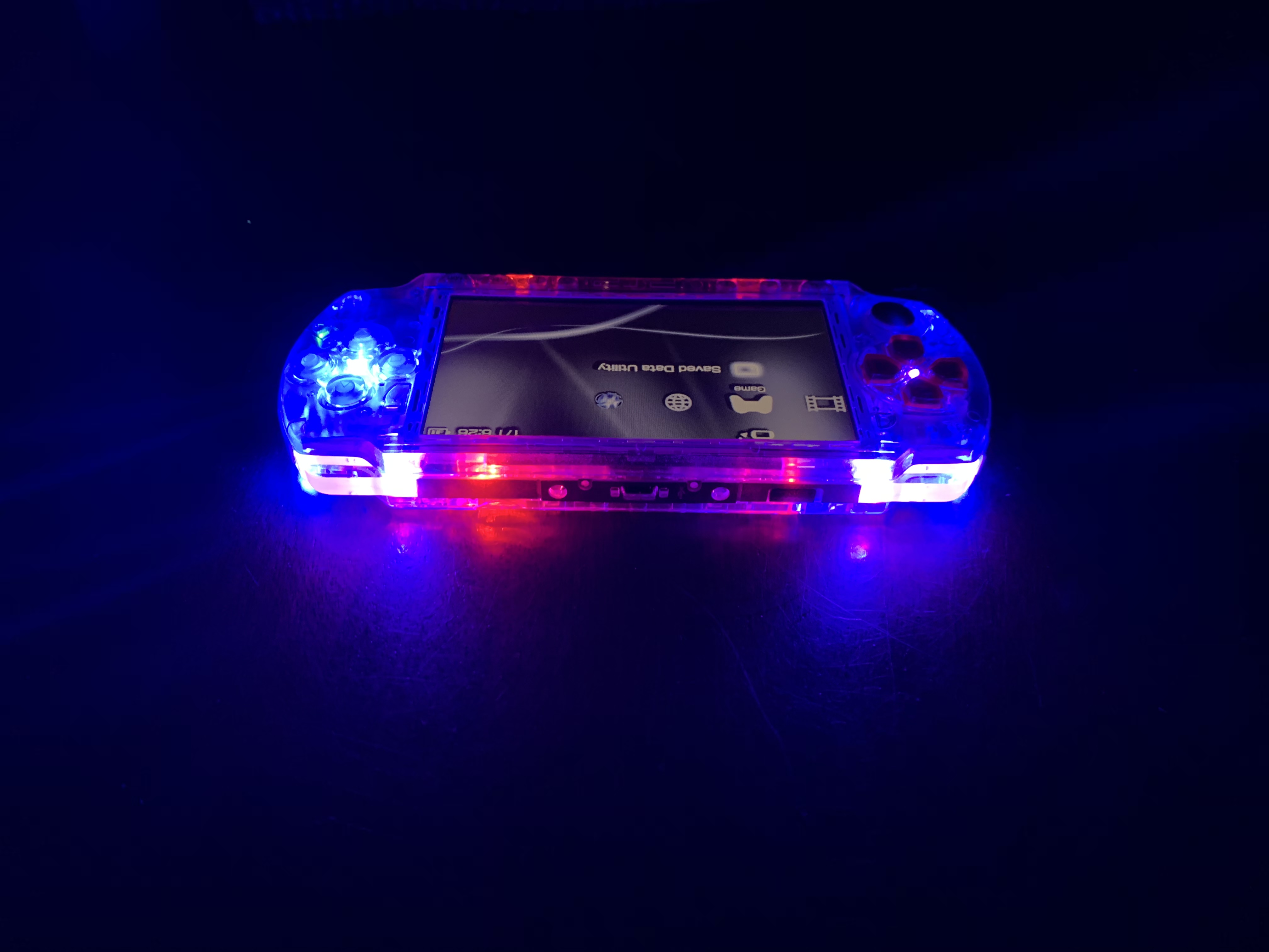

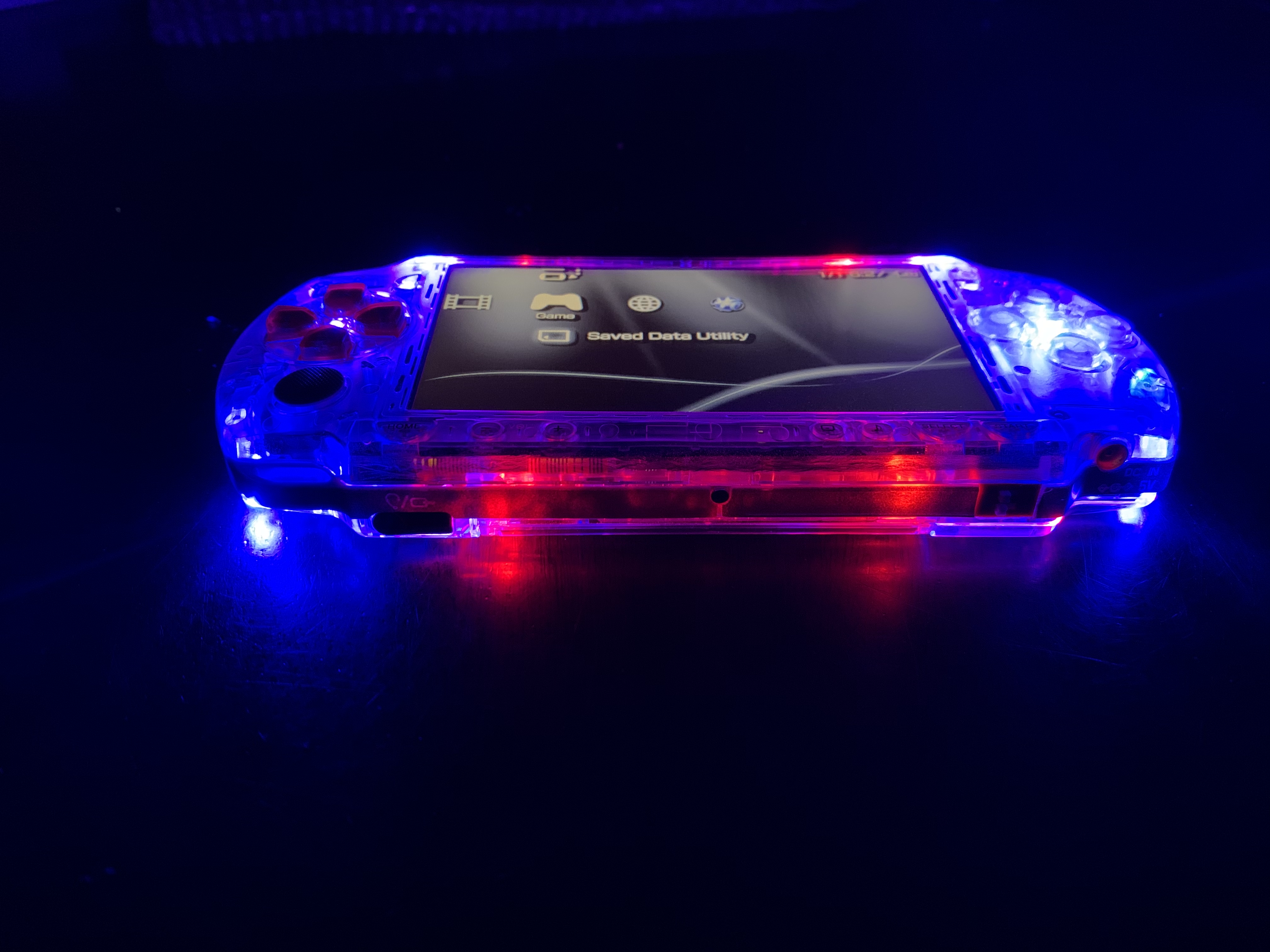

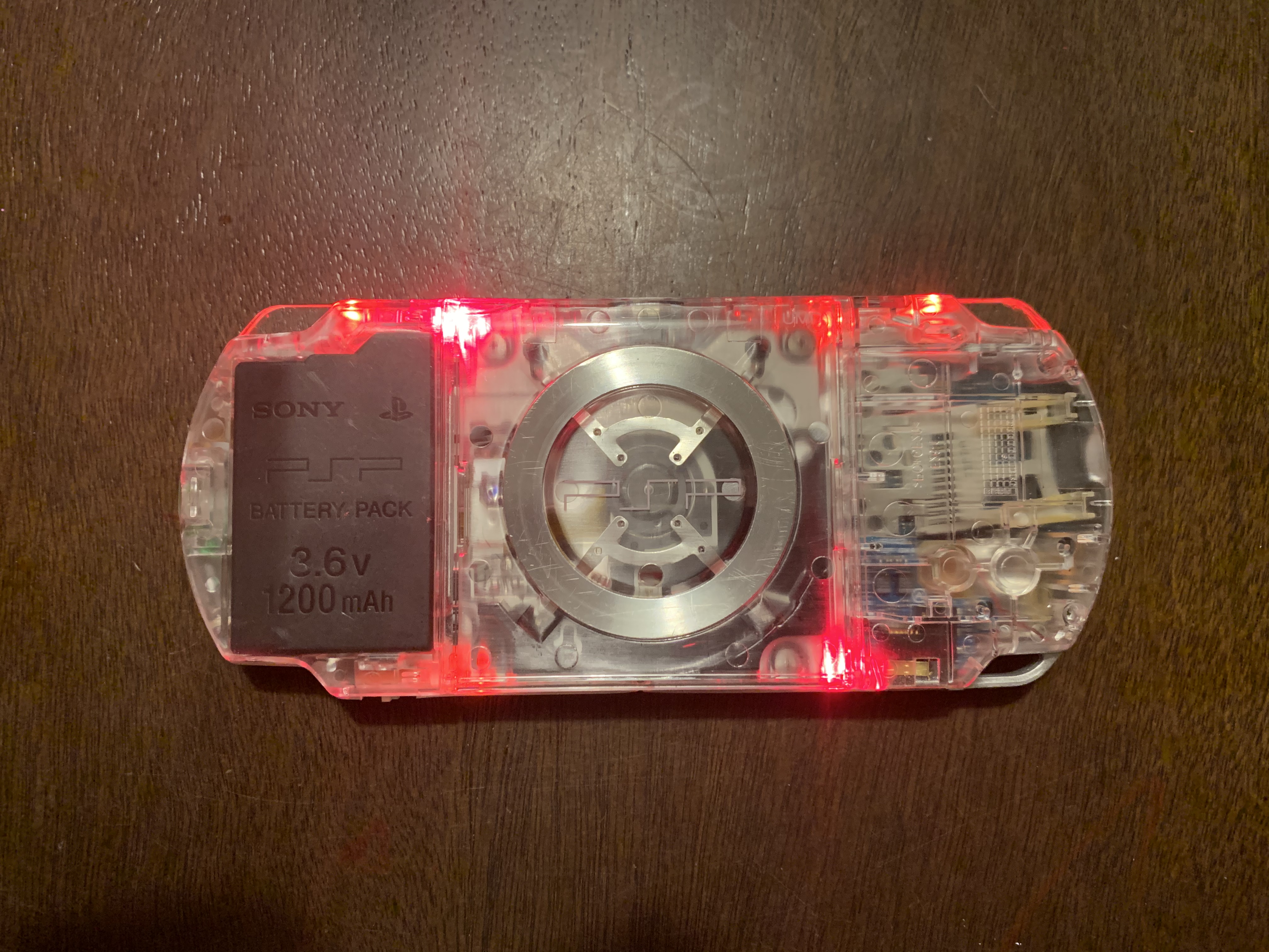

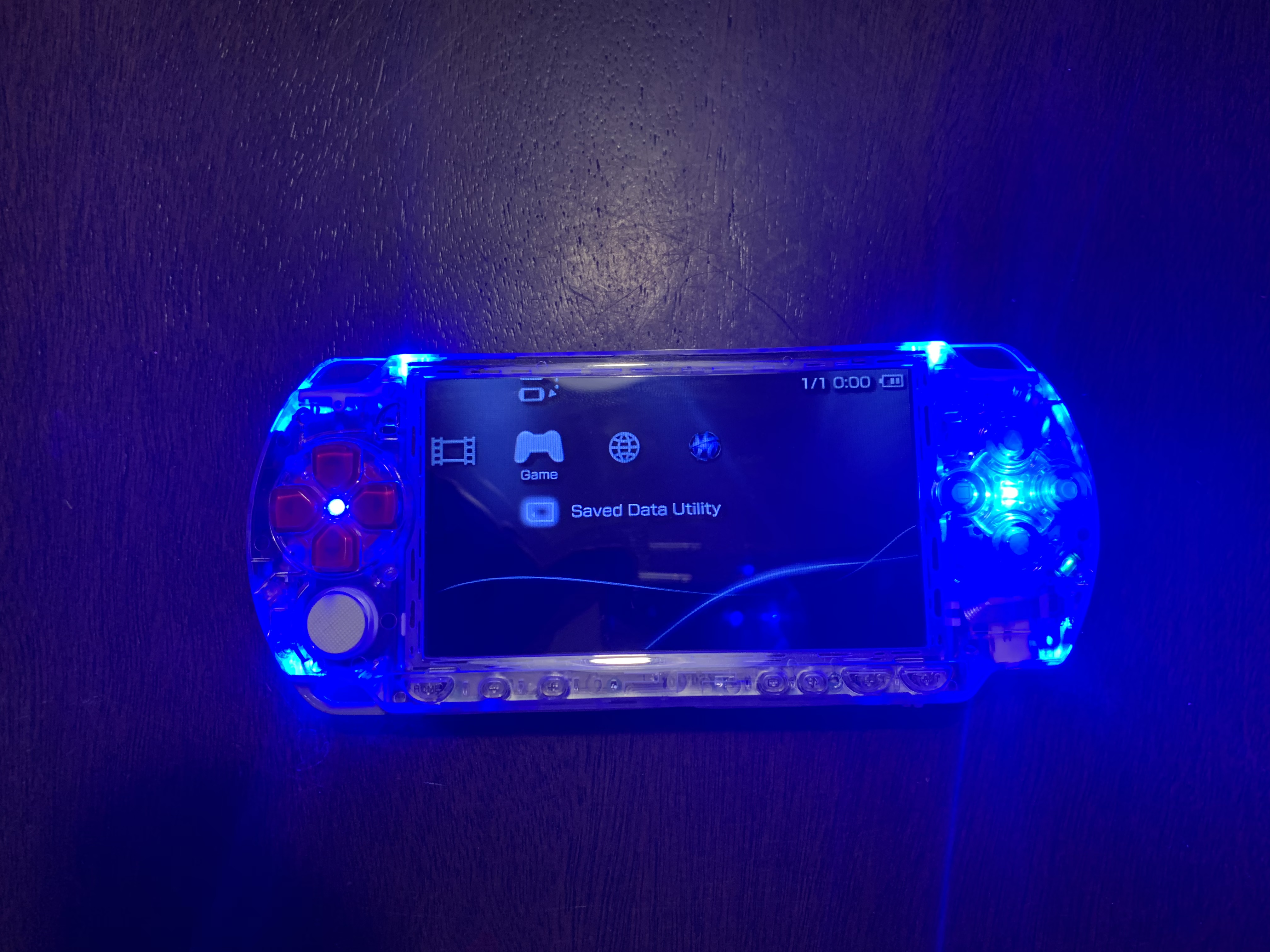

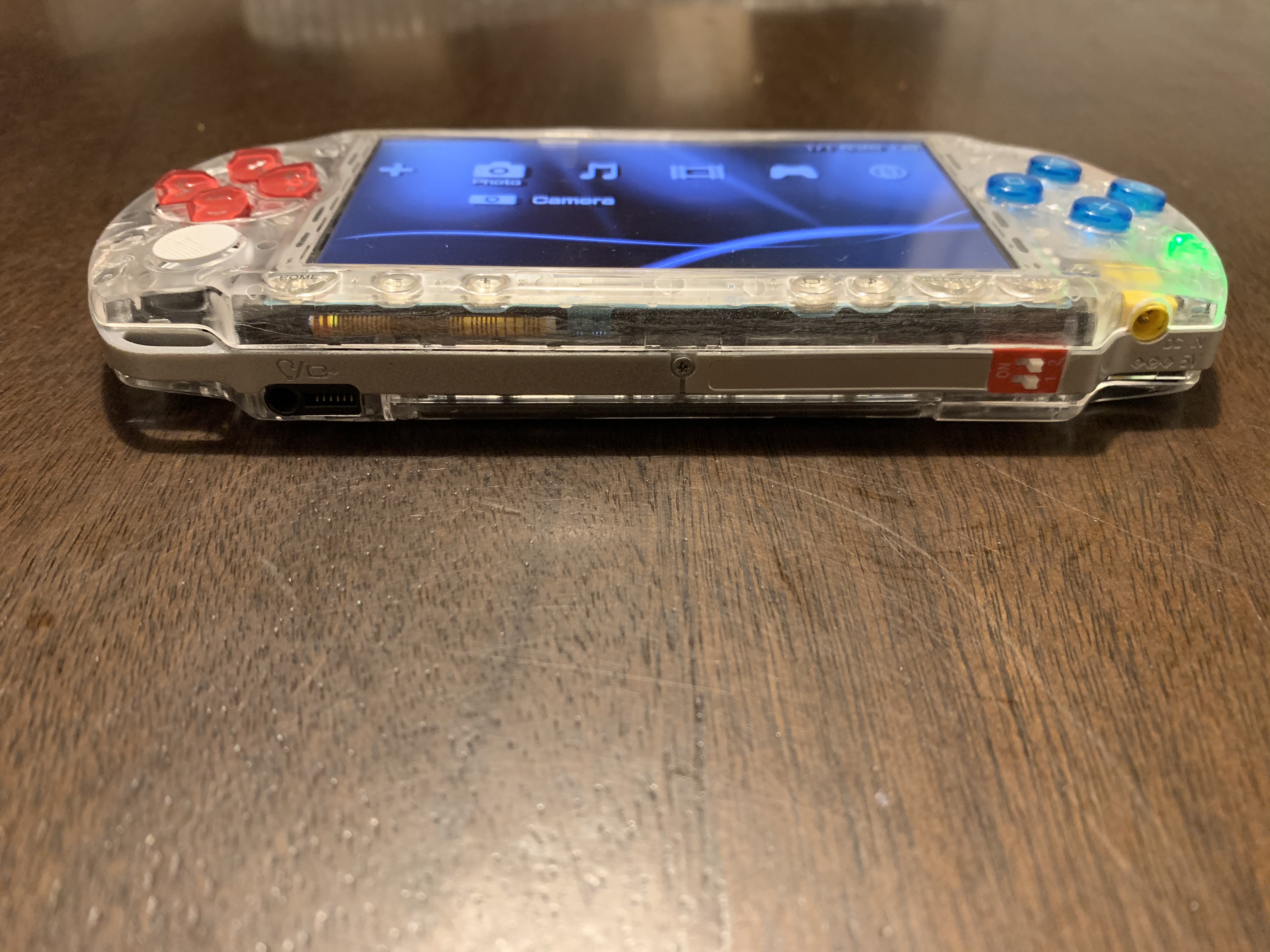

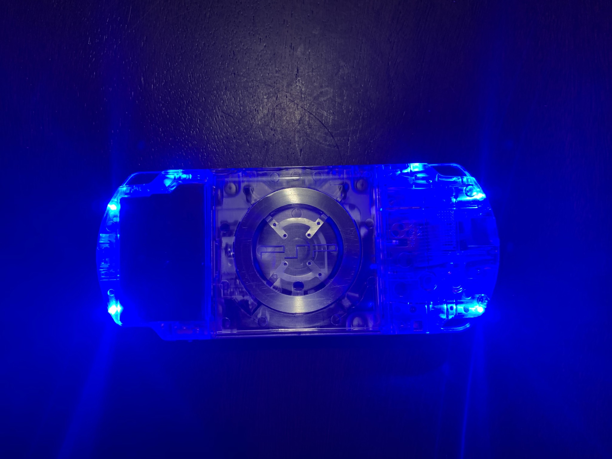

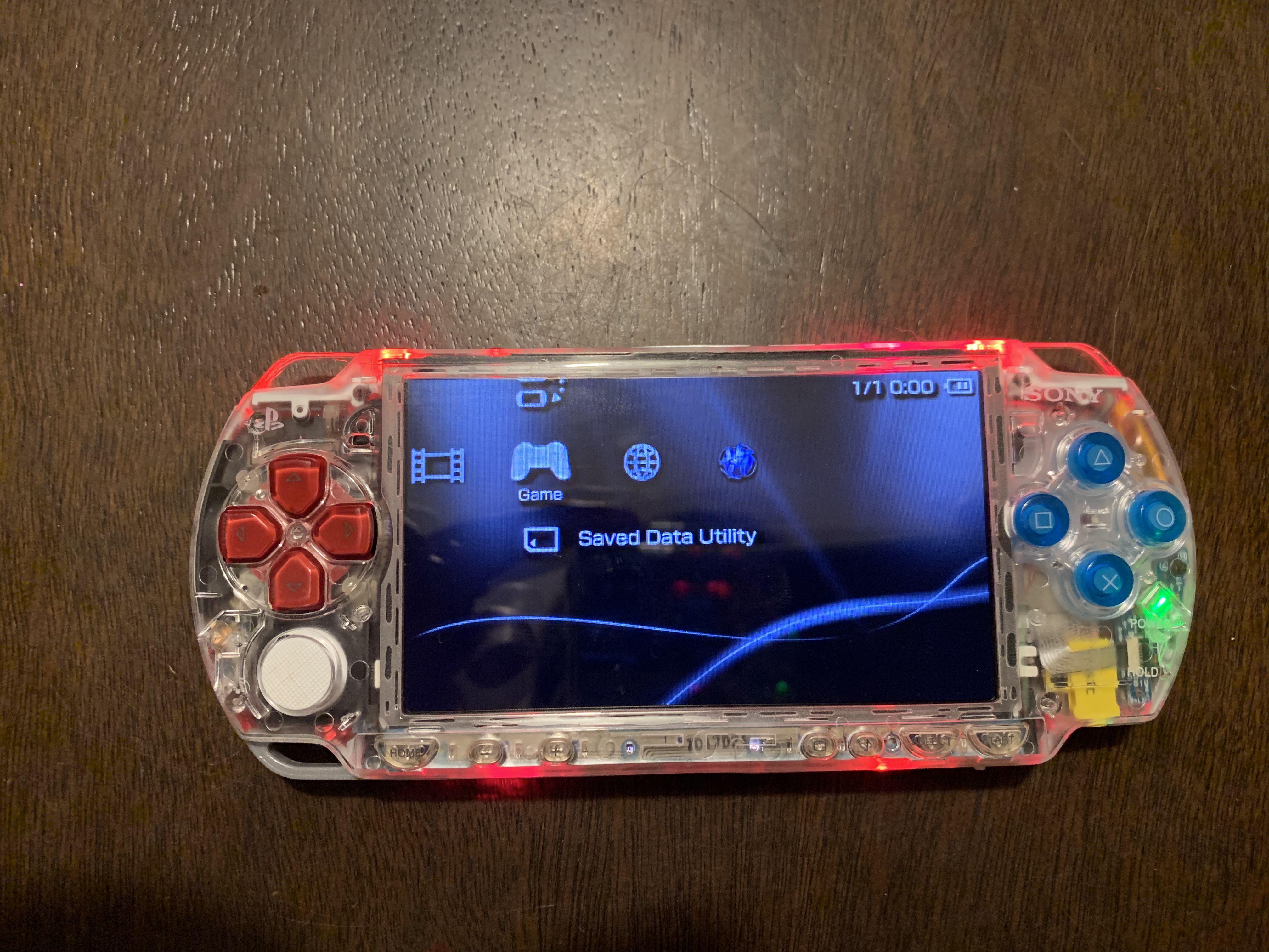

Just finish this one

Ciao, potrei sapere esattamente dove colleghi le cose? Mi piacerebbe farlo per il mio psp .. Mi piacerebbe fare una cosa del genere
Translate to English next time, I connect leds to speaker using a transistor
[QUOTE = "modio, post: 37952, membro: 1958"] La prossima volta traduci in inglese, collego i led all'altoparlante usando un transistor [/ QUOTE]
Forgive me..
Forgive me..
I use a 2n2222 transistor wire it like this
Base- positive side of speaker
Collector- negative side of speaker
Emitter- negative side of led
The 3.6v-5v- to positive side of led, use resistor if using red leds
Wow, that looks amazing! is it possible to have the LEDS continuously change? ( like what you see on those gaming PCs)
