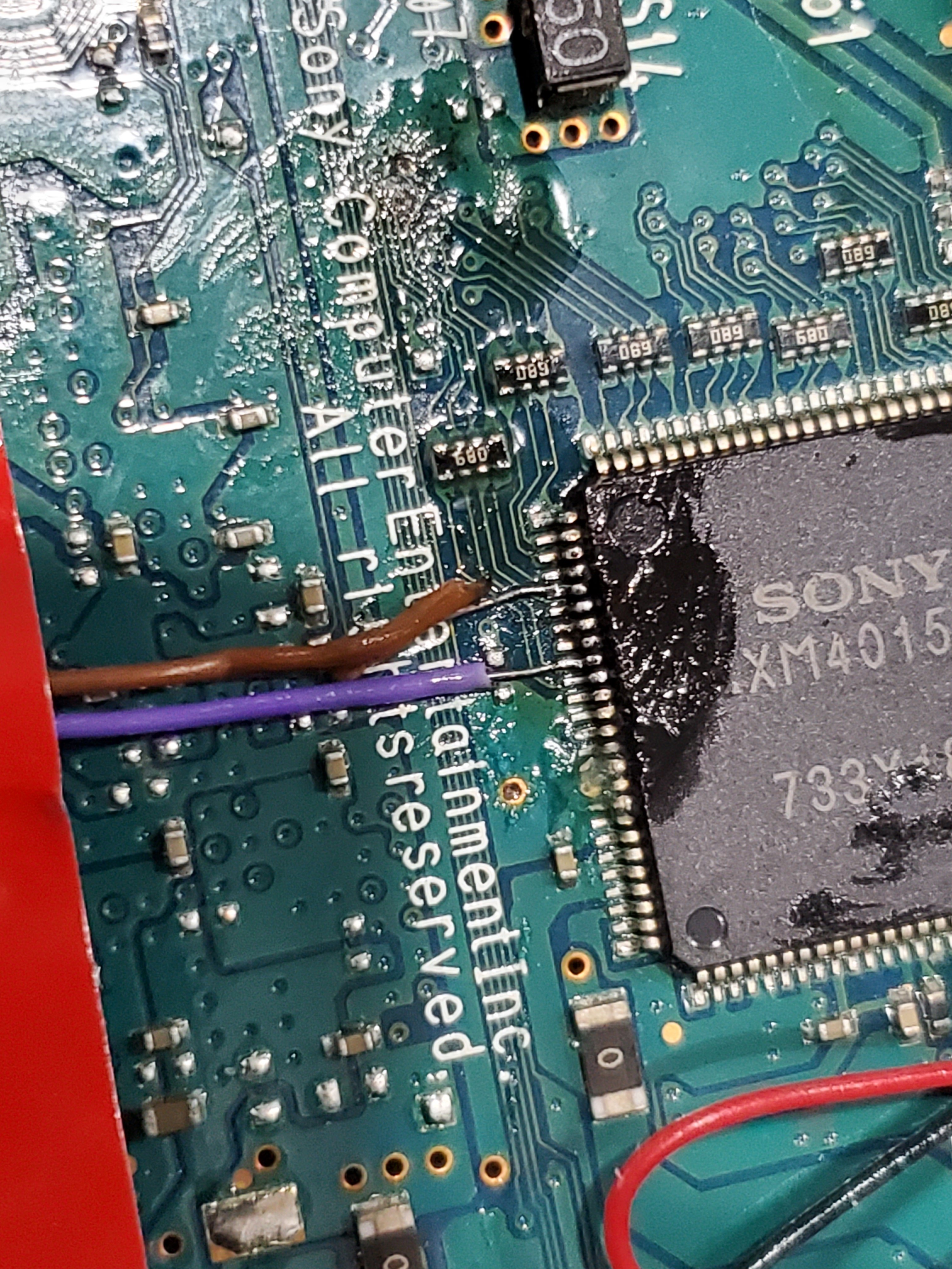

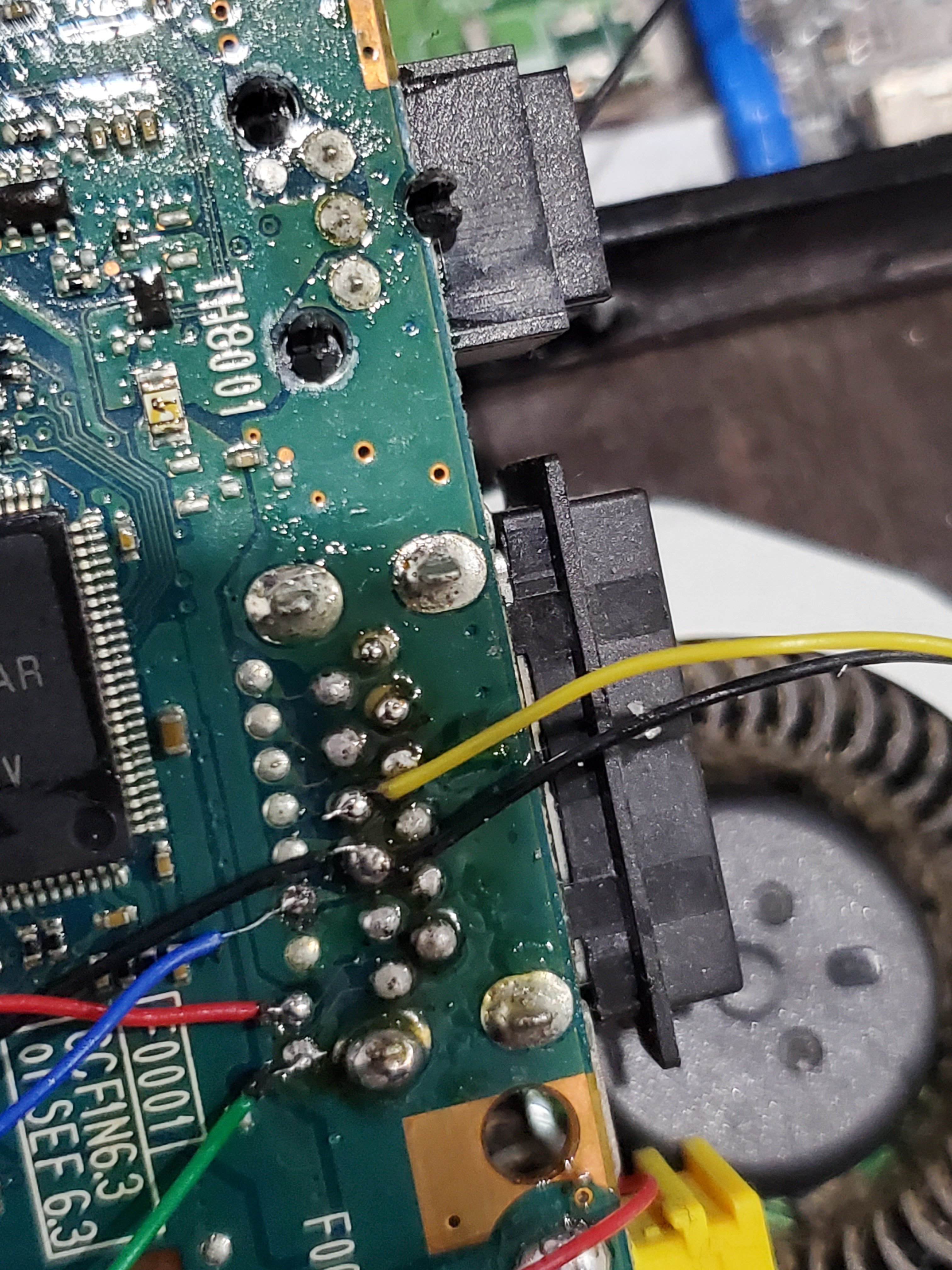

hey hate to bother but i wired up the vga pinouts perfect as shown in the tut and it still wont show vga only composite. ps2 slim 79001. any help will be appreciated
here are the pics

The VGA is interlaced signal which will only work on monitors that support this. Make sure of this.
thanks and yes it has to support that cuz its the same monitor i use my trim will on also and its connected with vga. did my soldering to the h n v sync pins are correct in the pics i posted. could it be the ps2. cuz i did try to use a ps2 to hdmi adapter n that didnt work either but that same adapter works onnmy 75001 ps2 slim. could it be that this system is defect and will only display composite. thanks again for responding gman. love the work u have done n see all YouTube vids u post.
and the screen is a b101ew05 and the lcd controller board is qpcb800099-v9. thanks again
I've never came across a PS2 where composite worked, but not component.
I am not positive that screen will work with interlaced signal. The Wii VGA can do progressive, it is not the same signal as the PS2. Make sure the H/V wires are as short as you can make them. They should not be more than a few inches.

i seen it popped up in vga for like 2 sec when i used a different pcb board for the same screen im using. so i do know its wired correctly n the system set to rgb. if that didnt happened i would think that its a display thing. might just rock with composite for now
