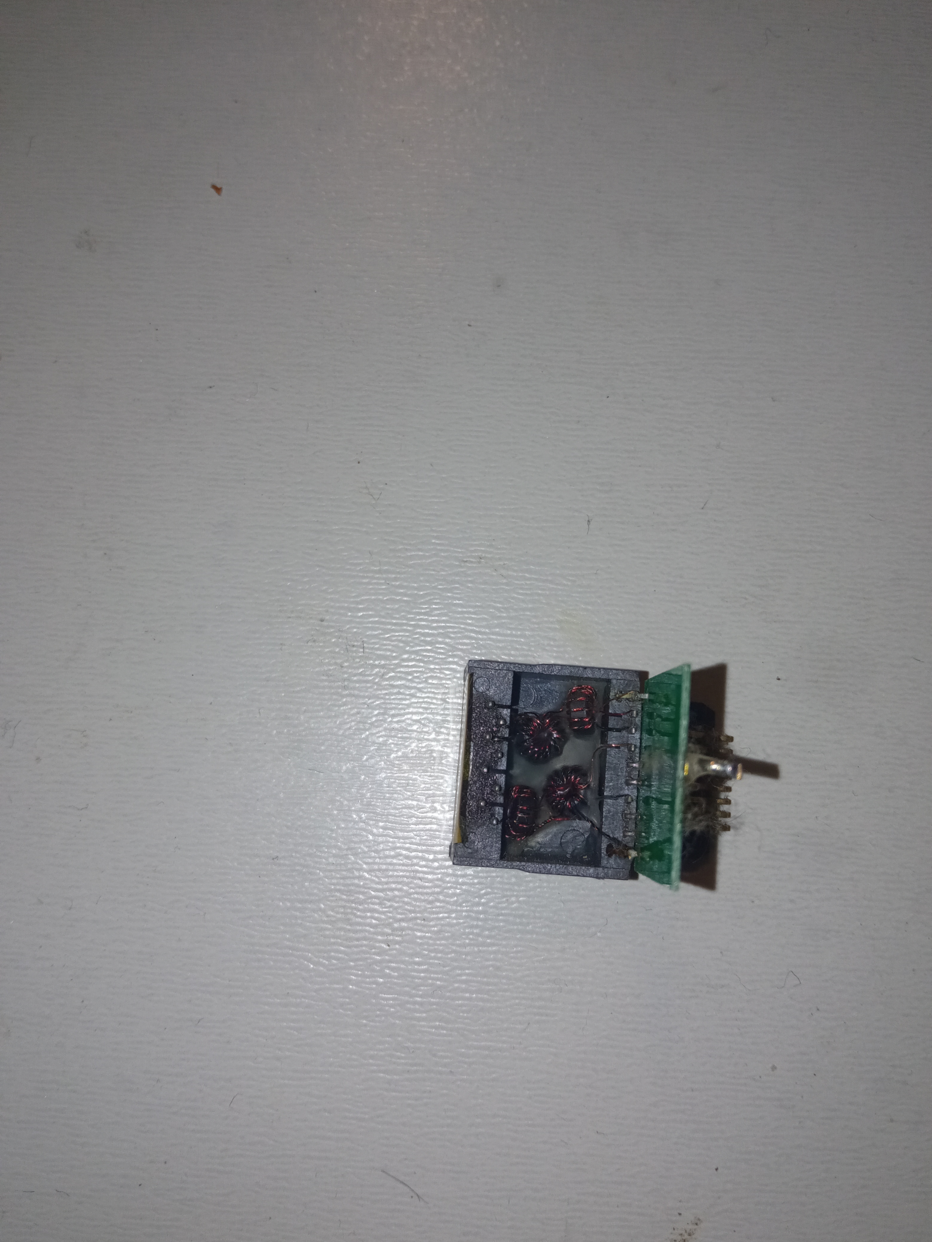

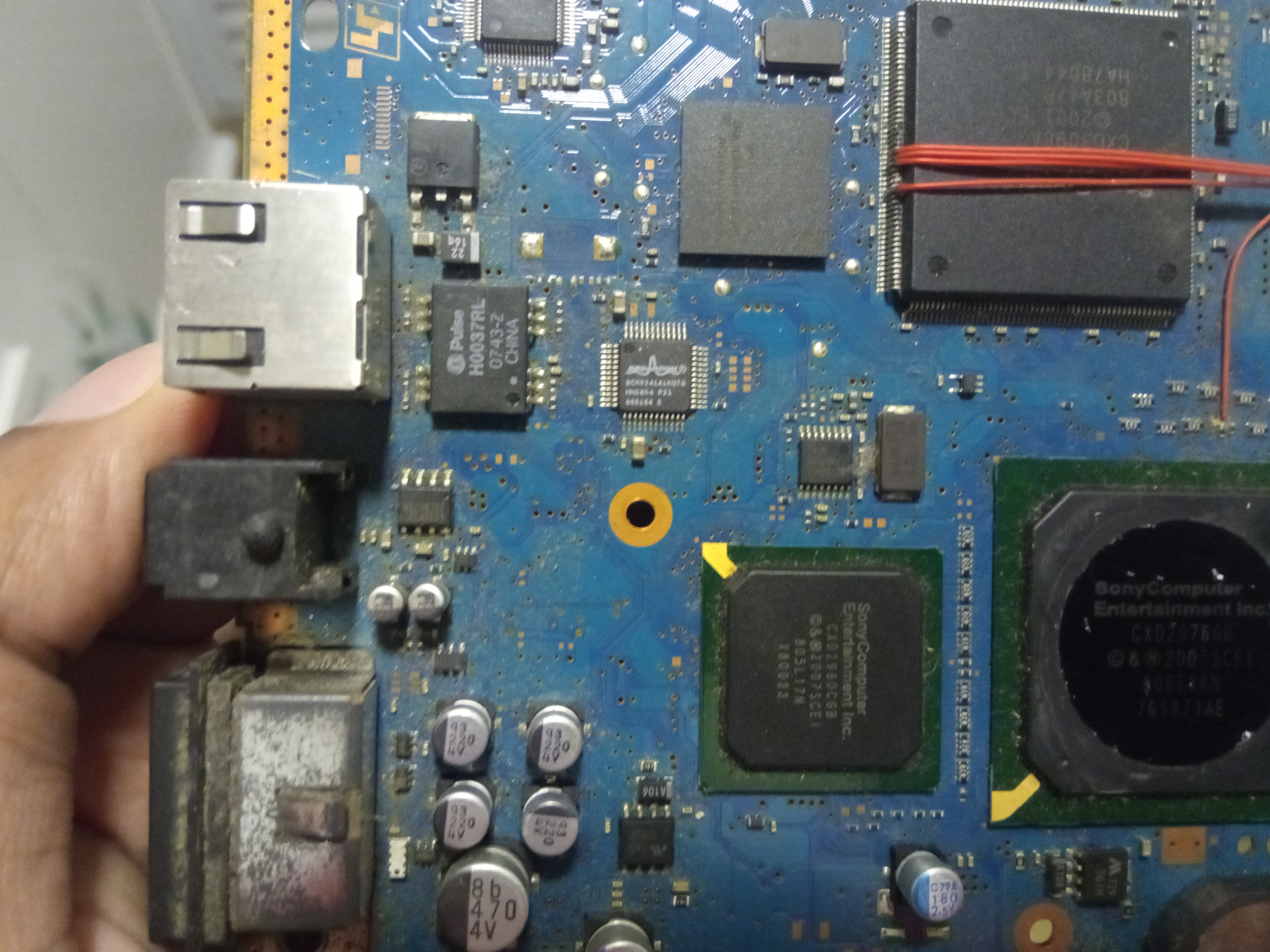

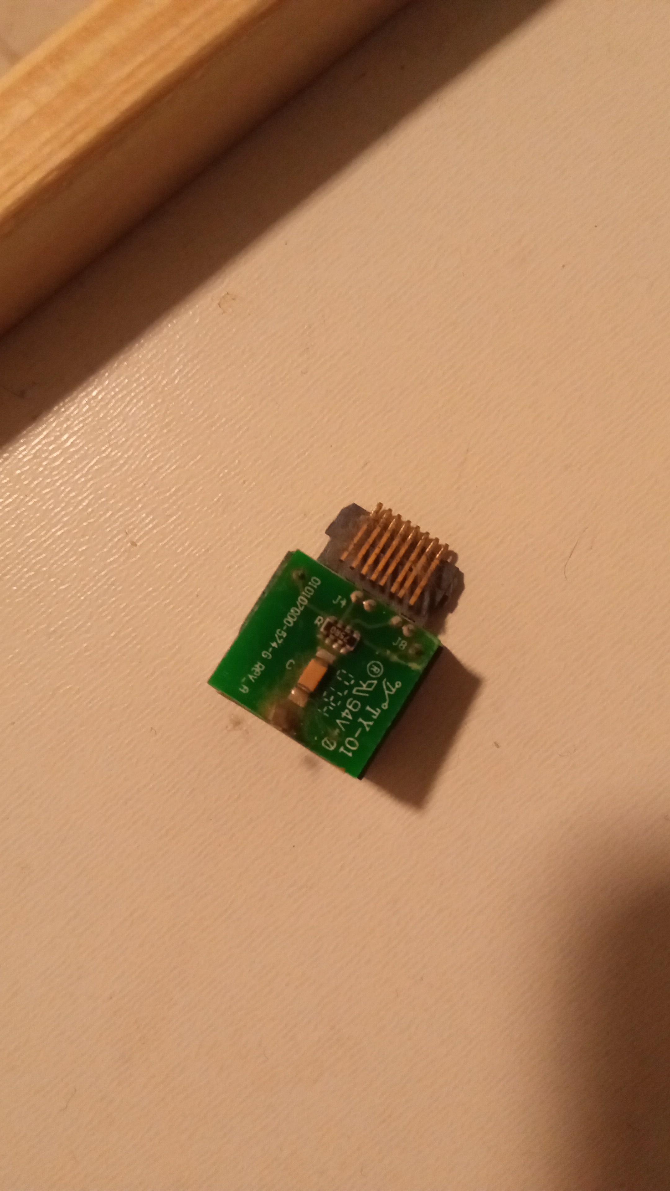

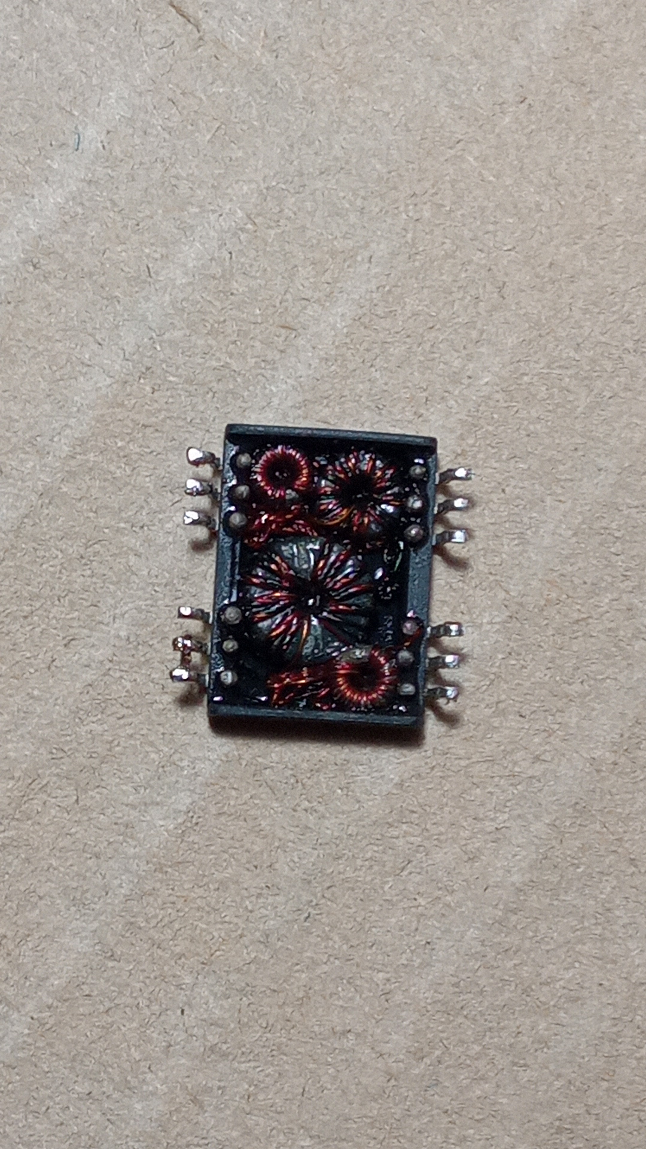

In the 70k and 75k versions of the PS2 up to the possible first version of the 79k an ethernet transformer, IC H0037RL, is used, in the other versions from the 79k to the latest version of the 90k an RJ45 Connector with an internal transformer is used, I am not aware of any project with the use of network connection on PS2 that has worked without this transformer, but I do not rule out this possibility. Below are pictures of what I'm talking about.
The transformer inside the connector:
The transformer in what I consider to be the first version of the 79k:
this RJ45 connector has no transformer, just a connector with its pins.
Finally, this is the 79k transformer inside, see the similarity with the connector transformer of the other 79k and 90k versions.

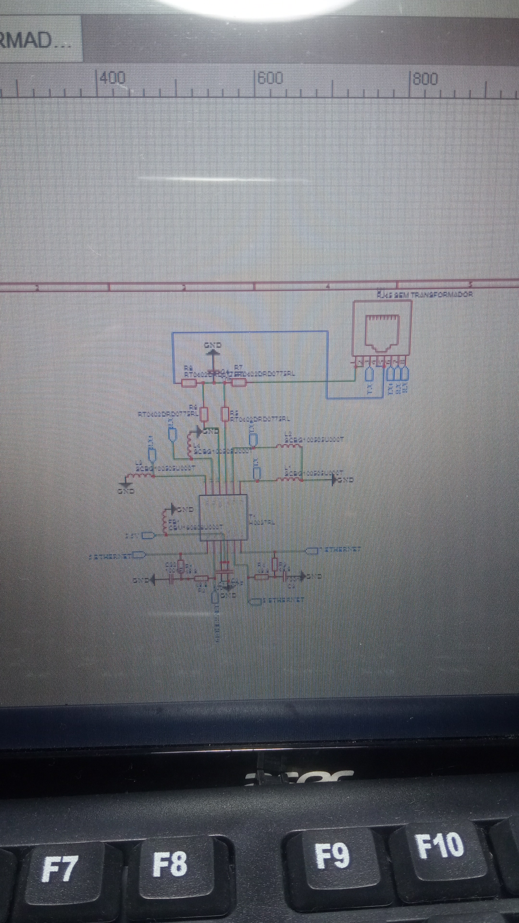

Thank you! I have the 79k version with the built in transformer into the jack. I am just struggling with figuring out the connections on the PI. It has a 10 pin Ethernet jack. I am going to hook up the transformer from the PS2 and see if that works.
I think this is a schematic of the pis jack. I am not very familiar with Ethernet.
yes, the schematic is exactly this, the part of the 75ohm resistors and the 1nf/2000V capacitor is inside the connector.
