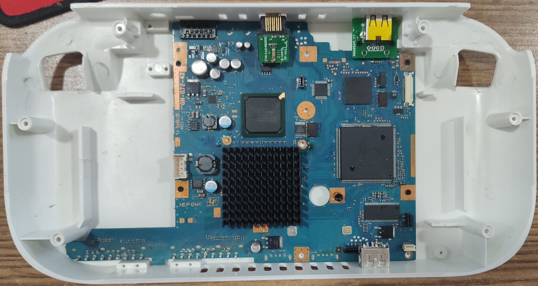

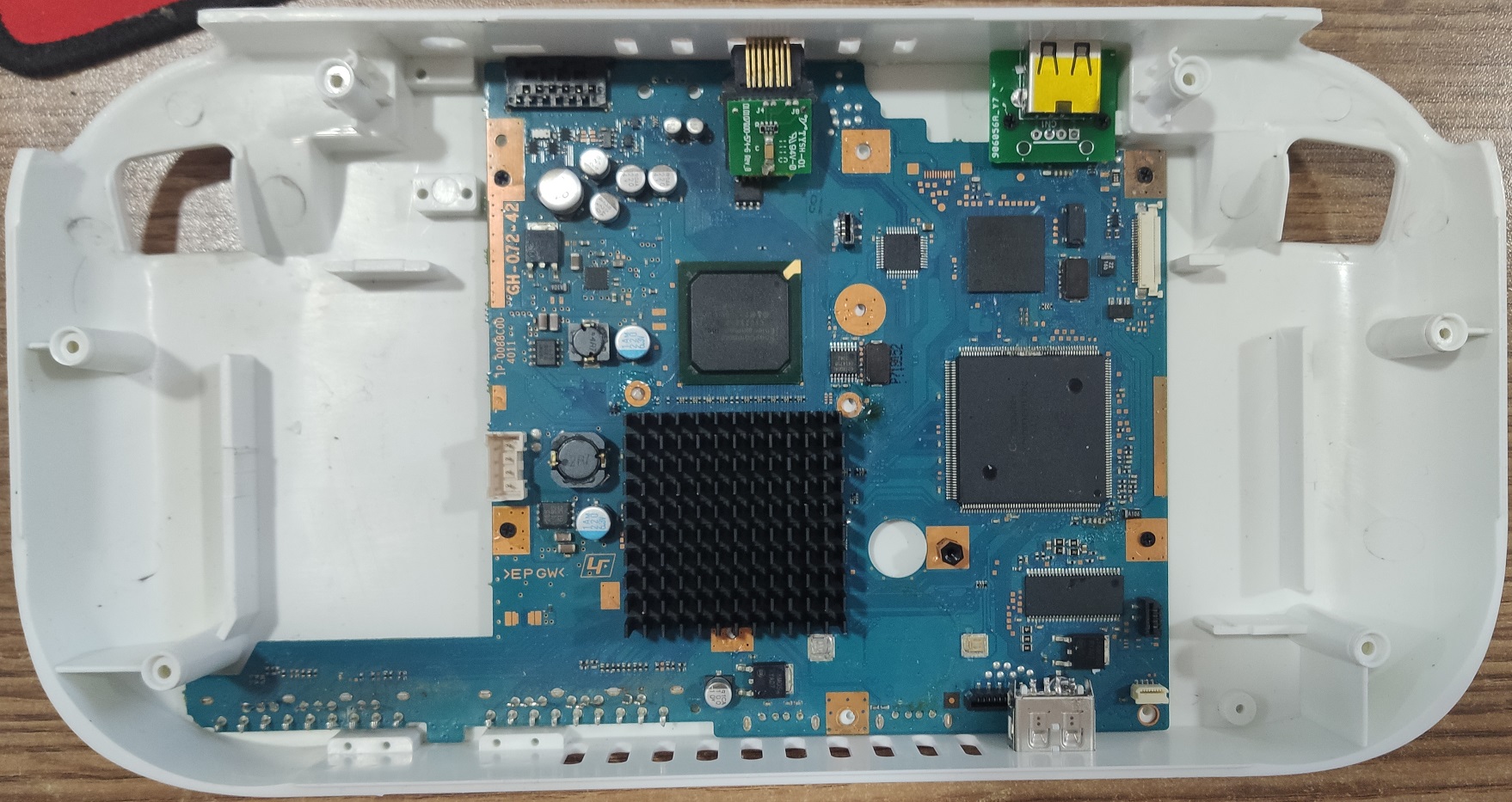

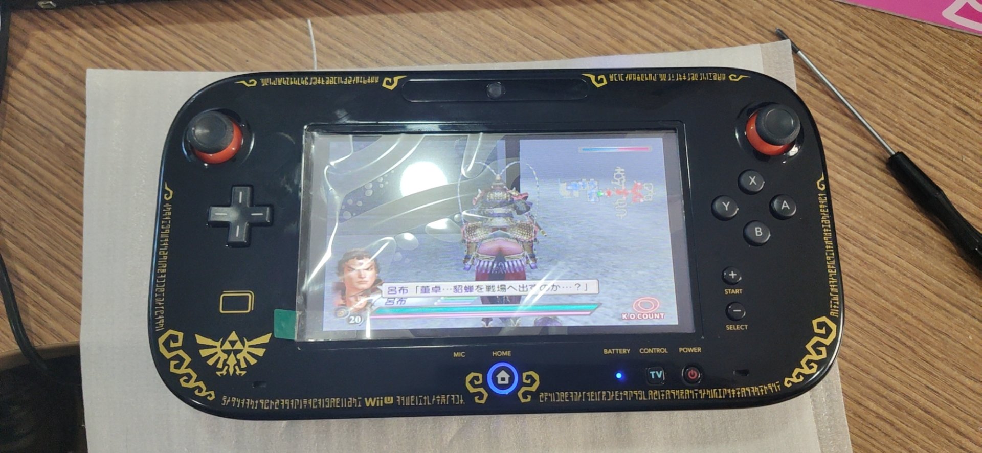

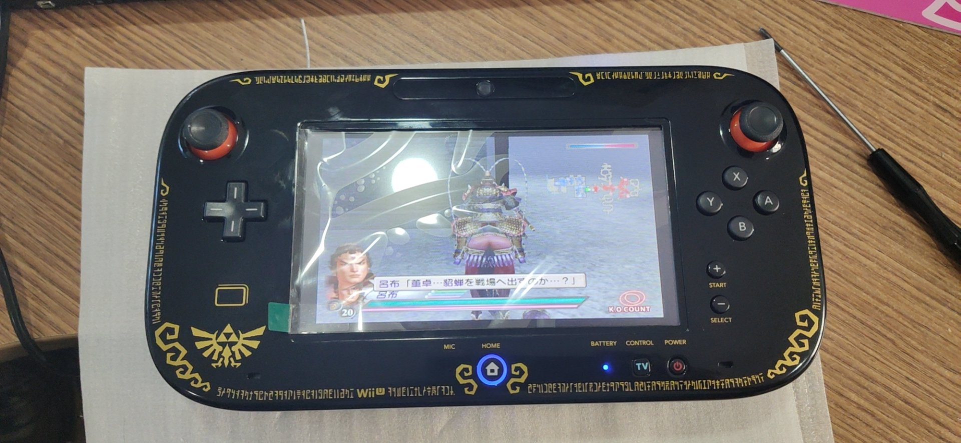

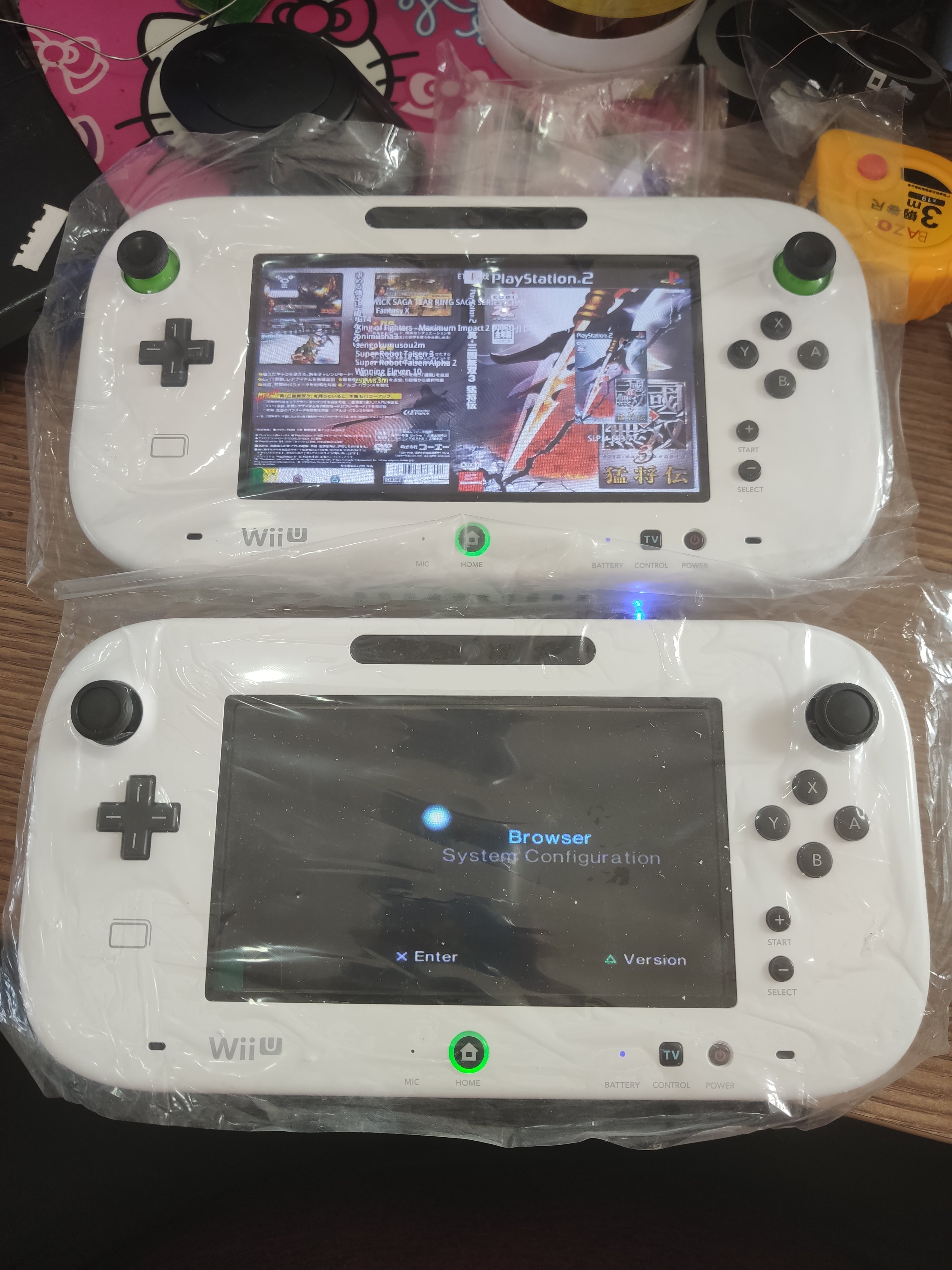

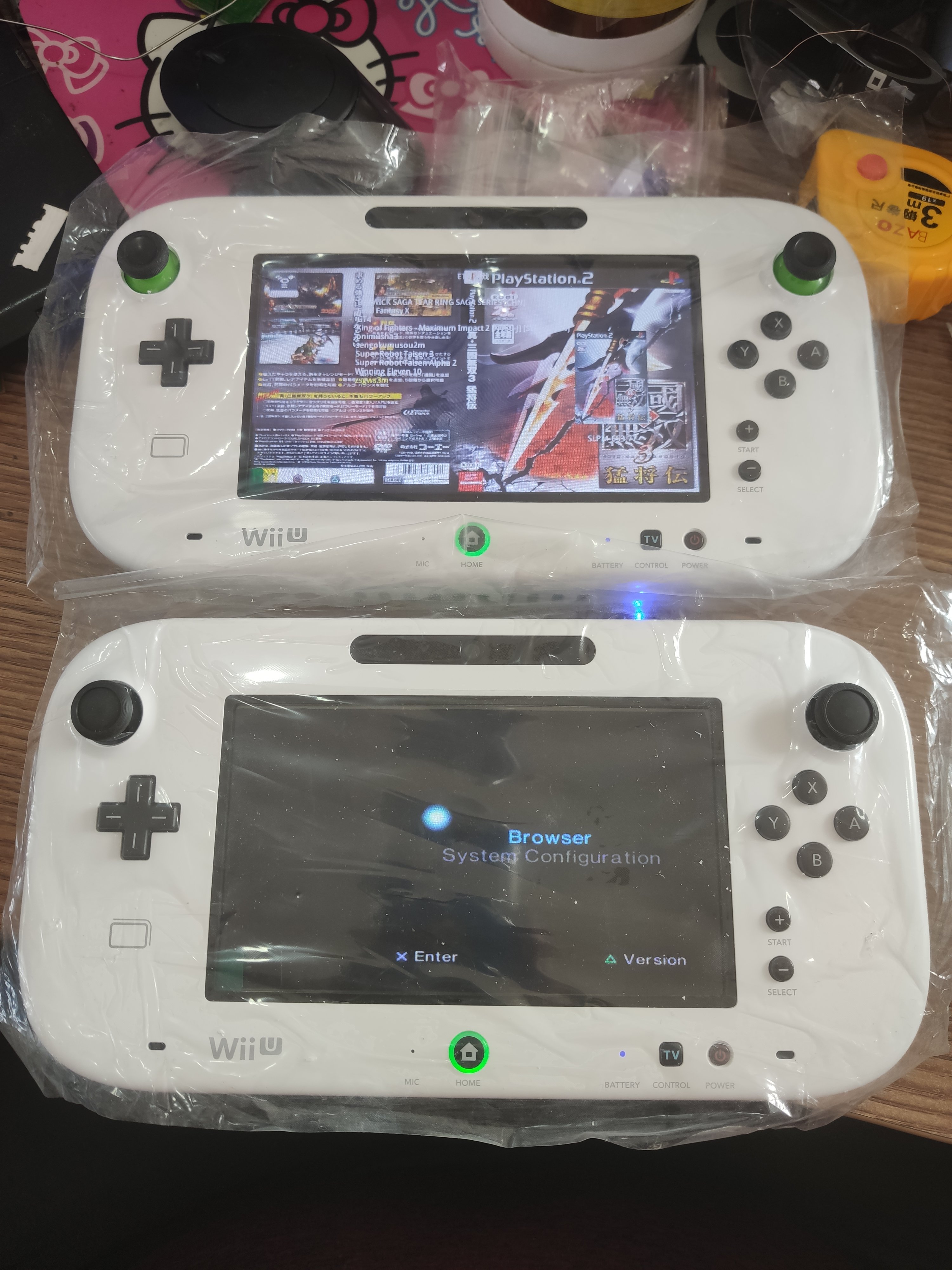

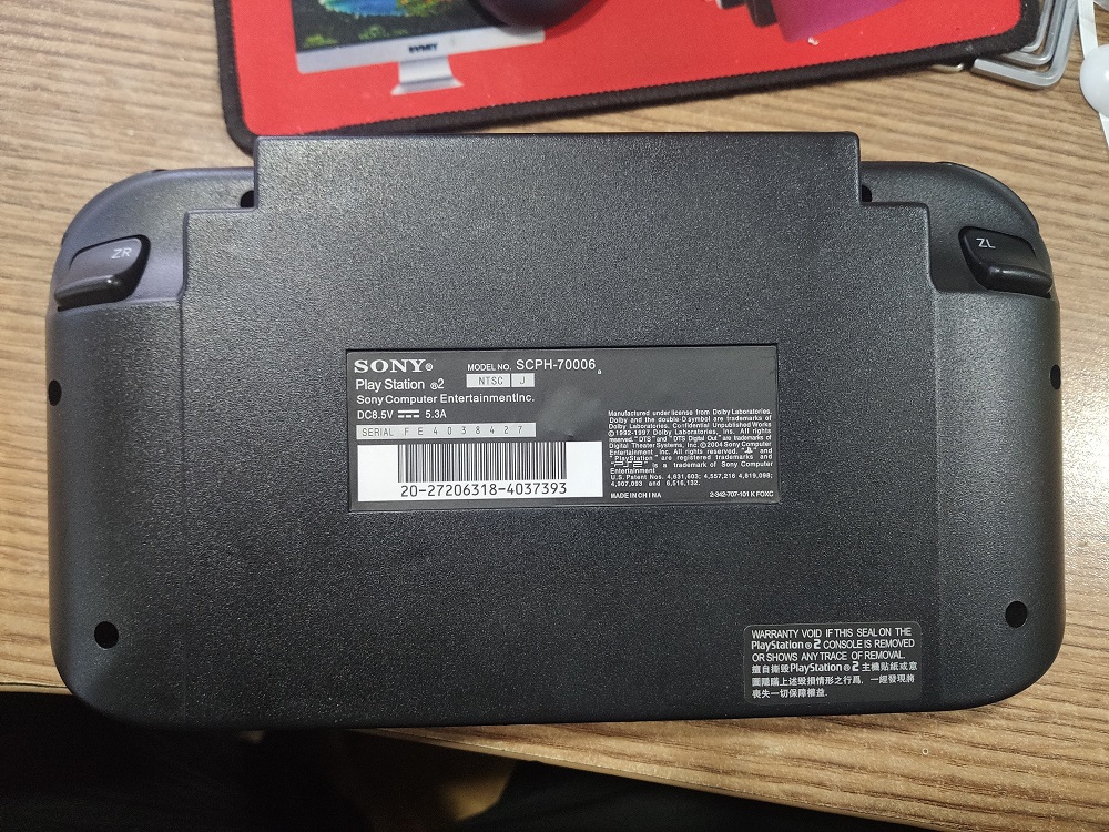

ohkin86 . Joined May 24, 2018 Messages 79 Likes 131 Location CHINA DALIAN Jun 25, 2021 #2 Yes, 9000x series can be used with two 18650 batteries. In my experience, it can run for about 1.5 hours. I made many PS2 protable with wiiu shell,
Stitches 2 and a Half Dollarydoos Staff member . . . Joined Feb 5, 2017 Messages 4,646 Likes 3,592 Location Banana Bender Land, Australia Portables 6 Jun 25, 2021 #3 ohkin86 said: Yes, 9000x series can be used with two 18650 batteries. In my experience, it can run for about 1.5 hours. I made many PS2 protable with wiiu shell,View attachment 17796View attachment 17797View attachment 17798View attachment 17799 Click to expand... Is that a custom injection moulded backplate?
ohkin86 . Joined May 24, 2018 Messages 79 Likes 131 Location CHINA DALIAN Jun 25, 2021 #4 Stitches said: Is that a custom injection moulded backplate? Click to expand... Yes, it's an injection moulded ABS frosted case.
JDat . Joined Jun 20, 2021 Messages 3 Likes 0 Jun 27, 2021 #5 ohkin86 said: Yes, 9000x series can be used with two 18650 batteries. In my experience, it can run for about 1.5 hours. I made many PS2 protable with wiiu shell,View attachment 17796View attachment 17797View attachment 17798View attachment 17799 Click to expand... Do you have any pictures of the internals fully wired up?
