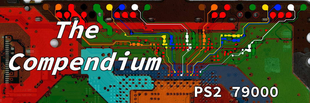

Board scan PS2 79000 Compendium
Gman
RTFDS
Feb 25, 2016
1,465
3,020
Download - Full size (.PDN)
Get Paint.NET
This compendium can be referenced for most of the 79XXX series motherboards and was used to map out the Advanced PS2 Trim. It's not a perfect scan however it is still incredibly useful.
Whaaaaaaaat? It begins!! Thanks so much G... legendary contribution. I have a 79000 in my backstocks... one day I'll actually put it to use. Cheers mate!
