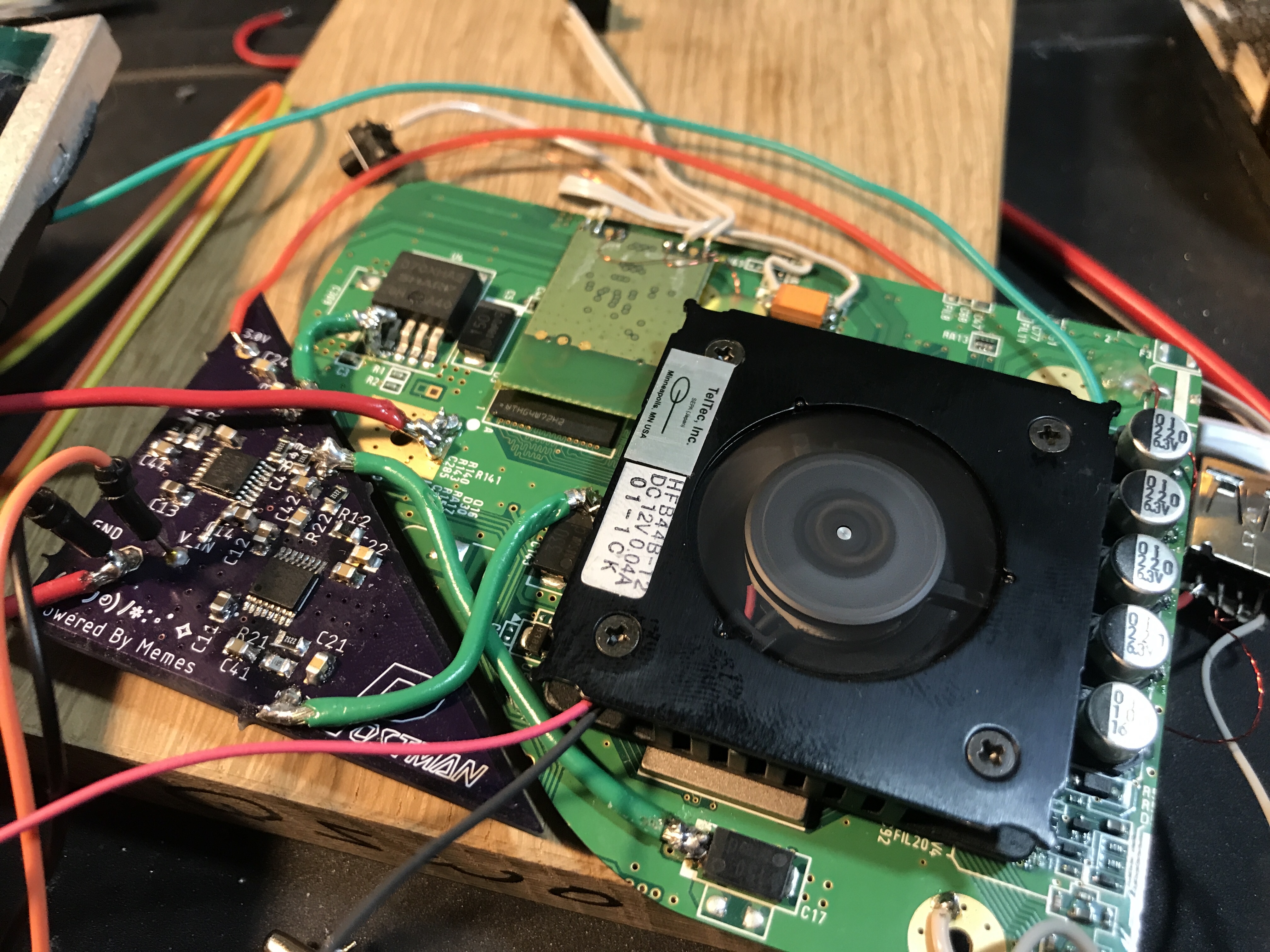

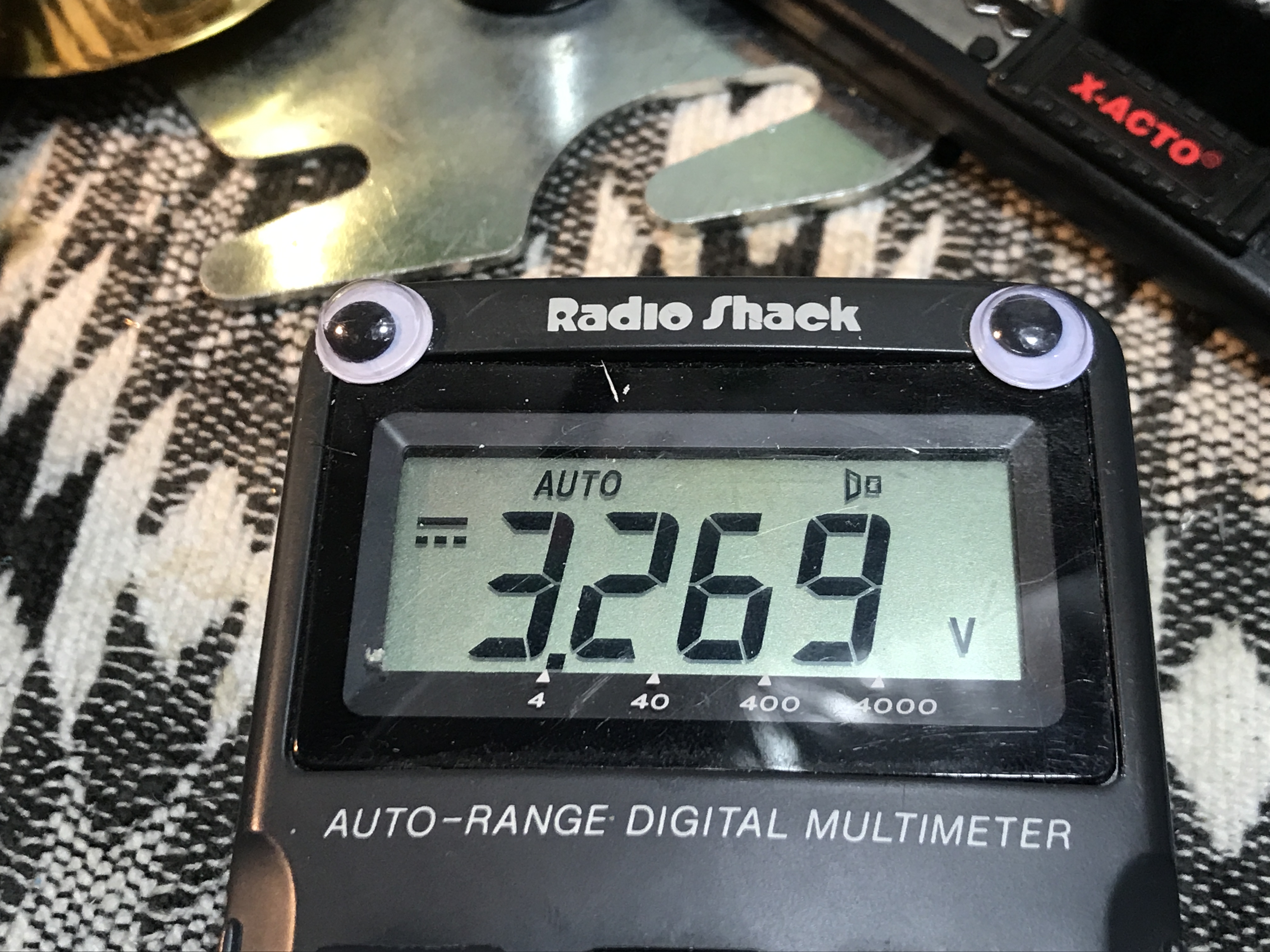

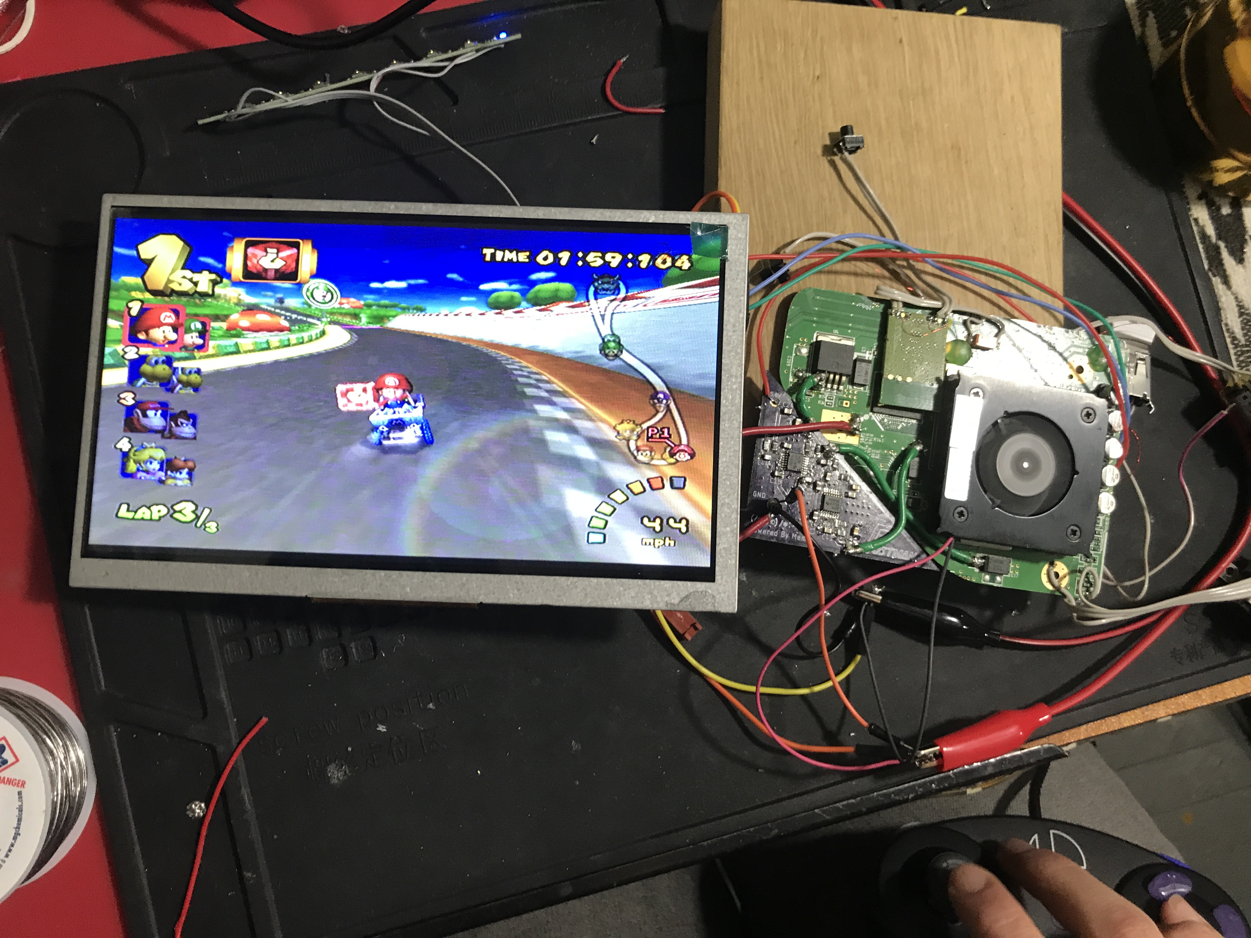

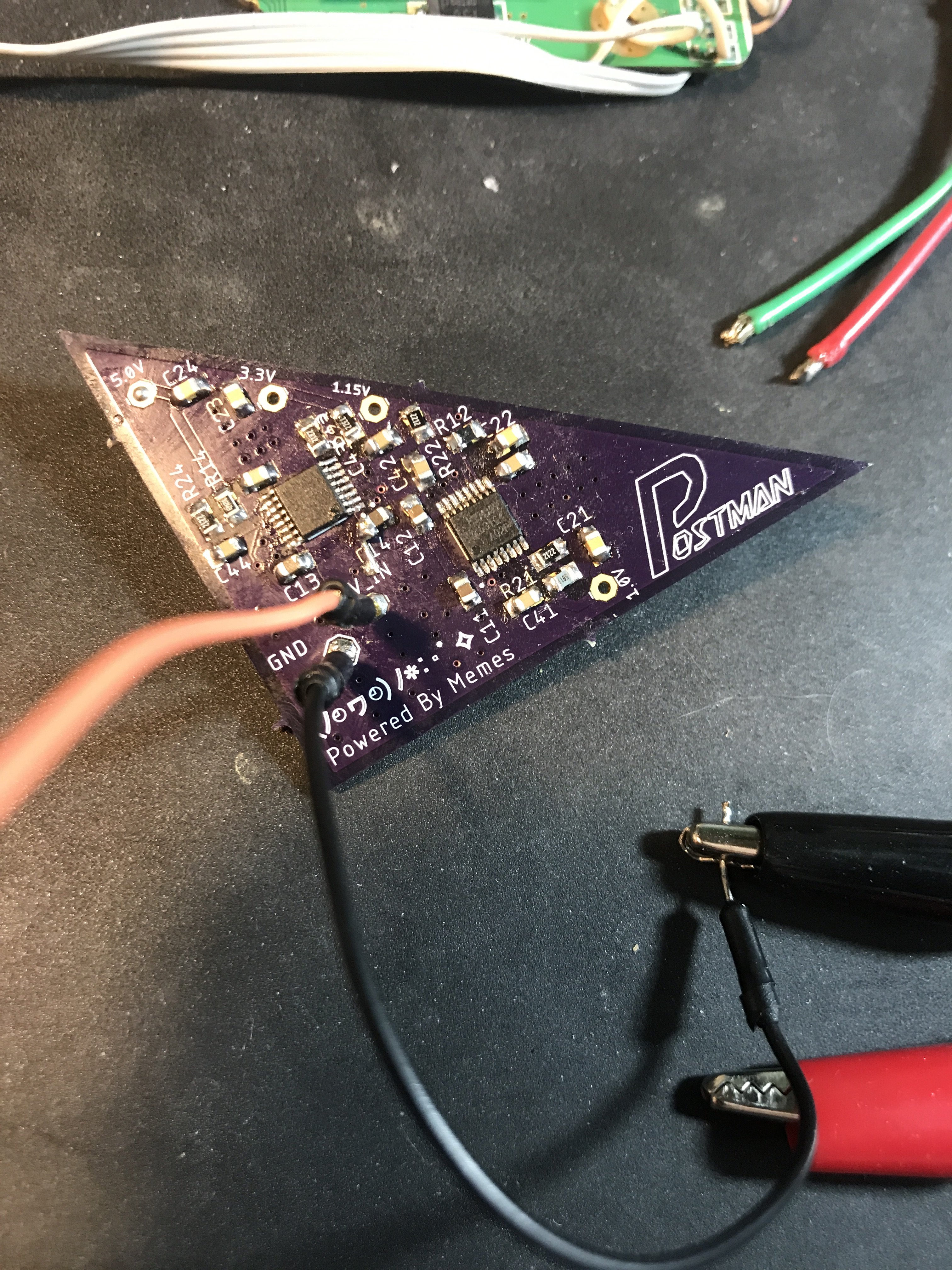

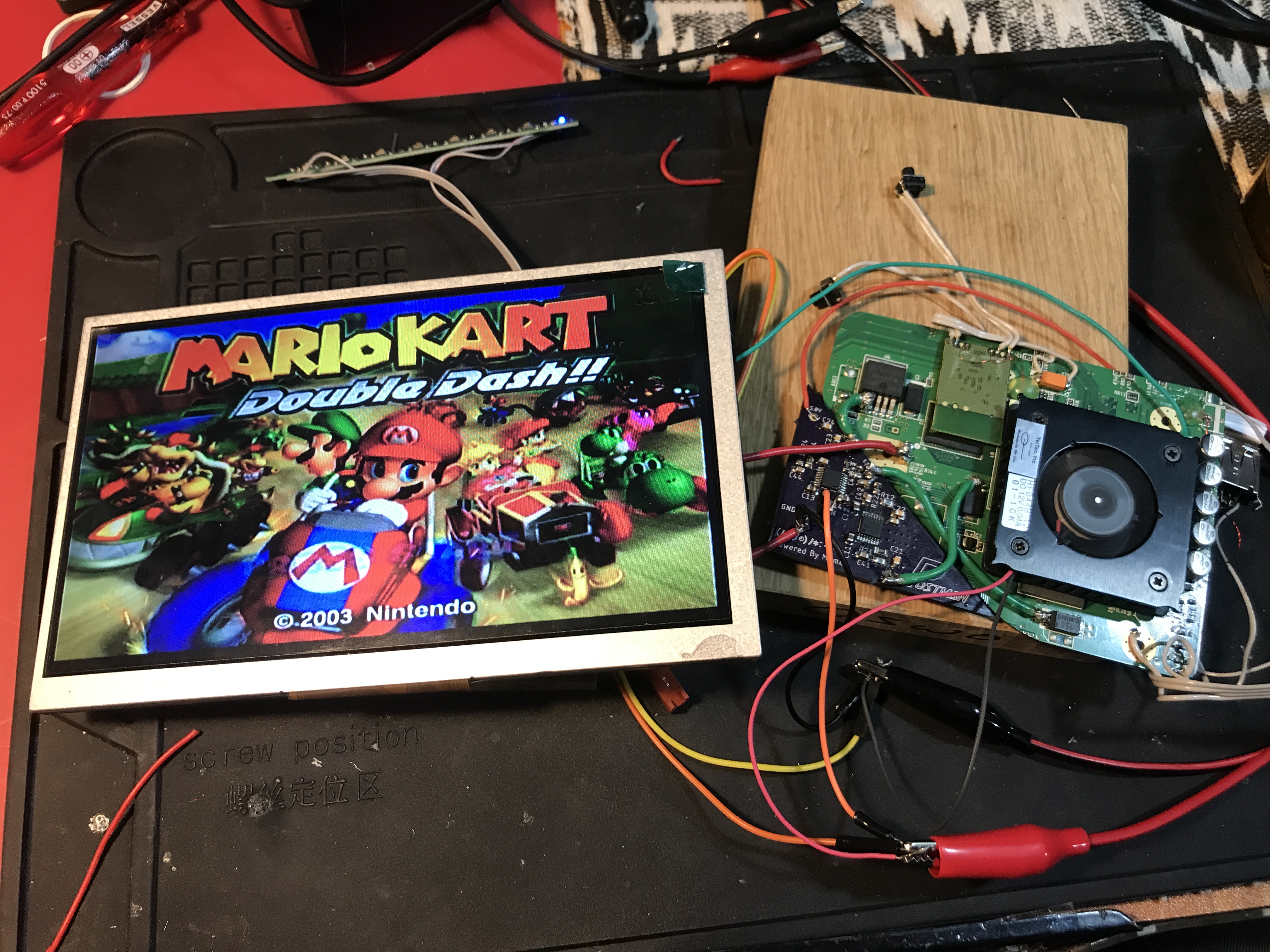

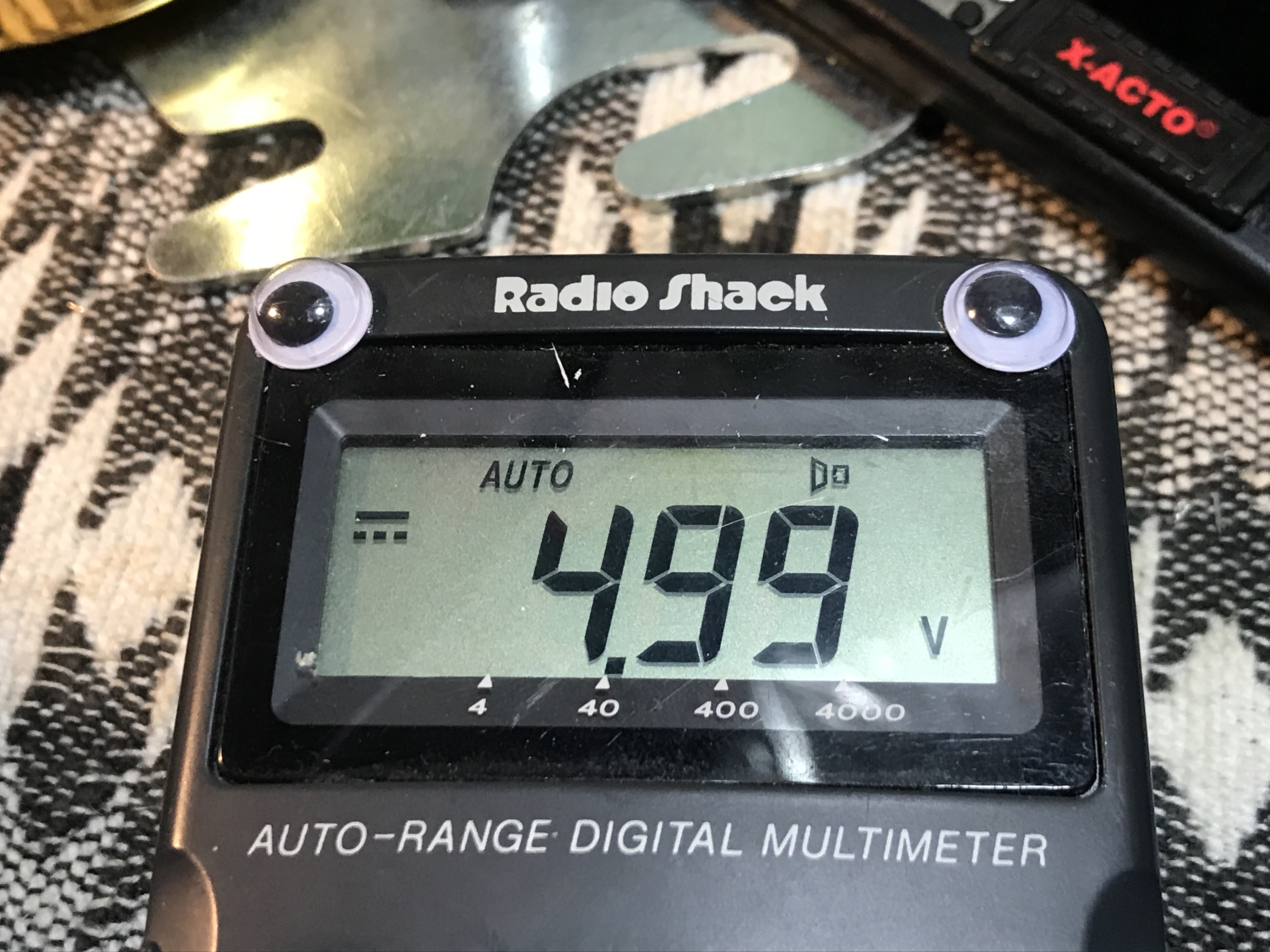

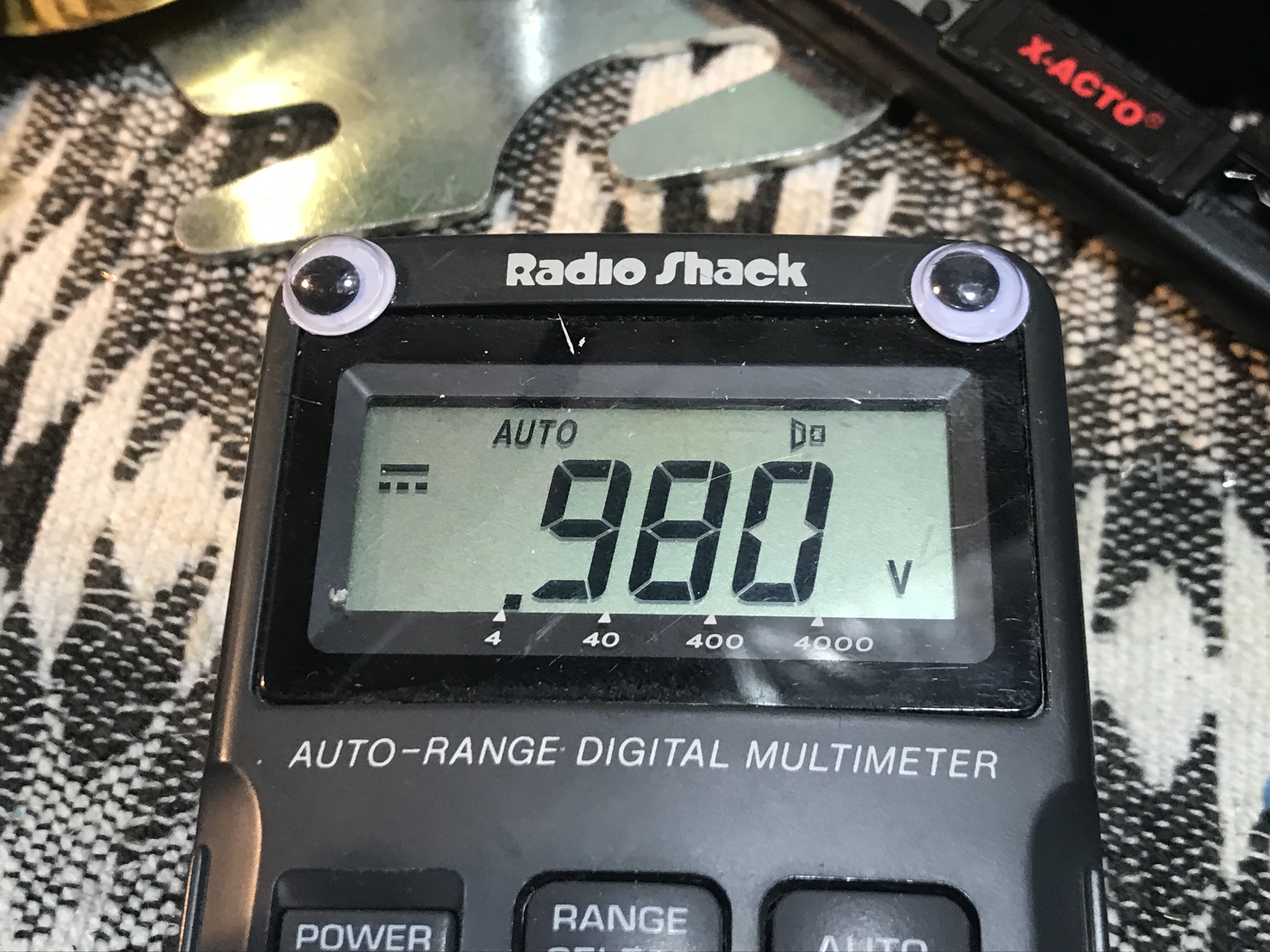

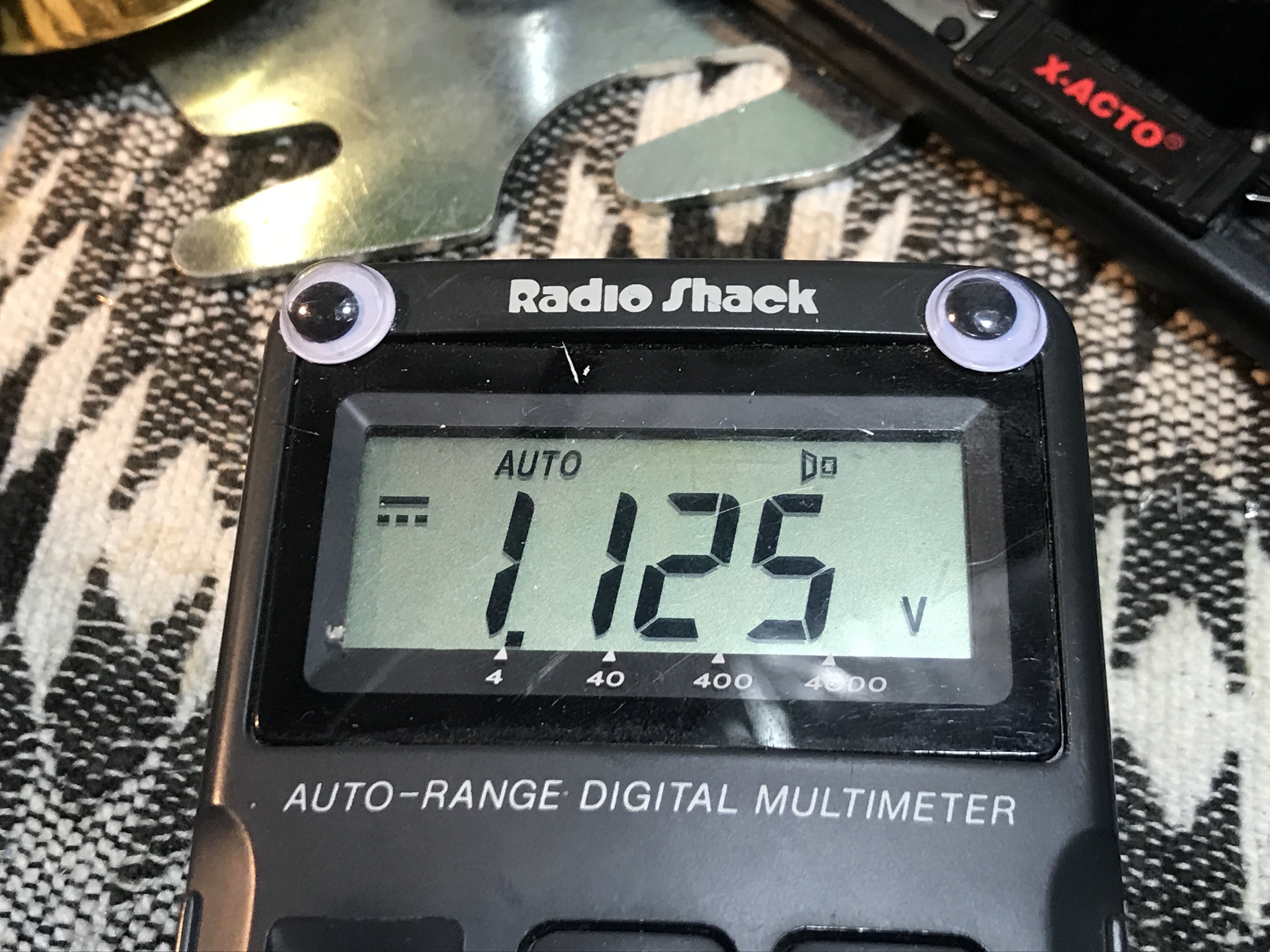

I present to you all: PIIza TIme. A custom Wii regulator board built off of 2x TPS54395 switching voltage regulators with around ~90%-95% on the 5.0v and 3.3v lines and ~80%-85% efficiency on the 1.15v and 1.0v lines. Also has a pad that can brought high or low to turn on/off the regulator board with a 2 position switch.
I started this project after MGC last year as my first ever PCB design project. After two boards that were garbage, some help from @Gman (<3 u baber), and many butt tears, I finally have a design that kicks ass.
The name is broken into two parts "PIIza" because it's shaped like a slice o' pizza and fits perfectly in with an "OMGWTF" trim to complete the rectangle it almost makes. It's also a shout out to @Aurelio because he is a badass piiza man, thanks for all your work man! "TIme" because it's built off of a TI regulator.
PIIza TIme does get pretty hot, but unfortunately I don't have a FLIR or even a thermocouple to test exactly how hot. In my testing it did not seem to affect performance of the regulators but I would recommend putting some type of small heatsink on top of the chips. Doesn't have to be fancy, something small would do with a little thermal pad would do. Raspberry pi heatsinks would do nicely.

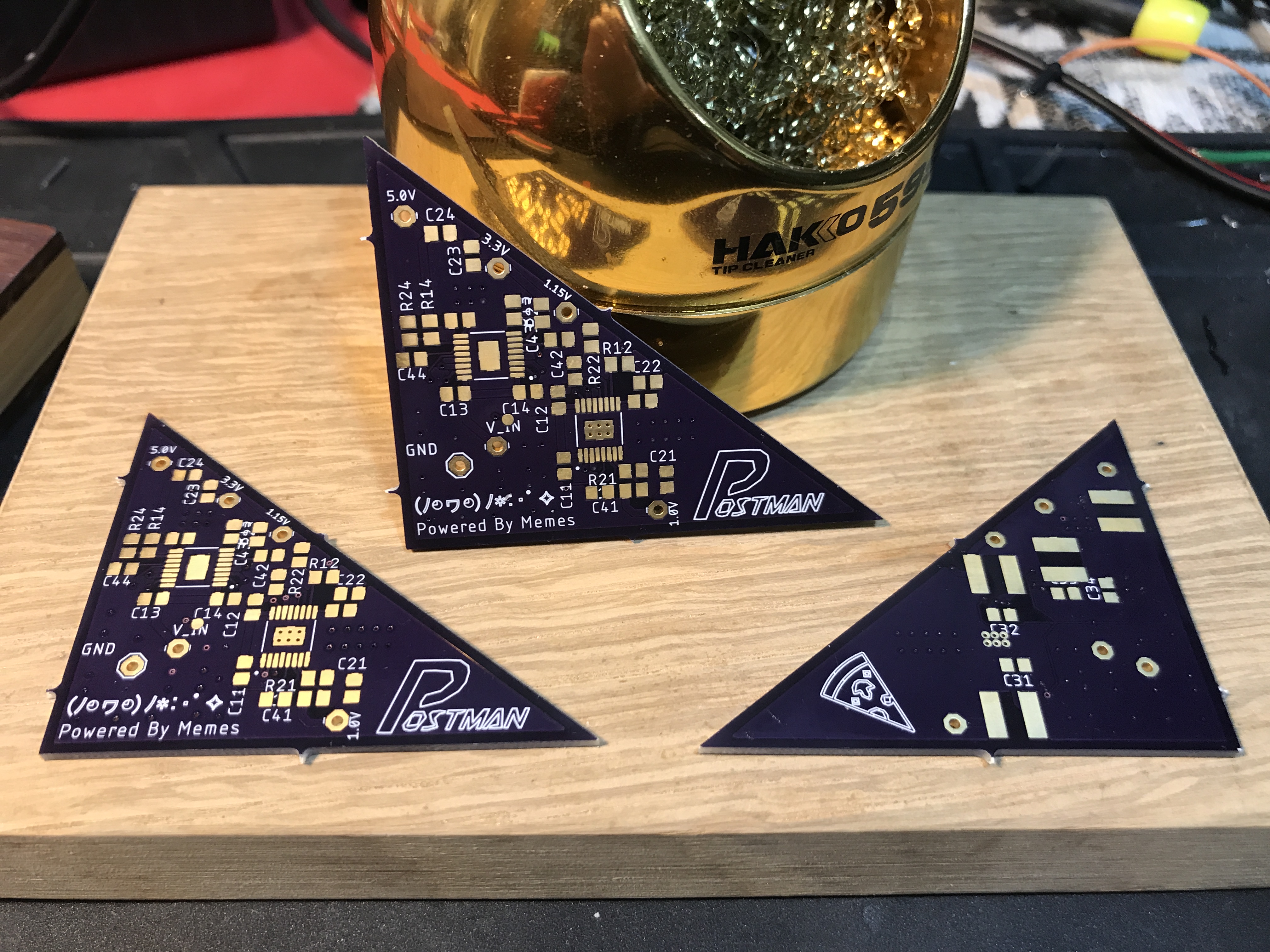

Hello everyone, back with an update!
I revised the PCB to improve the chip thermals. The board now has exposed ground plane with vias around the chips to help keep the TPS regulators cool.
I also added an attiny10 for pulsing the U10 point at startup. The program is designed to run at startup and pulse the U10 line for a second or so and then remains high @ a stable 3.3v. You can also attach a switch to the u10 pad that connects to ground for a makeshift reset button if you so choose.
PCB files are up on my github and updated BOM are up on my github. Can't seem to find the attiny10 code right now but Ill upload it once I find it.
Pics to follow once I receive the boards from the fab house!

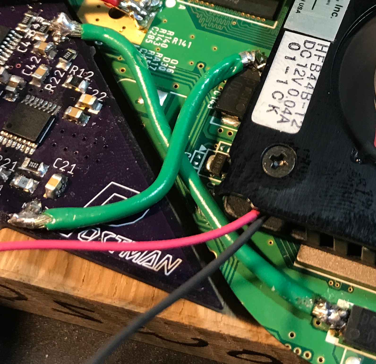

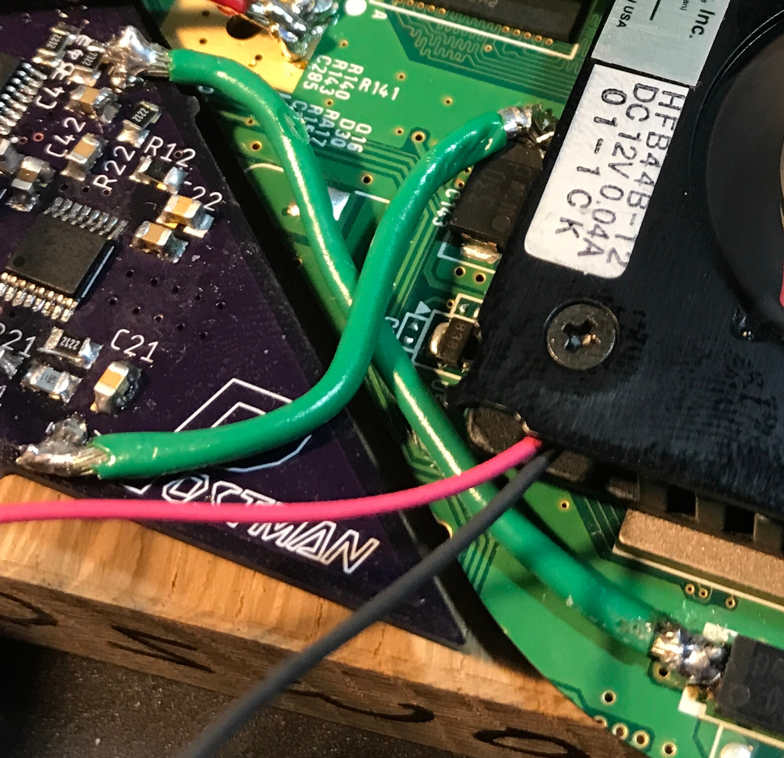

no offence dude - i was mostly wondering why the wires are crossed. would be dope if the vout pads just swapped places.
