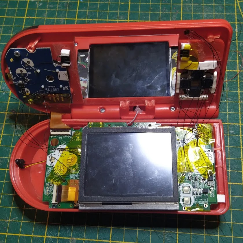

I have reused the original dpad but for the abxy I cut out it out of a ds lite shell and trimmed it for it to fit.
this is how the shells looks like fully trimmed

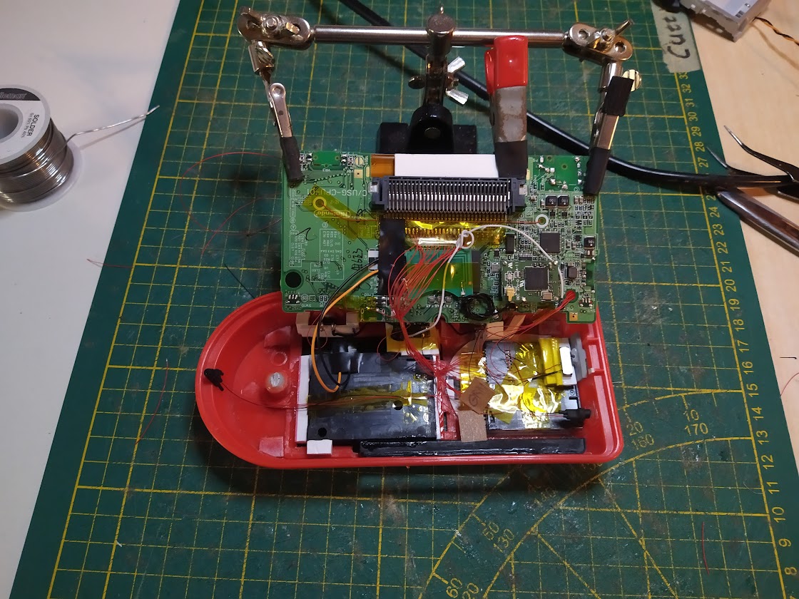

here I was halfway through installing the ds motherboard
all wired up

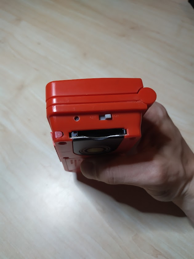

volume wheel, gba slot and headphone jack on the front.
stylus holder, ds slot and power slider on the right side.

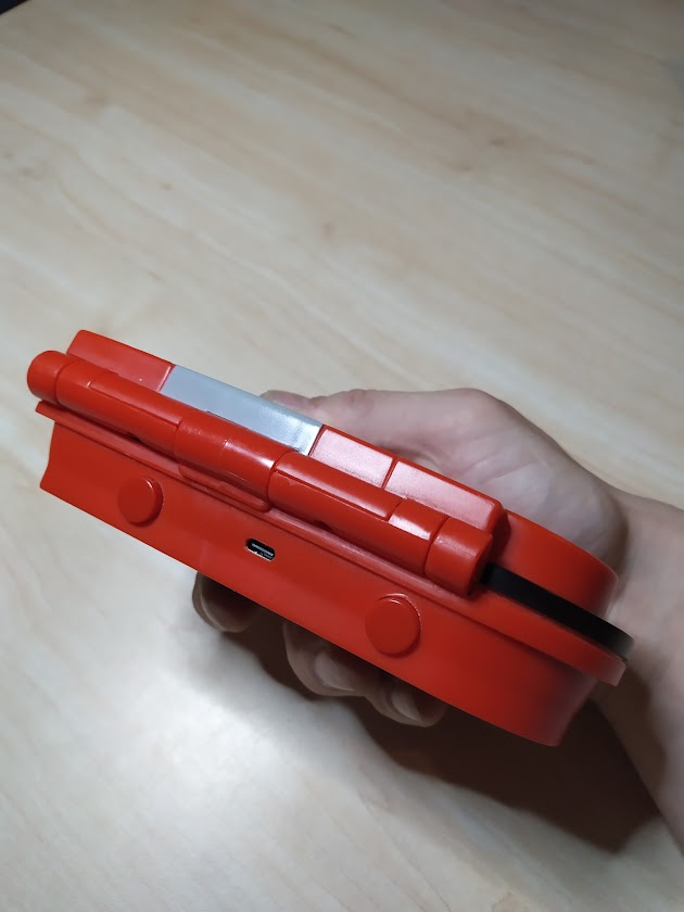

shoulder buttons and usb c on the back.
