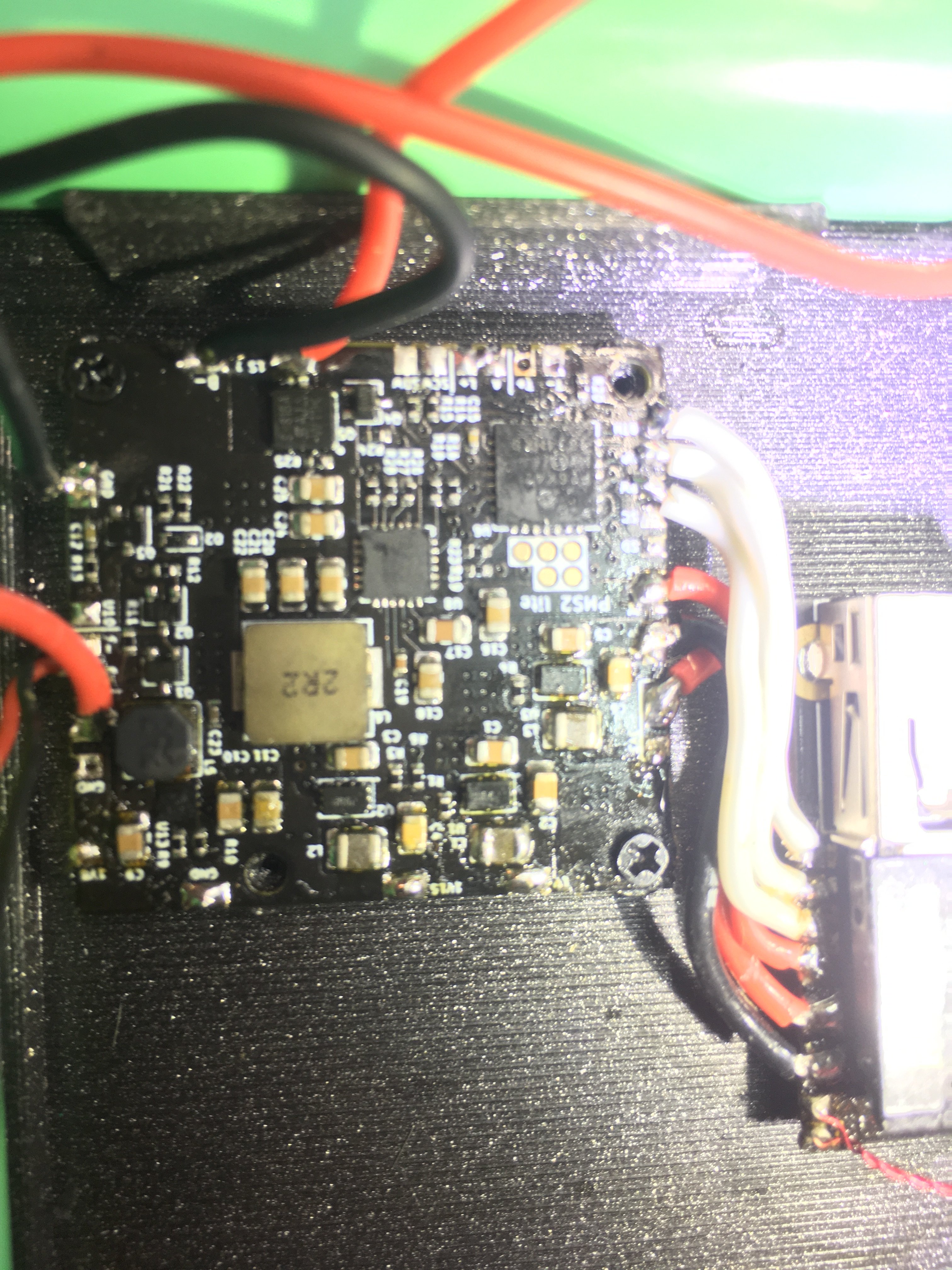

Question PMS lite not suppling 5v

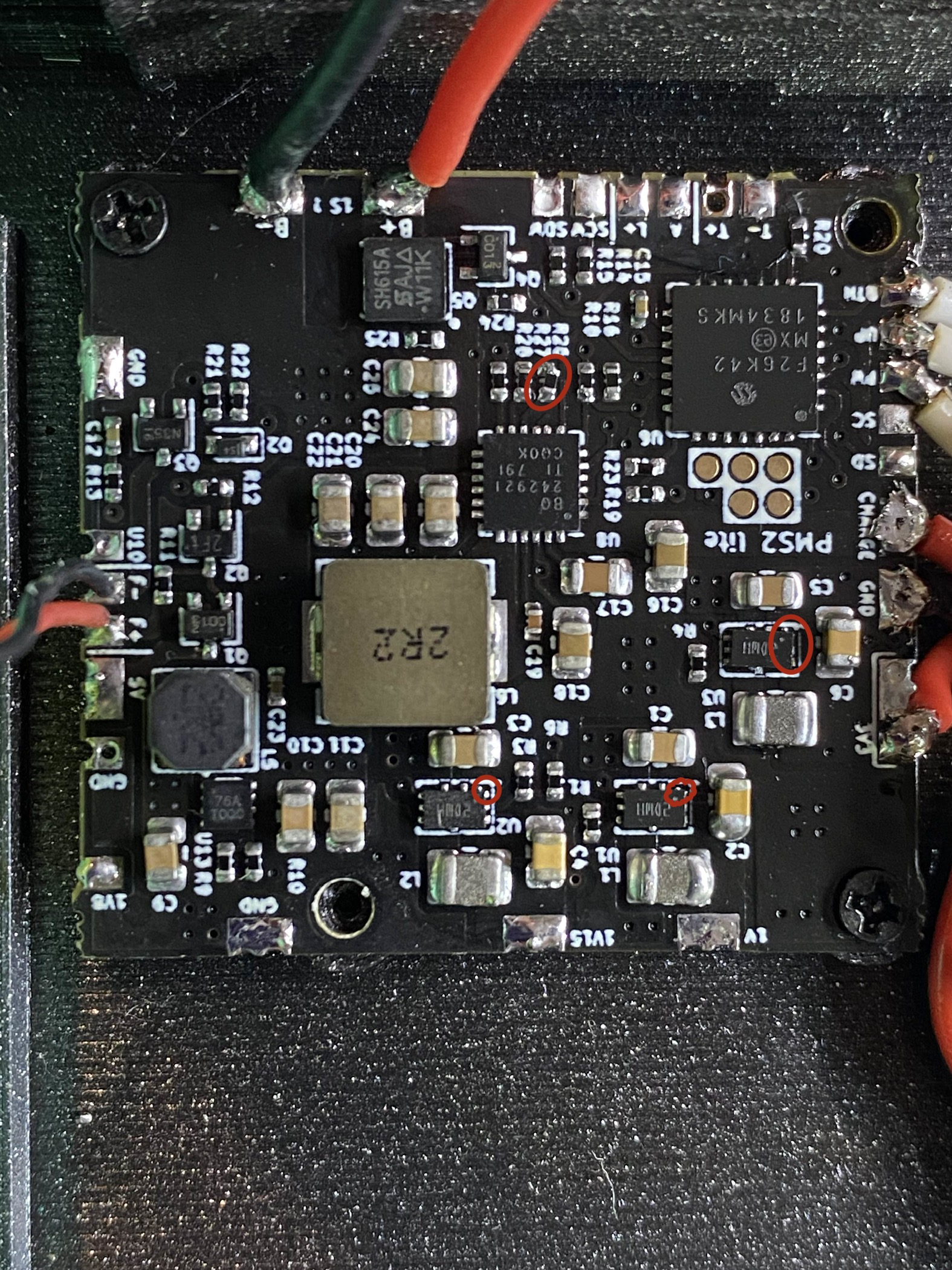

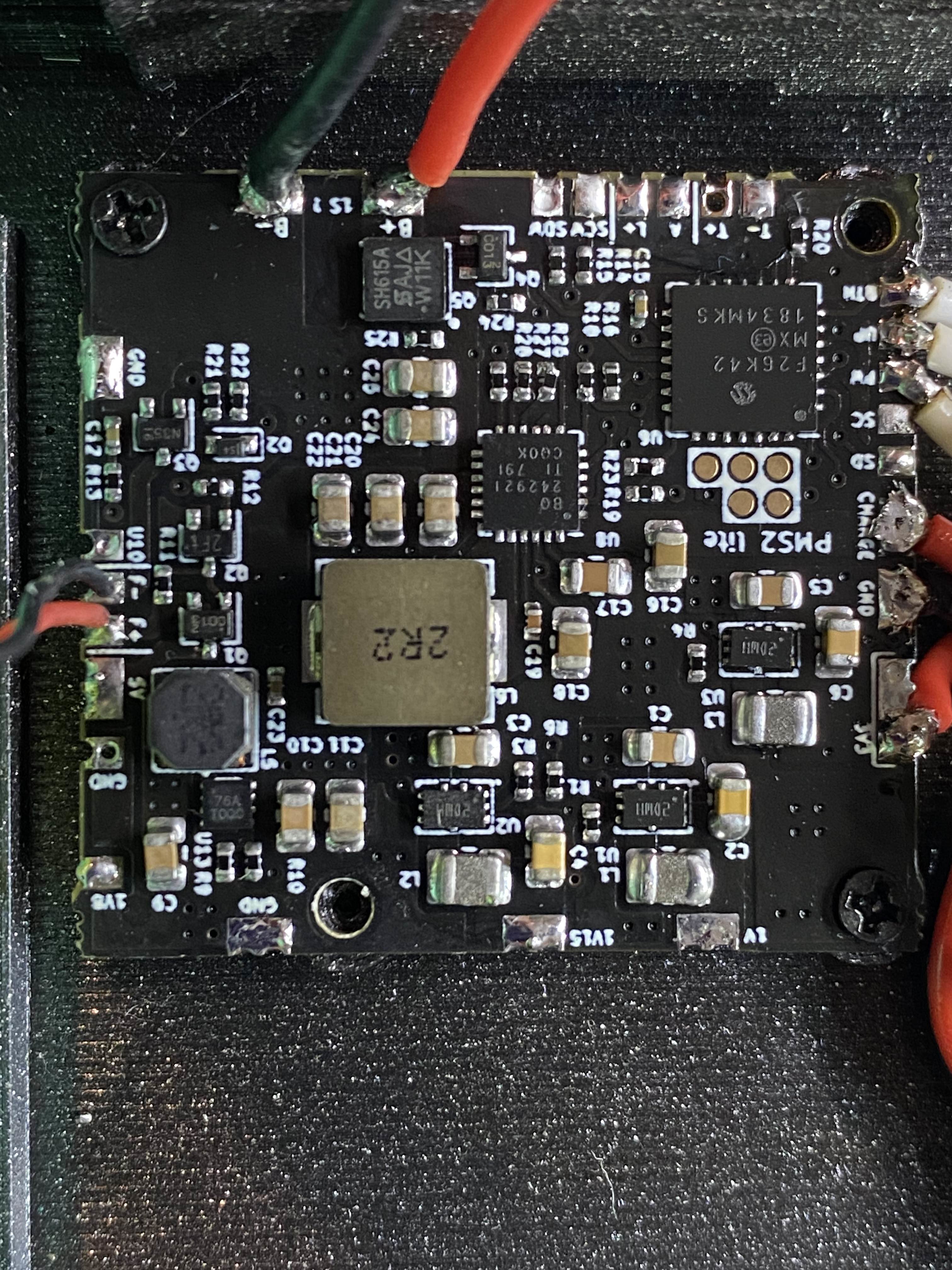

The 5v pad is giving the same voltage as the batteries
I think this chip is not working
The two pins circled in red are giving the same voltage. Im pretty sure that the pin on the right should be giving 5 volts, but instead its giving the same 3.64v
Maybe someone else can step in and help identify this component, also I would inspect the full board to make sure there’s no shorts or excess solder where it shouldn’t be.
The U10, U2, U3 devices you circled are all marked 2DWH which is a Texas instrument TPS62867RQYR. Someone may correct me if I am wrong.

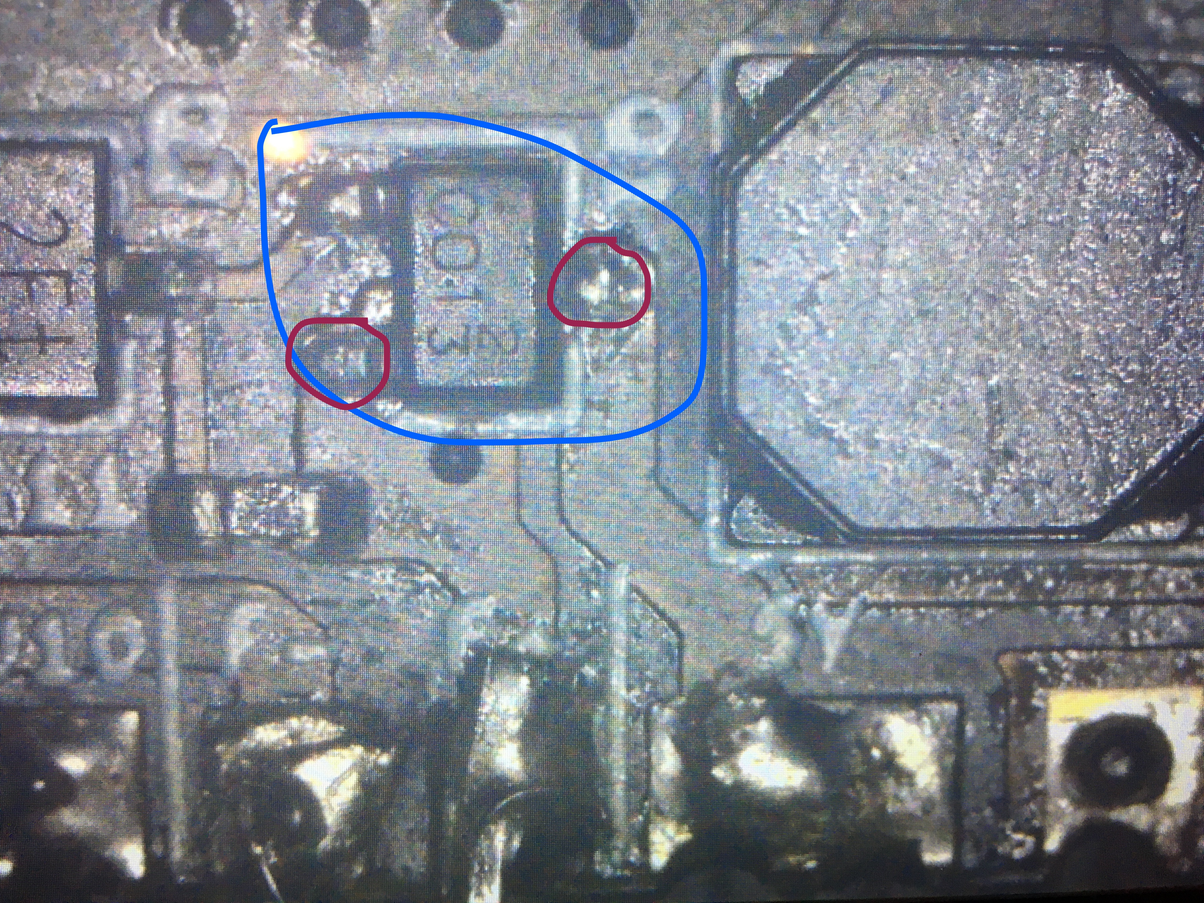

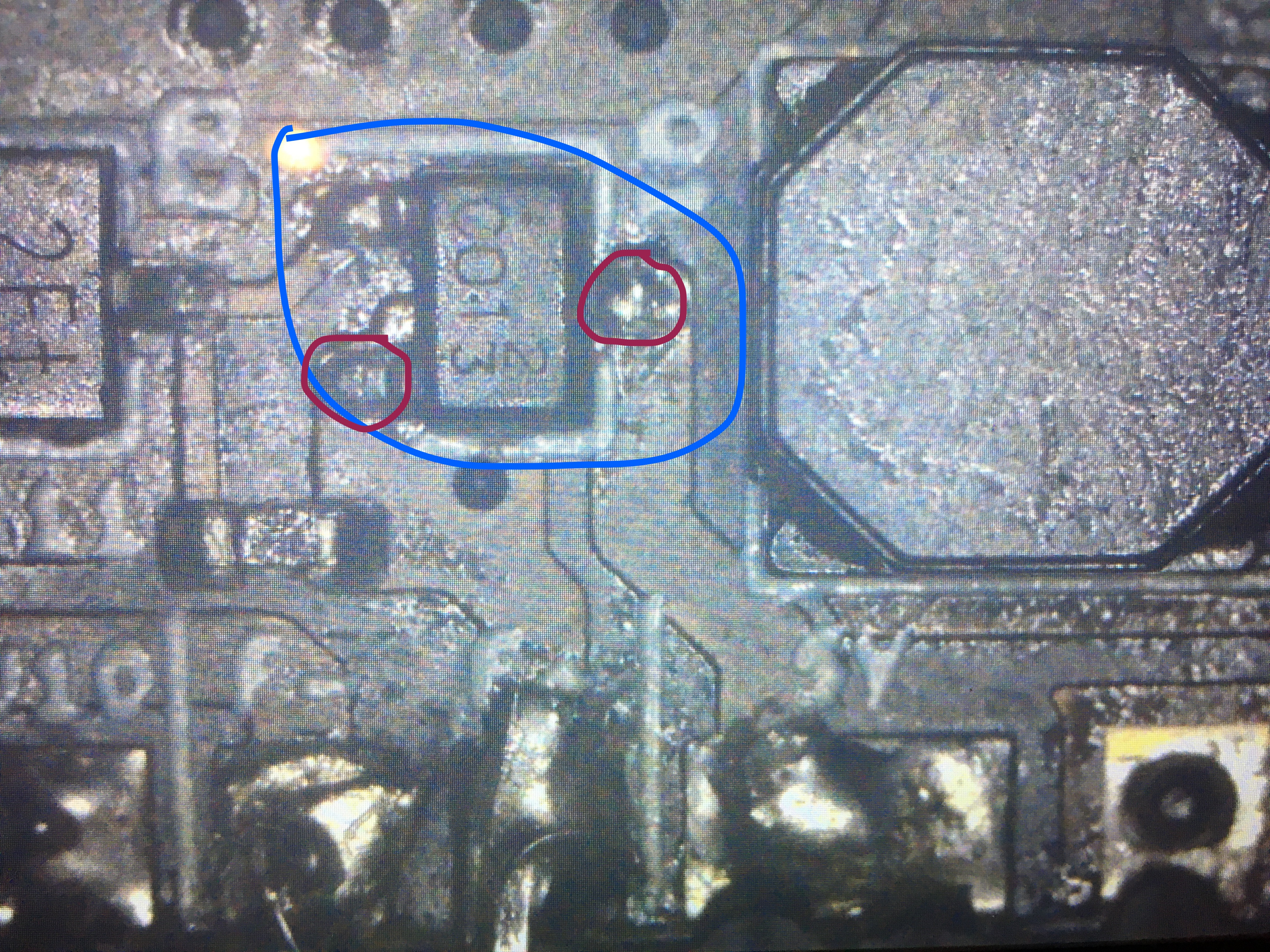

Oops i forgot to mention for him to check for shorts in the ones circled red and someone help identify this one here. It’s from his earlier post he made
Yeah that component is a bit trickier to identify because of the SMD marking. I couldn't find any spec sheets online for it.

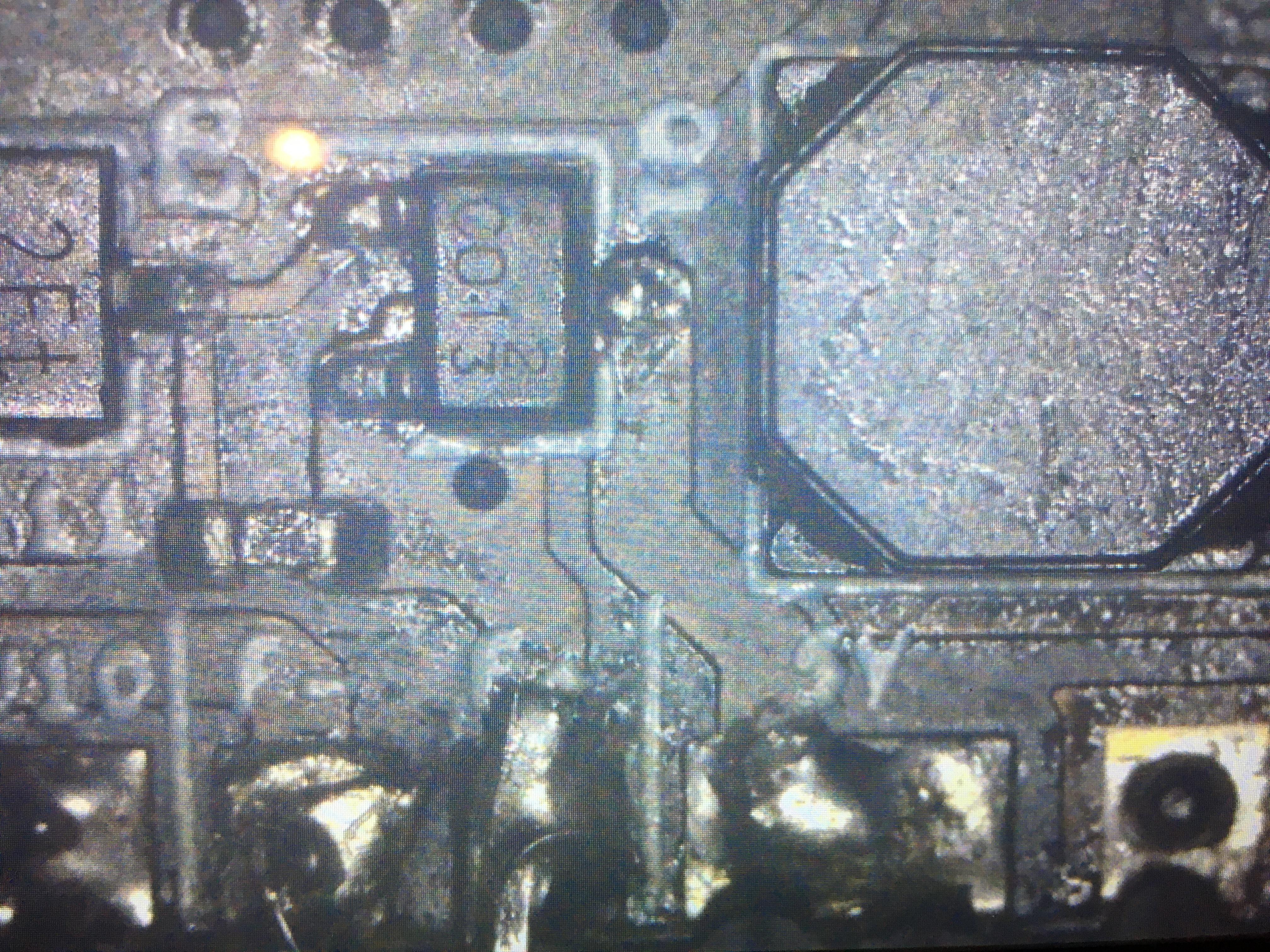

Do you have continuity between the 5v pad and the B+ pad on the PMS? The 5v reg might be shorted
I just checked B+ against 5v on a spare PMS LITE I have and got OL (no continuity)
You've got a short somewhere that's creating either a voltage drop, or causing one of the voltage regulators to not function properly.
The PMS LITE is closed source so there are no schematics available to help you troubleshoot this down an SMD component level.
Last thing I can think of would be to unsolder every wire from it, and basically bathe that puppy in 99% IPA and SCRUB SCRUB SCRUB. Half a dozen times at least. If that doesn't resolve your issue I think at this point you're better off buying a new board.
Sorry buddy );
Removing and replacing the 5v regulator is an option as well, but yeah I'd give it a good clean first and inspect the 5v reg for a visible short between VIN and VOUT
